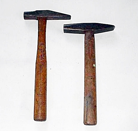

Here is a picture of a Paschall 1302 , 2 oz head.
In 1936 Plomb catalog this hammer made in LA, Cal. listed for 0.75 cents.....
They are now $75.00 +. This little monster almost got me in trouble but I got smoked on the Bay thank goodness.
Gary

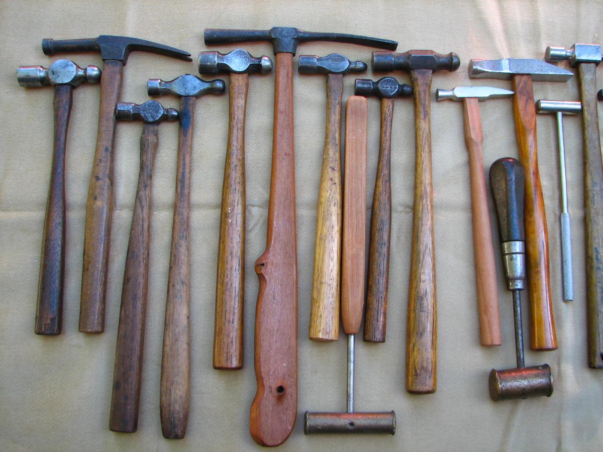

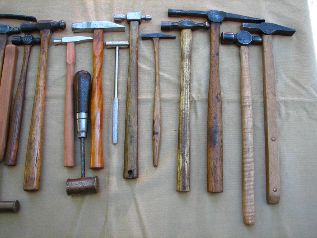

Glenn, you ever use the cross peen hammers? This is a couple I picked up off eBay back when I thought I might give knife repair a whirl. Nah. Not when I have you and all the other mechanics on AAPK.
- FRJ
- Posts: 17142
- Location: Ct.

Wow, Joe, that is quite the nice collection. I do have more than a handful of hammers myself, but only use a few select ones.FRJ wrote:I can't believe you guys don't collect hammers!
