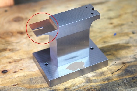

Building a steady anvil. I kinda understand what the design is for of traditional steady but not sure what the tongue is for or how it works. It kinda is throwing a wrench in the fan. Could someone take a picture of a demo of this unique projection so I can understand its' significance please.
Gary
whitebuffalo58
Posts: 2743
Re: steady question
Post by whitebuffalo58 »
For me, it's most common use is for peening handle pins without disassembling the knife. Slide the blade well over that end to backup the pin. The slot comes in handy for driving out pins and for driving new pins in just beyond the inside of the liner before peening. I almost always fully disassemble a knife, so it maybe has less use for me then other folks. But it's a handy feature at times.
WB

Thanks WB, if you were just building new slip joints from scratch lets say...would there be any use for this tongue please?
Gary
whitebuffalo58
Posts: 2743
Re: steady question
For me, no. A stiddy's best suited for repair work.
But, others opinions and/or methods may vary.
WB

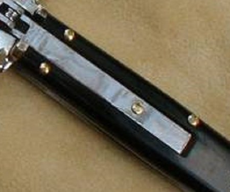

Thanks muskrat. Very interesting how those pins get riveted blind on the backside when slid over the tongue.
I can see this projection will need to be secure if I keep it as an attachment.
Also peening the heads with a cross hammer was interesting to see.
Good job and will be thinking more for the final design.
Gary

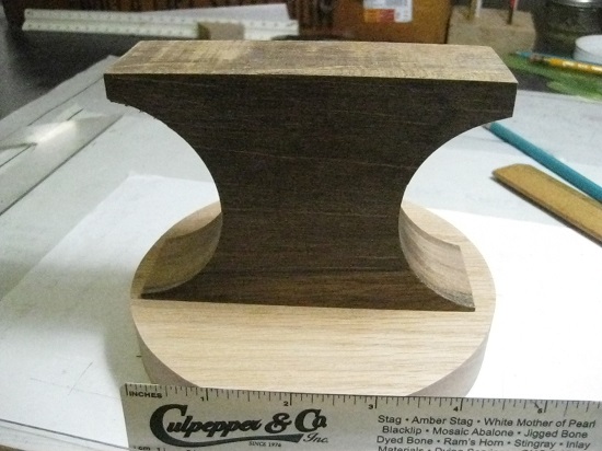

Stiddy wooden prototype ..trying to get it right before working with steel. Looks like D-2 will be the choice. Shout out to all of you that gave me info. Tongue will be an attachment at this time.
Gary

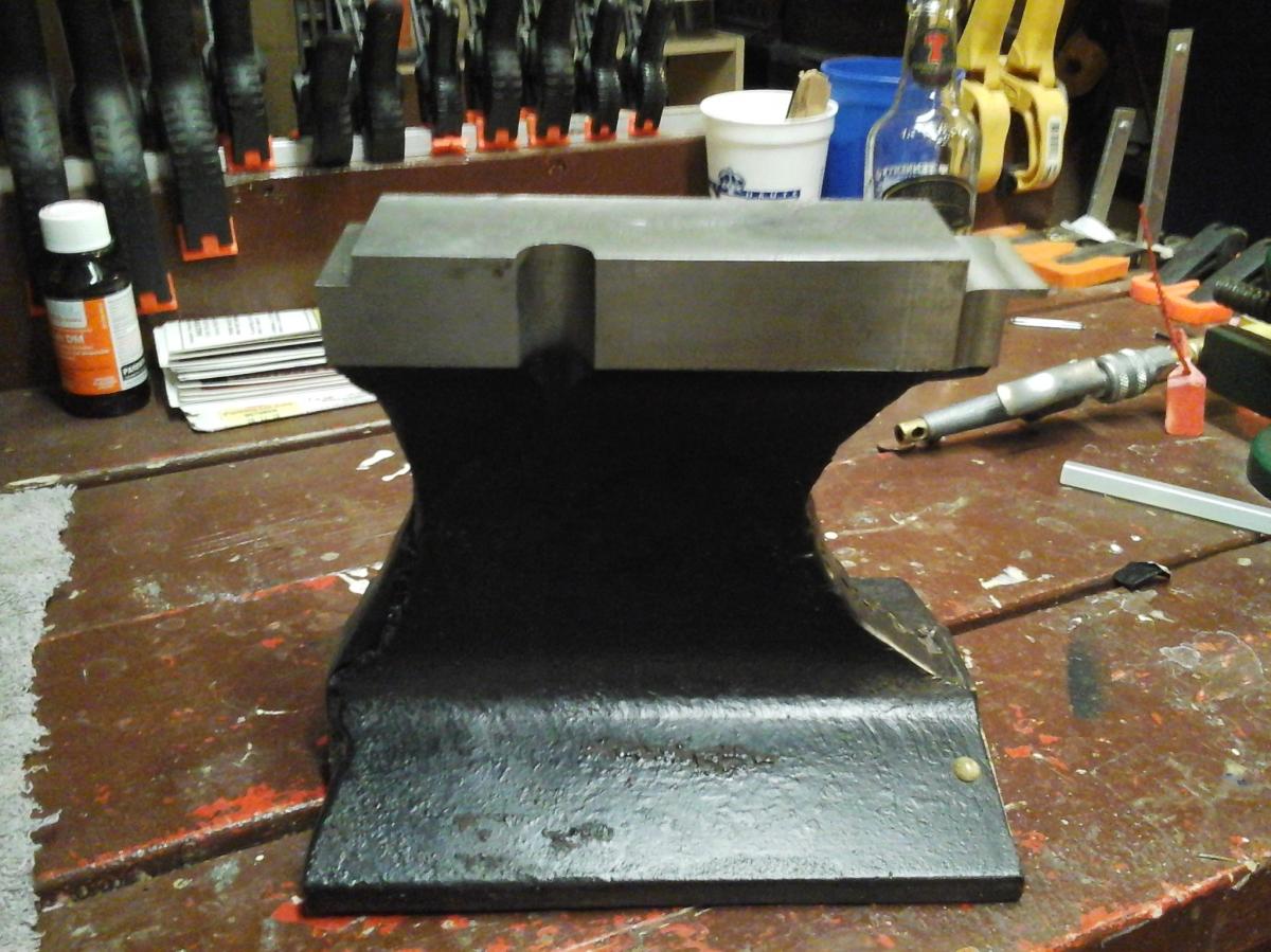

I have an idea to modify a prybar nail puller -needs to be thinned and slot widened a bit and holes drilled so it could be attached to milled-flat and tapped, or just welded, onto a piece of railroad tie....have not gotten to it, yet. That'd be a big project with the handtools I have. I'm holding out to buy a stiddy from one of the mechanics when it becomes available
edge213
Posts: 8487
Re: steady question
Post by edge213 »
A friend made this from a RR rail.

edge213
Posts: 8487
Re: steady question
Post by edge213 »
Bill DeShivs wrote:On used rail a simple annealing would alleviate any hardness problem. It would need to be heat treated after it's finished. I have one that I made from rail.
Yes Bill, this one was heat treated. But not rockwell tested. I think he used torch and oil quench. Not really sure.
