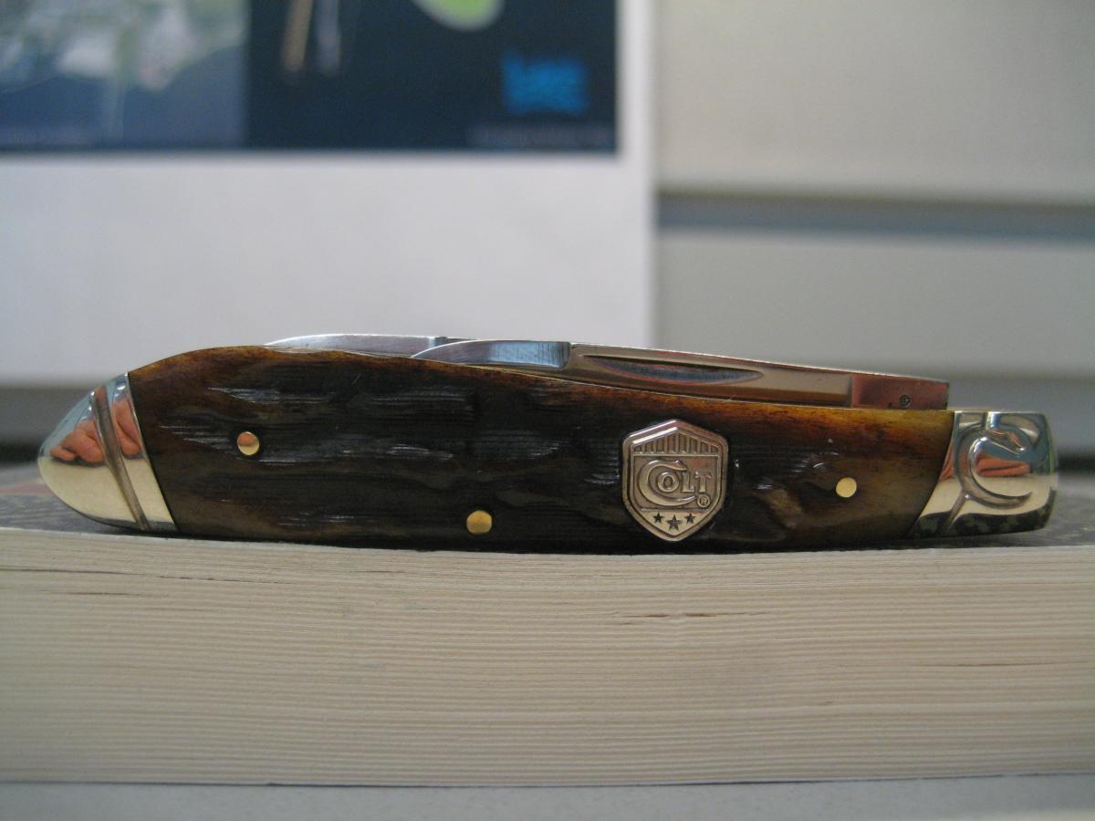

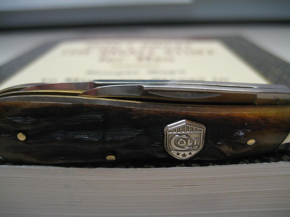

I ordered a number of knives from Smokey Mountain Knife Works, some of which were going to be gifts for some of my ‘non knife collecting’ friends. The Colt Peanut looked like a pretty knife to me. When I received it I was really disappointed because the main blade sits way too low when the knife is closed…you can’t get at the long pull without opening the small blade first (pics below). So I sent SMKW a memo…
Good day, I received my order from SMKW yesterday. Thank you very much, it arrived sooner than I thought as I live in Canada. Generally I am very happy however there is an unfortunate defect on one of the knives that affects the ability to open it.
The knife is the CT214, Colt Teardrop Peanut with Brown Stag Handles. The main blade cannot be opened unless you open the small blade first because the main blade sits lower than the small blade (when closed). I have tried to capture the problem with photos...the first photo shows it well.

I couldn’t be bothered with this so I took out my dremmel and ground the tang on the small blade to see if I could get it to sit lower…no good. I then ground a nail nick on other side of the master blade. Crude, but it worked, so I took it outside and used it to cut off a whole whack of thick ivy vines that were growing up my fence, and other yard work. This was somewhat unsuccessful. I dropped it a few times on my patio to see if I could age it a bit as well.
Moral of the story…don’t buy a Colt Peanut, and if you do, never use it to cut vines, or do garden work. Sheesh…I know, I know...you told me so.

Lawrence, take a little sliver of hard cardboard or a piece of wood just the right thickness to raise the blade to where you can get at the pull without the tip being above the liners, and place it under the kick of the master blade, it should fit tight enough so it will not fall out but not too tight to interfere with the blade movement.
If this works for you at least you can get some use out of it :wink:
