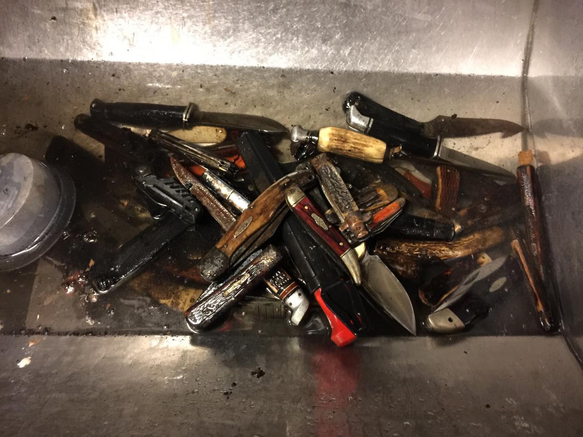

Hey guys, unfortunately we had a house fire on Tuesday and the vast majority of my collection is damaged or destroyed. What I'm trying to decide is if it's even worth the rescue effort for restoring these knives?
I have a few knives that mean a lot to me and hold sentimental value and I'd hate to just throw them out. If it's not completely burnt it's damaged from water or smoke. How do I go about cleaning them up? Soap and hot water?
These are all knives I use for edc, will the temper of the steel be affected? It's almost all 1095 carbon. I appreciate any and all techniques and tips for fixing them up.
Thanks guys!!!

I'm sorry to hear about the fire. I know that's a rough thing to deal with.
The impact on the temper of your knives will depend on how hot they got during the fire. The only way to tell that for sure will be to use them. Smoke tends to be acidic and will cause corrosion and pitting on most metal surfaces. The longer it remains on the metal, the more it will impact the steel. Clean each knife in warm soapy water then dry thoroughly and used some WD 40 to help disperse any remaining moisture.

Thanks Phil, I'll get on that today.
I wasn't sure if I could tell just by looking at the blades.
I was able to find my favorite hunting knife that has been missing for years. It was in perfect shape and was as sharp as can be. It's been in my pocket nonstop since our reunion!

Thank God everyone is OK. Phil's idea sound good to me especially if the knives are non stainless and got doused with water. Same process for the stainless ones too.

I have cleaned up knives that had some smoke damage to them. They did not get too hot, but did have a smoky deposit on them. I tried a lot of cleaners and polishes on them, but the best I found was Walker Wax. If you will PM me your mailing address, I will send you a jar Monday,(no cost)
You will have to use some elbow grease with it and maybe multiple applications, but I found it worked better than anything else.

Caleb -- So sorry to hear of your misfortune. Nature's big three, fire, water and wind. You were hit with a double whammy. I'd like to suggest you take a look at the knives with synthetic handles. If it didn't get hot enough to melt those, then it didn't get hot enough to damage the temper in the blades. It looks like an insurmountable nasty mess right now but as a two time flood victim I can tell you, this too shall pass. You have a lot of hard work in store for you. I don't know why bad things happen to good people but I send my best to you and your family.
Edit: While you're waiting for Dale's generous gift to arrive, may I suggest you try a regime of soapy water and scrub brush followed by a liberal dousing of WD-40 to chase the rinse water and some Mother's Mag & Aluminum Polish to see if that will bring them back to life.
Please let us know how you're getting along and what works and what doesn't work. There's no substitute for experience in a case like this. (yours or that of someone else)

Regarding your knives, I do not see that the handle material is damaged by heat, though it is hard to tell from the photos. I do not think that the temper of the steel will be affected if the heat was not intense enough to scorch the bone or wood, or melt synthetics. So I am thinking that a good cleaning and you are good to go!

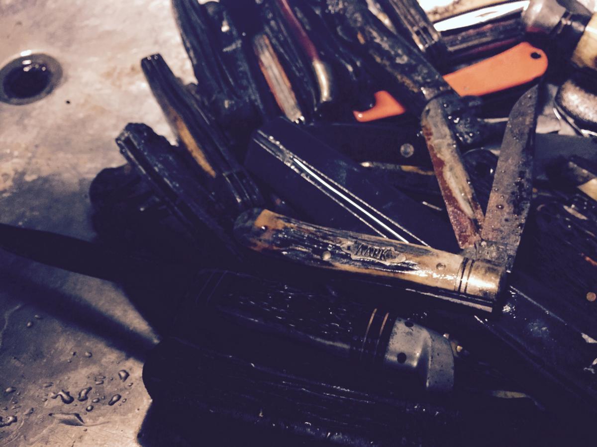

Unfortunately some of the delrin, micarta and carbon fiber is melted or distorted. The stag and bone also show some signs of heat damage. These knives may be a total loss as far as ever being able to use them again, but if I can get them to where they aren't decomposing I'll be happy!

Caleb, really glad no one was hurt. As Jerry said ,if the synthetic handles didn't melt,it should not have damaged the steel.

Kaleb, I will work with the knives tomorrow and see how much head way I can make. I'm hoping there isn't a problem with the pull but they are pretty coated in dirt and grime right now.
