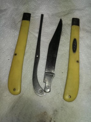

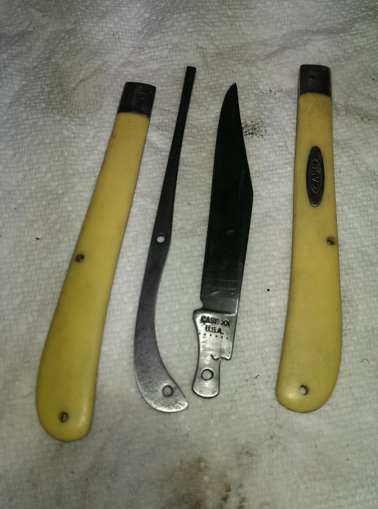

My first project. Old Slimline from eBay last year with a wobbly blade. This slimline has no handle pins, I think it was made by Camillus.... I will put 2 handle pins in per side since they are loose on the bolster end. Would 3/32" be ok, or should I go with 1/16"?
Thanks if anyone comments, it would help. I will post the finished pics when the pins come in.

3/16" pins is about the size of the rocker pin, so it would look strange.
I always use 1/16" brass or nickel silver pins for handles. When I can hind them I use even smaller pins on smaller knives. A size that works well for me on small knives are .054" brass pins.

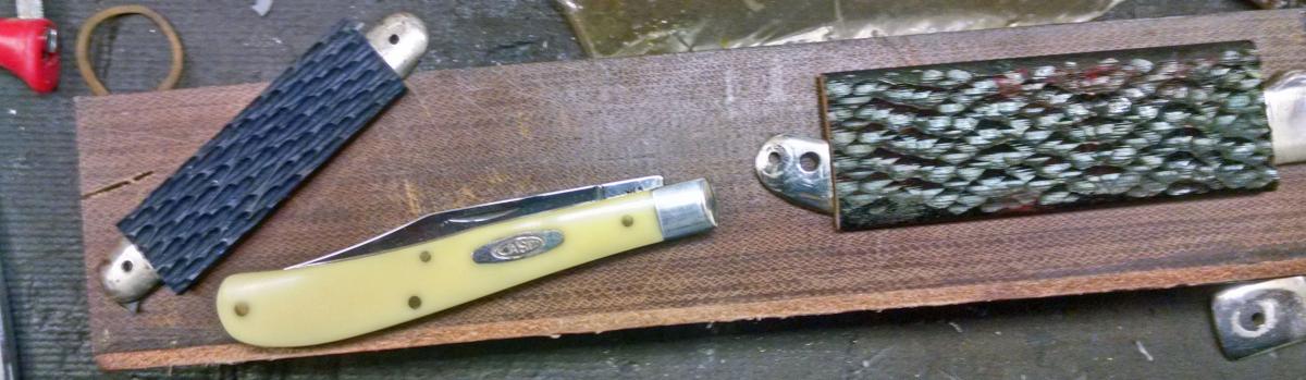

Here is a Case slim trapper on my bench waiting for a makeover. Note that it has a rocker pin, tail pin and two handle pins. I bought this knife about 4 or 5 years ago, NIB.

Dale I hope when I'm done it looks as good as yours waiting there for the makeover!

Here is something I'll post that was shown to me by the knife repairman in KY. Carrying a lot of different sizes of pin stock is expensive and it is impossible to have exactly what you need at certain times. Also turning down a pin is not an exact science and many times the pin ends up tapered and that isn't good. The most important tool in your shop is a 5/0 straight flute pin reamer. This is about .072 at the bottom and .096 at the top. I basically only use 3 sizes of pin stock the 2 mm .080 and the .092. Then the 1/16 - .062 to put the handles on the liners with. When you are doing a restoration project put the pin reamer in the hole you're working with then use the micrometers to check the diameter. Use the pin reamer in the drill press to enlarge the hole to either .080 or .092 going slightly larger than the pin stock. So for .080 pin stock ream the hole to abt. .084. This works every time. Eliminates the need for mass inventory of pin stock. You won't be able to tell the difference with the naked eye when you're done. I think the bolster hole in the Case 6318 is abt. 091 if you ream that to .094 your .092 pin stock will slide right in and work great. Here is a link I found with the pin reamers. Important to remember you get what you pay for. Many of these on ebay made in China don't last a week. The one I have now came from Granger and I've been using it 6 months. Also I only use ATF for cutting fluid. I know they make a lot of expensive stuff to do the job but this seems to work great and is cheap (like me)
