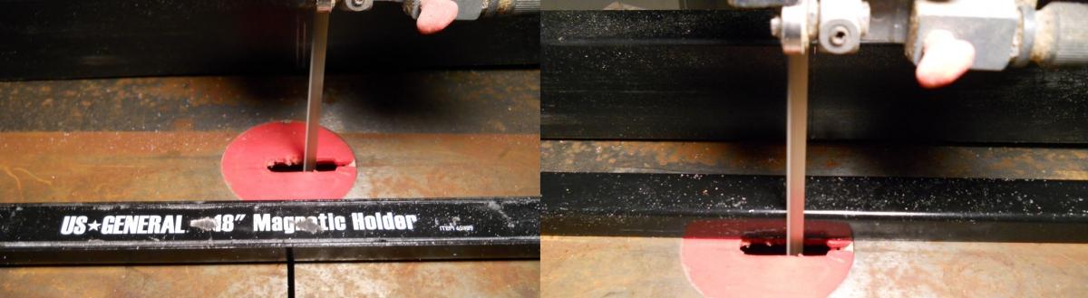

I have finally continued to upgrade and have a band saw with a fence. In the past I have had to try and find something straight, dig out clamps, and put it on. The next time I went to use it I couldn't find it and had to start all over. The first picture shows a 18" magnetic strip like you hang tools on and you can get at Harbor Freight for $5. These have powerful magnets and all you need to is to measure some lines from your table front and turn it over, line it up. Probably won't be able to cut lumber with it but it is a great, no clamp, light duty fence.

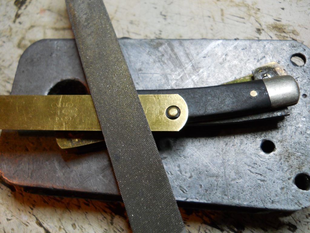

(2) I don't have enough hands to show how to do this but look at the other picture. Take a feeler gauge from a set of automotive type gauges. These are the kind that already have a hole in them. The .015 should work great. When you have the rocker pin in the knife and have the front side mushroomed and done push it all the way in and then you're ready to start on the backside of the pin. Put the hole in the feeler gauge over the pin and you have created a guard against getting file marks in the handle material while you are working the pin down to length. The person that showed me this trick said he takes them down to .015 and spreads them after that. Mine are a bit longer. I have used this same method and taken a knife to the Scotch Brite wheel on the bench grinder and worked the pin down that way. This keeps the wheel from digging into the handle material as well.

It seems I am not a creative thinker, and always have to do things the "hard way". I do the same thing on the saw with a pice of wood and a clamps. I'll have to check to see if my table is steel and will attract a magnet.
I do like the feeler gauge idea also, now why didn't I think of that.

I usually spin my pins so I there are not many times I would use the feeler gauge trick, but it is good know for those knives where I don't want a spun rocker pin.
