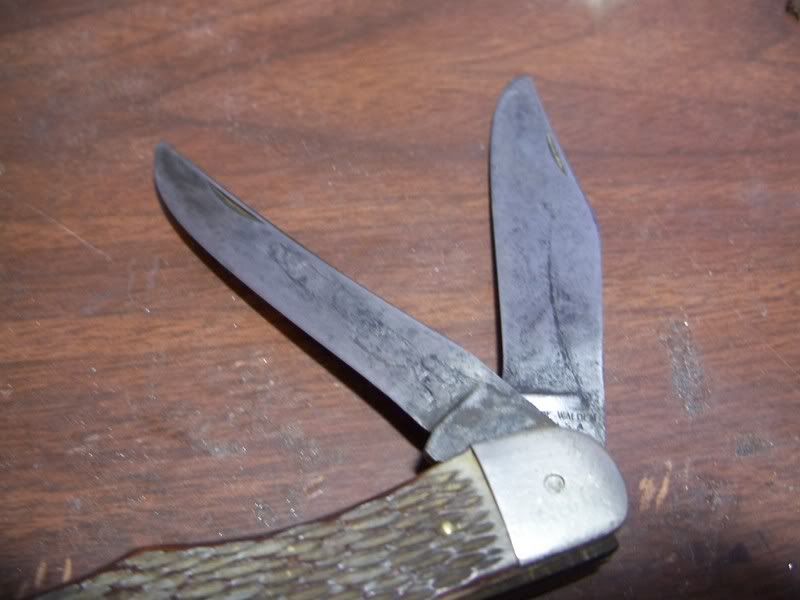

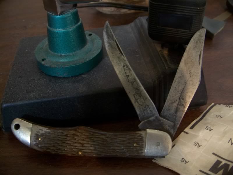

as it was from the yard sale:
water had layed on the blades for a while

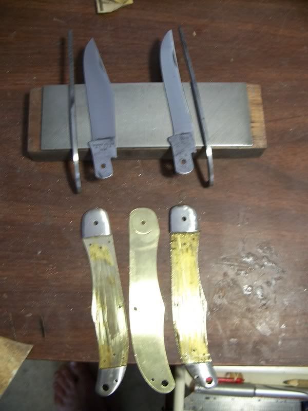

Some sanding to show just how deep they were (the blade had been tipped and reshaped, I trued up the repair to make it presentable)
everything cleaned and ready to be reassembled

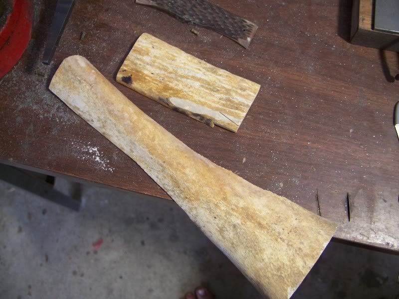

the leg bone after I had cut on it a bit

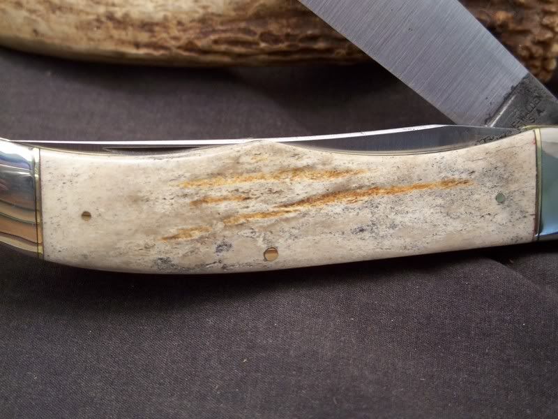

I ended up measuring wrong and cut each handle too short ::dang:: so I improvised and did some brass spacers, worked like a charm ::tu::
finished product

Wonderful restoration Kaleb! ::tu:: That was a dolla well spent hey?

Wow! What a difference. Who would have thought the beast would become a beauty? Very nice work.

Hey mm - any model no. markings on that Schrade? - looks like the big bro to my 1250 - the 2 bladed hunter.
A man's best friend is his knife, not his dog.
orvet
Posts: 19542
Post by orvet »
chuckwagon wrote:Hey mm - any model no. markings on that Schrade? - looks like the big bro to my 1250 - the 2 bladed hunter.
It looks like a 225H. The "H" designated the lanyard hole in the rear bolster. This is the 2 blades Open Stock predecessor to the 225OT.

Dang MM, you've got me stoked now! I have a mint 125OT, but I'm not real crazy about the plastic, resawn looking handles on it. I know where there's an old elk carcass hanging in some brush up on the side of the mountain behind where we live, so in the next few days, I'm going to make a trip on the ATV and see if I can find it and decern if there's anything big enough to do exactly what you did as far as rehandling your Schrade. Thank goodness I don't have to completely disassemble it, or it would be out of the question....but I think I could handle a rehandle job. If it looks even 10% as good as your finished product, I'll be more than pleased. ::nod::
A great looking job you did. I'm amazed and quite envious of your work. The little brass "shims" on each end are sweet! ::tu::
