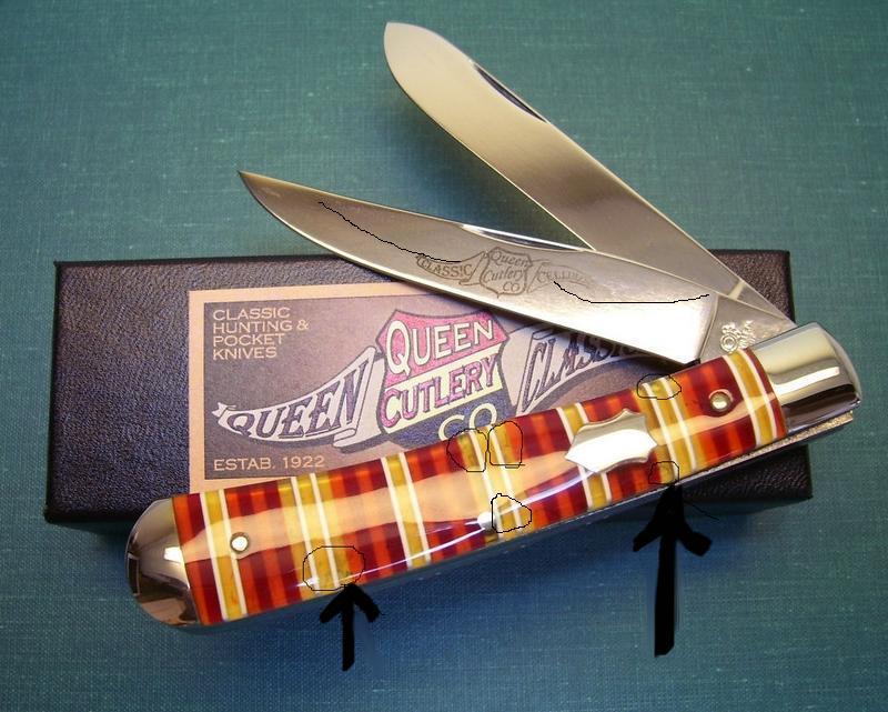

Just for discussion,
Here is a Queen Candy Stripe Celluloid. I've highlighted what look to be "fractures" in the celluloid. It has gassed the exposed part of the blades and the backsprings (at the arrows).
Just as information.
It is unfortunate, bescause it still is a fine looking knife.
Bill
Bill
