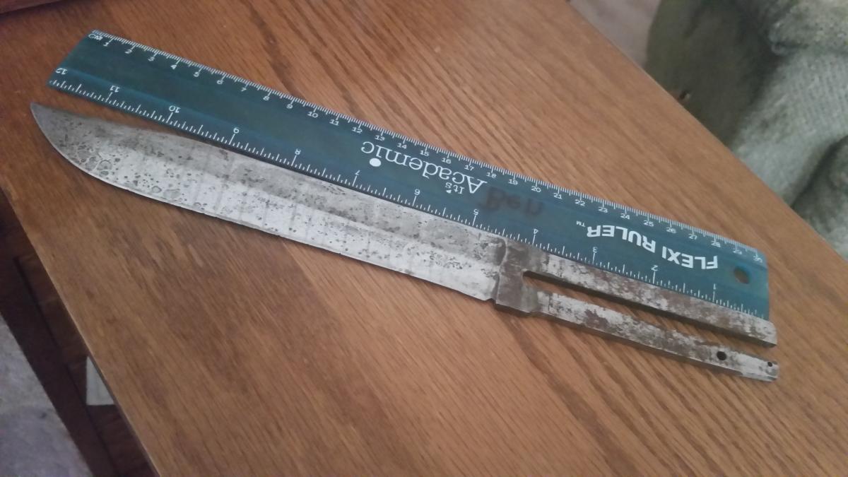

Curious on how this knife could best be made usable again. I picked it up quite a while back with plans to do something with it eventually. The handle part has been ground on some and I think some of it may be missing. This is a bigger knife than I typically go for but it is a pretty nice blade. Well at least it could be again with some work.
I am just looking for some opinions. To be honest I am not sure it would be a job for me yet as I don't have all the tools and experience needed.

Ben, welcome to the forum.
That knife looks like it has possibilities. Is the pommel end cut off?
Some one around here should be able to make it right. Maybe ............
Got any other knives?

FRJ wrote:Ben, welcome to the forum.
It looks like the pommel end was ground on so it may have been cut off. I am not sure what these typically look like on the inside.

I'm not familiar with them either without the handle.
TripleF (Scott) was rebuilding one a while back.
He might chime in.
He might chime in.

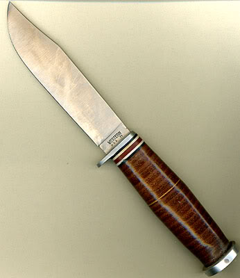

Your knife probably originally had a stacked leather handle.
It is missing the guard and butt of the handle.
The small hole was where a pin held everything together.
Something like these knives.
"Handle more like bottom picture"
JW~

That knife has what is called a "bifricated" tang and was made that way from the factory.
Like others have said, it probably was stacked leather.
A site search of "bifricated" may turn up some info on the knife...

Welcome to AAPK. Glad to have you aboard. The old Westerns are well worth the effort to get them on the road again. They're good knives, not high value but good users.
There's a fella that sells repair kits on eBay for the Westerns with the bifurcated tangs. He sells just the leather washers or just the spacers or the pommel.
This is what he currently has up for sale. http://www.ebay.com/sch/sharpshootershe ... 7675.l2562

You can use those from ebay to complete it.
I am not sure the tang has been shortened.
Is there a model number on the tang?
If you can find a model number we can probably find a picture of what the knife looked like originally.
Of course with a blank blade you can always be creative and make a customized knife.
It is a nice looking blade and Western's carbon steel was second to none, which is one of the reasons they are still so popular with hunters and outdoorsman.

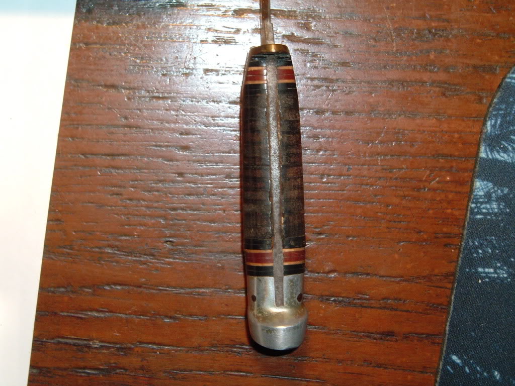

Usually those bifurcated tang knives had a hole for each side to attach the pommel to. The holes on the OP knife look different. I guess it wouldn't matter if there was enough handle to work with though.
You could do a slab style bowie mod on it, that would look cool!
Looks like a fun project either way...

After looking at the tang on the back I believe it is a L46-8. Its hard to make out all of the numbers on the knife. I did a Google search using Western 46 and the model I mentioned came up. It looks like the kit sold on Ebay may work. I may purchase it and some of the colored pieces as well.
Can anyone link me up to a video or tutorial on redoing a stacked leather handle? Thanks for the help guys

One thing worth noting here is I noticed that the handle part had been ground by someone along the edges as well. I saw a blade similar to mine with no handle on Ebay completed listings. It seemed to have more of a bulge on the sides of the handle. Mine are ground nearly flat or straight. This may make mine have a thinner or straighter handle with less of a bulge than an original. I will see if it is something I can live with. If not I may try to figure something else out.[/quote]
Some one may have ground the bifurcated frame thinner to accommodate a slab handle on each side.
Inletting the frame in the slabs and not showing the frame. Just a thought. Too bad they were ground.
I hope this is a success for you. Go for it.
