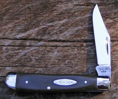

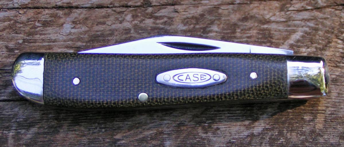

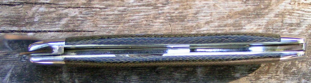

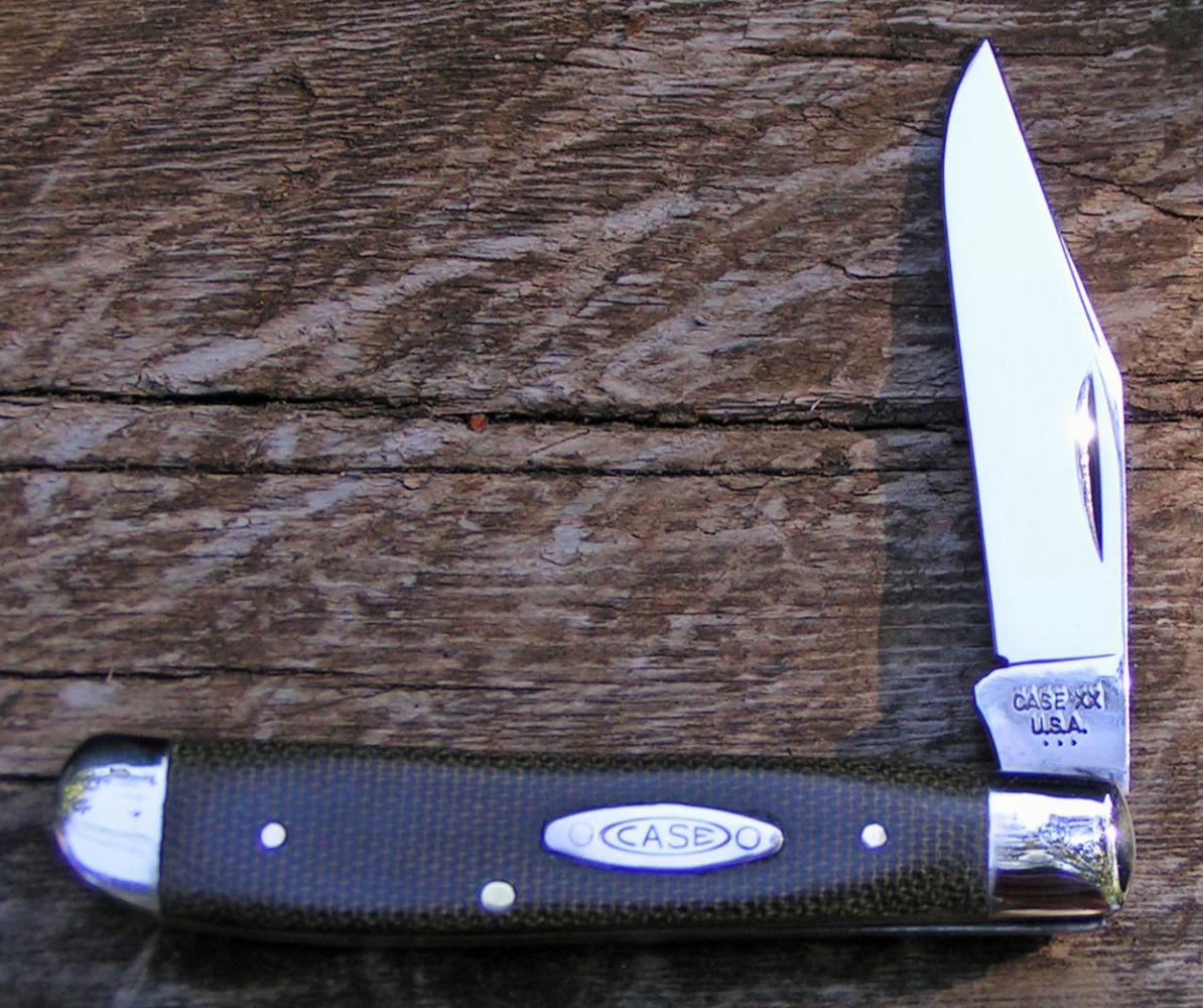

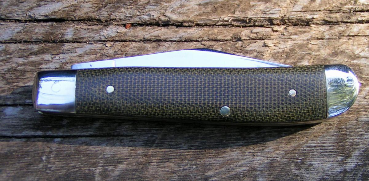

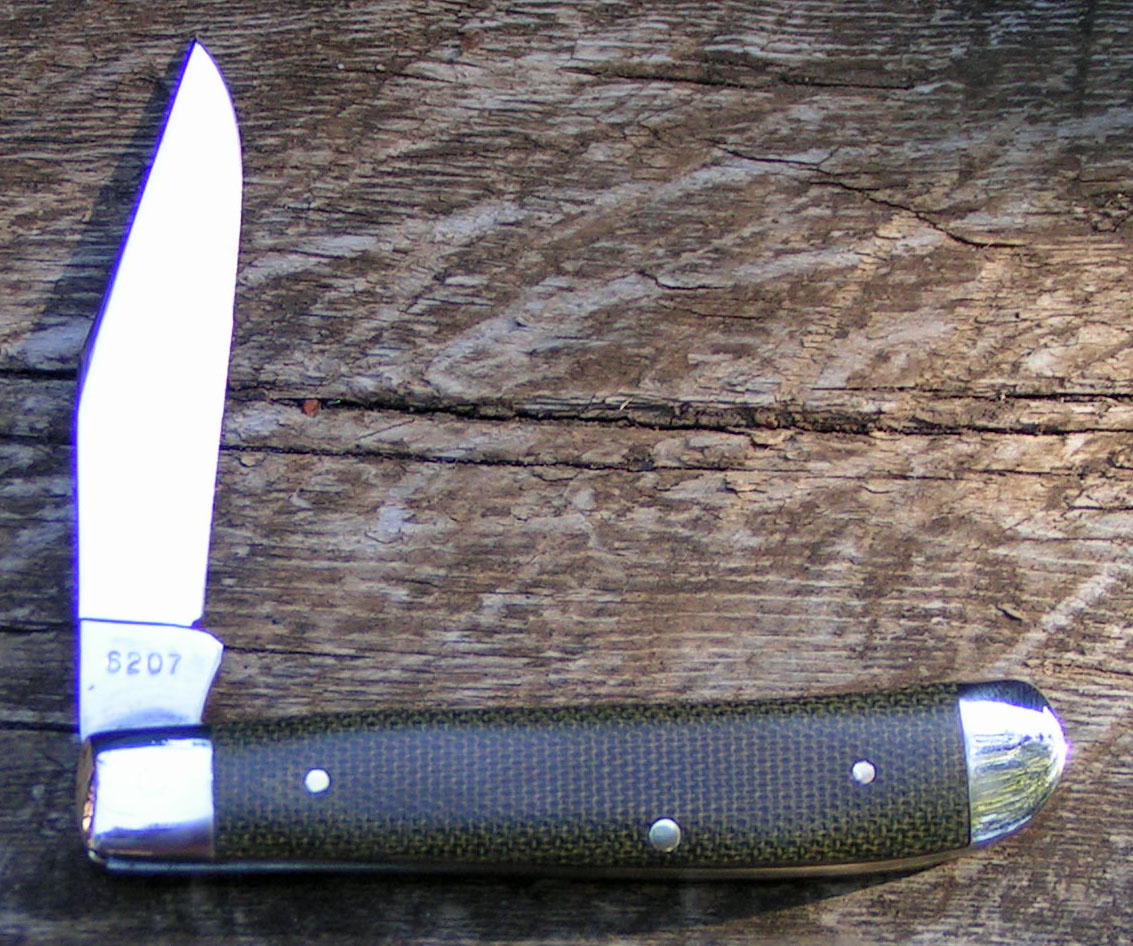

This is a knife I customized for a customer. It started as a Case 6207, Mini-Trapper, with bone handles.
My customer wanted a single blade with olive green linen micarta handles.
This was the first time I had inlet a shield in linen micarta, it was a pain and took several hours to get it right. The edges like to fray when you cut it with a Foredom burr, but I learned something so it will be easier & faster next time.
The finish was another problem to be solved; he did not want the micarta raw, nor did he want a glossy slick finish but something with a little grip. I did some experimenting and did a hand rubbed epoxy finish.
I was happy with the results and more importantly, so was my customer.

Very nice work dale, one question how did you get the frame to fit one blade? The knife started off with 2 blades right? Amazing work

0078 wrote:Very nice work dale, one question how did you get the frame to fit one blade? The knife started off with 2 blades right? Amazing work
It is really not difficult. You just cut the pins and remove the pin blade, pin blade spring and the center liner and reassemble it without them after putting on the new handles and inletting and pinning the shield.
