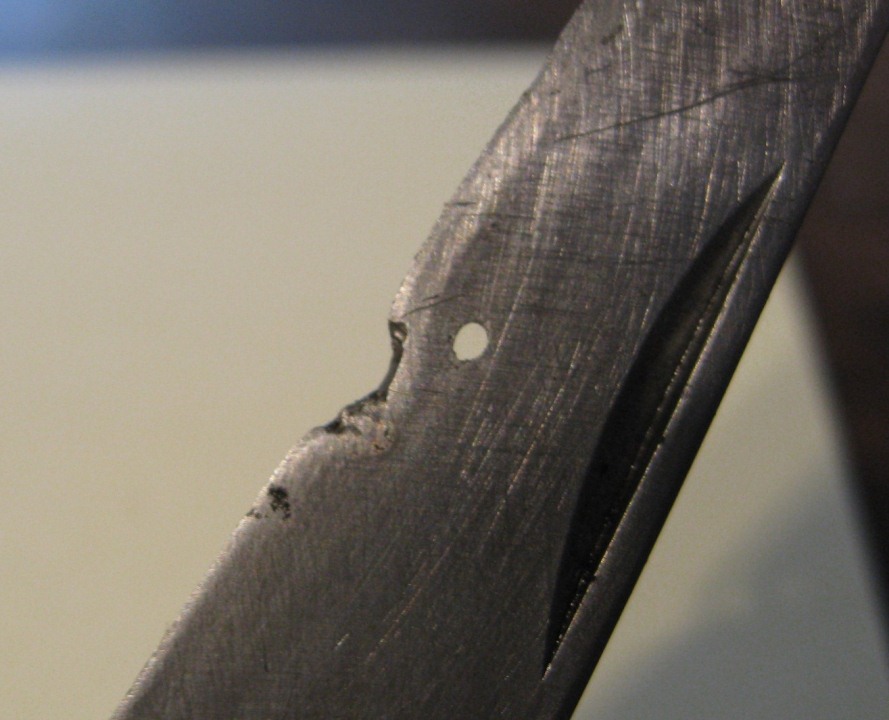

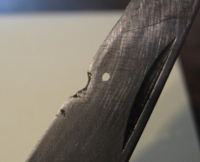

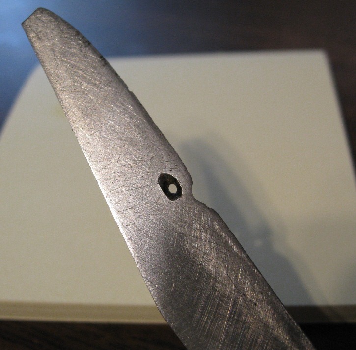

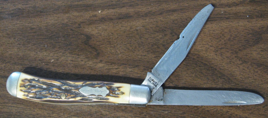

I got this Uncle Henry at the junk store for a buck. I figured I would try to fix the blade. Looks like some bone head grounded across a starter or something with it or something. (Tip gone and hole in the blade....LOL)
Anyway, do you repair guys know if carbon steel weld metal will fix the 2 bad spots on the blade? I have a wire welder and you can turn the heat down with small wire to where it won't totally blow up when you weld.
What do you think?

Short answer-
It would be far cheaper to find a knife with good blades and swap blades, or buy another used one on ebay. You should be able to get a decent user for $25-$30.
Both blades in that knife have been abused. The spey blade on that knife looks more like a worn down spear blade than a spey.
Long answer-
To the best of my knowledge; if you just want to fill the hole and clean it up and put it on display that would probably work but it won't work as a knife.
The crystalline structure of the blade is much different than the crystalline structure of the weld, as is the steel itself. Even if you could fill the hole & knick to make it look right with the same medal, you would need to heat treat the steel again to make it hold an edge.
There is an expensive process of laser welding where a new blade is welded onto a tang that has a broken blade to preserve the tang stamp. Heat treat is not an issue since this is usually only done high dollar antique knives to preserve a example of a brand & pattern that looks like the original. The knives are for display only, not users.

It will also be a simple one to replace if you can find another of the same pattern with tight blades.
Just remove the center pin (rocker pin) and give the bolsters a tweak and the knife will pretty much fall apart. Clean up the insides and the new blades and reassemble with the Swinden keys in the proper keyways. Then compress the springs to get the rocker pin back in place. Peen the rocker pin and you are all done except for any polishing you wish to do. ::tu::

The "new" UH blades are much thinner then the U.S. counterparts. China made and pretty much worthless in my book.
You might consider removing the bad blade and rebuilding it as a single blade using just the spey. You'll have to drill out the pin holes, but it'll make a fine slimline trapper for totin'. I think there's a tutorial on drilling out the swinden keyed knives in the mechanics forums.
