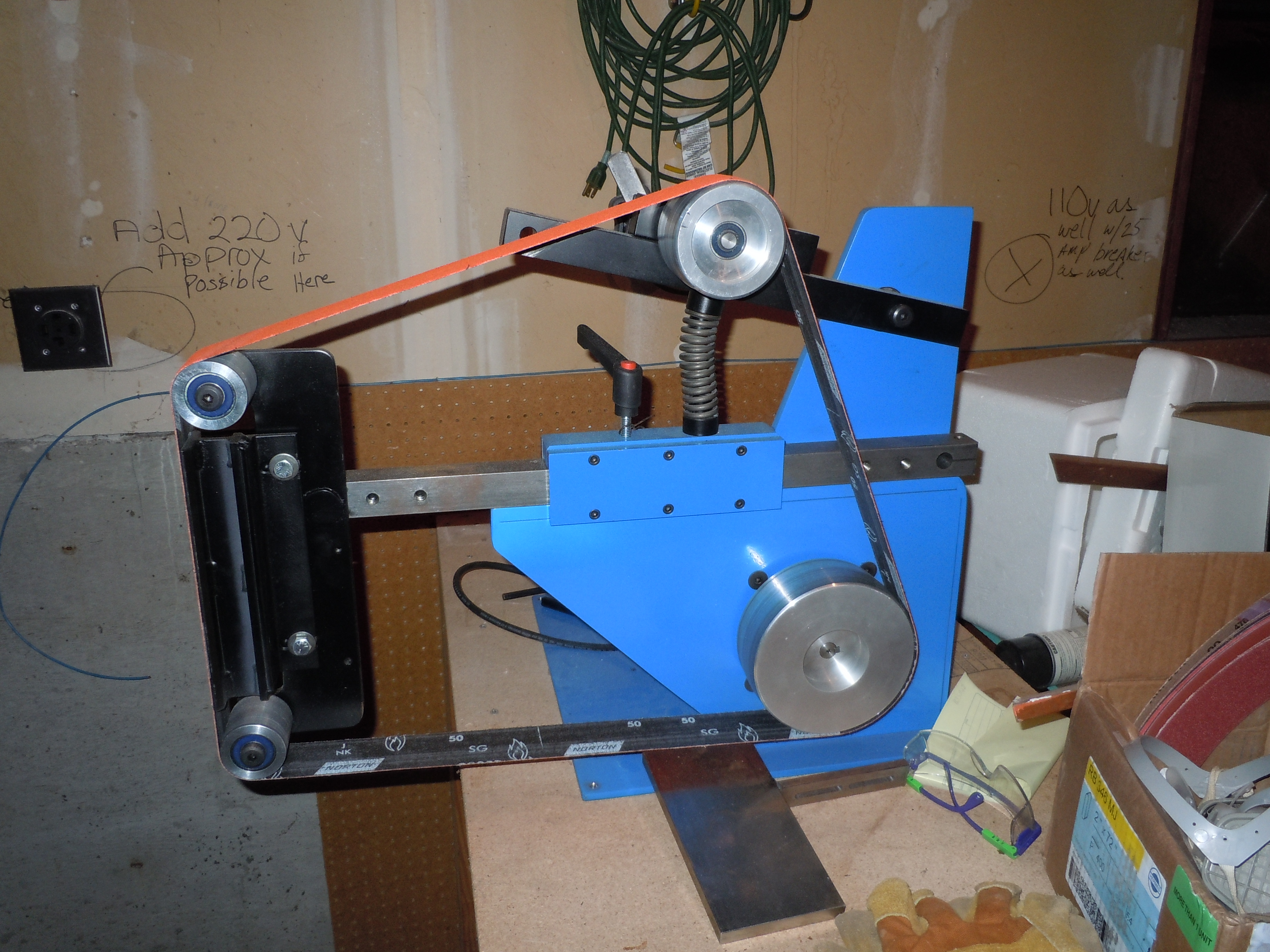

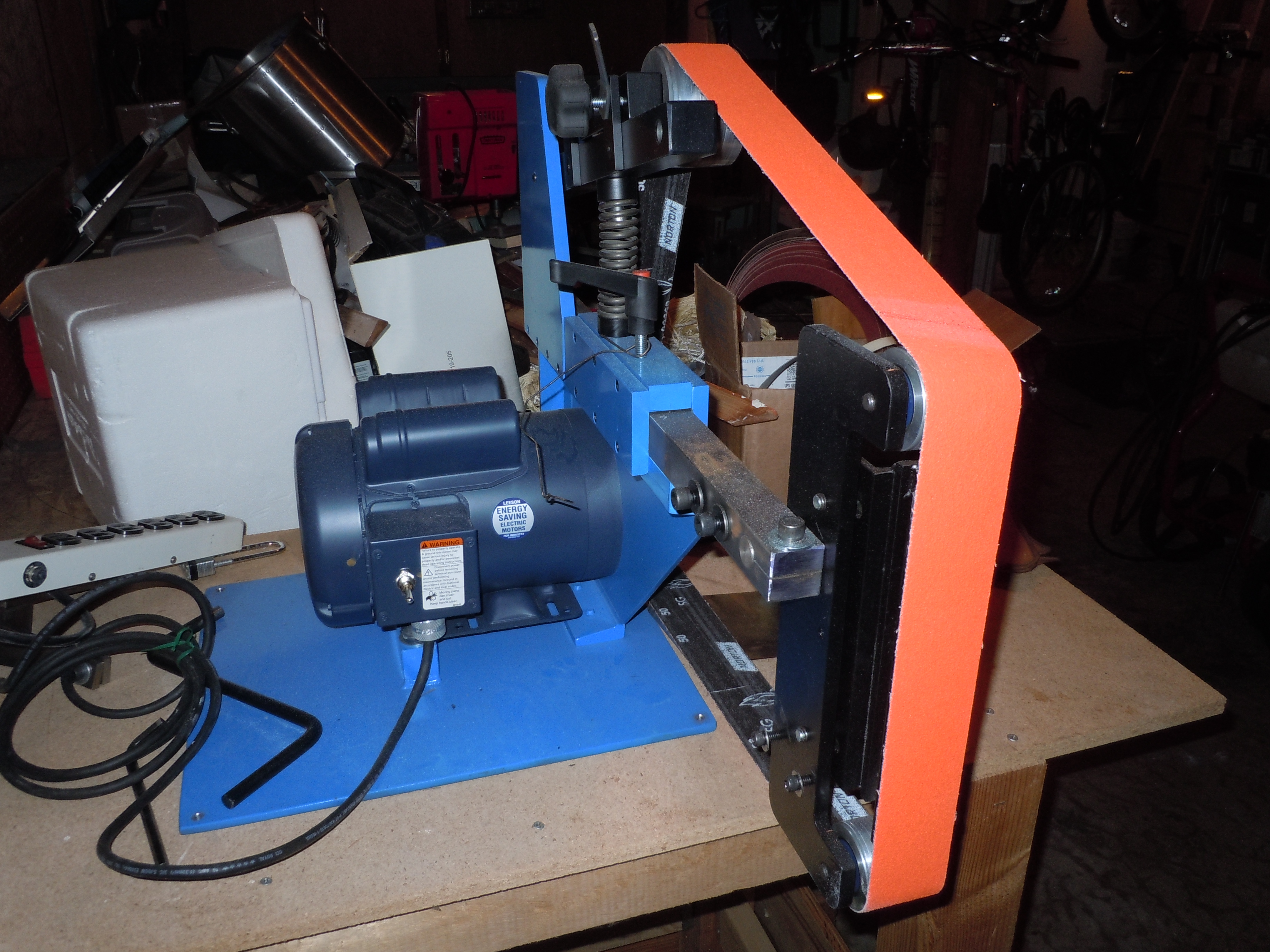

Sold my Ruana and got my first grinder at the OKCS. It is made in Washington state and a custom knife-maker I know highly recommended I get a variable speed version of this grinder. However, I couldn't swing it and got the single speed instead. Most expensive tool I have EVER paid for. Thirteen hundred dollars....I was nervous handing over the cash....lol
Brett Mathews makes this machine.

Looks like a heavy duty top rate machine. I'm sure it will give you many years of service. What kind of motor is on it?
