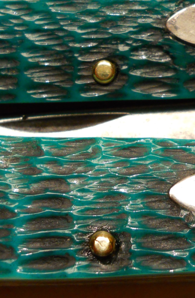

If you search this same forum for pin spinner you will find numerous posts on the subject. Orvet seems to have more experience on answering this. My 2 Cents worth is that while some make it sound easy to make these, that is not the case. In his book Adrian Harris says to use a 5/16" set screw for the spinner and then take a Dremel with a cutting disc and cut 6-8 slots at a 20 degree angle to create a cutting surface. I have tried this and have seen some other aborted attempts by others. Everyone will tell you the one from Jantz is junk but it does work. What I have found is that at first I was leaving the pin too long and it just wasn't coming out right. I have started to cut the pin down almost flush with the handle material and have been satisfied with the results. The guy in KY that does knife repair has modified the Jantz spinner and is getting great results. On my next visit down there I am going to take my spinner and let him modify it. He has a mill and is set up to do machine shop work so this kind of thing is old hat to him. Here is a pic of 2 pins that were spun with the Jantz pin spinner.
