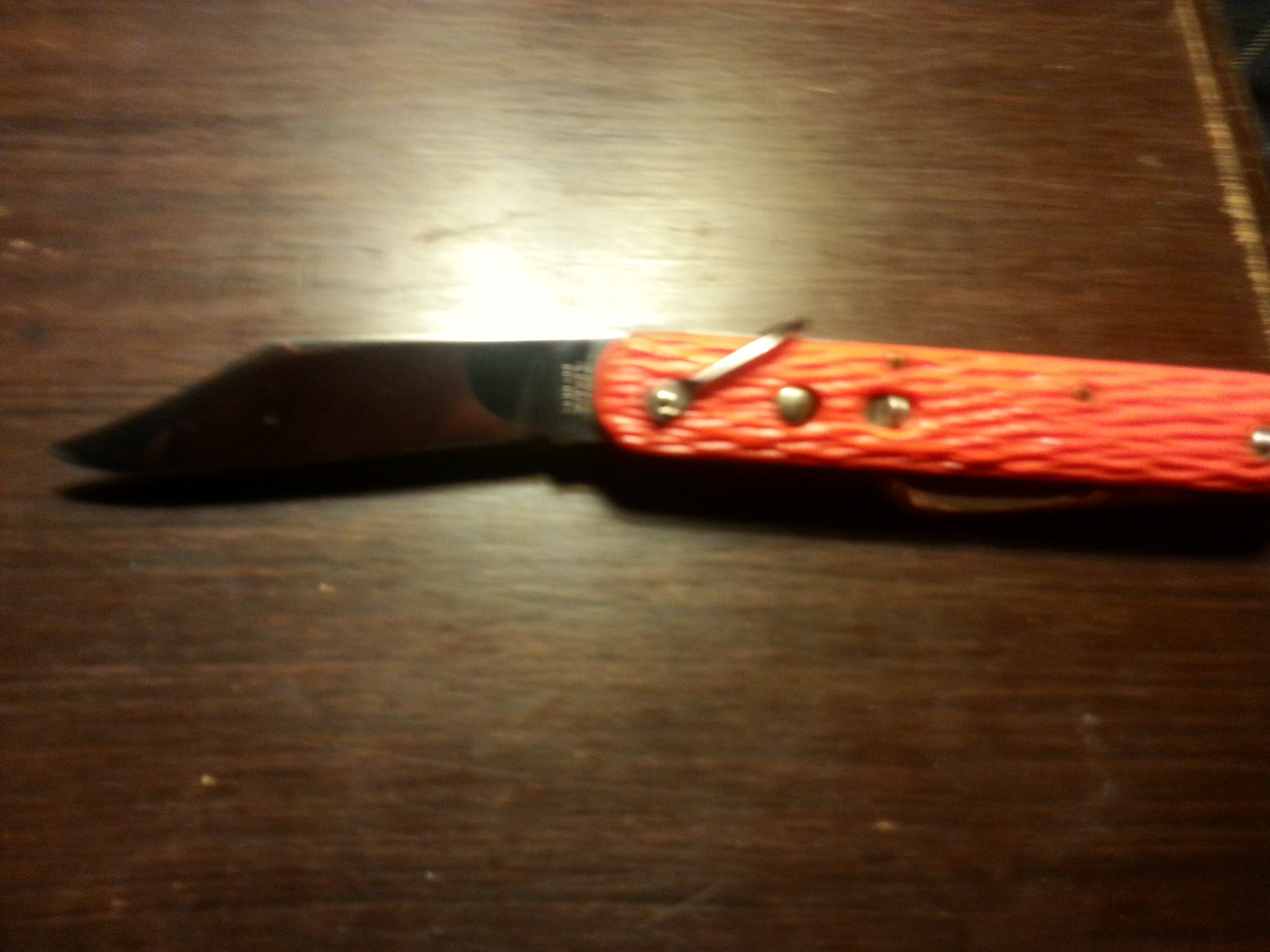

I have a schrade paratrooper switch orange handle it was fired and now the button popped up and the blade will not stay open or closed it was my fathers so i really would like to get it fixed any help woukd be great.

Re: need a fixing
Sorry, I'm having website problems. I hope to have it fixed tomorrow.
If your button "popped up", try just pushing it forward back into place.
If that doesn't work, my email is [email protected]

Thanks bill it worked closes and fires great but when open u could peobably close the blade without pushing the button so its not catching very good or is woen inside what do u think bill .very weak lockup blade has some movement

Re: need a fixing
Try flushing the blade tang out with lots of WD 40. If the slot in the blade is dirty, the sear will not seat well.

Re: need a fixing
Button slide back in and fires great now
