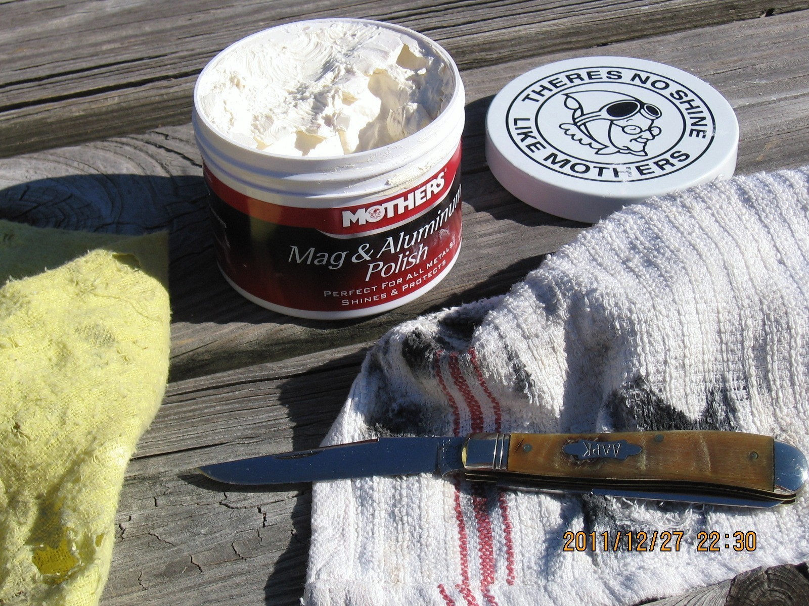

I polish off the etching on the GEC knives with ""mothers wheel polish""___rub & rub & rub,with a soft cloth,till you don't see it anymore at any angle***--good luck,Monk ::tu::

Monk it worked!! All that ink on the blade is gone.(lol) thanks for all the suggestions.

Just tried this on a Case knife that I have. Haven't used Mothers before, but it worked nicely. Thanks Monk!

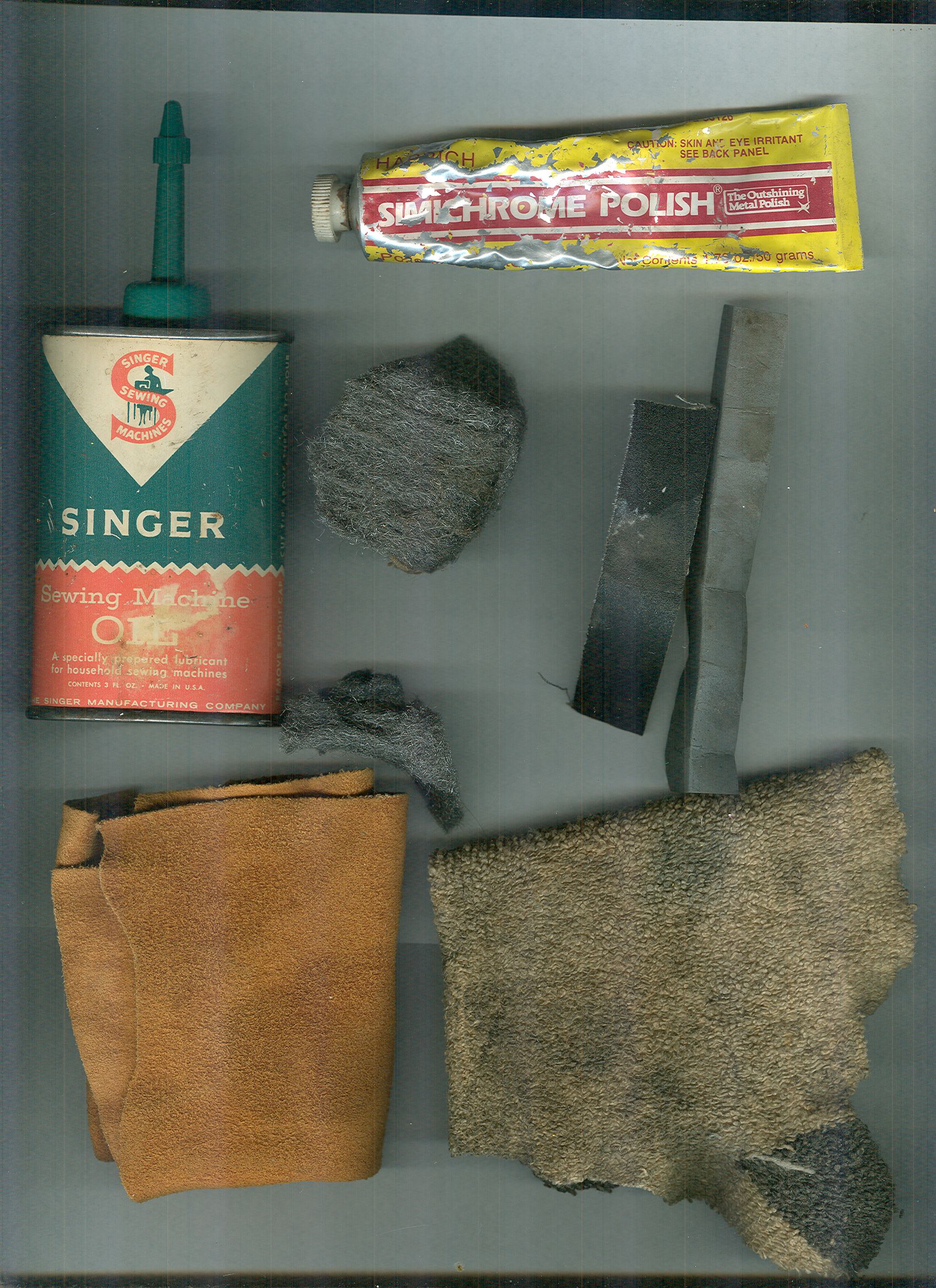

Here's an assortment of stuff I use to hand-clean a blade with etch on it. I didn't have a can of Liquid Wrench (the nut & bolt loosener) for the pic, but I'll use it to loosen up the rust at the onset of cleaning. I then work on the rusted areas with the choice of abrasives; steel wool and/or emery cloth or paper and with any of them, I lube them up with both oil and Simichrome before using, that way it will only cut the rust and not mark the blade. This doesn't work with ink stamps--they disappear. The other two items not pictured are elbow grease and patience; both are needed for this trick to work right.

ole_muddy wrote:Here's an assortment of stuff I use to hand-clean a blade with etch on it. I didn't have a can of Liquid Wrench (the nut & bolt loosener) for the pic, but I'll use it to loosen up the rust at the onset of cleaning. I then work on the rusted areas with the choice of abrasives; steel wool and/or emery cloth or paper and with any of them, I lube them up with both oil and Simichrome before using, that way it will only cut the rust and not mark the blade. This doesn't work with ink stamps--they disappear. The other two items not pictured are elbow grease and patience; both are needed for this trick to work right.
Eric
+1
Similar to my method. Yes, elbow grease and patience are often discounted but essential!

I''ve cleaned up a few old tarnished and rusted up knives that you couldn't tell was etched until after I used semichrome on them. ::tu::
