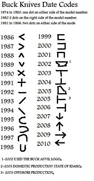

It is a c1980. There should be a date Mark on it, if you can take a pic of the tang stamp I can tell you for sure. All the 110 in those years have a date Mark,be it dots or a date mark.
This may help.
This may help.
- Attachments
- BuckDateCodesSmall-1.jpg (44.19 KiB) Viewed 8131 times

IMHO, it is better to date a 110 by the tang markings listed in knifetime’s post than by handle pins. It seems from the Data Sheet that the number handle pins only tells you when the knife was made in relation to 1974 and the changes made then.

Everything I have read you are right on Dale
I thought he meant to say DOTS to identify the year
where a three dot is 1980-81

Buck added an extra rivet to the rear end on the ebony inlay in 1974 to 1980 it should have dots. I'm no expert on Buck but if uou post a pic of the tang I could date the knife for you. Or give us some more information on the tang. Like,dose it say Buck 110,USA or just Buck,USA and is their dots on ether side of the 110,if so how many and where.
Look at the spring holder if it is stainless with no dots it is 1972 to 1974 but you say it has 3 pins so it should be latter.
I find that Buck is one of the easiest knives to date, do to good information kept by the factory and all the people that collect them.
Orvit is right, you should not count the rocker rivet.
