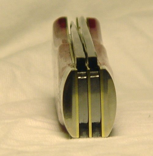

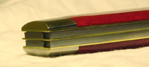

Here's a shot of the GEC tang end. The spring is set back VERY slightly (maybe 1/16 or 1/32" so that the tang is barely nestled between the liners when the blade is fully opened:
Great Eastern Northfield Red Bone End 3.jpg (34.88 KiB) Viewed 2896 times
Great Eastern Northfield Red Bone End 2.jpg (52.79 KiB) Viewed 2894 times
