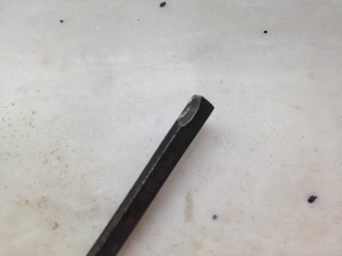

I absolutely love the shape, weight, feel and looks of this cattaraugus but there's just not much life left. I would love to carry and use this knife, just not sure where to start. The main blade is pretty worn and has little to zero snap. The secondary blade has plenty of snap but is in really rough shape. Is this a doable project for anyone?$?$ I'm afraid it's a bit above my skillset and may be above my $kill$et. Any input on replacement backspring or blades would be apriciated. I'd hate to lose (IMO) such a beauty.

I would wager someone here will be able to help you. I can understand your affection for that knife. It looks like a great one. I can't tell from the pic if the problem with the main blade is the blade tang or the spring. Either way it will require parts or custom work. It may not be worth the price.

This method would fix it if you think it would be worth the effort.....http://www.allaboutpocketknives.com/kni ... 37&t=23801

Anyone know what type of steel is used on these springs? I took it apart tonight and found the problem to be exactly was Elvis has described in his post. I'm also still looking for replacement blades, if anyone can help. If someone knows of a craftsman who could fabricate new blades, that would also be helpful.

It looks like the spring needs to be fabricated, did you see the part where bob welded a nipple on to the old spring of a case knife? If you fix that your snap should be back.

Yeah, I'm gonna have that done. That's why I was curious as to what type of steel it is. As far the blades, I'd like to replace them....if possible.

the blades look fine for a user to me, like said earlier that is where a lot of the character lies and there is still plenty of use left in the blades. weld in the spring divot(s), the tangs still look square from your pics. I can do it pretty reasonable, even more so if you just want to send the spring, I can weld, krink and send back to you to install or do with as you please or do it all. Just sayin.......

Don't forget to check the blade tang. In the post I referred you to, it showed the blade from that knife and how much of the tang had worn away. That part needs to be TIG welded too and ground back down to specs. As for the type of metal, all the welder cares about is whether it's carbon or stainless.
