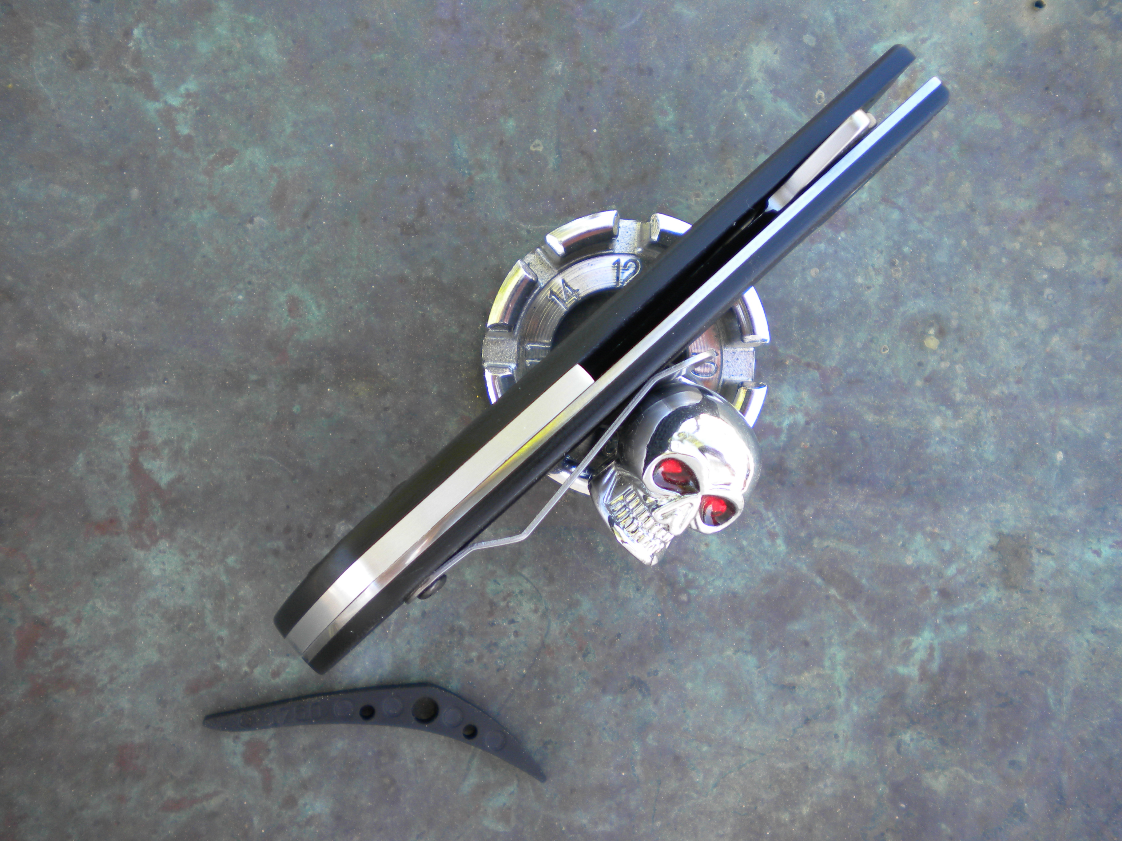

another garage fix/MOD err ever utcha call it?????????? :D
got this kershaw skyline from CK here at AAPK..........
had a plastic back bone/ spacer..........
made my own out of aluminum scrap i had i garage........

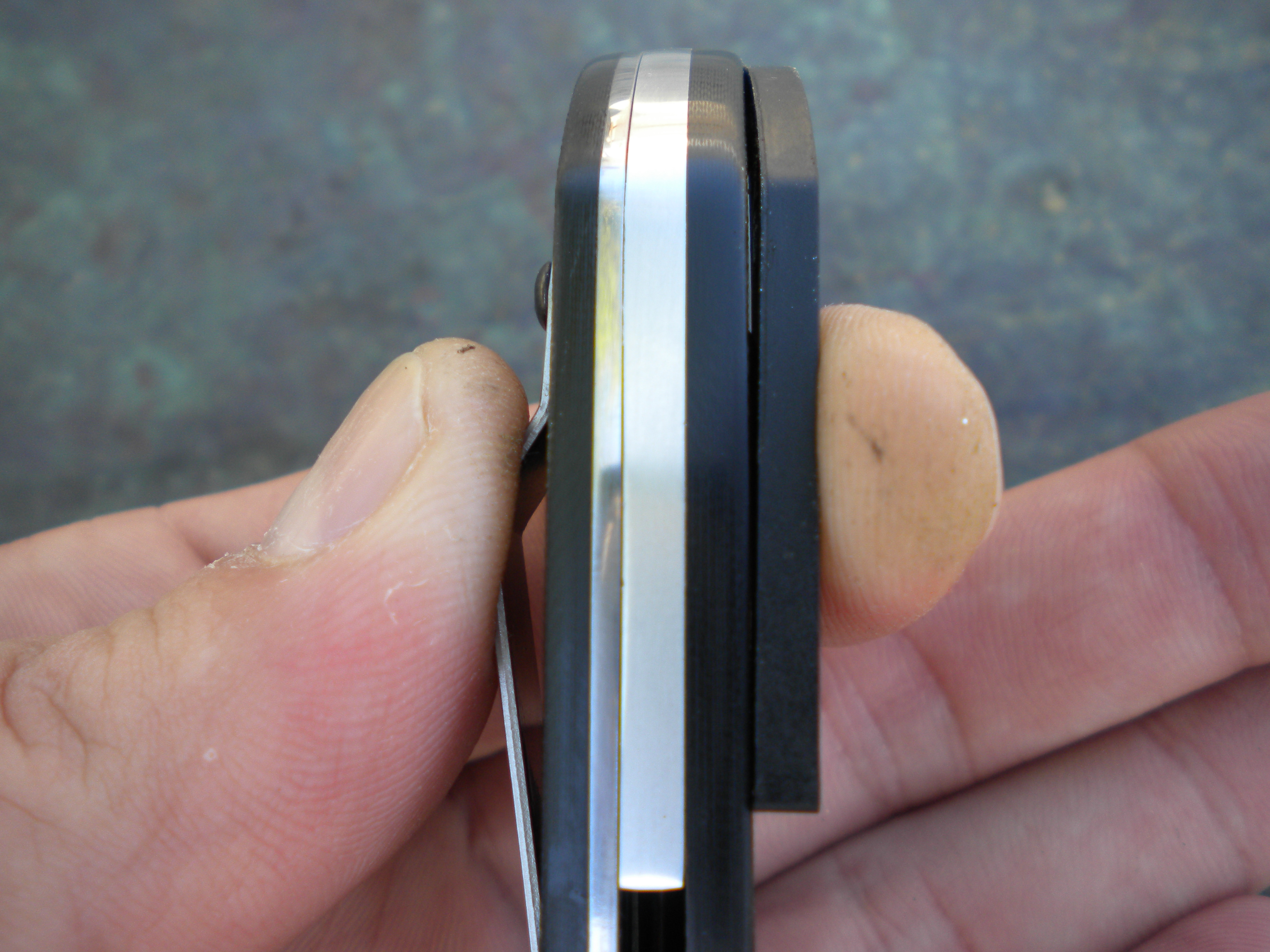

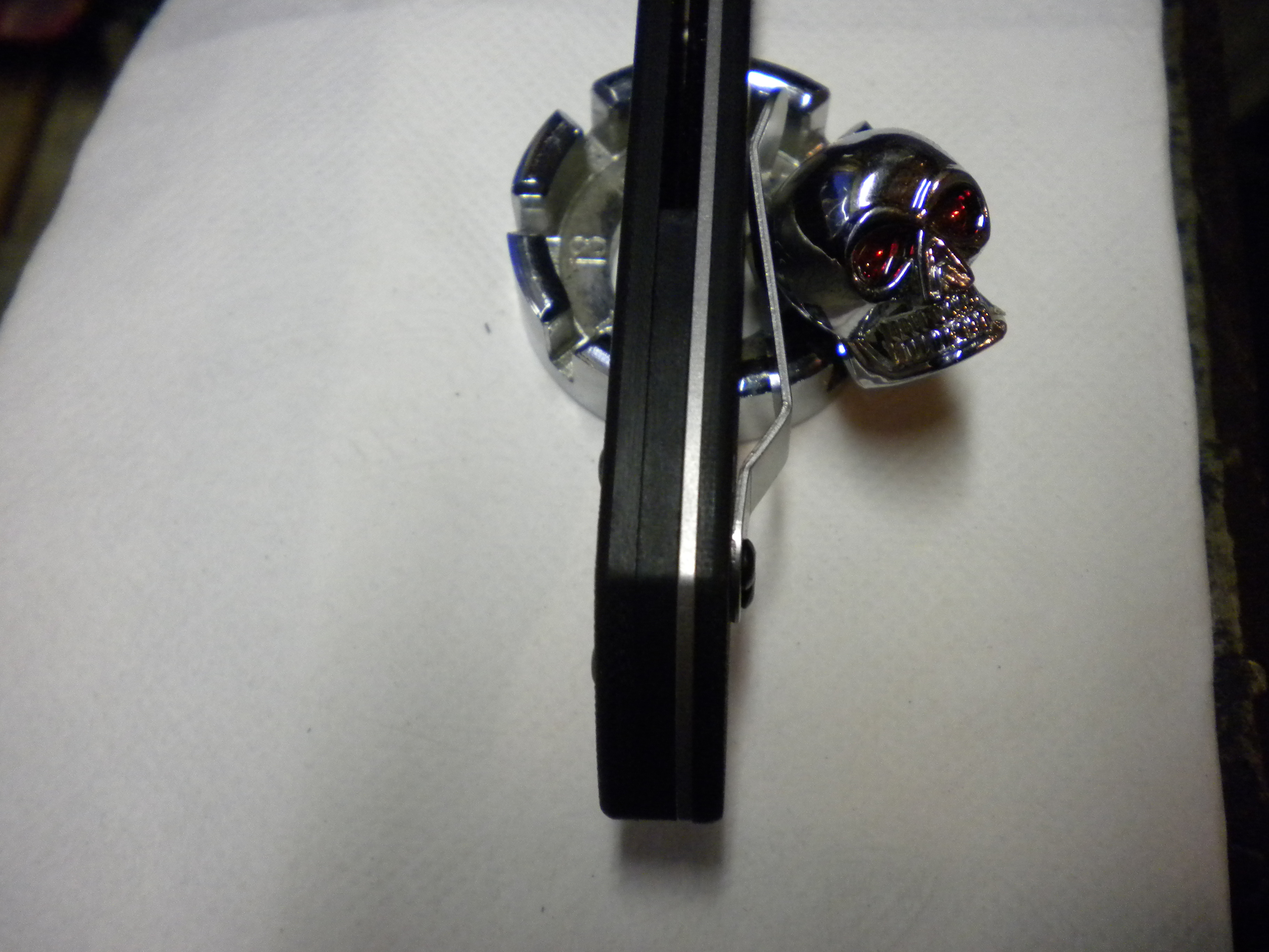

1- orig LOOK

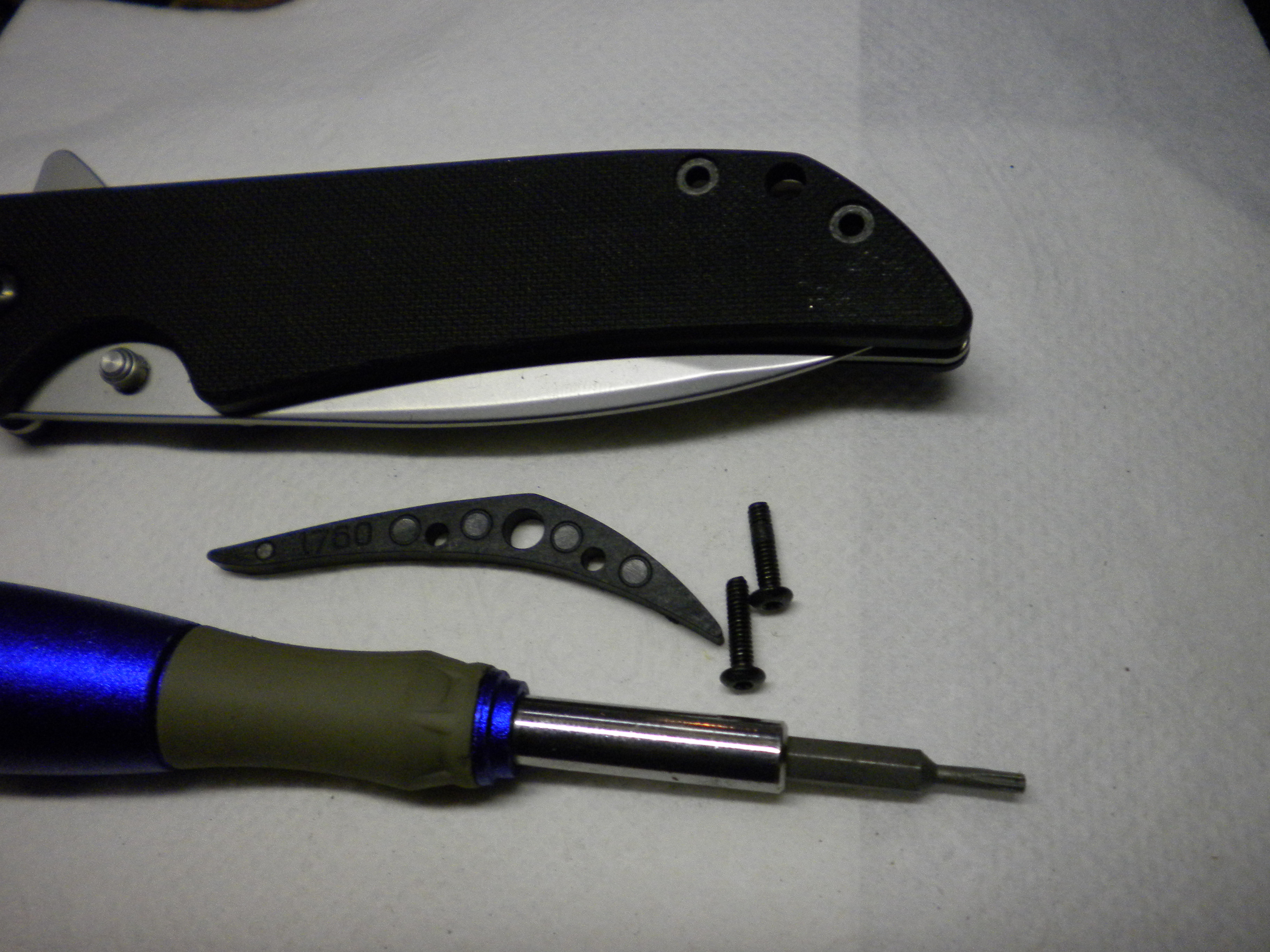

2- plastic spacer out

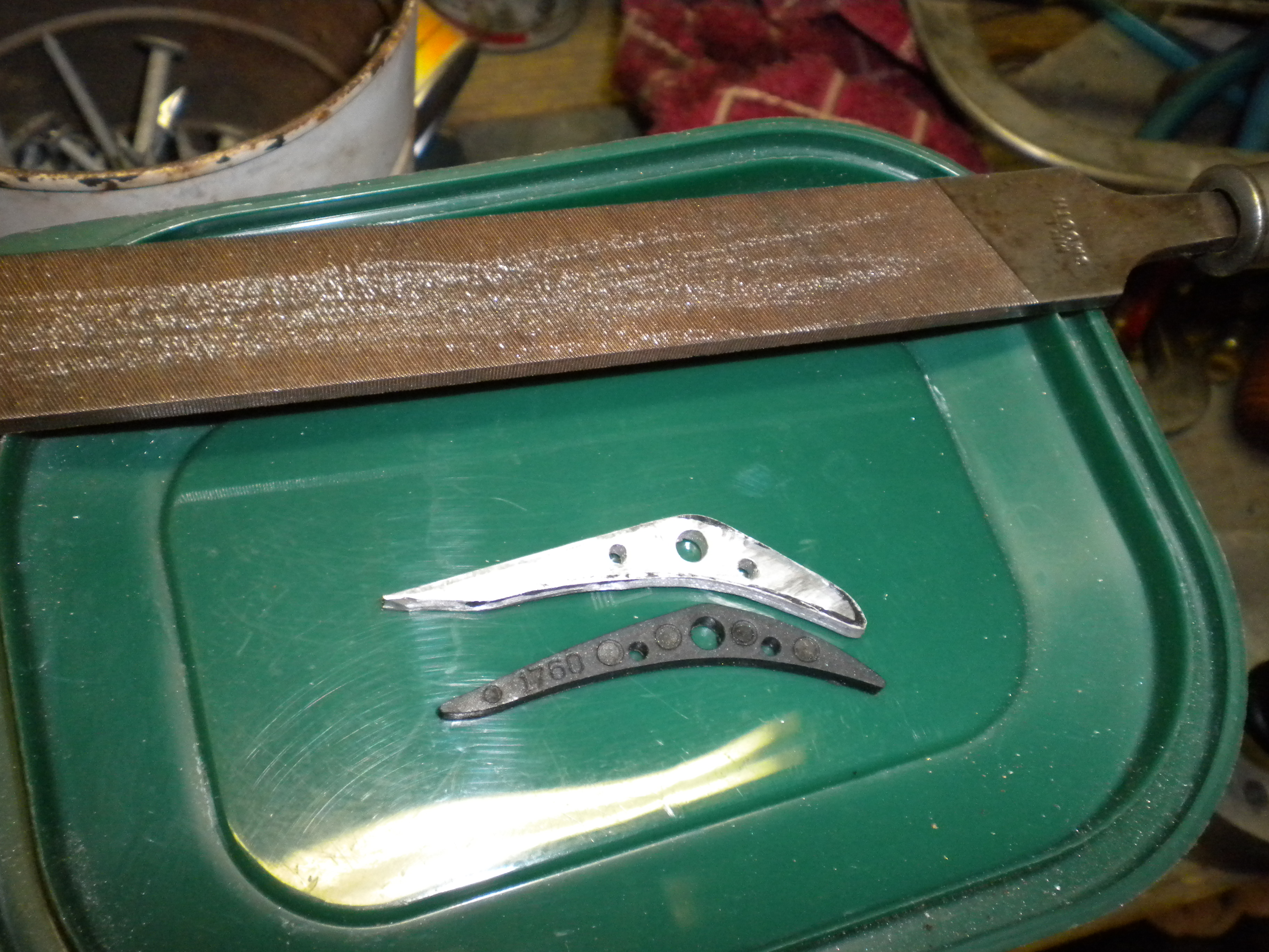

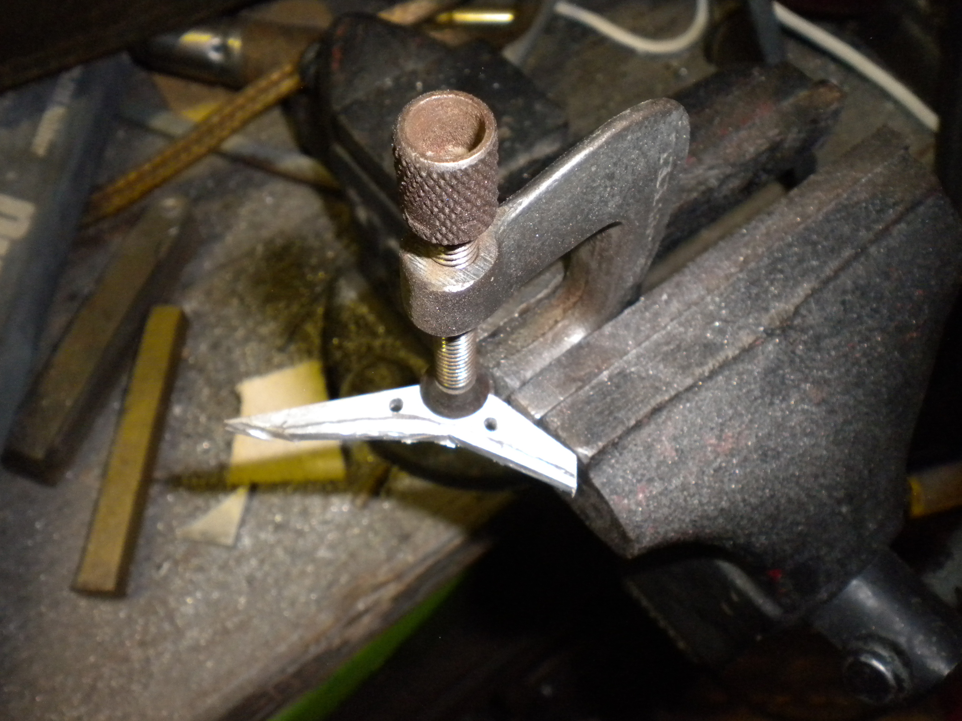

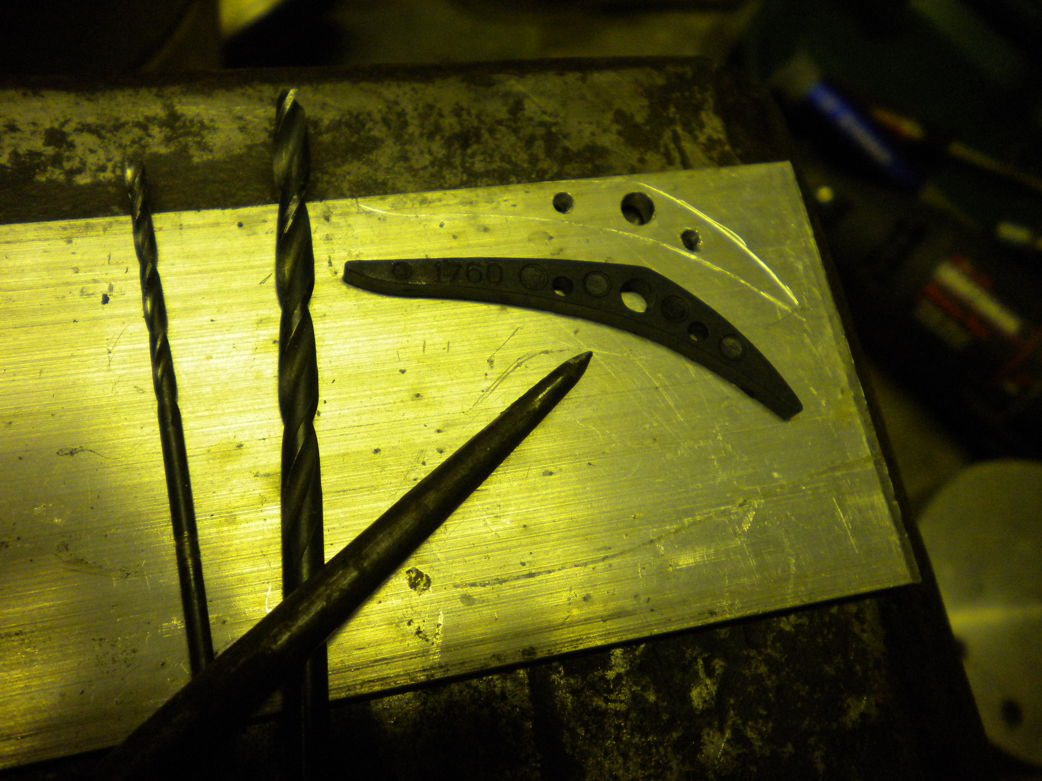

3-found scrap same thickness,marked out,and holes drilled

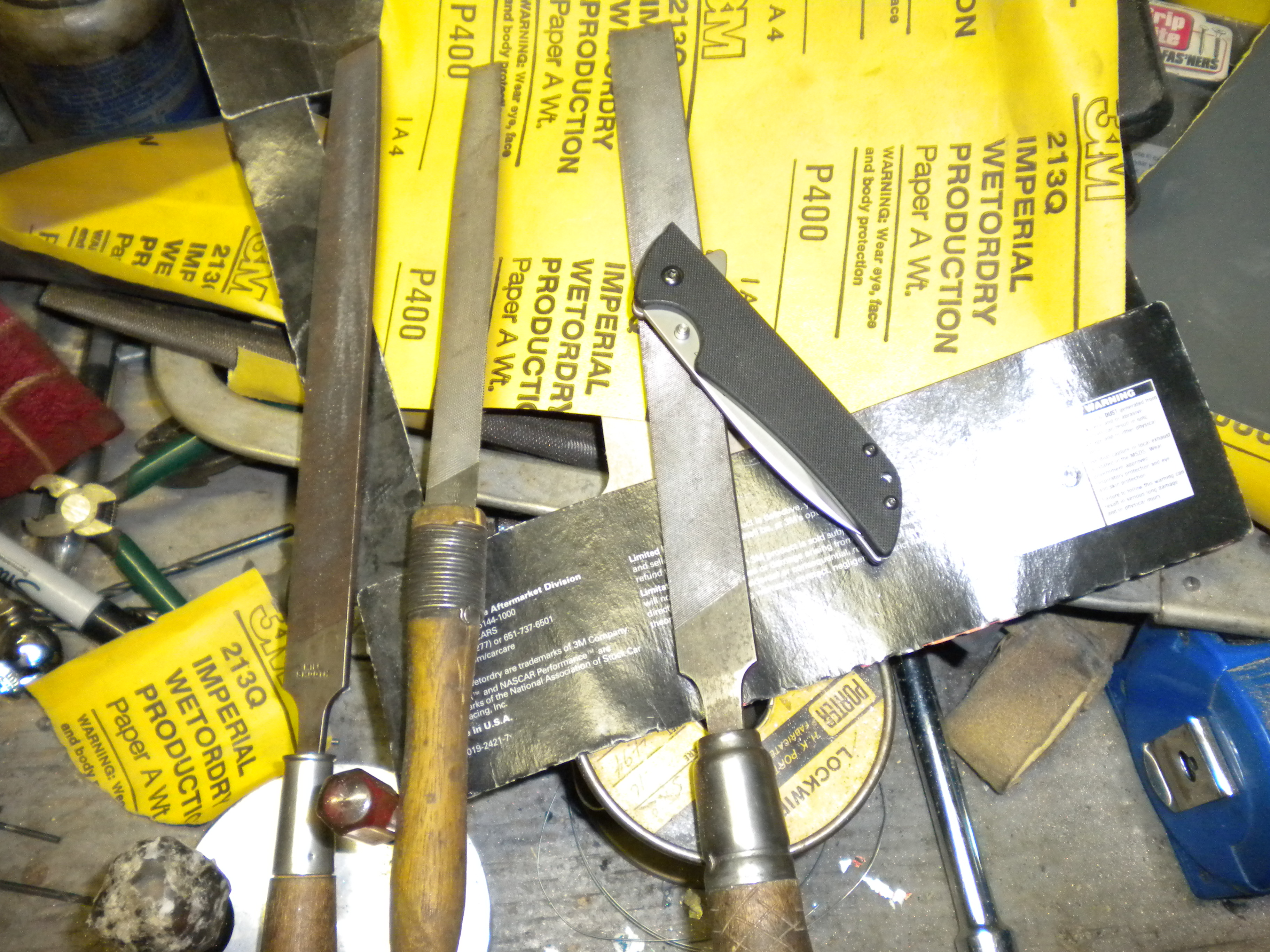

4-clamped and roughed out shape with saw/files/dremel
5-almost there....on and off knife like 20 times ::facepalm:: BUT CLOSE!

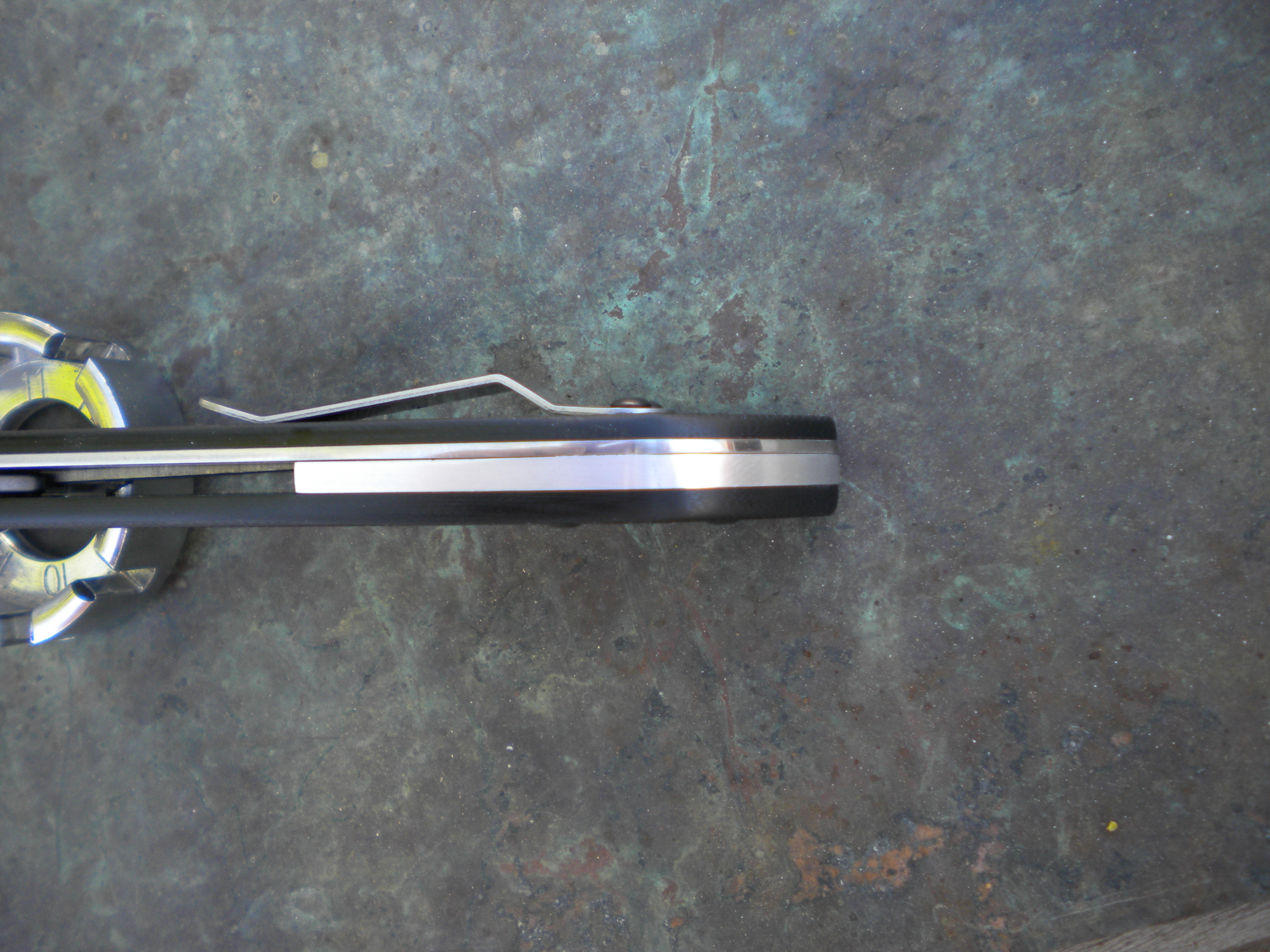

6- a lot of filing and sanding till just a touch HIGH.....

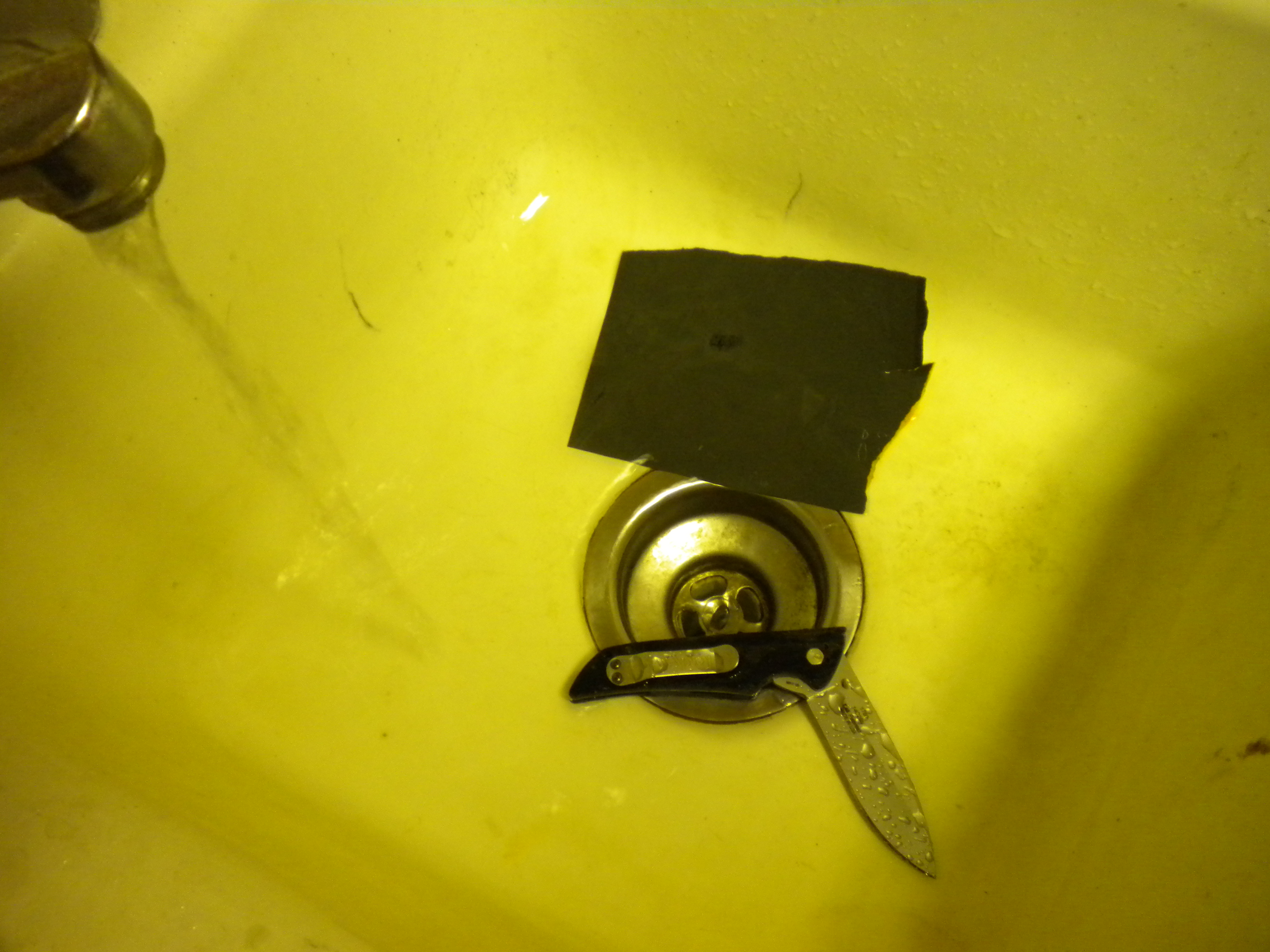

7-ONCE I FELT GOOD ABOUT shape and fit......WET SAND
8-finished up ::tu:: (CERTAIN ANGLES LOOK LIKE A GAP,BUT PRETTY TIGHT) ::paranoid::
9-done.....i weighed and same weight as plastic.....and a little longer to help keep junk/lint/coins OUT
ALL IN ALL........... i like the look better ::nod::
way easier than the last SPEEDSAFE ASSISTED OPENER i did.......
and way less time.....about 2 hours??? total

Looks like it was done at the factory, Josh.

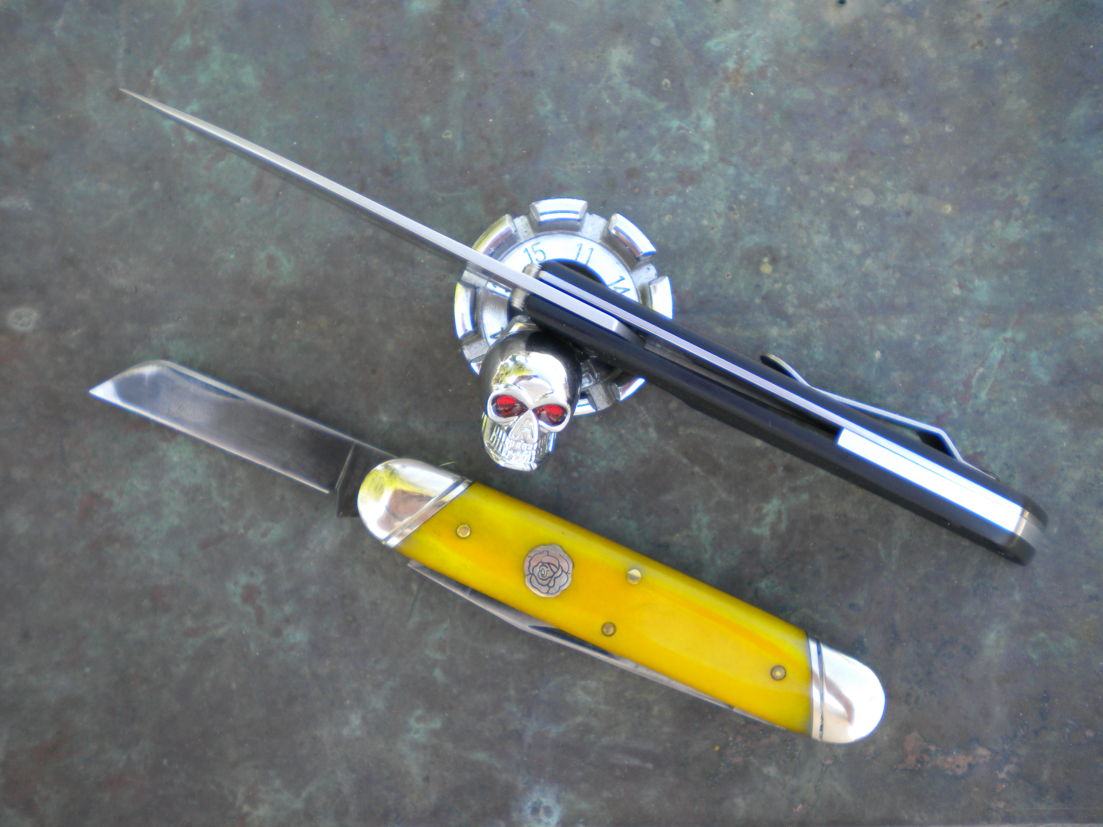

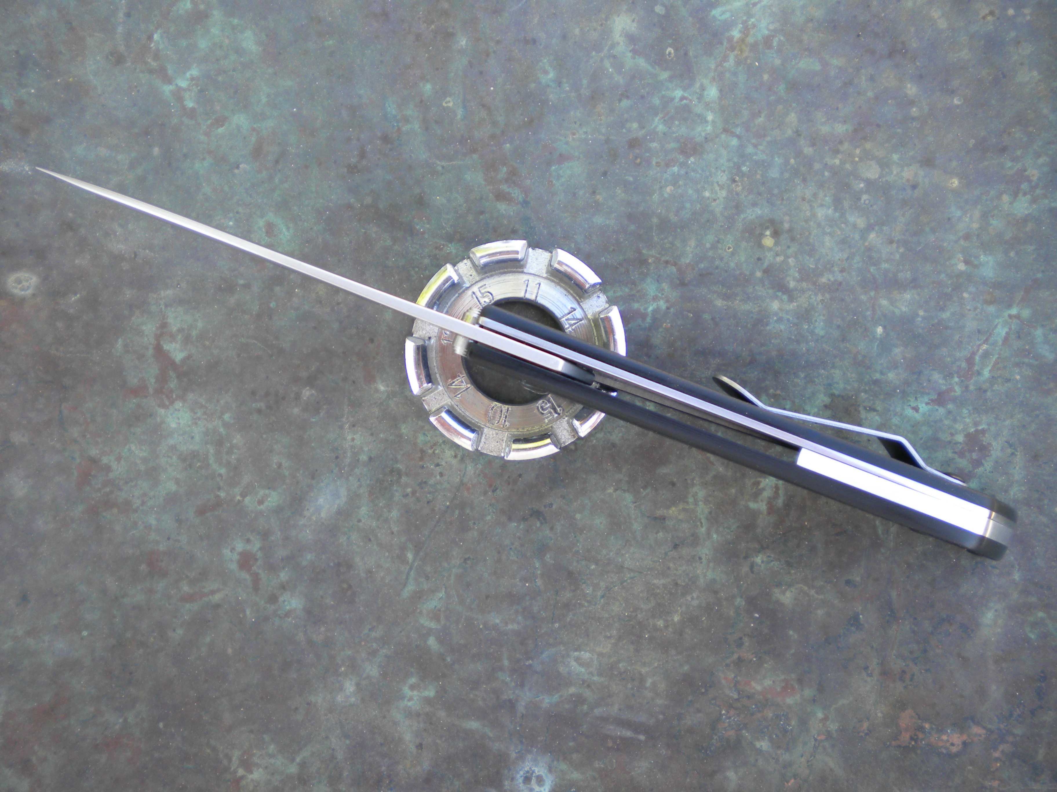

couple more finished pix
