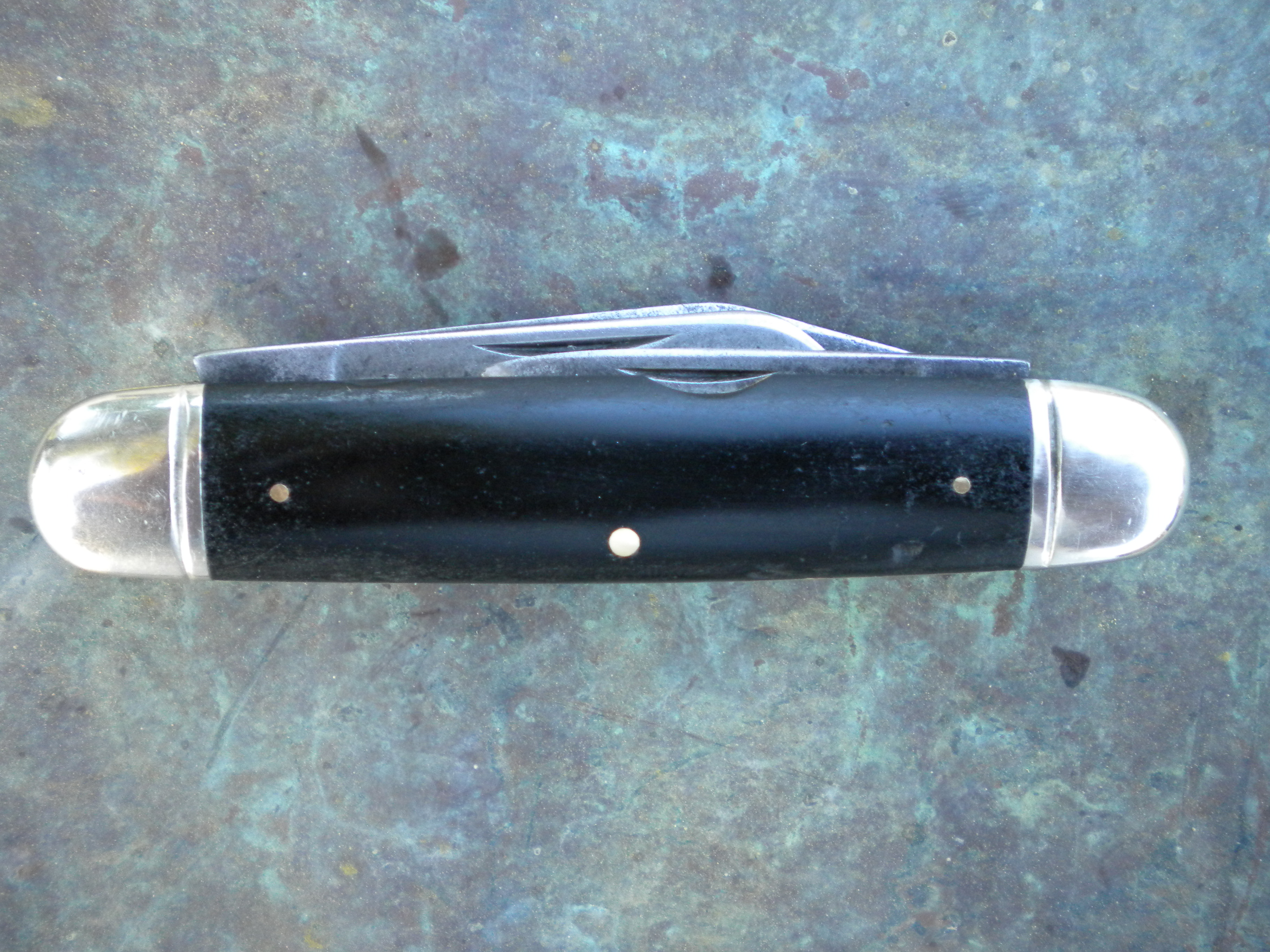

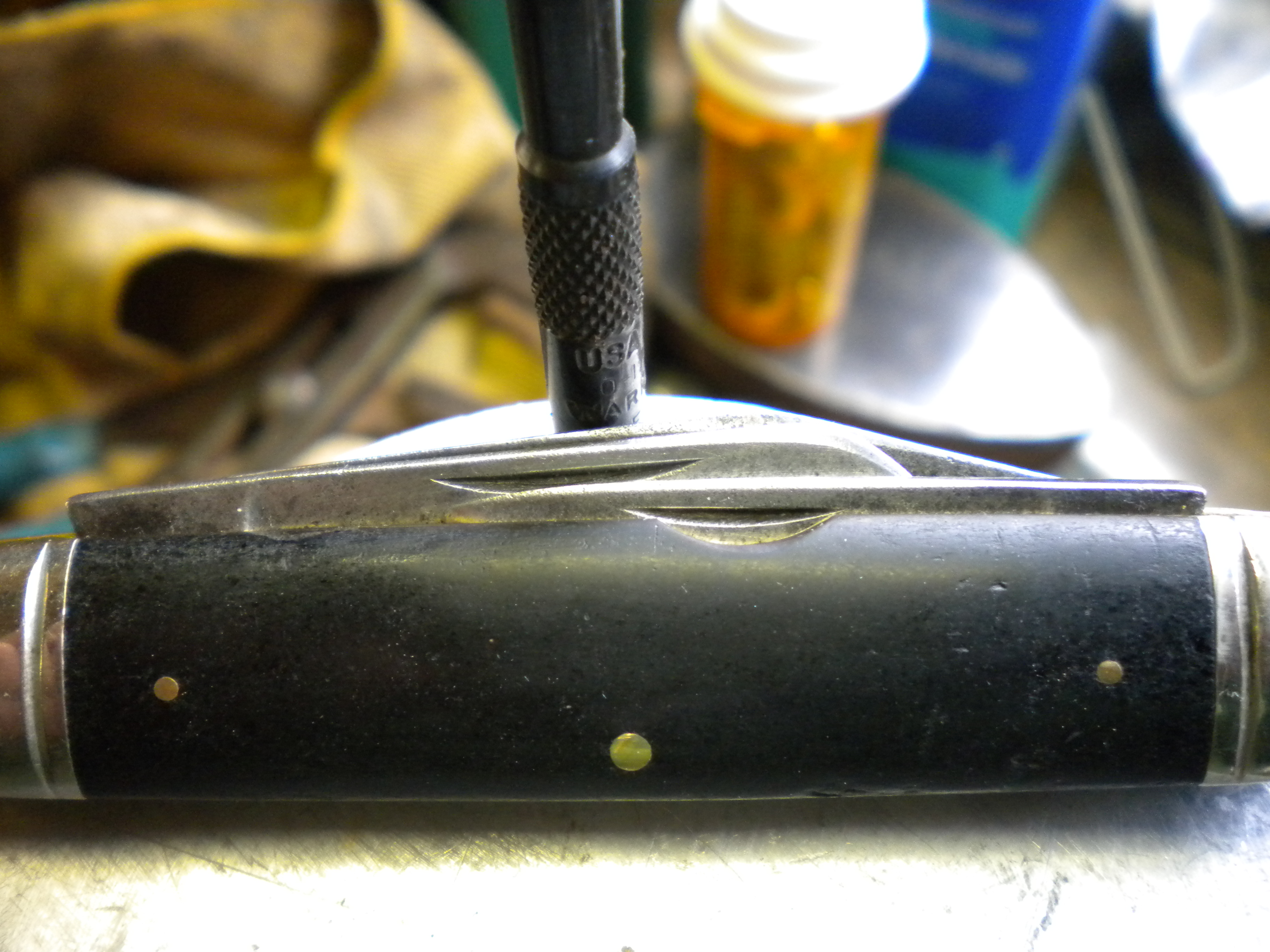

grabbed this old ROBESON for $7 bucks.......snappy ,GOOD cond., ....BUT the pen blade nail nick sat TOO LOW. ::dang:: .....and the pen blade tip sat TOO HIGH and snagged stuff...... :x

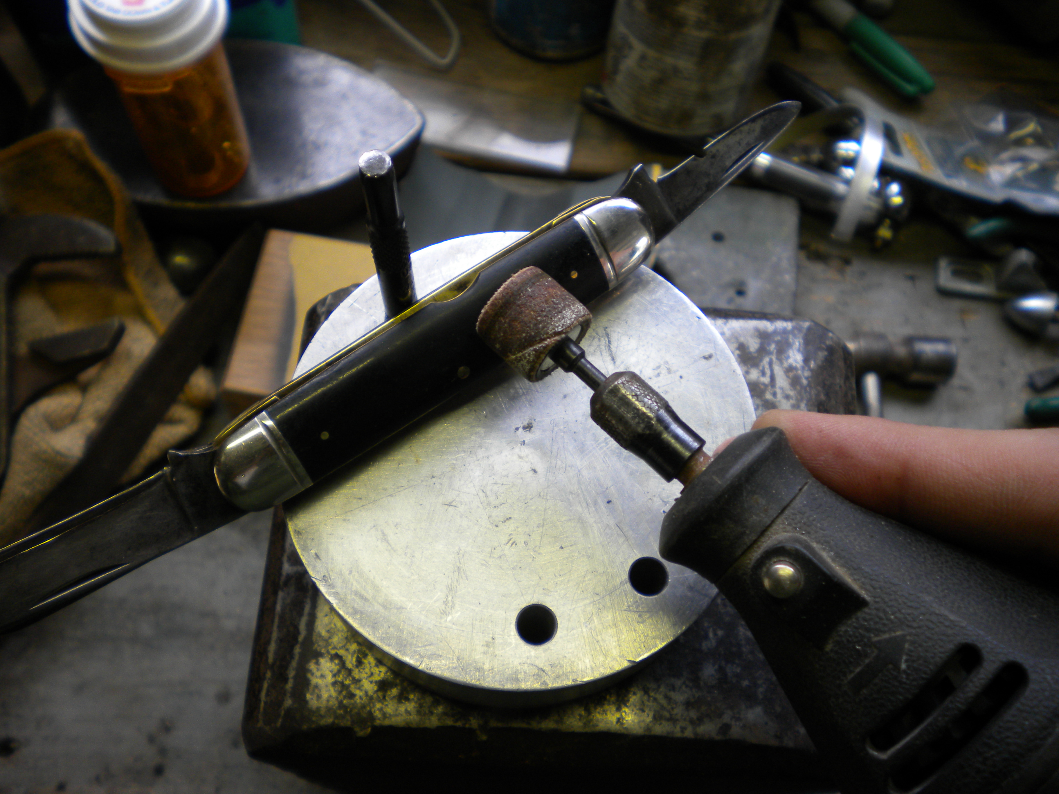

so i broke out my dremel and a lil sandin drum and got to work MODDIN' her back into EDC order ::tu::

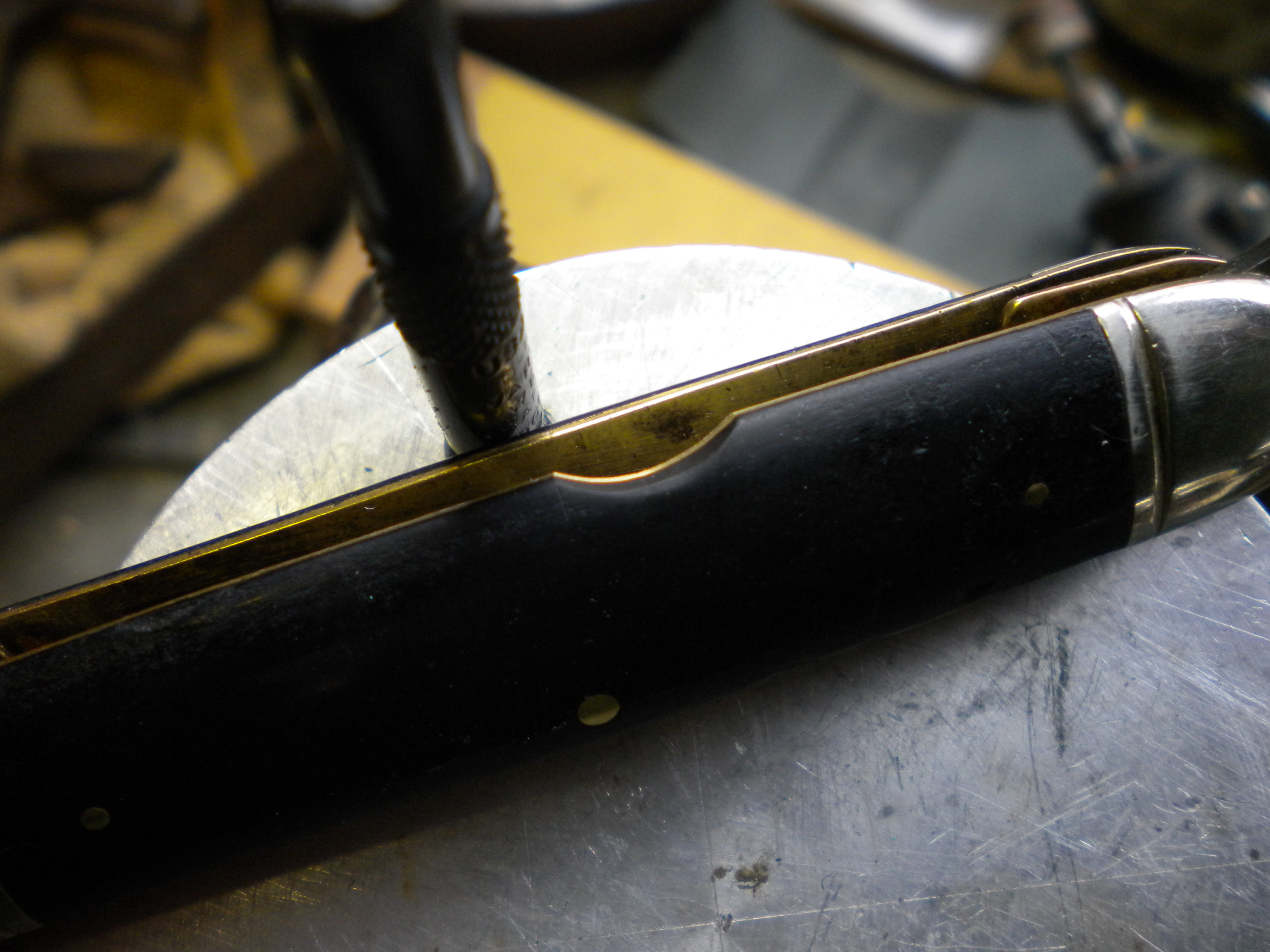

sanded a EZ open half round for the nail nick to be raised....... ::tu::

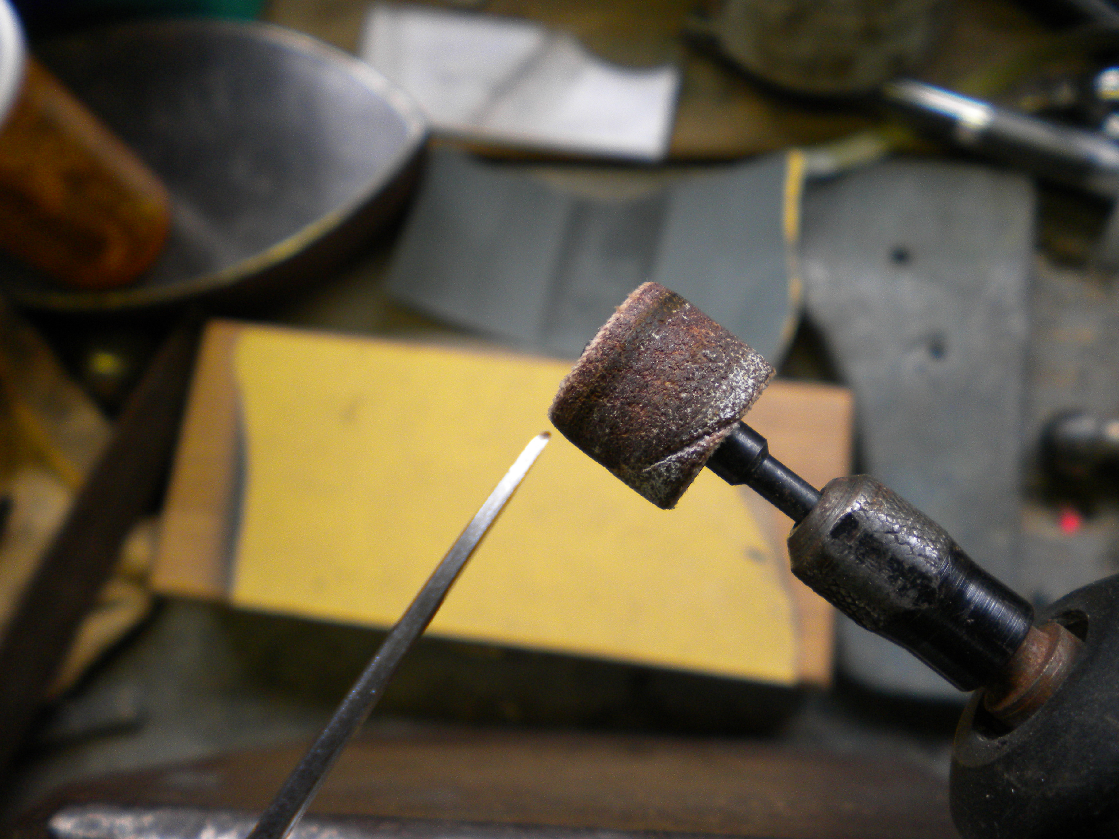

(side note: i used an old "used" drum so grit was not to much...all i had was rough ones)
and sanded the top of the blade tip so it swooped down...as to not snag on stuff ::tu::

SEE low nail nick & high pen tip
DREMEL AND DRUM I USED.
EZ OPEN half round ,sanded out.
lightly sanded tip to swoop down at TIP.

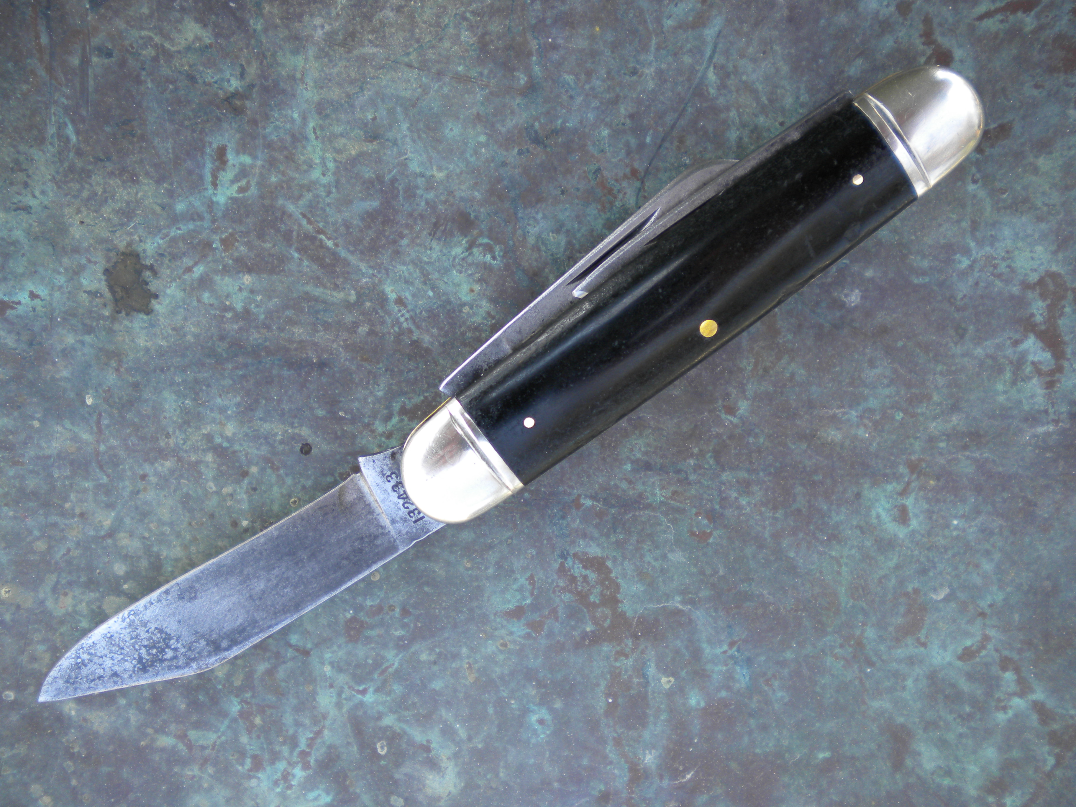

and finished up.......light 0000 steel wool rub down ta smooth it all out.........READY TA ROCK 8)
PIC makes nail nick look a lil off...must be camera angle and a lil blade patina err shadow ::shrug::

That looks great! Looks very pocket-worthy now. I use a dremel for some operations, but I also like to use files for blade reprofiling. That way I can ensure that I will not overheat the blade too much.
Careful, it looks like you're enjoying knife modding too much. Once you slide down that hole, there's no coming back... :shock:

i get impatient ::super_happy:: ......SO i went slow and after 2-3 passes i let the tools fan(when it runs) blow on the blade for a few seconds...the a couple more passes....then back to fan......more passes...till done. ::tu:: ....and YES YOU CAN MESS A BLADE/ KNIFE UP FAST WITH A DREMEL TYPE TOOL!!!!
BE WARNED!!!!!!!!
kinda why i called it a GHETTO fix.....lololololololol dremels and knives dont really mix! ::nod::

Het. Whoever you trade that off to is gonna be scratching their head looking at the book looking at the number scratching head looking back at the book lol good job ::tu:: I love a little chaos j/k your pic made it look like you were using the dremmel without holding or clamping down the knife. Thats dangerous ::woot:: gotta love livin on the edge (pun intended) I'm curious about your rehandle woohooo fill me in bro :D
