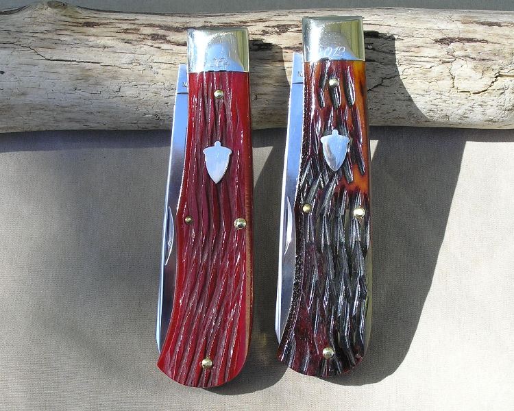

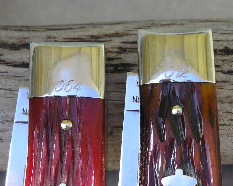

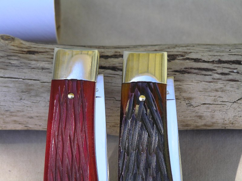

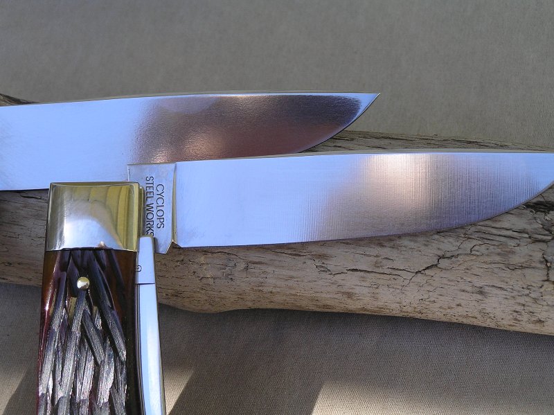

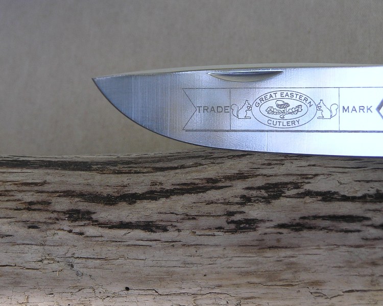

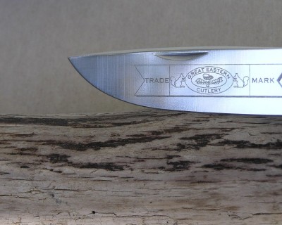

I took a few pictures of what I regard as defects in the 2 knives as far as fit and finsh go.
Let me start off by saying that these are big solid trappers that feel great in my hand. They are very nicely designed if it were not for these flaws, they would be a joy to own. I will be contacting Great Eastern about repairs on both.
The clip blade on the Amberbone Horse cut should have been thrown out, that should never been allowed to be installed. I forgot to take a picture of it the spey blade of the Red Diamondback Bone knife also has the grind/mill lines that I can feel with a fingernail, should have been tossed also. The other 2 blades are smooth, both sides, I assume this is the way it's supposed to be, I'm running at 50%.
Those are big dents in the bolster that line up with the jigging, they do detract from the knife, at least the big ones. The small one's are no big deal.

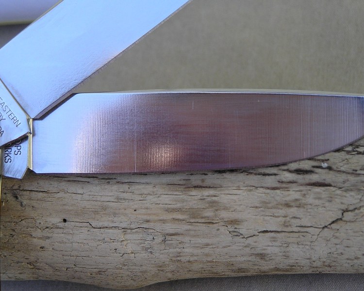

The spey blade on the Red Diamondback Bone knife grinds badly when opening or closing, it will never work itself out. Like they did not shim it correctly when the knife was put together.
The jigging of the Red Diamondback Bone knife appears incomplete, maybe it's supposed to look that way.
Quality Control is an issue that needs to be addressed.
Please click on the photo's for detail.

I'd say you've made some valid points. There is a term for when the jigging passes into the bolsters, it escapes me right now, sorry

i know they are machine jigged but i did'nt know it was done after assembly. what about the pins? like i said, i have case, s&ms, etc with some indentions on the bolster that line up with the jigging and assumed it was done polishing the handles. your's are deeper than mine. when i talked to bill howard, he assured me all problems would be fixed. at a 50% return ratio they'll be extra busy.

Ouch, 1 clip and 1 spey blade need to be replaced, that's not something you can buff out either. Check out picture 006, that clip blade in the back is not very good either. Has "orange peel", something you see on D2 occassionally when someone first starts working with it.
EDIT:
Oops, my mistake after viewing the knife there is no orange peel. This is what it looks like but you can see this ONLY because the picture is blown up. Basically orange peel has to do with the grain size after to high of an annealing temperature, normalizing. etc.
Sorry, My ERROR!

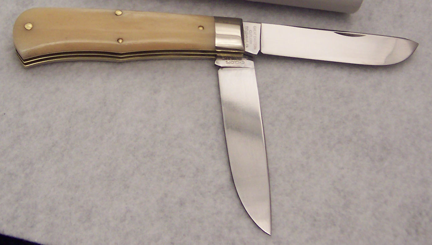

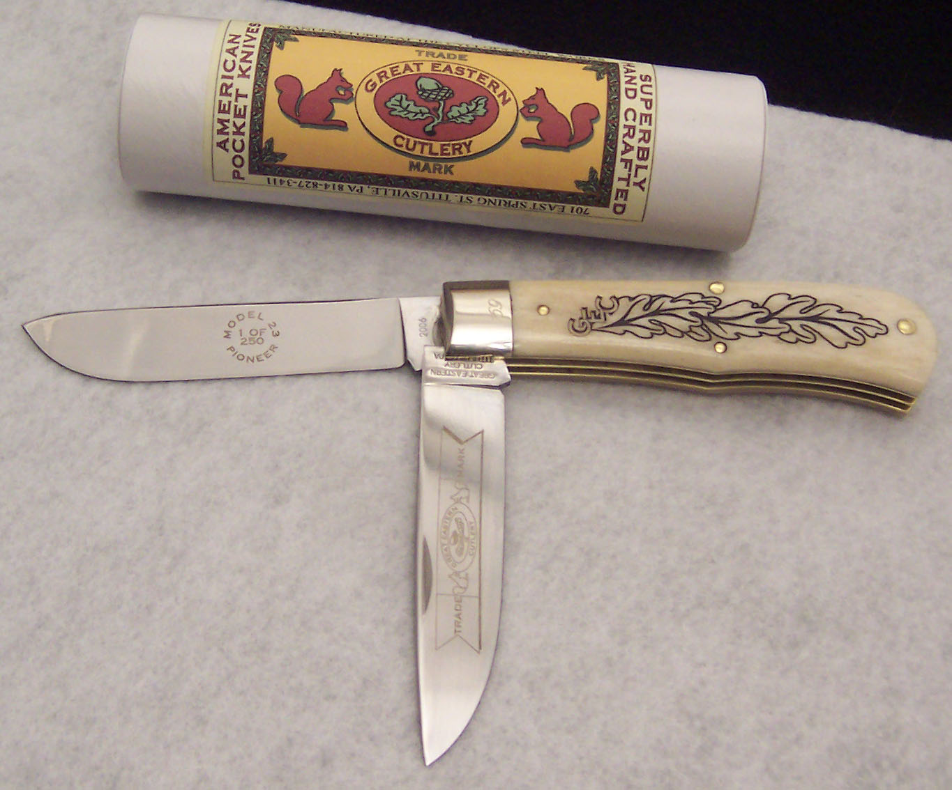

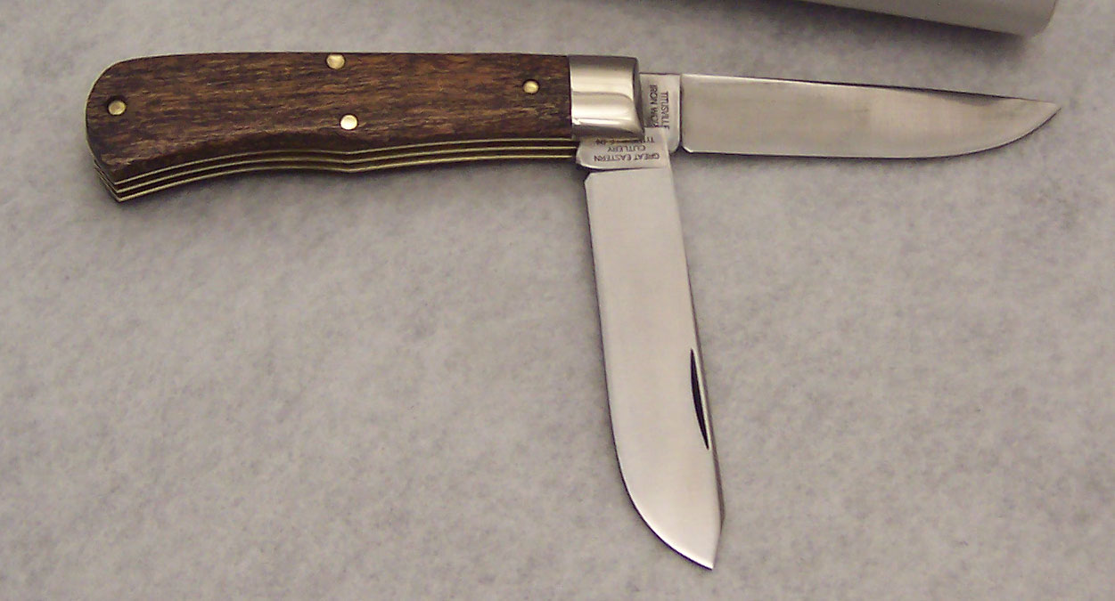

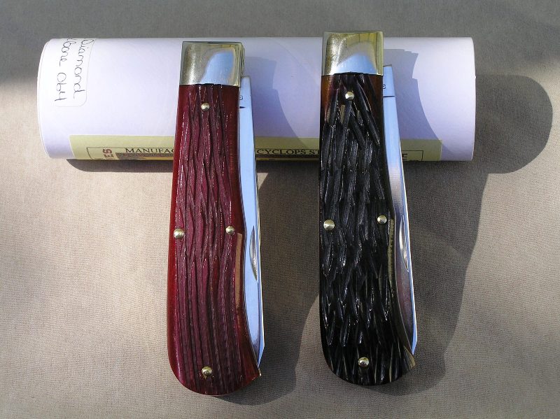

I just got in a batch... White smooth bone 23 models in 440C and Bokote Wood 73 models in 1095. No problems on the bolsters ...because the handle scales are not jigged of course
I haven't had a chance to check them all. The two I opened don't have any serious issues. The shield is set flush on the bokote 23. No shield on the white bone to examine. Blades walk and talk like I like them to. I have no problems there. A couple of the pins stick out a bit more than I like on the white bone. Blade finish is not the greatest on either, but looks much better than Hukk's.
All in all... The two I've examined aren't bad by my standards ...fit is pretty good.
Haven't seen any of the jigged bone examples up close and personal. I'll reserve saying anything else til I get my hands on a few more.
I've attached pictures, but my pictures are pathetic as usual

The marks in the bolsters could be from buffing with a soft rag wheel after the bolsters and scales were assembled,possibly after the knife was finished.the soft wheel would follow the grooves in the bone, and eat away the crisp corners of the bolsters.Just my opinion

edgy, if it was a soft wheel, the handle material will go long before the bolsters. these notches are not softened like polishing does to metal.

Exactly correct.edgy46 wrote:The marks in the bolsters could be from buffing with a soft rag wheel after the bolsters and scales were assembled,possibly after the knife was finished.the soft wheel would follow the grooves in the bone, and eat away the crisp corners of the bolsters.Just my opinion
That is a well known phenomenon that was documented a long time ago in an article in the Case Collectors Club magazine. The marks on the bolsters are called "sucking out marks".

Well, it is just as Edgy wrote. Handle slabs are ALWAYS jigged and dyed before being pinned to the liners. If the jig trails extend to the bolsters after the rough hafting process, then during the final buffing with soft wheels the spinning cloth wheel edge gets "funneled" through the jig trail and wears away a bit at the bolster at the end of the jig trail. NOT AN ERROR at all...but a sign of a properly hafted hand made knife. I see it on some of the new Queen knives that I buy. It is normally VERY subtle and not something that one would notice without close exmaination.jonet143 wrote:hey knifaholic, can you elaorate? i'm all ears. i've never heard the term and , bummer, did'nt read the article. this phenom. is an error, correct?
Whn I first noticed this on Case pocketknives in the 70's, I mistakenly assumed that the handles were jigged post-installation but I quickly realized that that could not be a workable method and came upon the other explanation after thinking about it.
