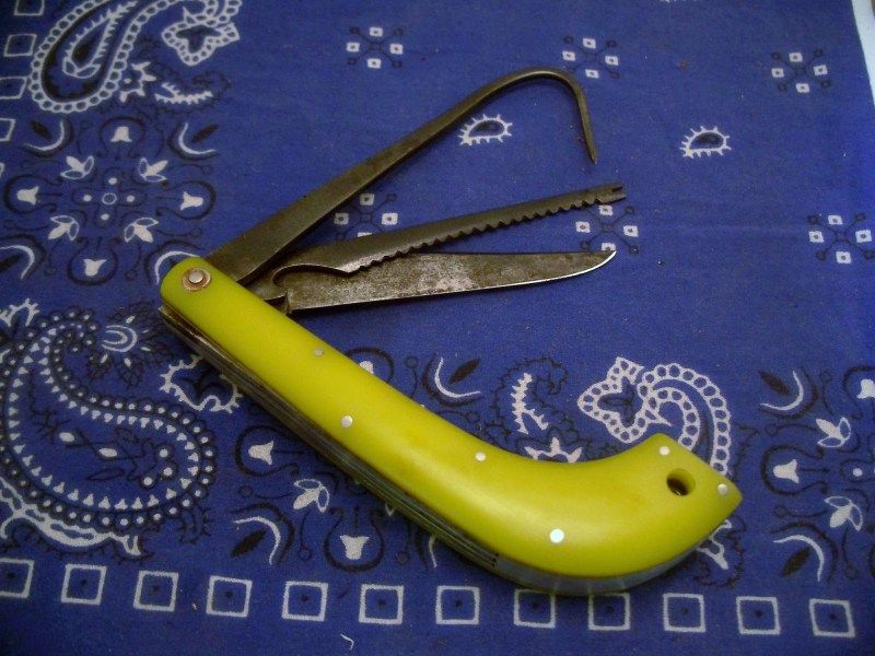

Finally I was able to find a local source for good yellow composition. I bought a sheet and had to try some of it out so I knocked out this 3 bladed fish knife that was gassed out real quick to see how it worked. On a fragile scale it's about like bone maybe a tad tougher, it's semi translucent so it has a little depth like old yellow cell without the hazards of real celluloid (not to mention it's about unobtainum in solid colors). The company rated it as a moderate to high shock resistance which sounds good, I peened the pins pretty good into the countersinks and didn't have any problem with cracking or chipping like with yellow corelon. It takes a good shine too, this is just finished down with steel wool, not buffed because the rest of the knife retains it's age.
They sell it in a variety of other colors too black, red, blue, green, white clear ect They also sell black delrin sheets which will come in handy for restoring old slick black case knives.

That came out real good. At the pivot/rocker (I can never remember which), was that washer on each side that you had to peen the pin over to hold it?
That yellow looks nice.

I'll sell some if there is any interest. The washer acts as a tiny bolsters just like a sodbuster or a birdseye rivet

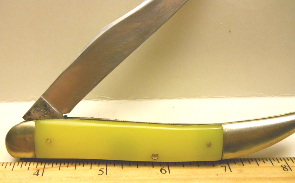

I've had this old fish knife in the project box for a while and saw this post and bought some material from MM. This was great to work with and no problem in drilling or sawing. Didn't shatter when peening it like some of this stuff does. The faults in the knife are mine. I got in a hurry and should have painted the liners yellow before putting the new handles on. The old handles out gassed and the liners were a mess. Cleaned them up on the wire brush, but didn't get it all off. May do a little more finishing on this when it warms up. I also bought other colors from MM that I'm anxious to give a try at.

looks good Bob! Paint the back side of the handles white for best results it brightens up the handles and hides any liner faults. AS is it looks old and correct though!

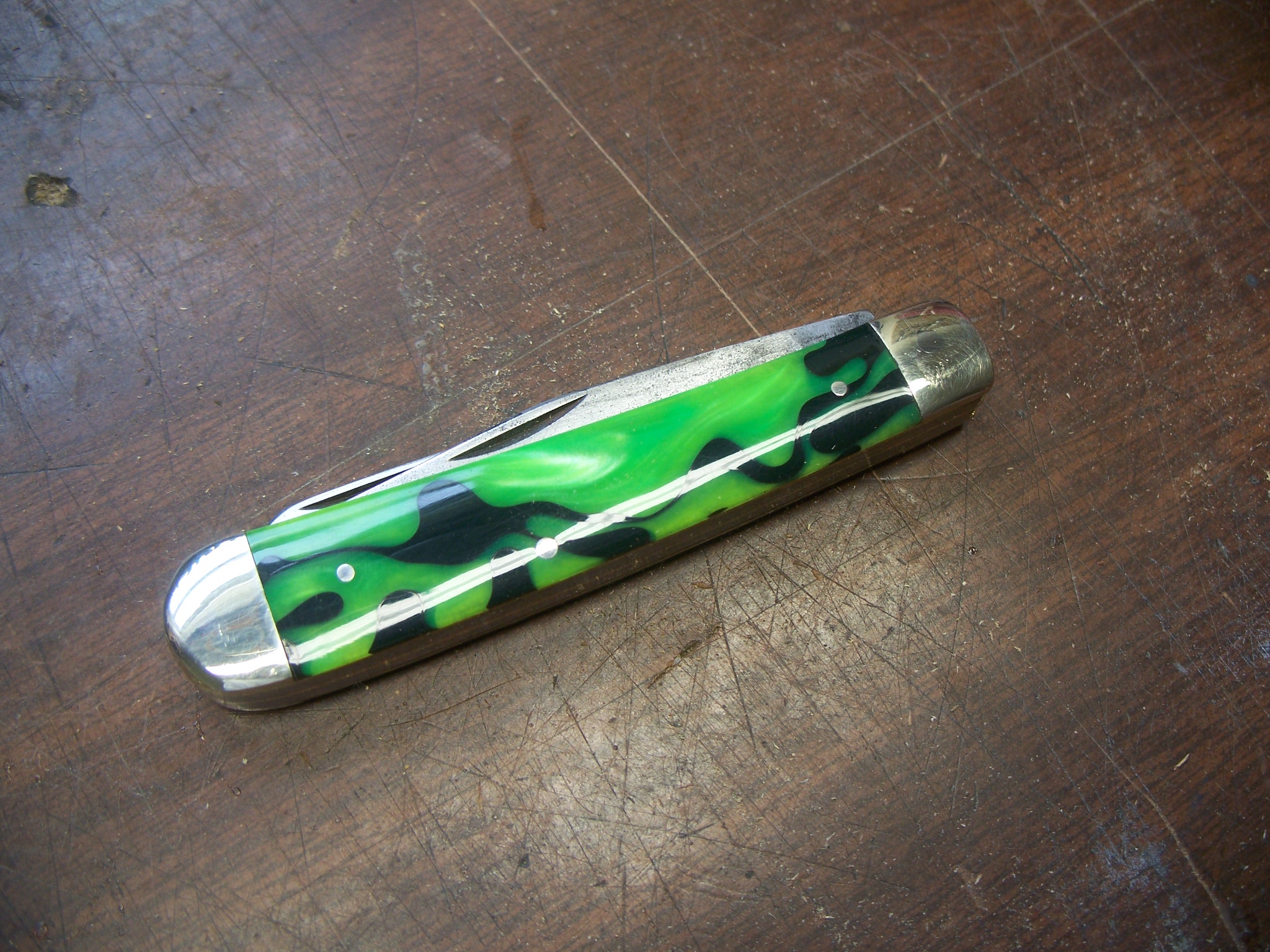

the waterfall, candy stripe, abalone and opal I have in my store is all genuine celluloid, not a modern acrylic substitute like the solid colors i'm offering. not all of th epen blank materials are brittle either, just depends who you buy from. Here is a german eye trapper I did yesterday in an acrylic blank material

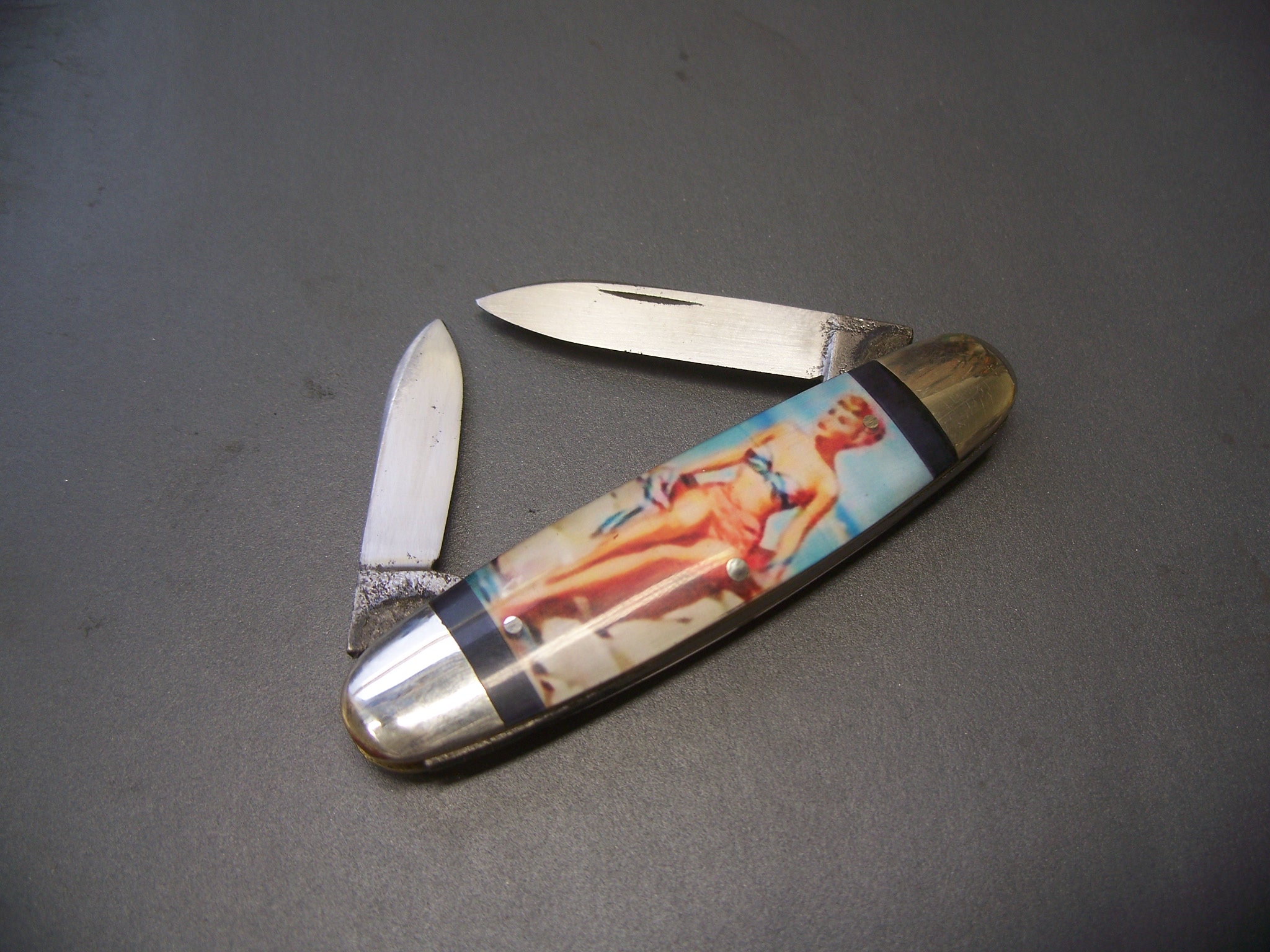

found a good clear for redoing the old picture knives too works great and is indestructible.

Boy that'll rescue some of the older picture knives for sure! ::tu::
