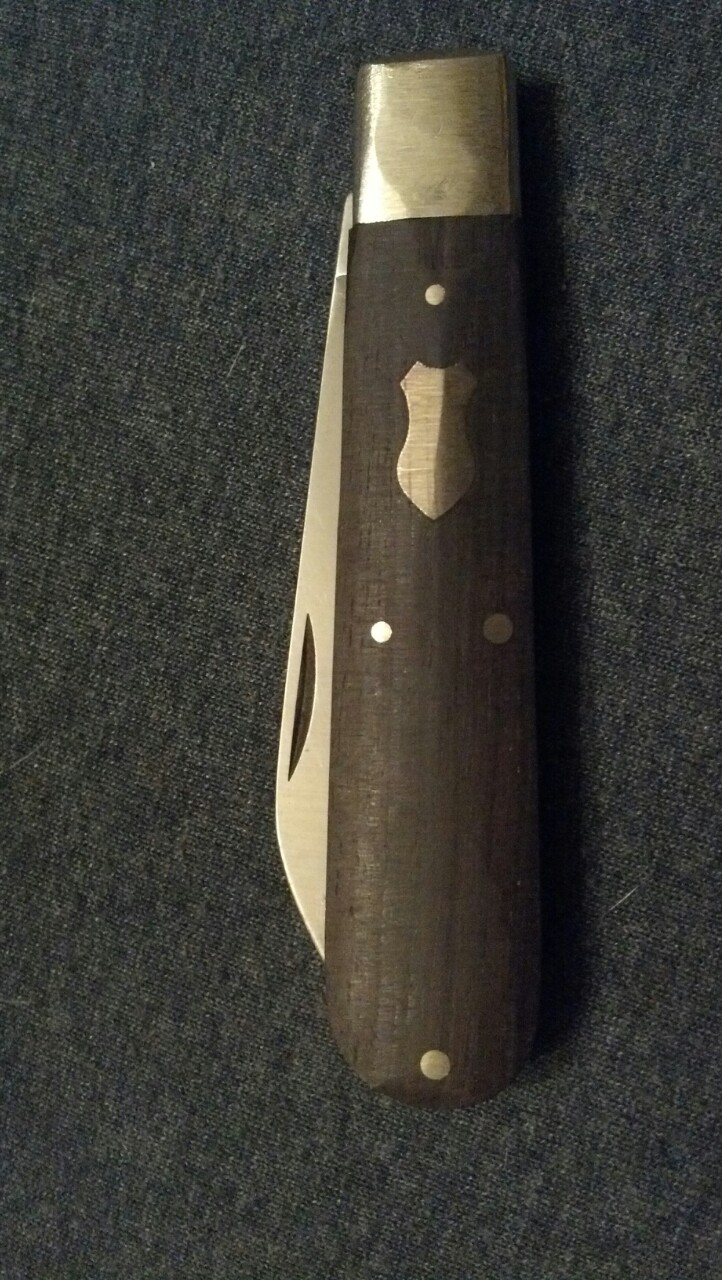

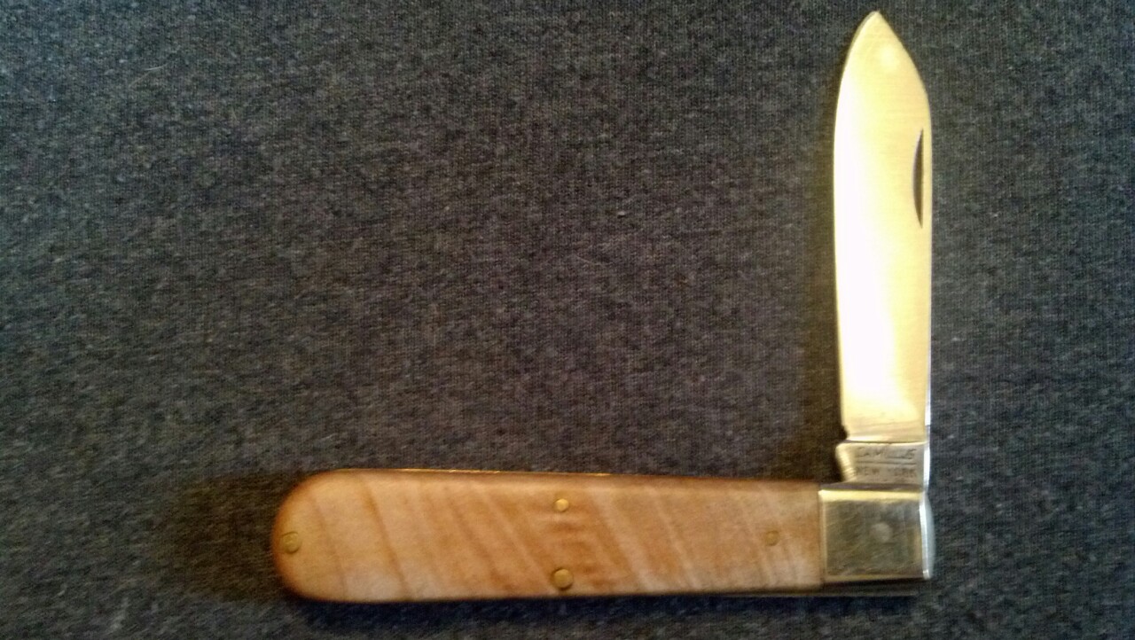

Here is my process for inletting a shield. Bear in mind only my second one and first of this design. I had this Cam TL29 I had made new liners and bolsters for about 6 years ago. In shaping the handles got frustrated and it has sat till about 2 months ago when I tried to finish it. Was not happy with the maple scales so decided to redo it and took some pics. Any comments welcome and I am a big boy.
Here is the donor knife.

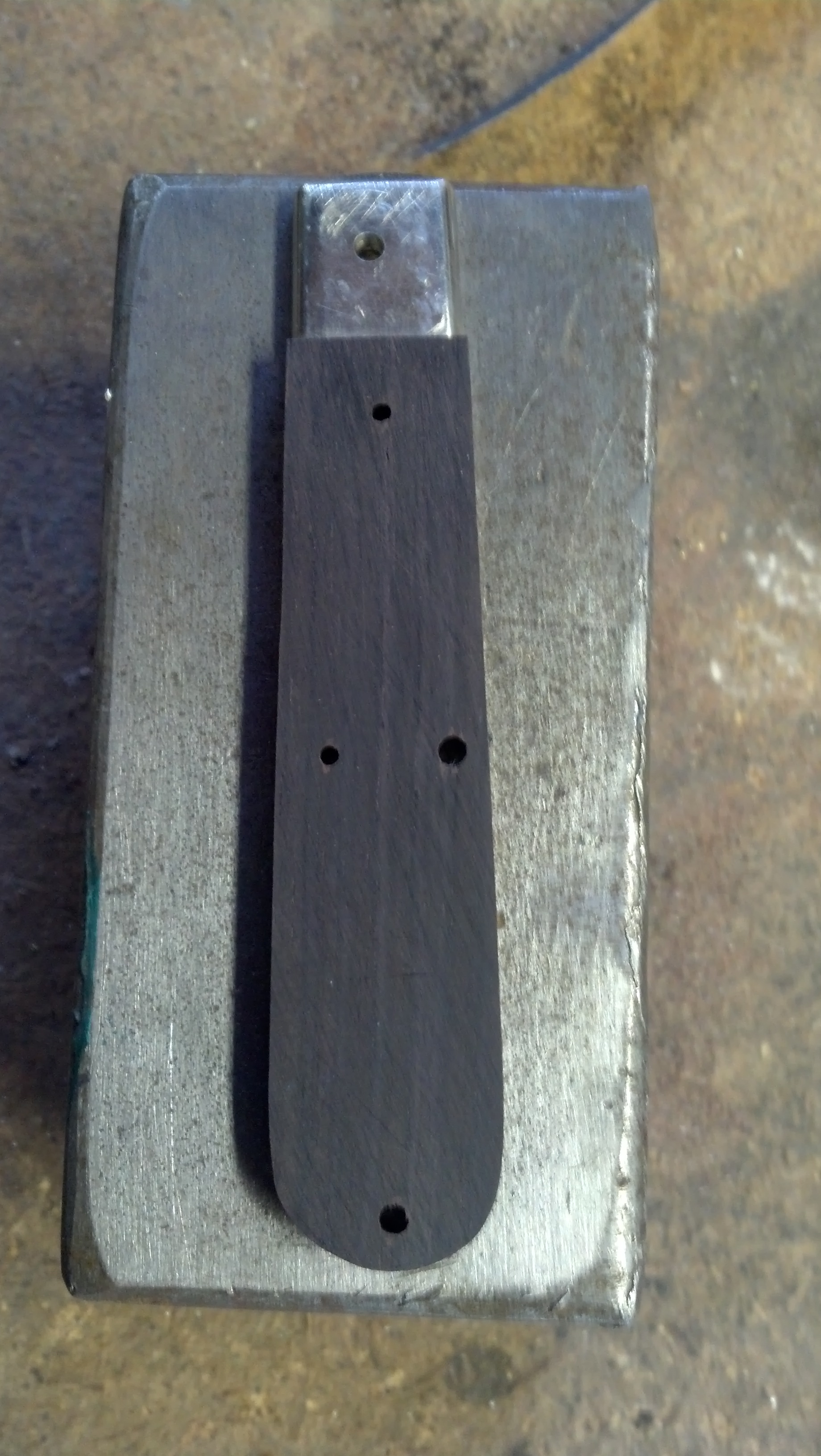

Removed old scales and put some African Blackwood on. Has been superglued to hold it on and holes drilled.

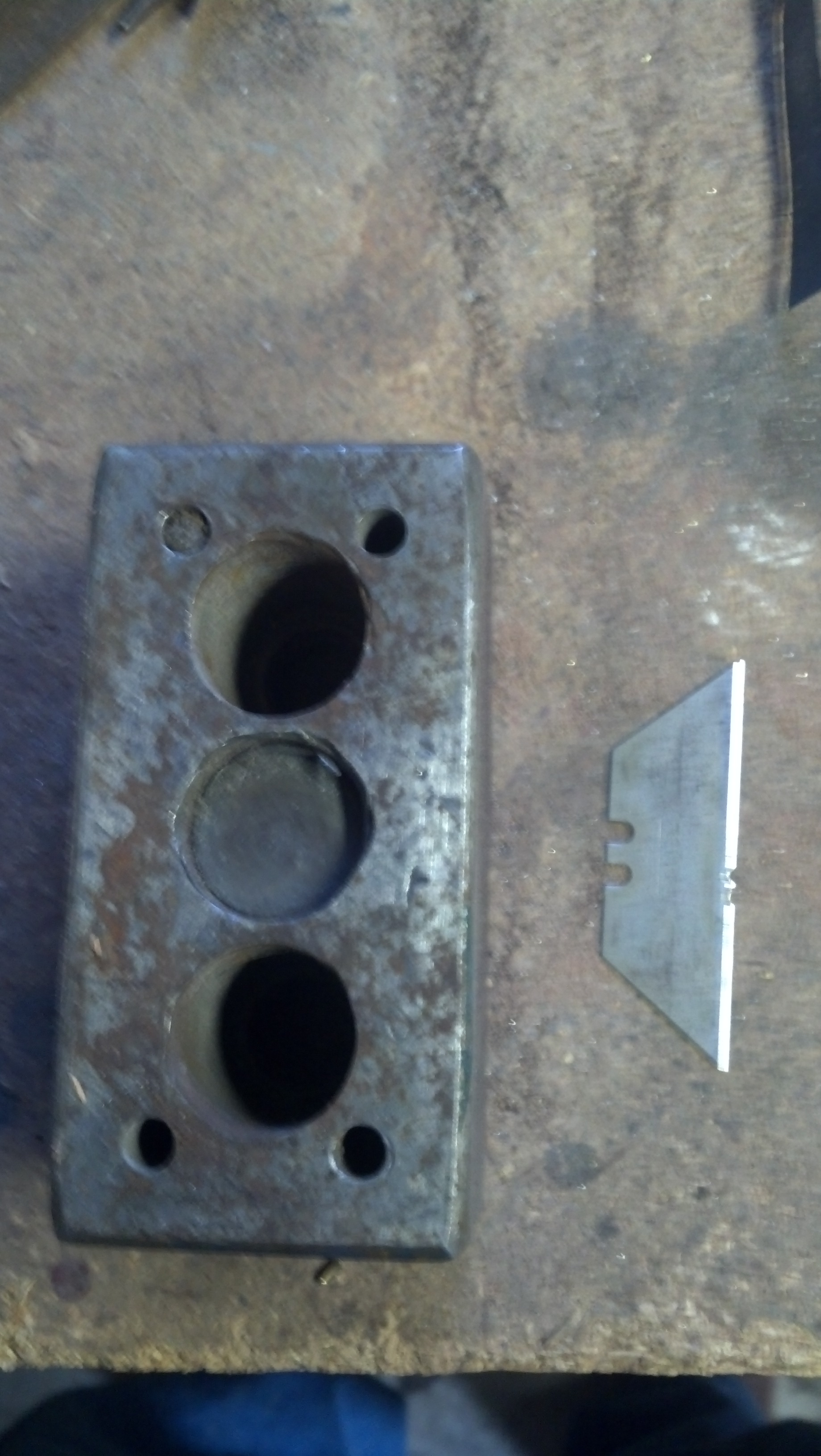

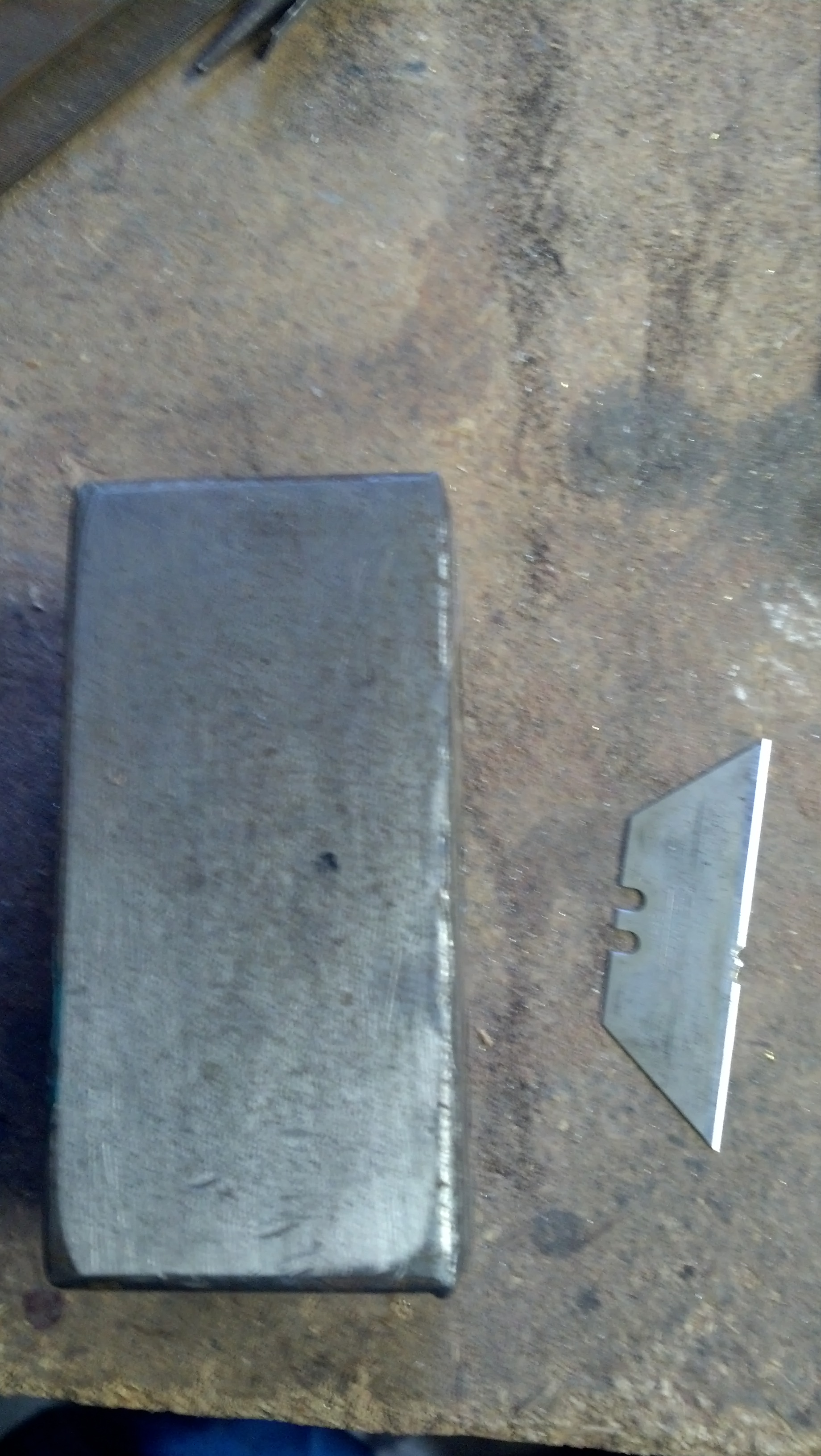

Here is steel block I am using for my anvil. It came off an air press thing. Have found it usefull.

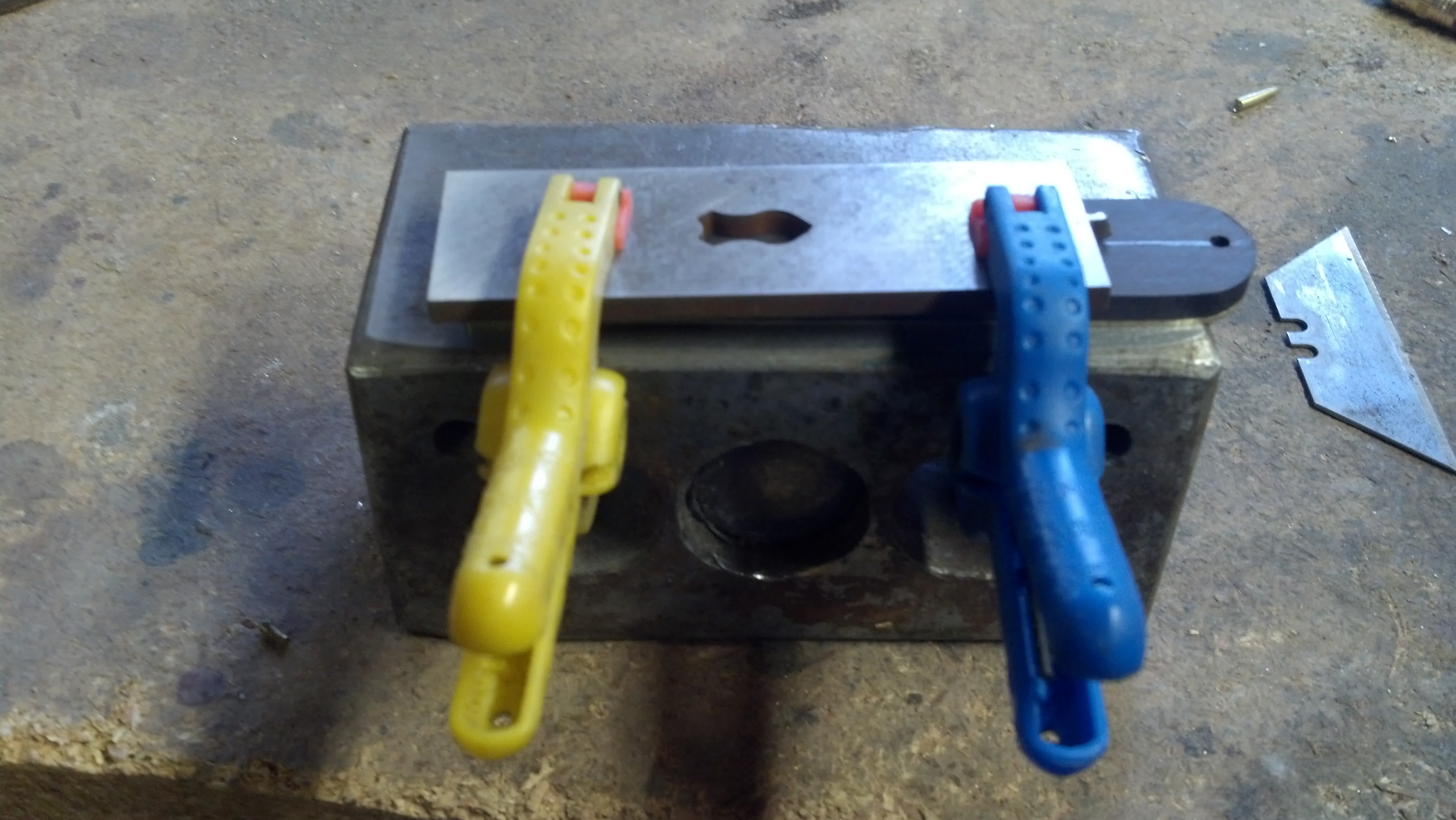

Re: Inletting shield
Here is how I have is set up. Seems to hold it pretty well but like I said only second shield I installed.

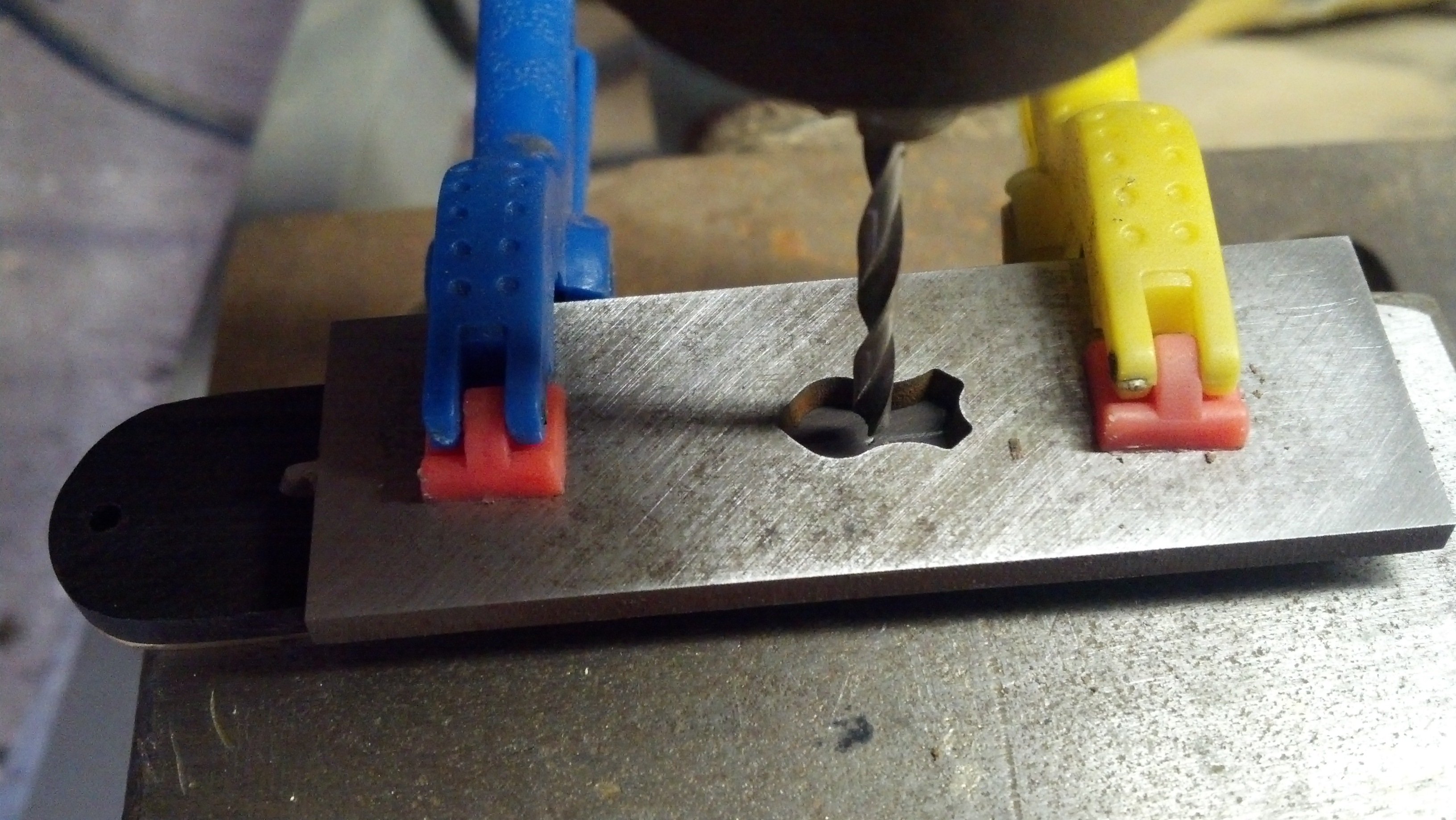

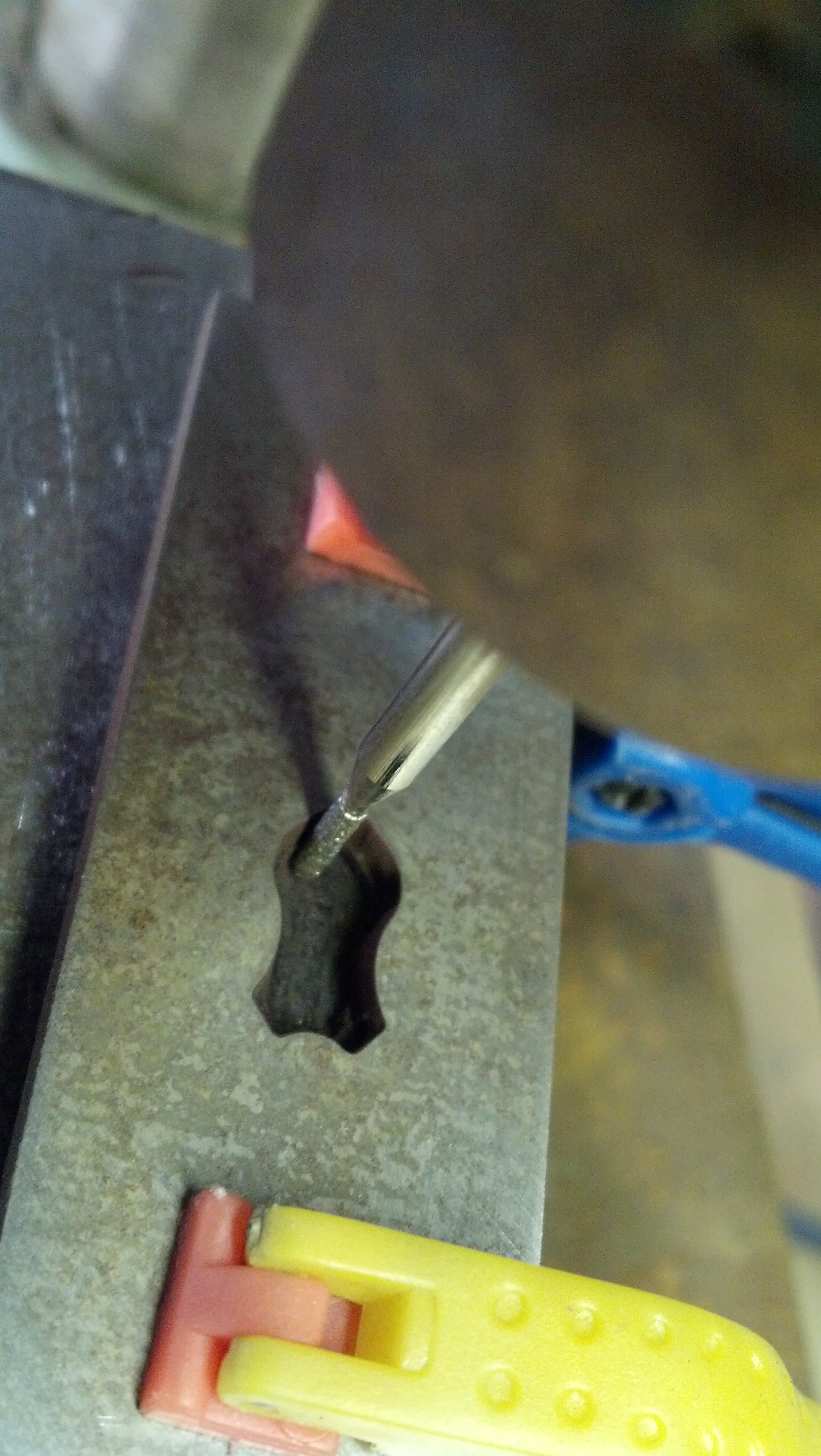

I then drill a series of shallow holes trying to only go the depth I need. I try to drill out as much as I can.

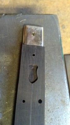

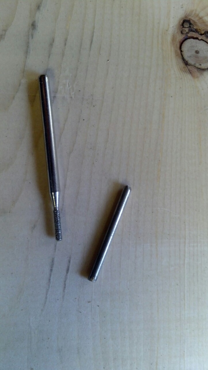

I then switch to a diamond burr for a dremel. Shown with 3/32 n/s pin material. I also have a smaller one but had problem with pics but looks just like this but maybe 1/16 inch

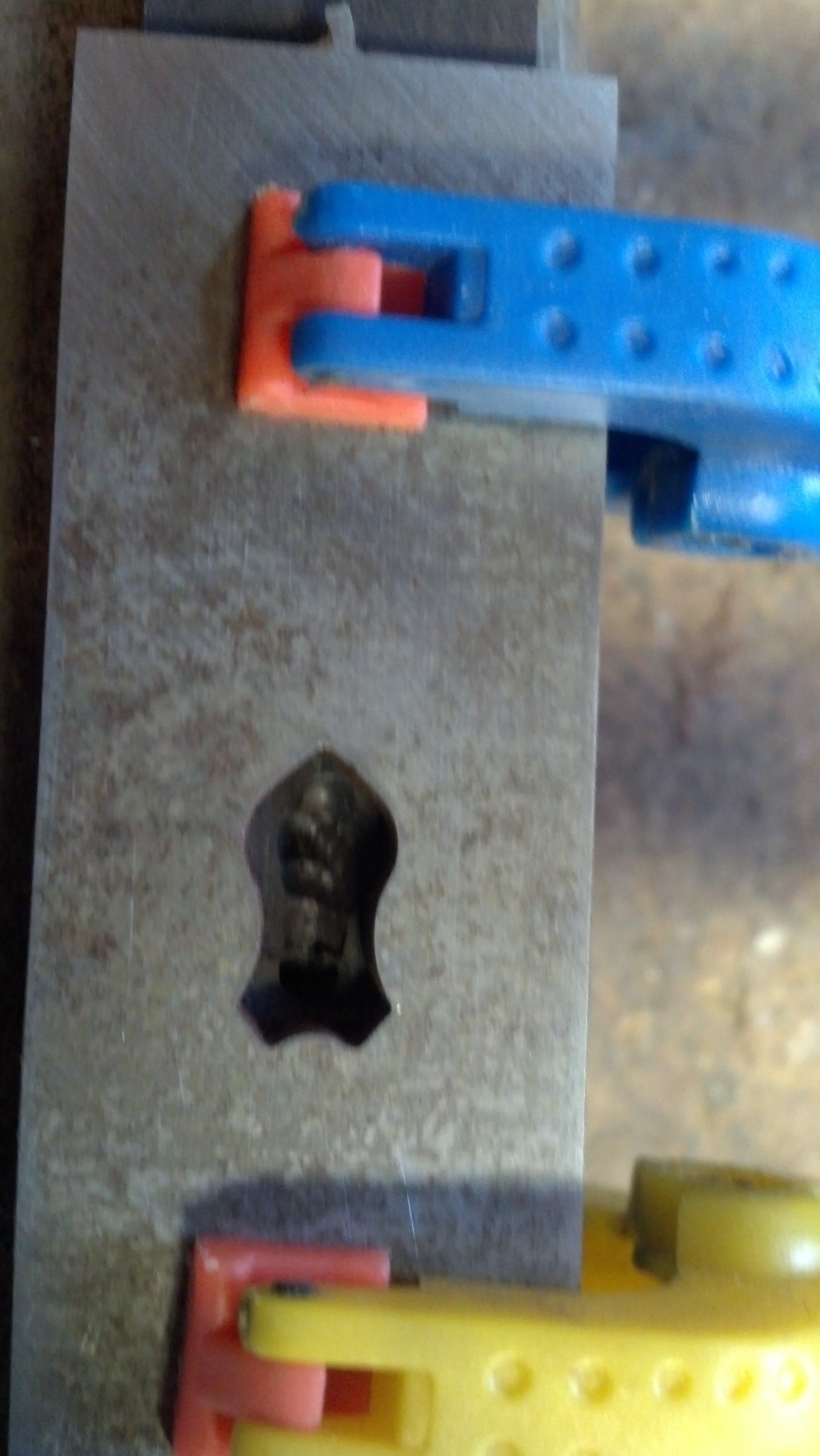

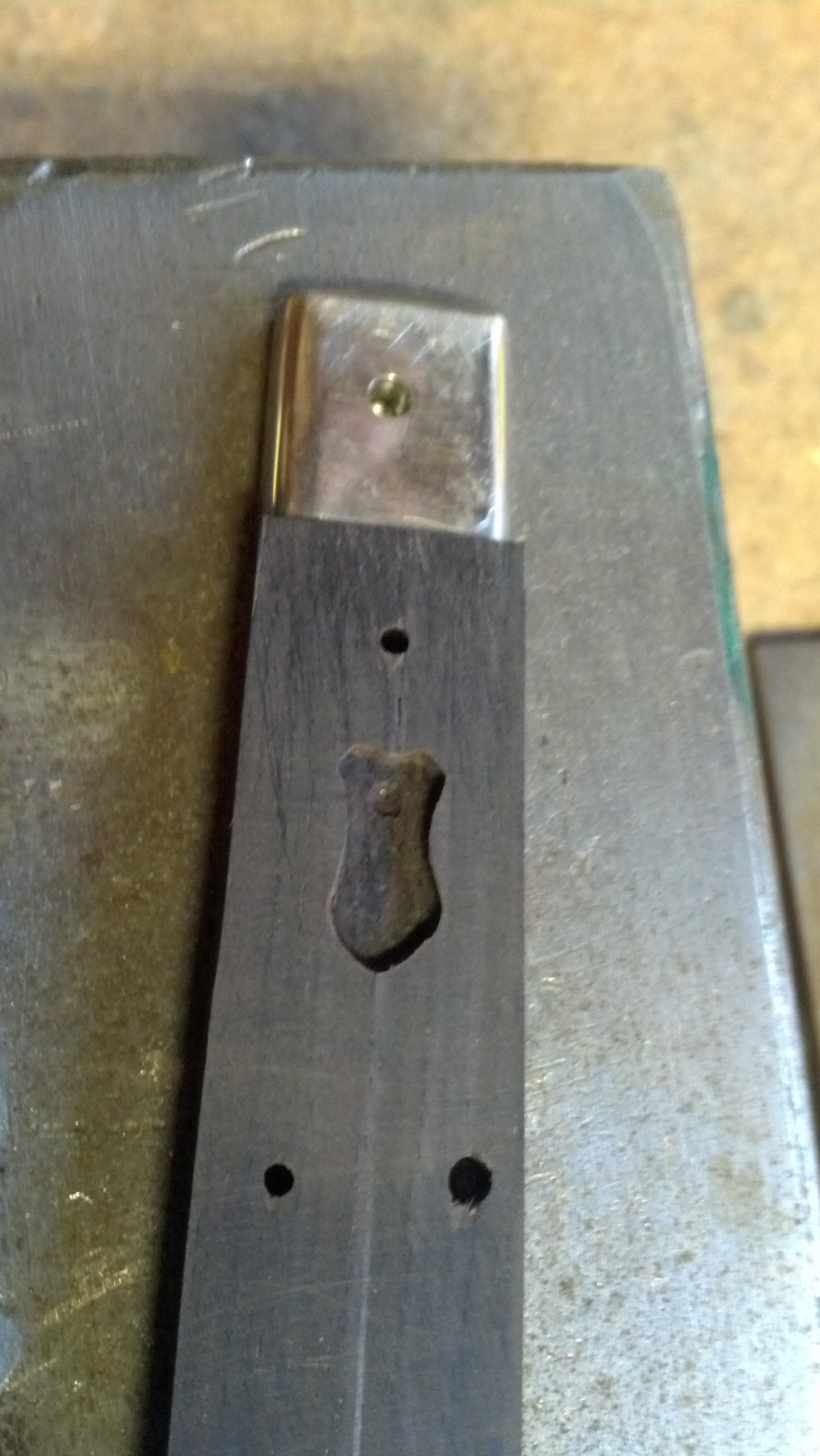

I then put the bit all the way up in the chuck on drill press. I move my steel block under it and lower the bit. I try to find one of the deepest holes that was drilled. You can only remove very small amounts of wood with this bit so I set it to barely remove any wood. I turn on drill press and move block around very slowly and let bit cut wood. I try to get as close to template as I can but with this big of bit it won't fit precisely in all the corners. When that level is done I go back to that deep hole and lower it again. Keep repeating till you get it the depth you want. I then switch to the smaller bit that removes wood even slower the the bigger one. This time I get right up next to the template as well as the whole "floor". It does take some time and I even move bit back up in chuck so I can remove block and take under better light to check progress.
Paladin 51
- Posts: 193
- Joined: Thu Sep 13, 2007 2:39 am
I check it numerous times to make sure I am as close to template as I can be. Then when I think I am done I take it all apart.

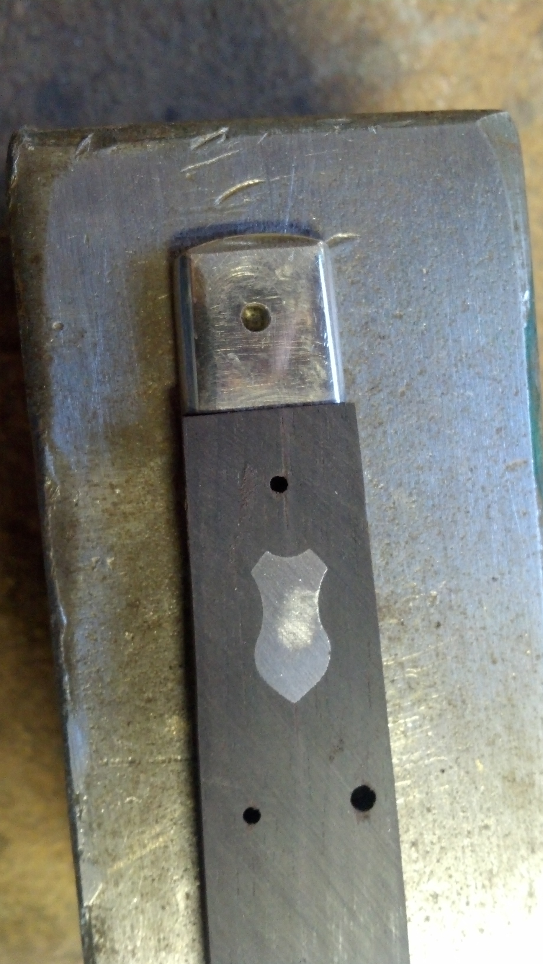

I then put some superglue gel in hole and with a few love taps with ball peen. Shabam I did lightly sand away some of the glue so you could see better.

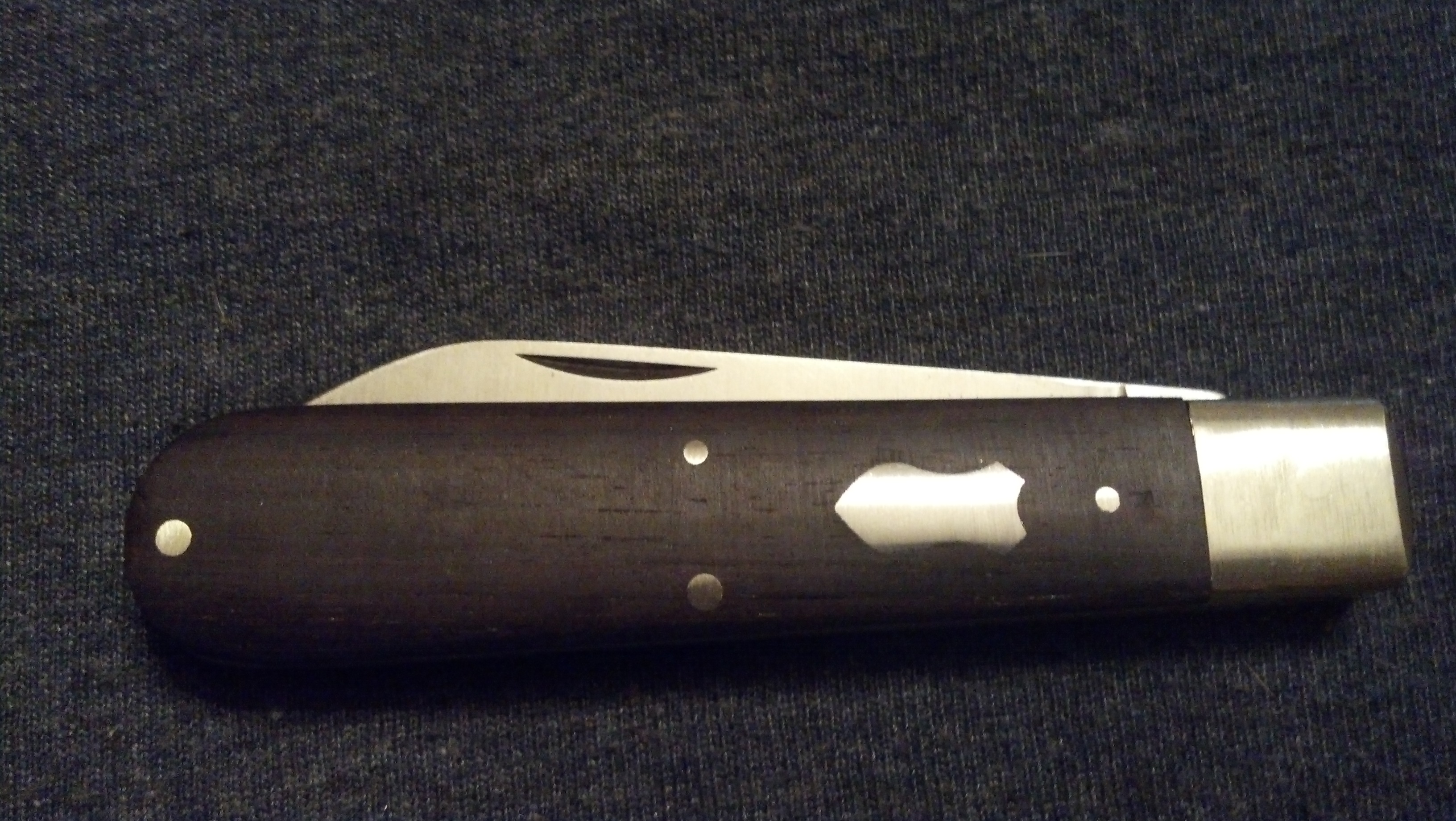

After a little bit of hand sanding. Is coming out pretty nice. I like it lots better than the maple. Overall I would guess I got about 3 to 4 hours in this but I did have to cut the scales out of 1.5 inch square by 4 inch long piece of wood. I do go slow as those diamond burrs don't cut to fast and they do break if you try to push the small one to fast.
Good job Ken. Looks like it was done by a true custom knife-maker.
