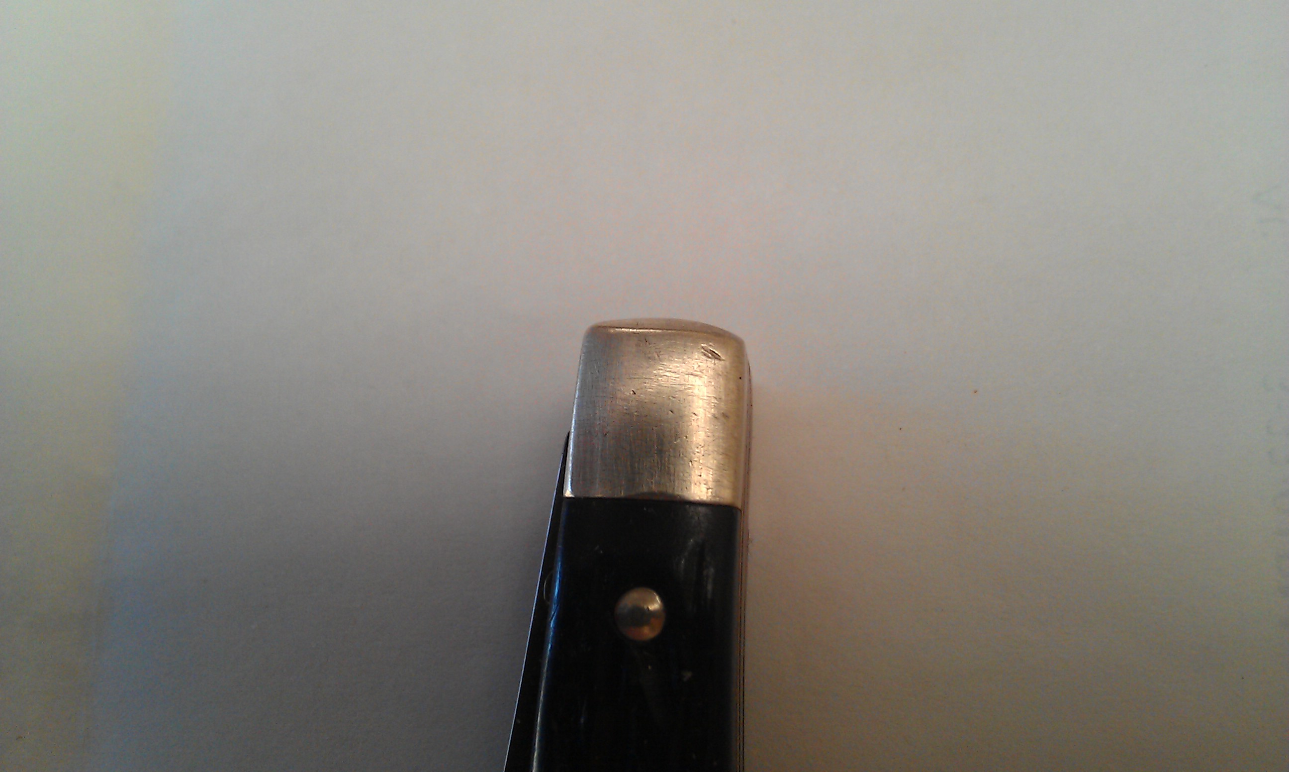

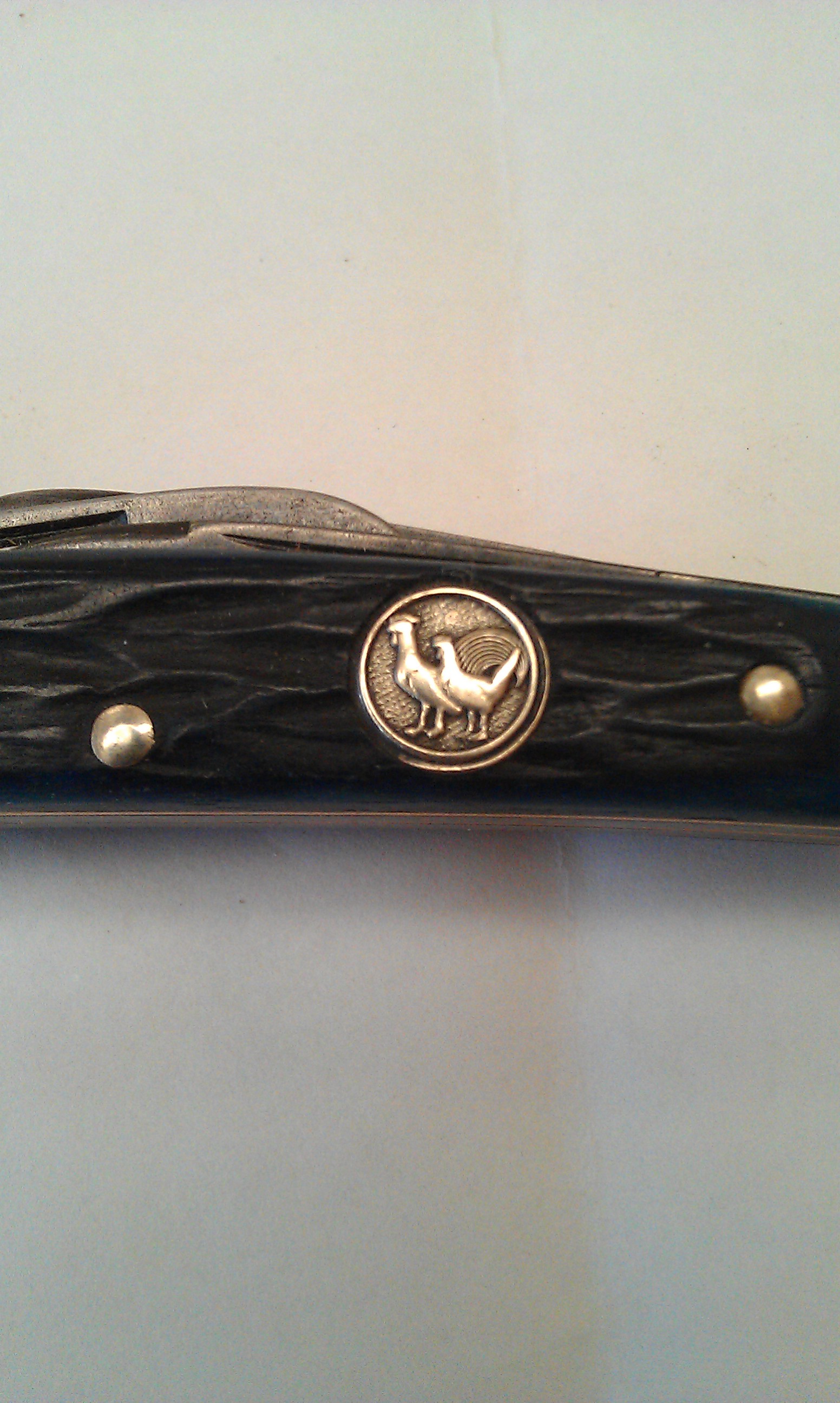

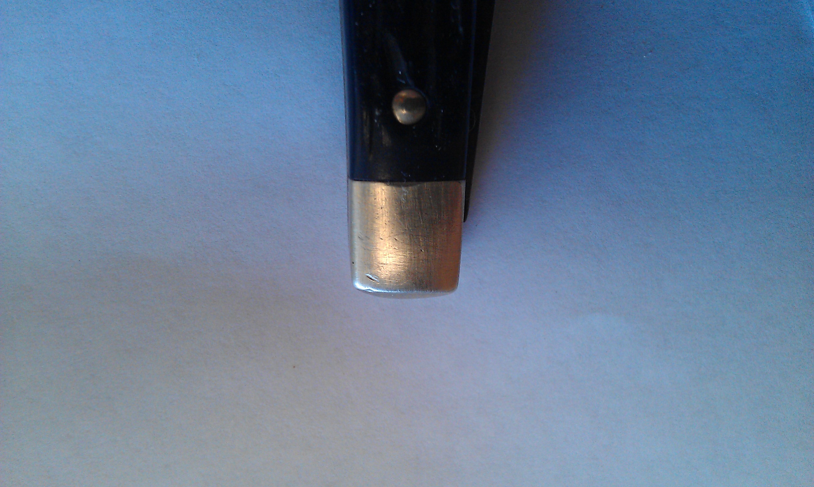

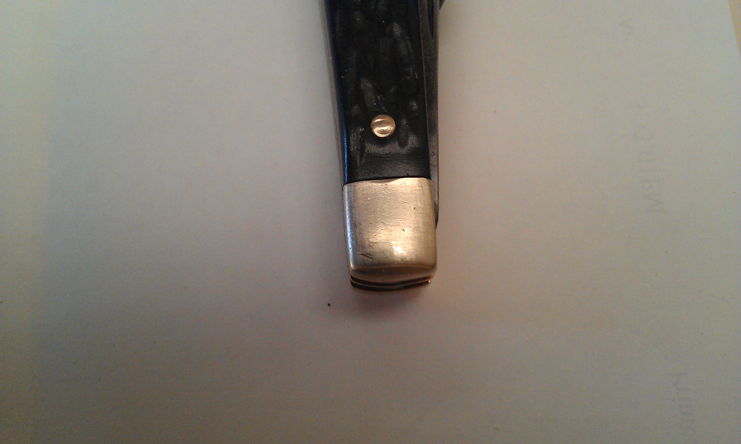

Ok here is a couple of images. As I said I find it very difficult to see those pins. Oh and by the way I am surprised by the amount of scratched etc. on the bolster.

Oops! I believe I see a pin in that last pic. That is a really great knife. It should clean up great without taking it apart. Does it have good snap as is? If it does , I would leave it alone but if you want to put on new handles, it will have to come apart.

I did a search on the word visible in the restoration section but did not see anything other than using a punch and giving the thing a wack to try and make the pin start to partrude a little. One thing I have learned after a couple repairs. Keeping things as square as possible during disassemble is very important for getting a good fit on reassembly. I also went back and looked at the pics again. Like you, I still see no sign of a pin.
