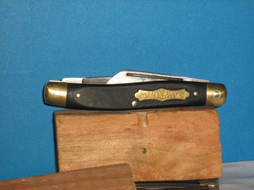

I finished this Schrade up for my friend at work. It came out OK but I did get the thing too tight. I think I will have to use more space in the future. The pins are OK also but I need lots more practice. It should be a fine EDC for him and now he does have a knife that is not broken.
