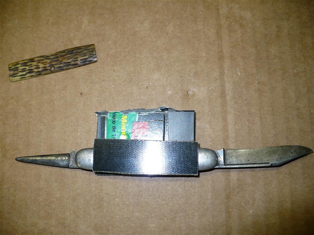

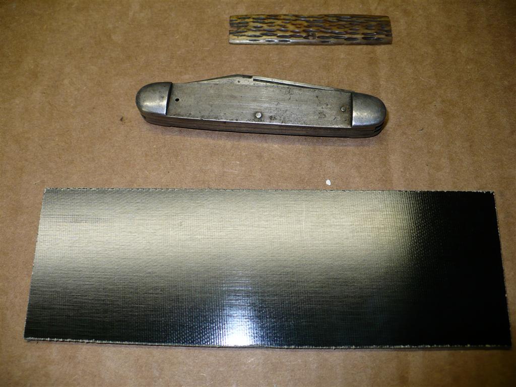

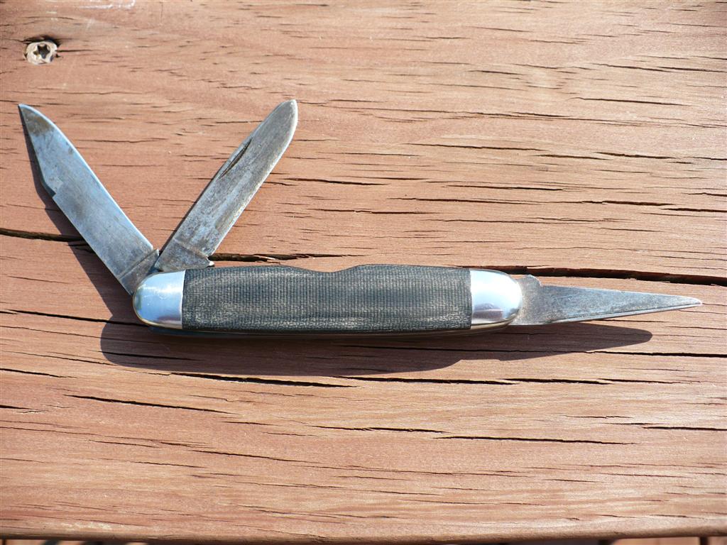

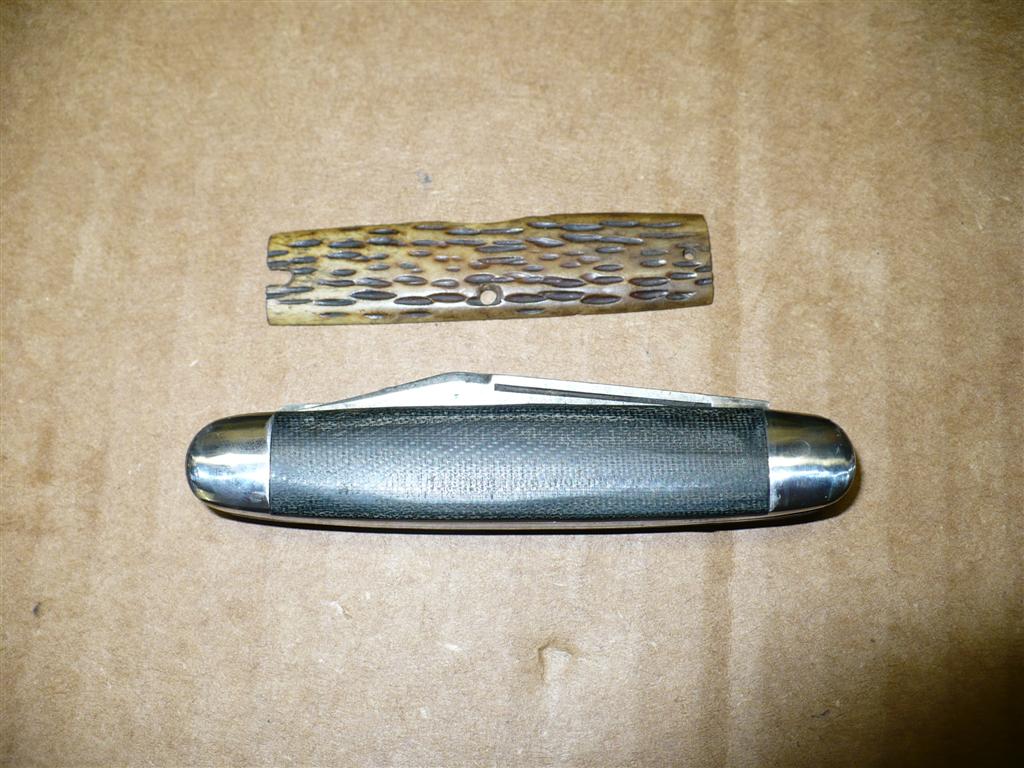

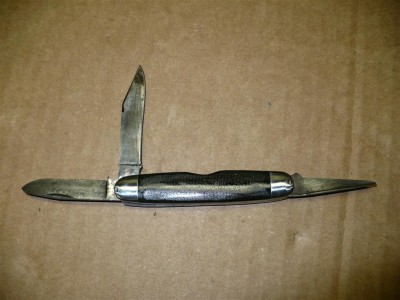

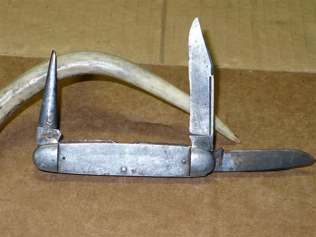

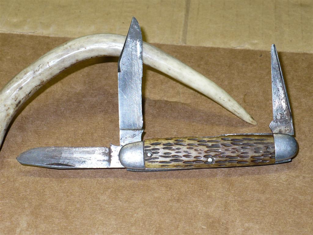

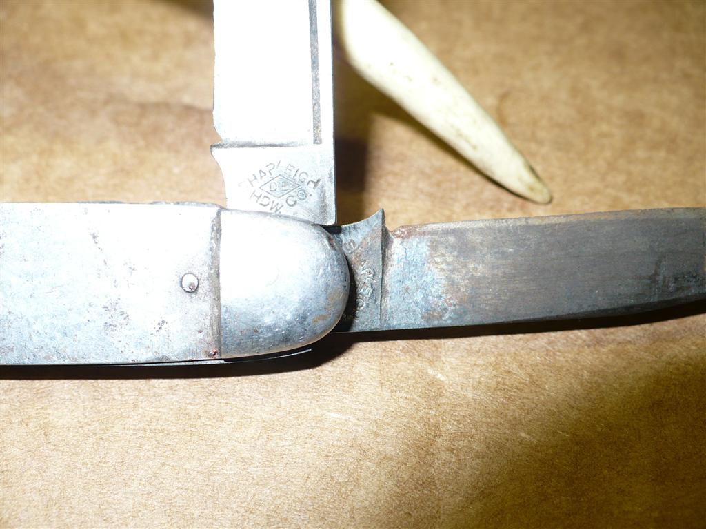

Here is a nice DE Punch I ran across that was in dire need of scales but in pretty good shape otherwise. I wish I could have salvaged the bone, but it was too far gone.
Before
Before

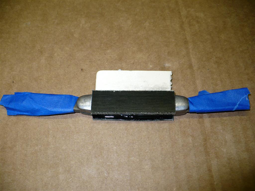

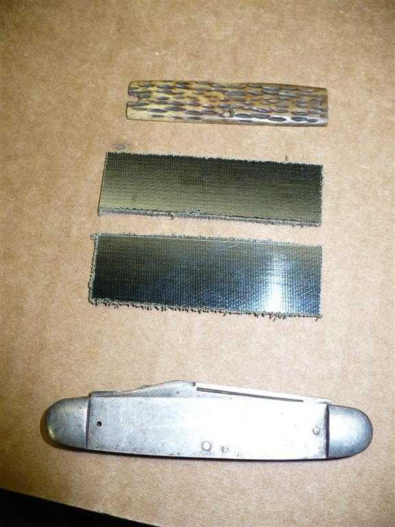

Paper Micarta
Rough cut
Glued on

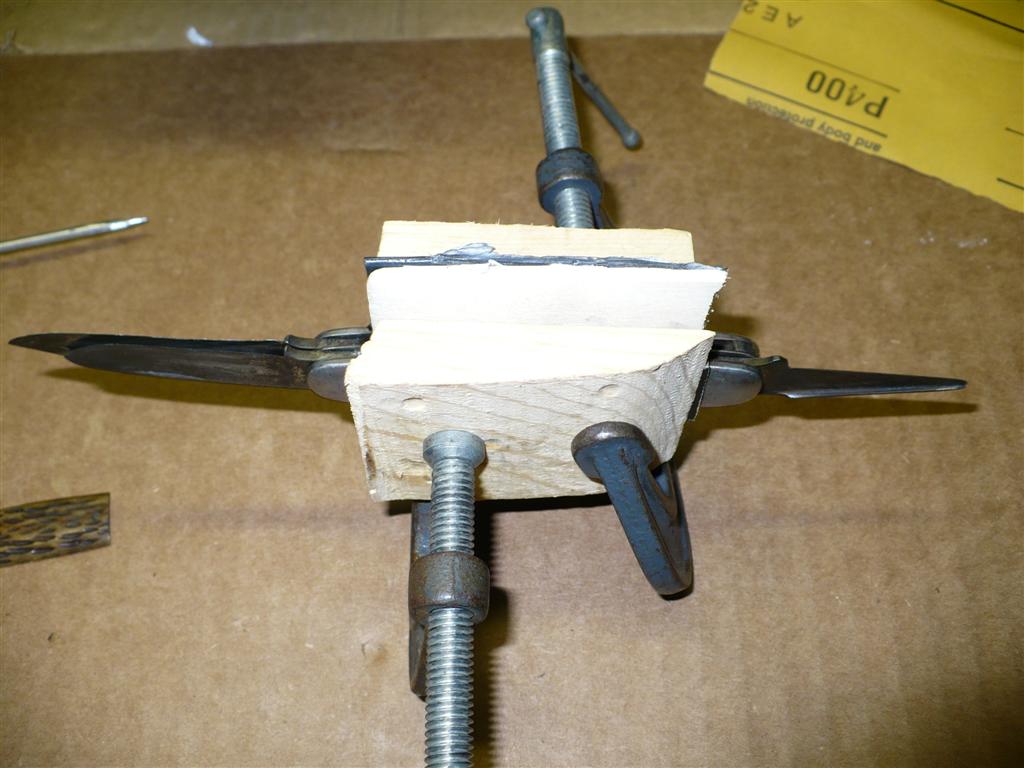

Clamped
Dry, ready to shape

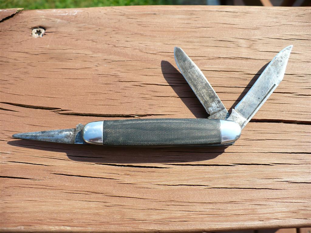

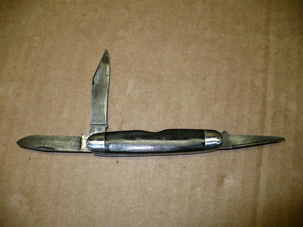

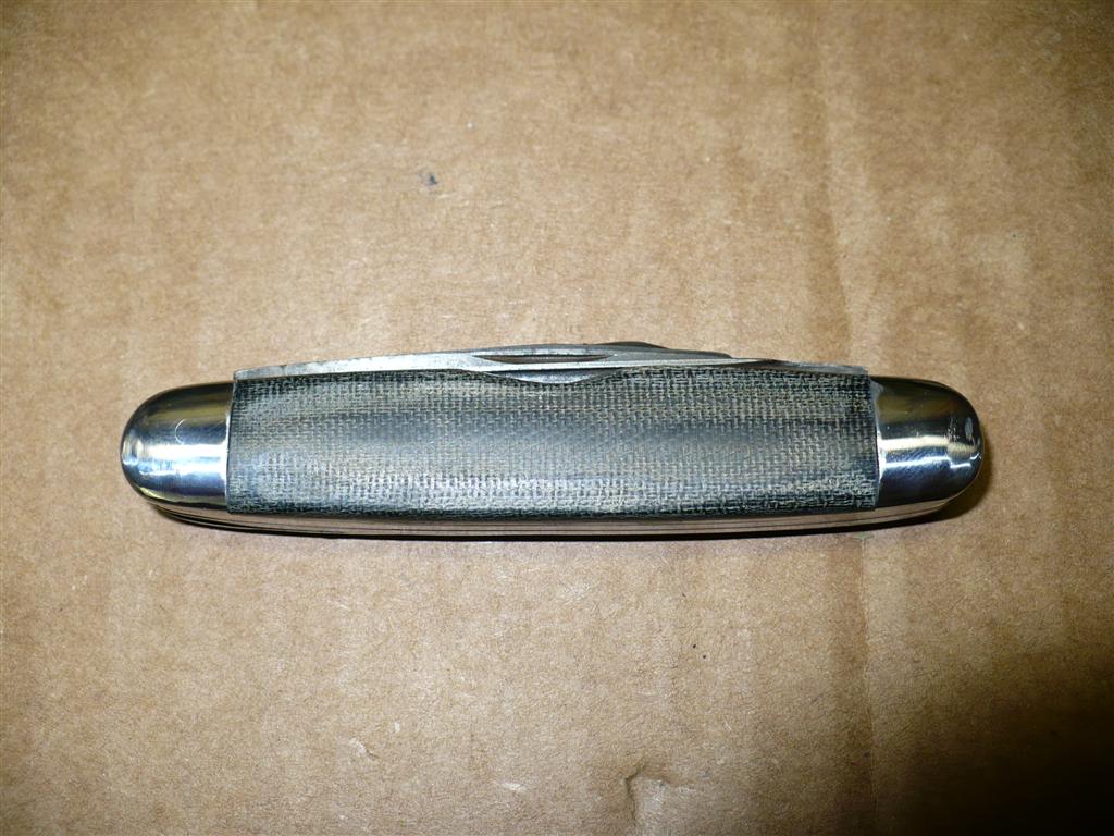

And I got busy working on it and half forgot to take pics and half didn't want to get the camera so dusty. SOOOOOoooo, here is the finished product. Dry, not oiled yet.
I was wanting to keep the patina on the bolsters, but that was impossible, So I plan on carrying it with keys/coins/etc. to bring back the dullness/patina to match.

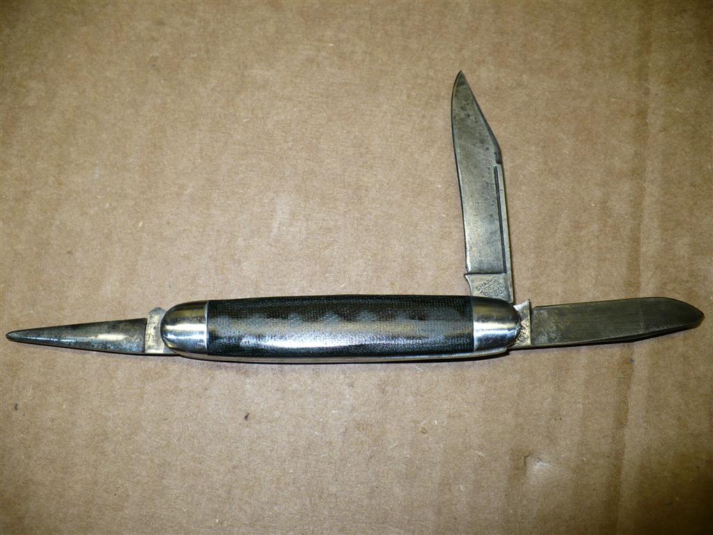

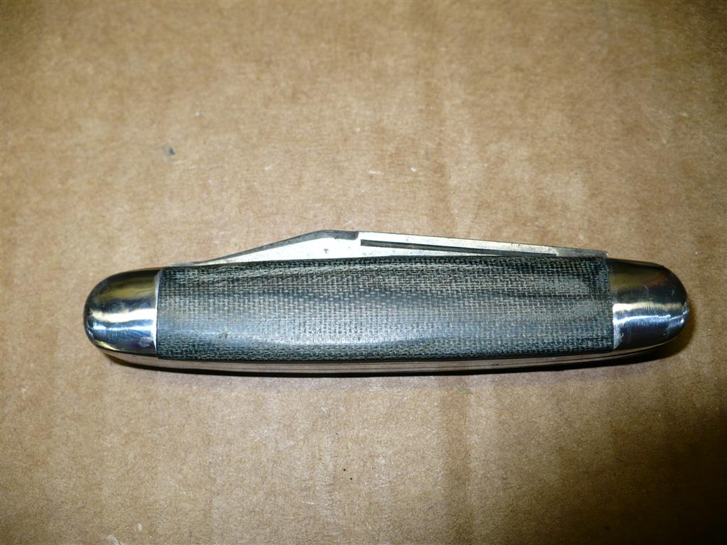

Oiled
Oiled Pile side
Finished with original bone. I may try to sand the scales a bit more, but carry it for now.

How did you get the handles off without taking the knife apart? I see one handle pin hole broken. Did you replace the hinge pin? Great looking restoration!
Simple Man
Posts: 624
Joined: Mon Jun 08, 2009 3:06 pm
Re: Shapleigh DE Rescale Project
Post by Simple Man »
Thanks for the comments, I like the HOK's (Honest Old Knives) and especially when they able to be revived. Lot more character than most new ones. This one had good liners, action and pretty decent blades.
Na, the pile side scale was missing totally and the front scale was wobbly loose. All it took was a light prying to release it from the hinge pin. I have not gotten into re-pinning any yet, so I just dremeled them down flush to the liner. One I did previously, a Spyderco Kiwi, I used a small sharpened screwdriver to gently remove all the (bone) scale material and scrap all the glue off.
Only thing I really don't like about this one is the vast difference in patina between the blades and bolsters, but I'm not about to polish the blades. The bolsters will catch up soon enough.
It still doesn't have any more monetary value than it did before, but breathing new life into one and letting it be used is worth much more. Don't be afraid to dig into one, what are ya gonna to tear it up worse? ::doh::

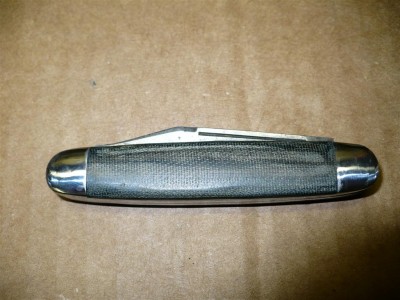

Here are a few updated pics that show the color/texture better. I also sanded the scales a some more. I'm callin it done.... ::undecided::
