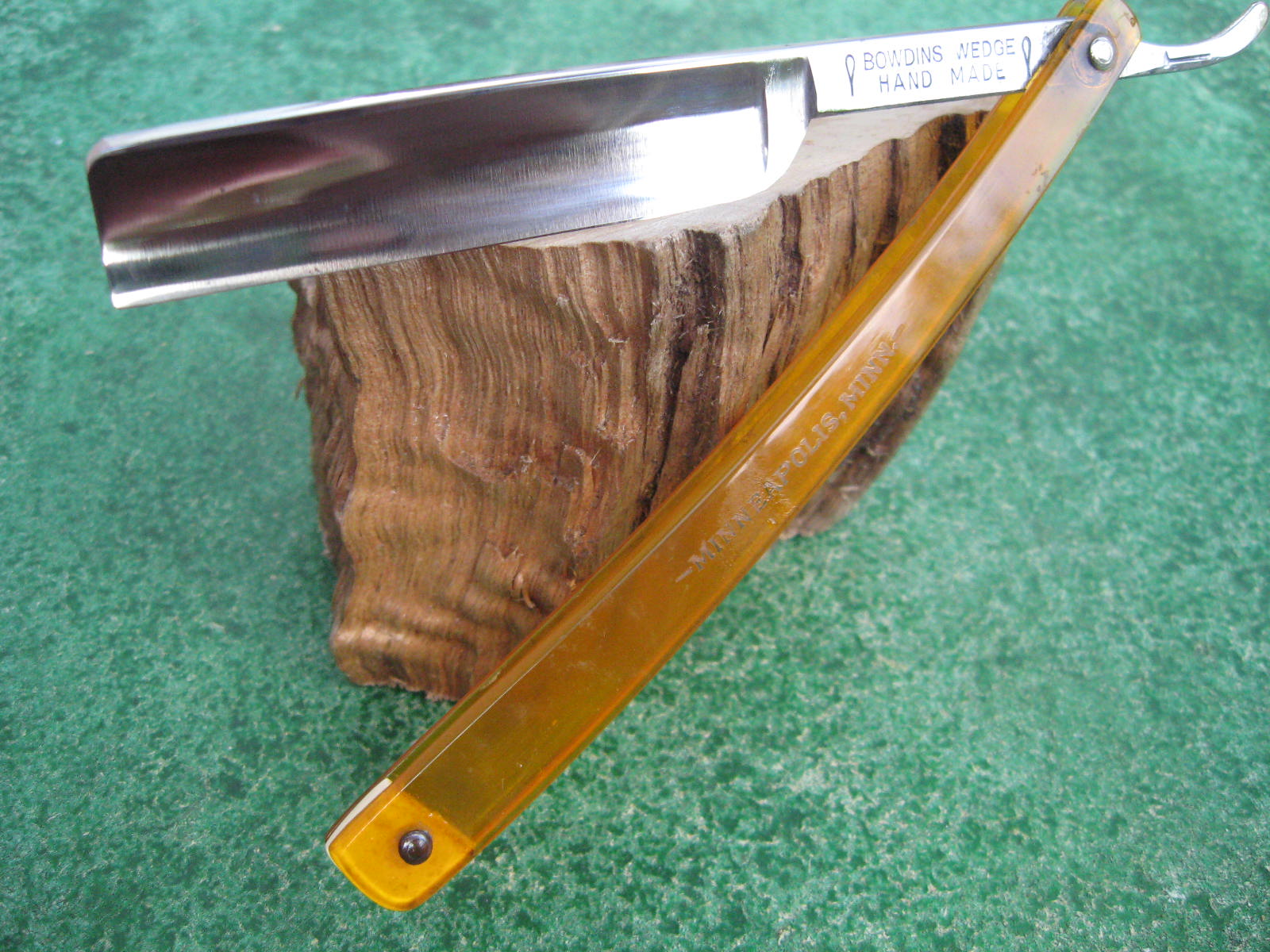

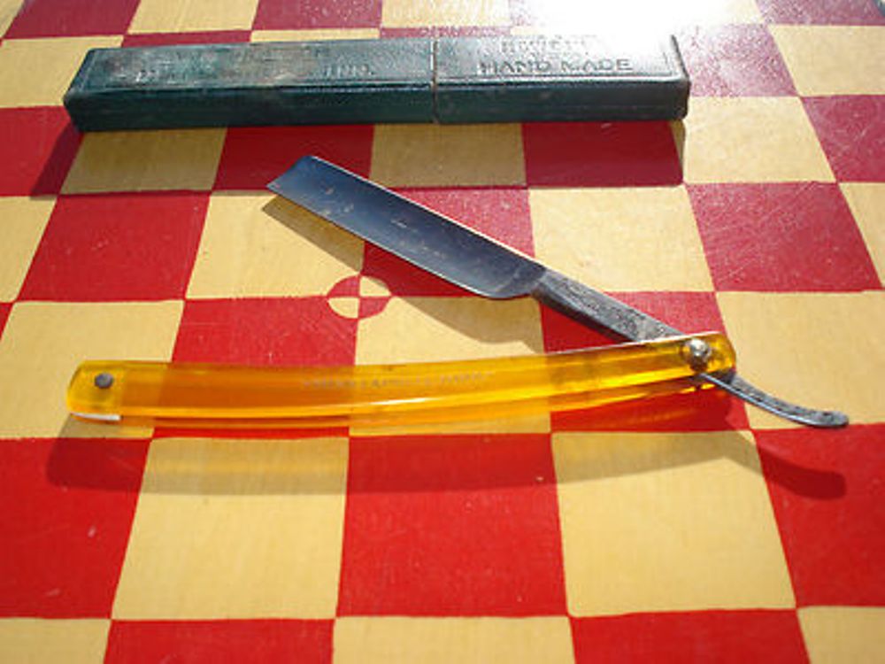

Here's my first "shave ready" project; a Bowdin's Wedge circa 1950? or therabouts. Here's what it looked like when I first bought it:
Shaved with it and it was fair, but it still needed some more work on the edge. That done, I'll test it out again tomorrow. I don't think it had ever seen a hone before.
After I first buffed off some of the discoloration using a Dremel tool with a felt wheel charged with compound, I polished it with some Mothers Mag & Alum. polish, then took it to the hones.
There were a couple small pits that wouldn't buff out, but they don't affect the function at all. They could be hand sanded out with Wet or Dry paper, but it is a lot of effort.

Tried out the Bowdin wedge tonite, and it shaved very well. It may still need a hundred licks on the strop, but quite acceptable.
One more for the rotation! That makes two!
Now where'd I put that old Puma....
