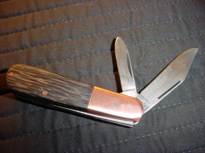

It worked for me.
This is the only knife I tried it on.
I used them on the pivot pin and peened and sanded them just as you would with regular pins.
Just need to let them stick up more before peening.
They will get mashed up but after sanding the design will come back.
This knife works and functions perfectly.
JW

@knives are quiet - I had a feeling they would work ok for pivots. After sanding, yours look pretty clean. Did you have to pick out any debris ?
No not that I remember.
I did this knife awhile ago.
I think I just wiped the knife down after sanding with WD 40 or similar.
JW
