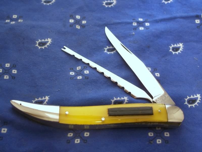

After agreeing to do repairs for KA-BAR on vintage folders I have been getting a few in. Here are a couple of the most recent ones.

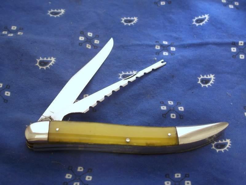

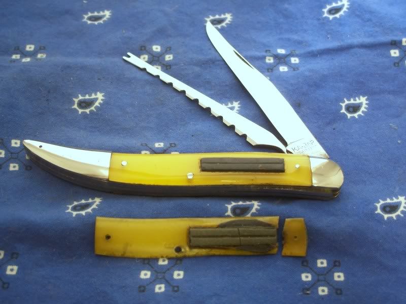

This T29 fish knife was in rough shape, scratched up blade, melted front handle, broken stone, weak snap, broken hook degorger, mangled rear bolster ect. The knife belonged to the gentleman's great grandfather and he uses it while fishing to this day. I cleaned it up, put on an original front handle w/ stone, repaired and reattched the rear bolster, improved the snap, and retipped the hook degorger

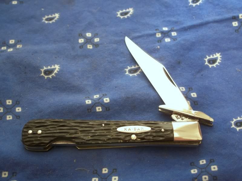

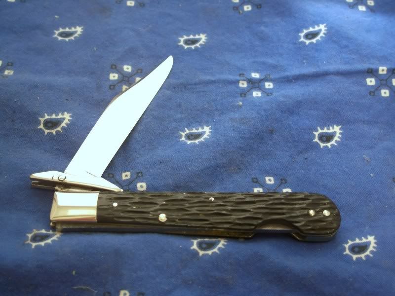

This Lockback swinguard didn't come with a story but it was requested I clean it and fix the terribly bent lockbar that was affecting lockup.

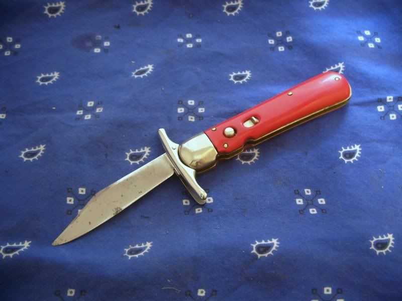

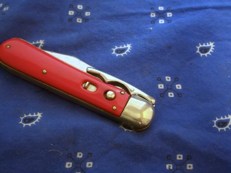

And just for fun, a Schrade Hunters Pride made for sears (craftsman) with smooth orange composition handles, it just needed a set of replacement guards which are nearly impossible to find so I make my own reproductions.
