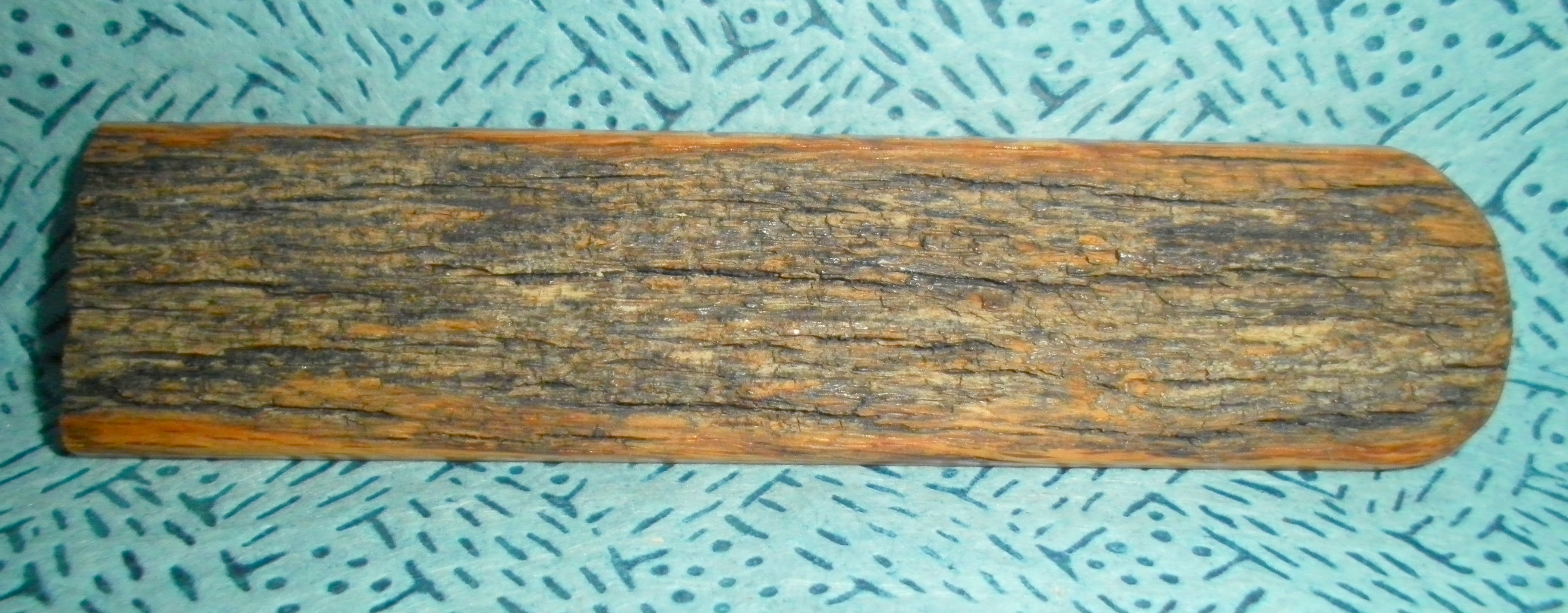

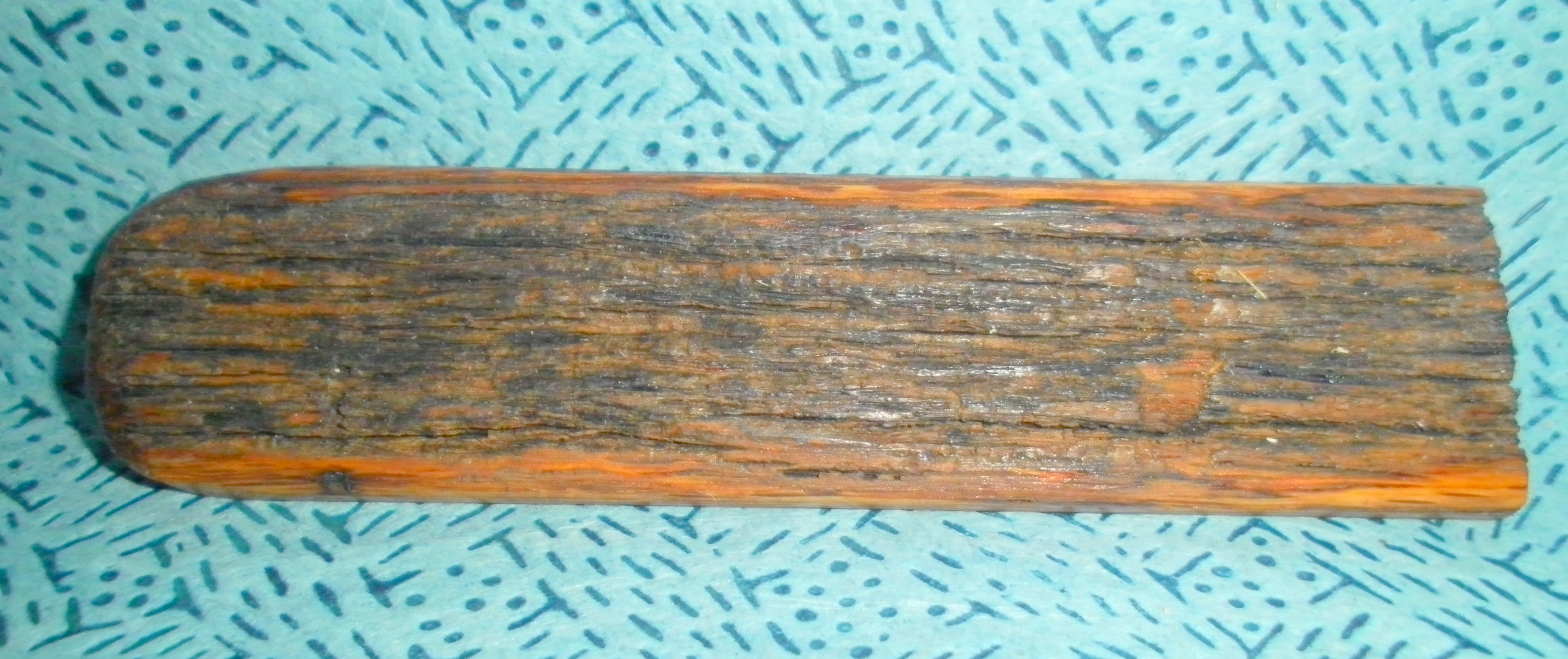

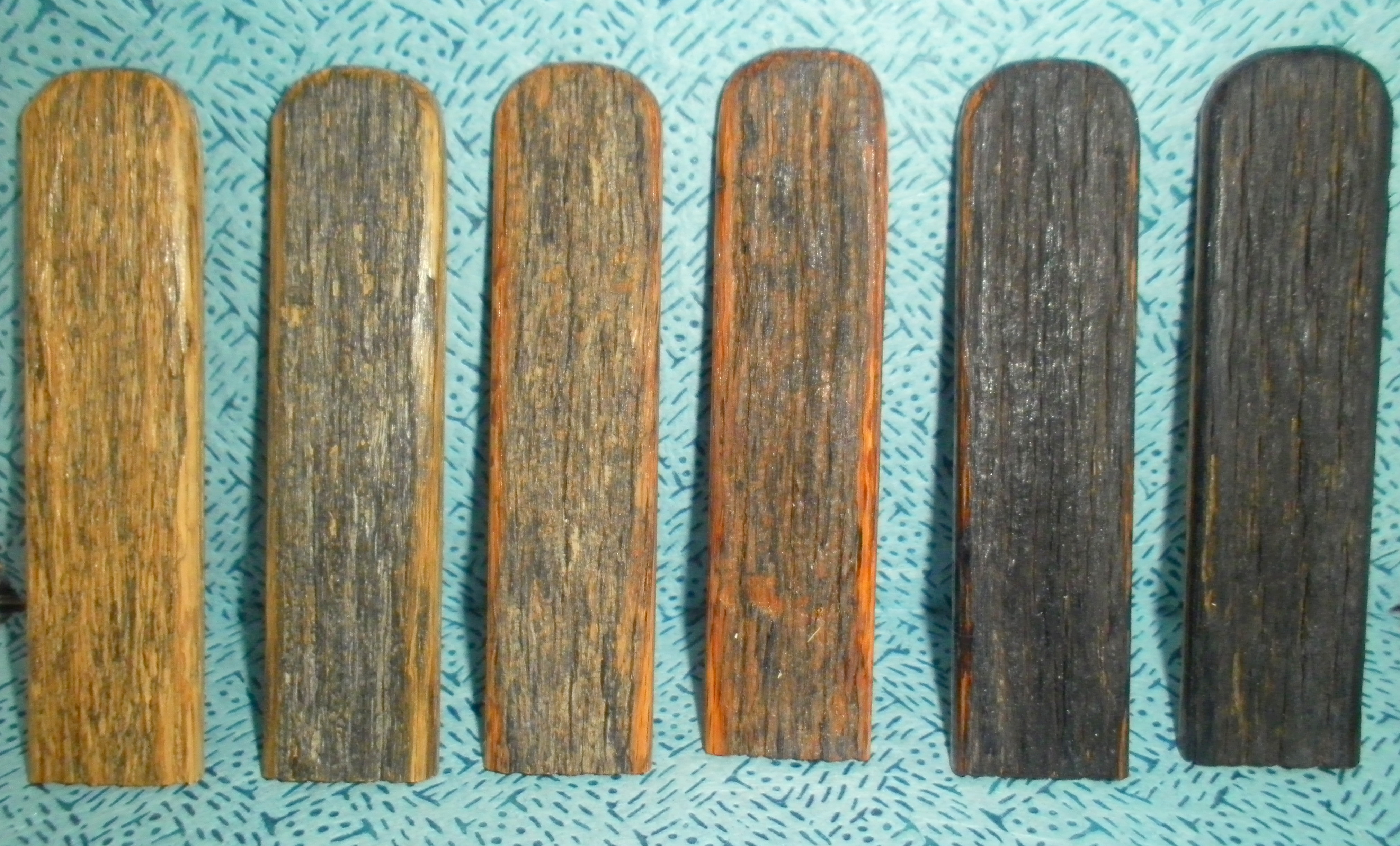

Here's an idea i've been playing around with for knife handles. These are made from antique Chestnut from a 120 year old barn we tore down several years ago. Weight wise, they're a bit on the light side, but thought about routing a pocket in the back and adding lead weights of some sort to beef 'em up. I used a few different proccesses to get different effects.
I kinda figure that if it was tough enough to survive 120 years of Ozarks weather, it should hold up as knife handles pretty well.
WB

I think it would be to your advantage to find some way to impregnate them with epoxy, polyurethane, what ever. I may have the materials wrong but you get the idea. The handles look great but they need something to give them some durability. IMO

I would have it stabilized.
There are a number of companies that provide stabilizing services. I know K & G does stabilizing.
Stabilizing will add substantial weight to the handles plus make it extremely durable.

I really didn't think durability would be an issue. I guess I was thinking in terms of it having weathered 120 years of everything mother nature could throw at it. That ol' barn would still be standing, if the landowner hadn't wanted it taken down so he could put up a new metal barn. On raw wood handles, I do seal the surface, but just to keep dirt and polishing compound from penetrating. A commercial grade thin set superglue (cyacrylinate?) works real good for that. Chestnut is naturally resistant to rot and decay.
I'm not sure the lead would be a problem, but maybe a small piece of steel inset in the back would be a better choice. They wouldn't need much, just a bit more heft wouldn't hurt.

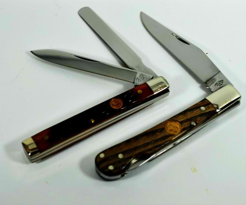

Canal Street currently has a line of knives that are handled in reclaimed chestnut wood which came from a barn in Hopkinsville, Ky. It is some fine handle material. Below is a picture of one (on the right) that I "borrowed" from a current AAPK store listing. (Thanks Redtrout, hope you don't mind)

I like that series from CS, Phil!
When it's planed smooth, Chestnut resembles oak and is an open grained wood. I imagine Canal Street probably did have it stabilized (and possibly dyed) for their knives.
