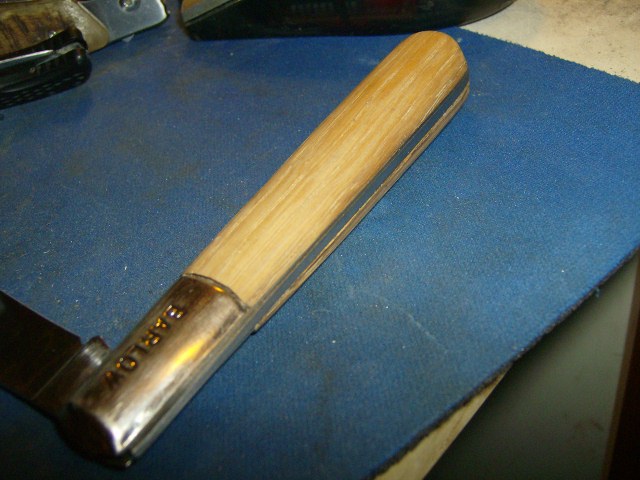

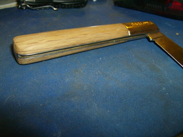

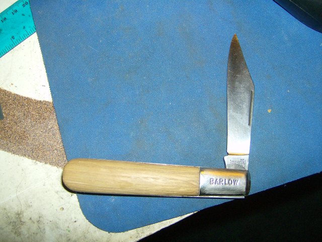

Hey guys! I did an Imperial Grand Daddy Barlow a couple years back. I used the oak from a half rotted wine barrel for scales. I cut flat slabs of good wood and then traced out the shape of old scales on the oak. Cut to shape. Hollowed out the scales until fit the the shell and then glued them on! Hand sanded to a final fit. Here's how it came out.
Maybe I'll stain and polish her some day
Randy

I LIKE it Randy...nice and those oak barrel scales
kinda like them them natural......! Doug want to see some finished product...hope you're learning.......as me....!

Nice work Randy. I may end up putting some wood on the shell like you did. I think that would probably be the most cost-effective route.
However, I really do have a strong desire for another amber carved stag bone knife since I sold my Queen Mountain Man. If I could get some of that on this frame I would be very happy!

Thanks guys! Doug that stag sounds real sweet! Let everyone know how your project turns out. I may try some stag at some point. But shaping stag to the shell , I like to save as much of knife as can , won't be as easy as carving wood. I have another Imperial Barlow apart right now. I am thinking of aluminum bolsters and Tiger Stripe Maple. When I find the time that is! We sure have a lot of talent here in the AAPK! Keep up the great work
