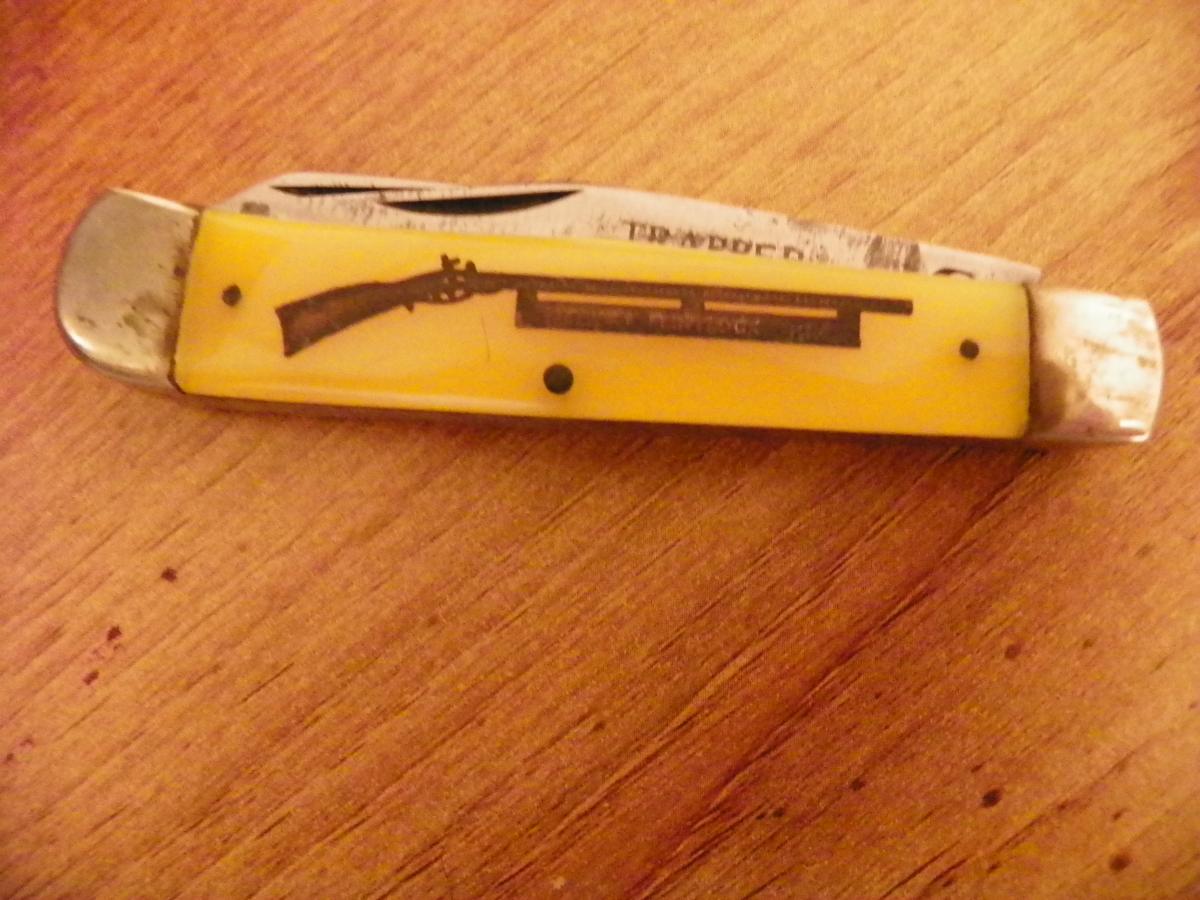

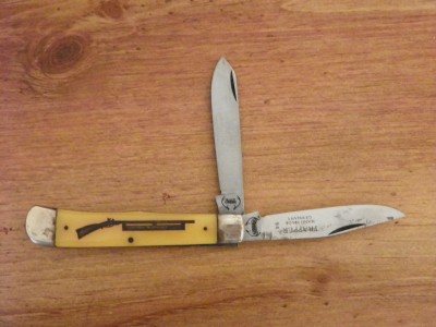

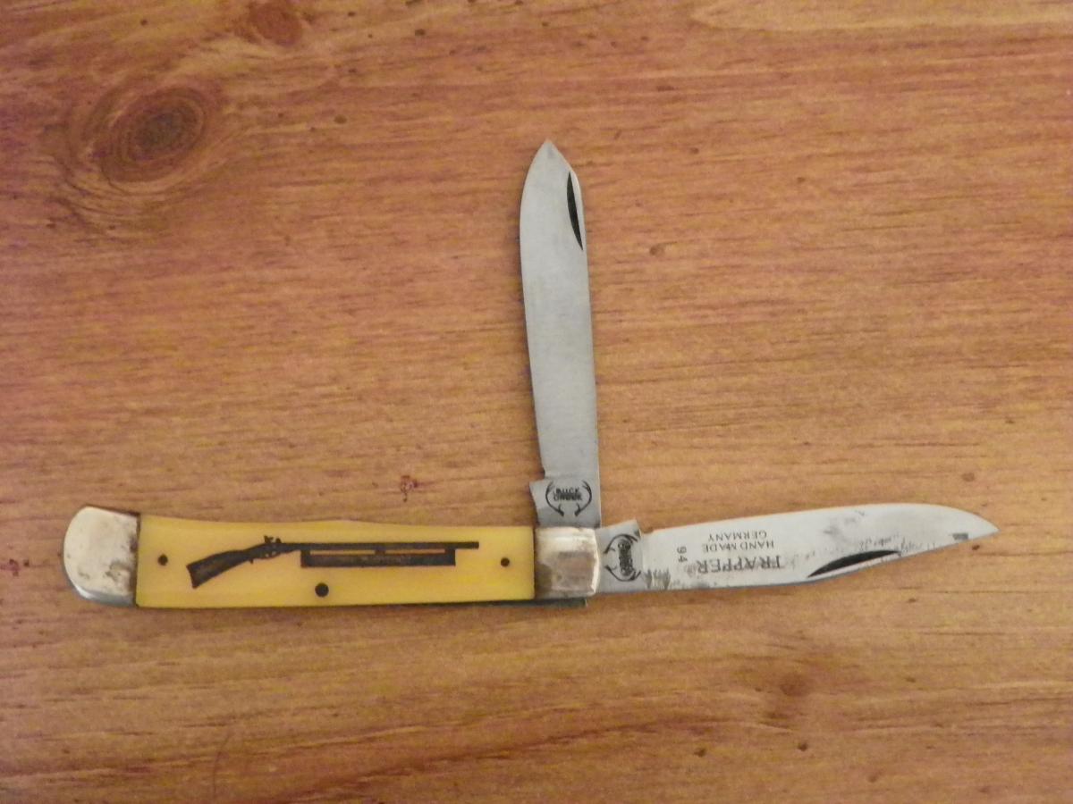

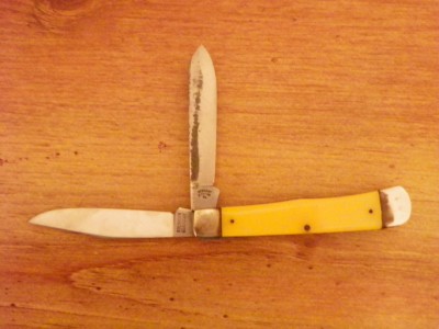

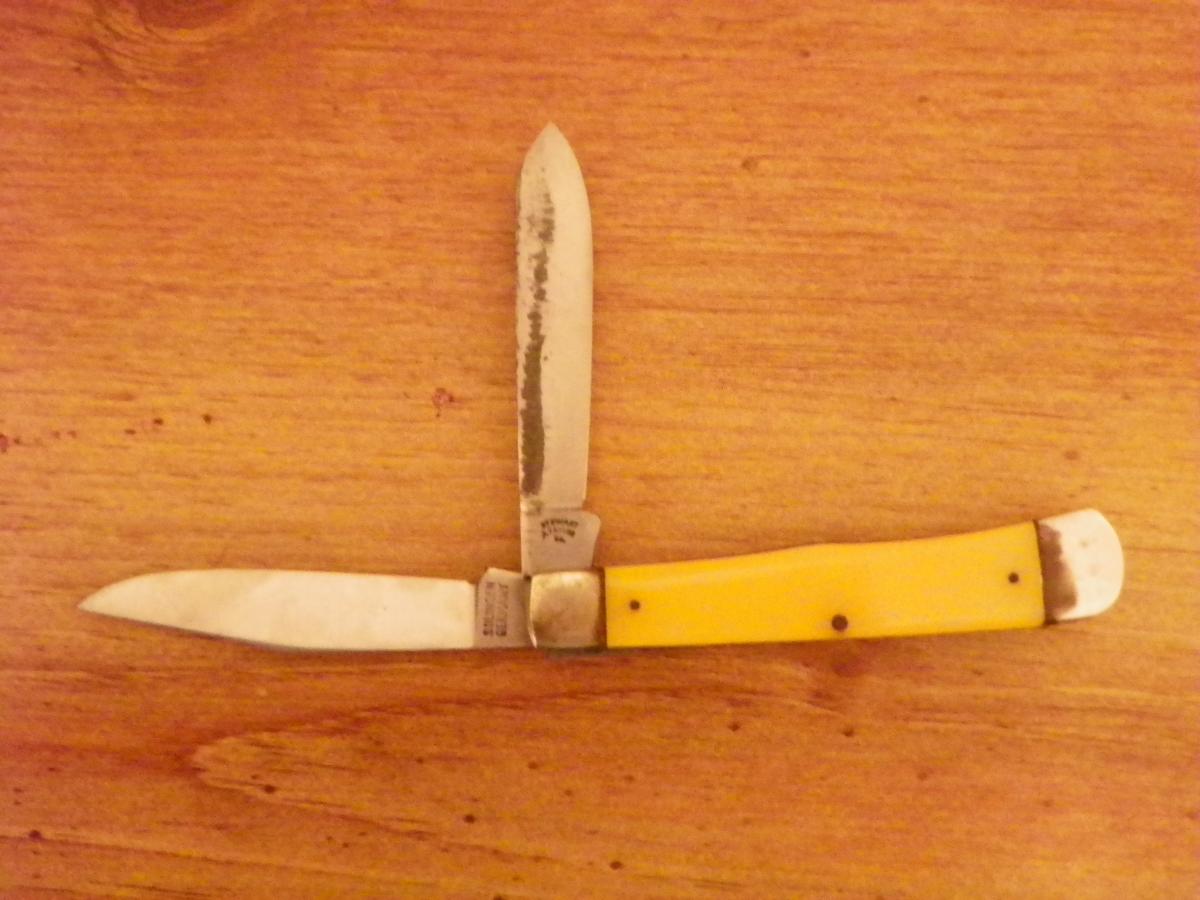

The one I have was made in 1994. It is yellow handle with a Kentucky Flintlock Rifle on it.

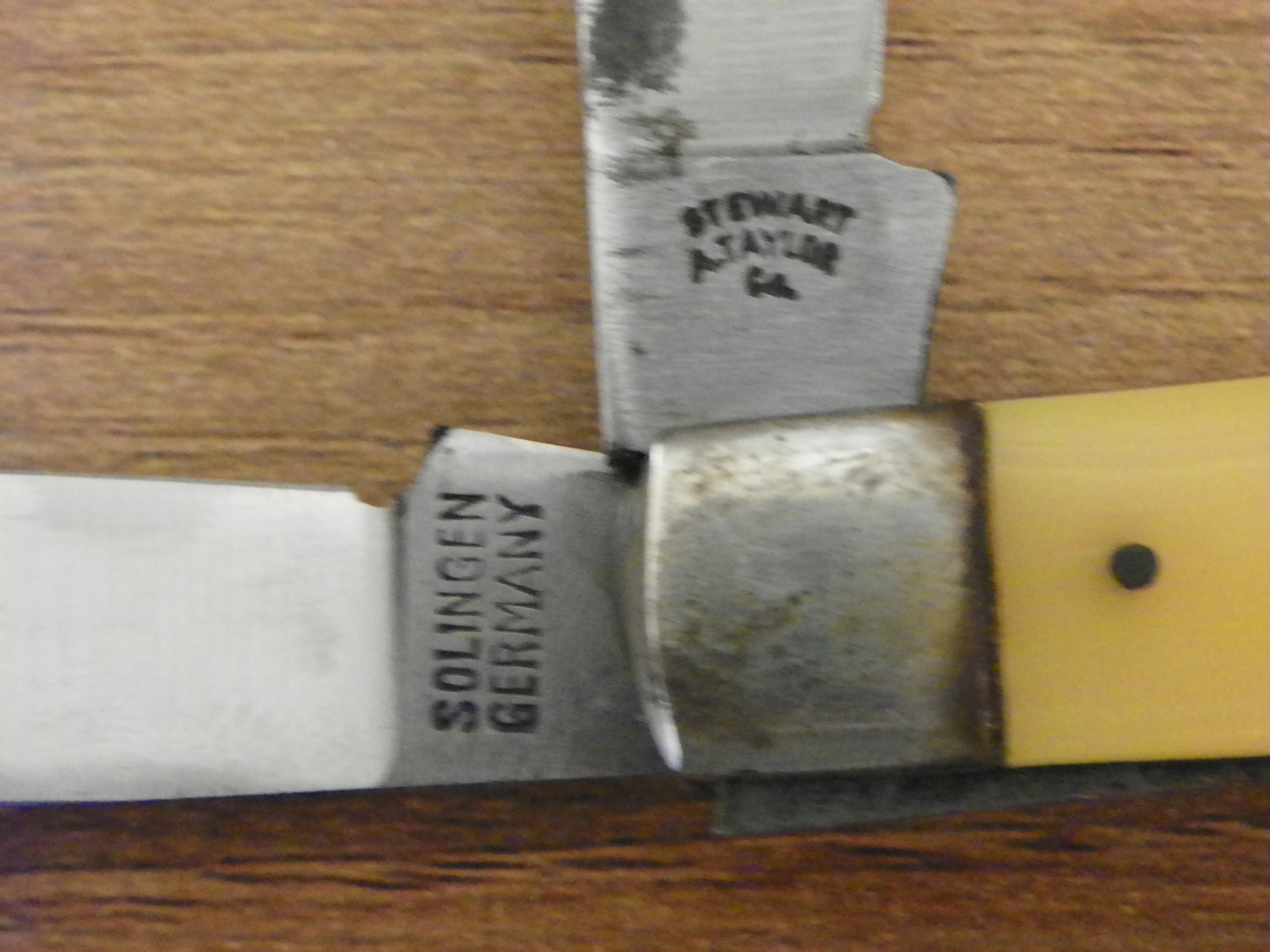

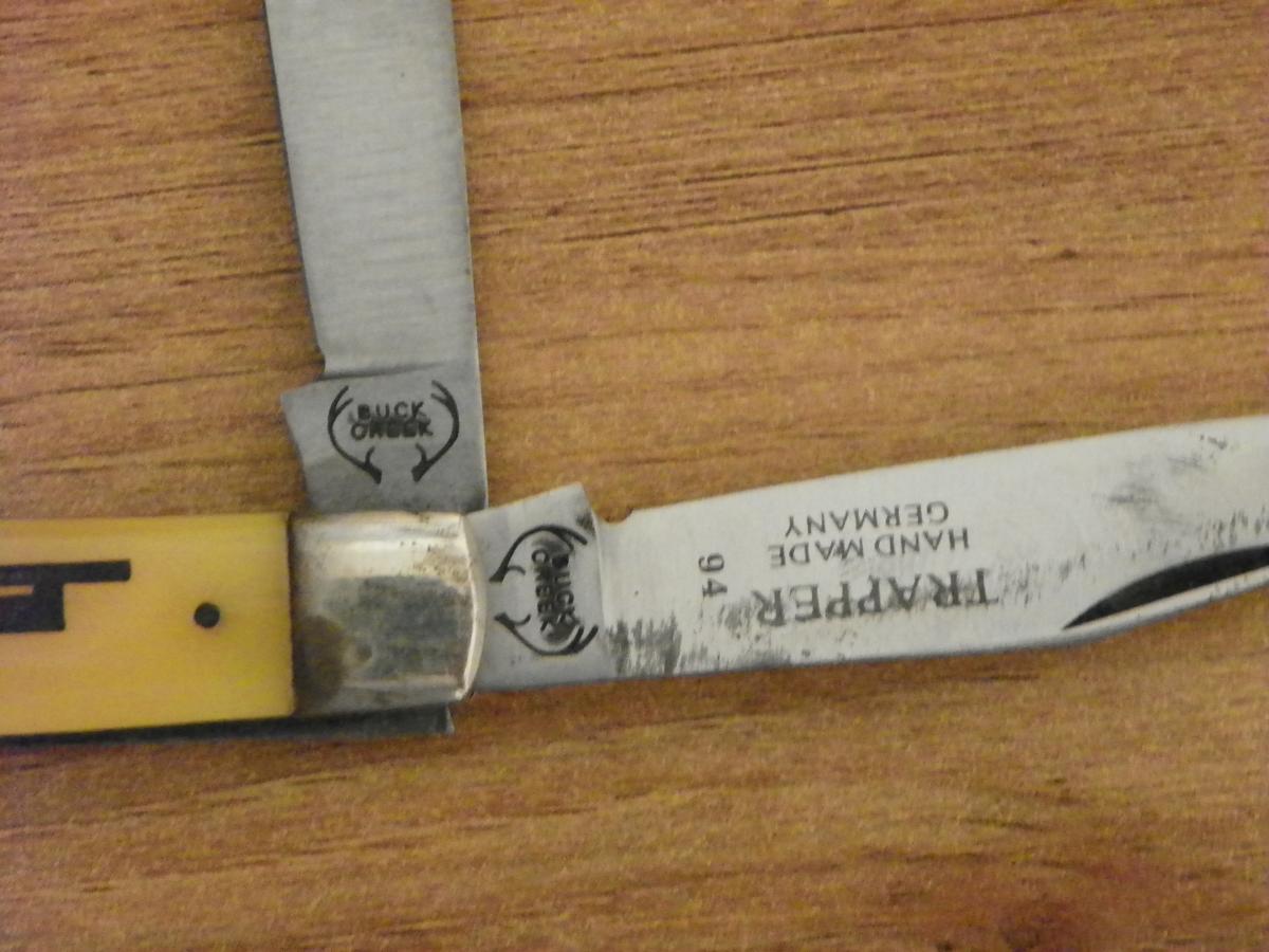

Sounds like the same name knife only with 94 stamped on it. Will try to post pic.

bryan, nice knife, but unfortunately it looks like you have some celluloid gassing problems with that knife. the tops are the blades are at an advanced stage of tarnish. a very good indicator of gassing. leave your knife in the open. don't store it in a closed enviorment, especially with any other knife or metal keepsakes.

The 93 & 94 numbers mentioned are the dates of manufacture . Earlier Buck Creek knives were of excellent quality (comparable to German Eye) .

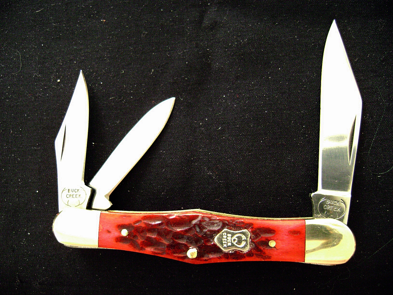

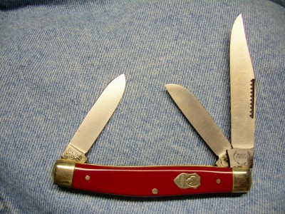

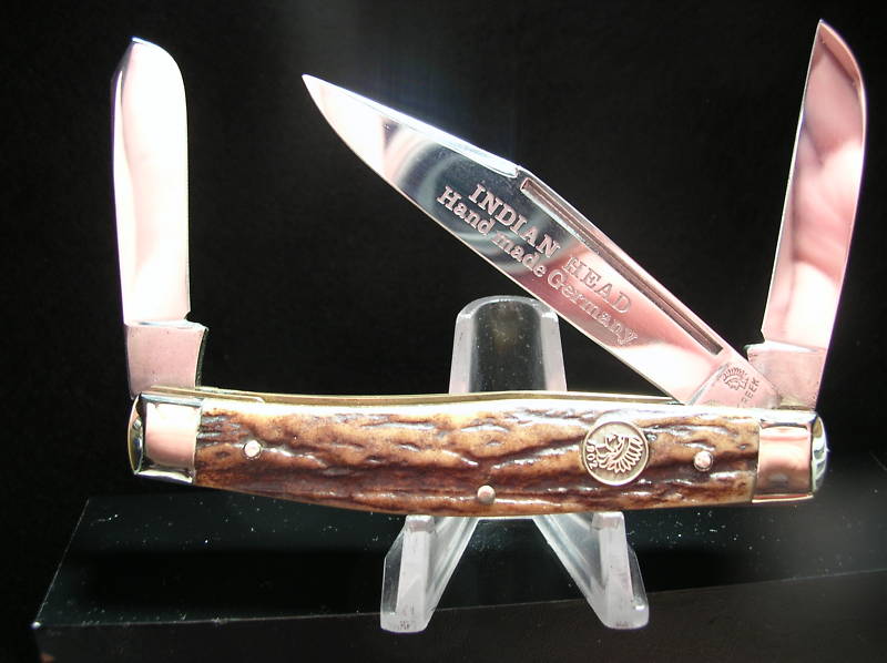

Here is my fav I own, I think they are well made knives.

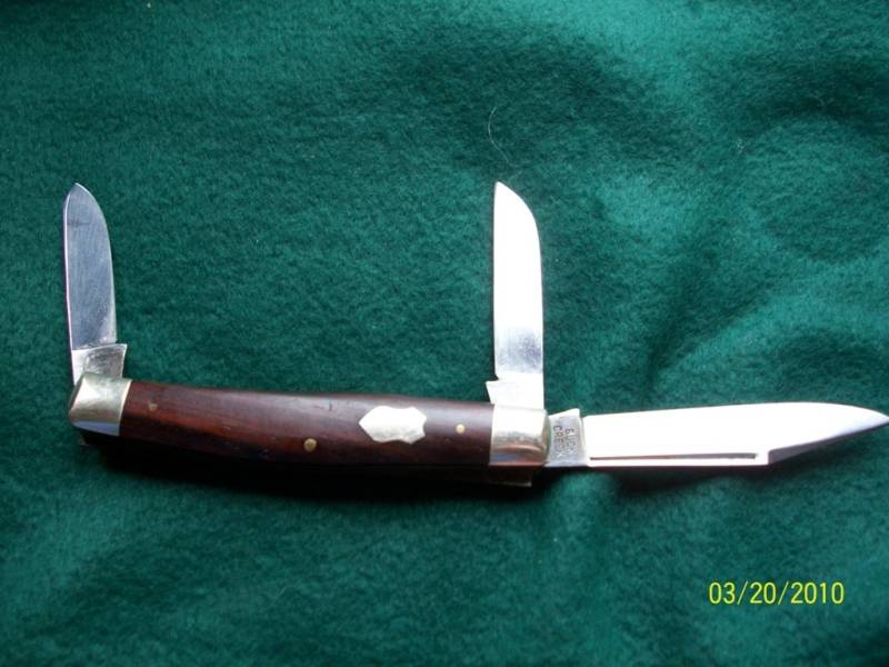

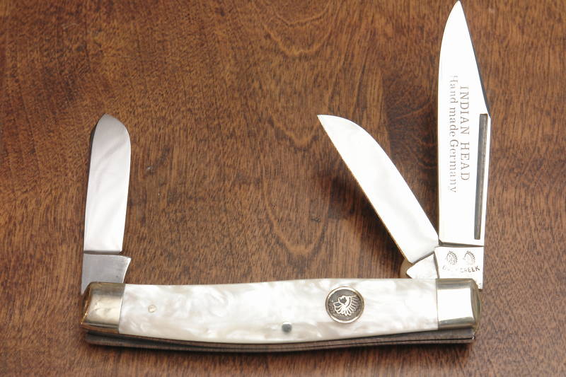

I got a few Indian Heads from the 70's and 80's and I love em.
In '91 they started having C. Risner on the tang above the Buck Creek.
Personally I like the pre '91s.

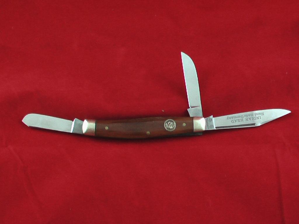

Mark , WOW ! I believe that last pic (rosewood w/crest shield) is one of the first Buck Creeks !

Sorry about the crappy pics. They are nice in person.

Bryan, hate to break it to you but your knife is outgassing. The blade rust along with the bolster staining is a sure sign that the celluloid on your knife is going South.
IF it was mine, I'd pop that plastic off and send the knife to one of the knife mechanics here on the board and have it re-scaled before it rusts to nothing.

olwd willie hit it on the head with the off gassing warning. in the 90s i had 15 or so eyes in one box & the one gassing cellouloid maked several knives before i segegated the bad apple.--HiPower

Less than a new knife usually.Bryan76 wrote:What does it cost to repair?
Either way, It would be in your knife's best interest to get that plastic off of it. When you take it off, throw it away. That stuff will rust steel anywhere in your house. It's evil.
Should be able to take another knife or small screwdriver and get it under the scales and just lift them loose from the frame.

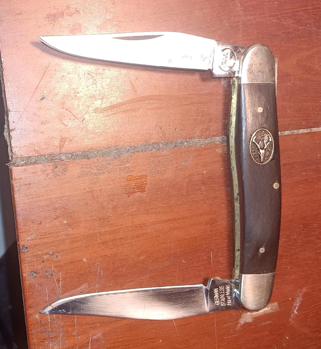

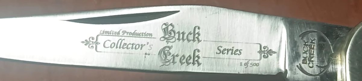

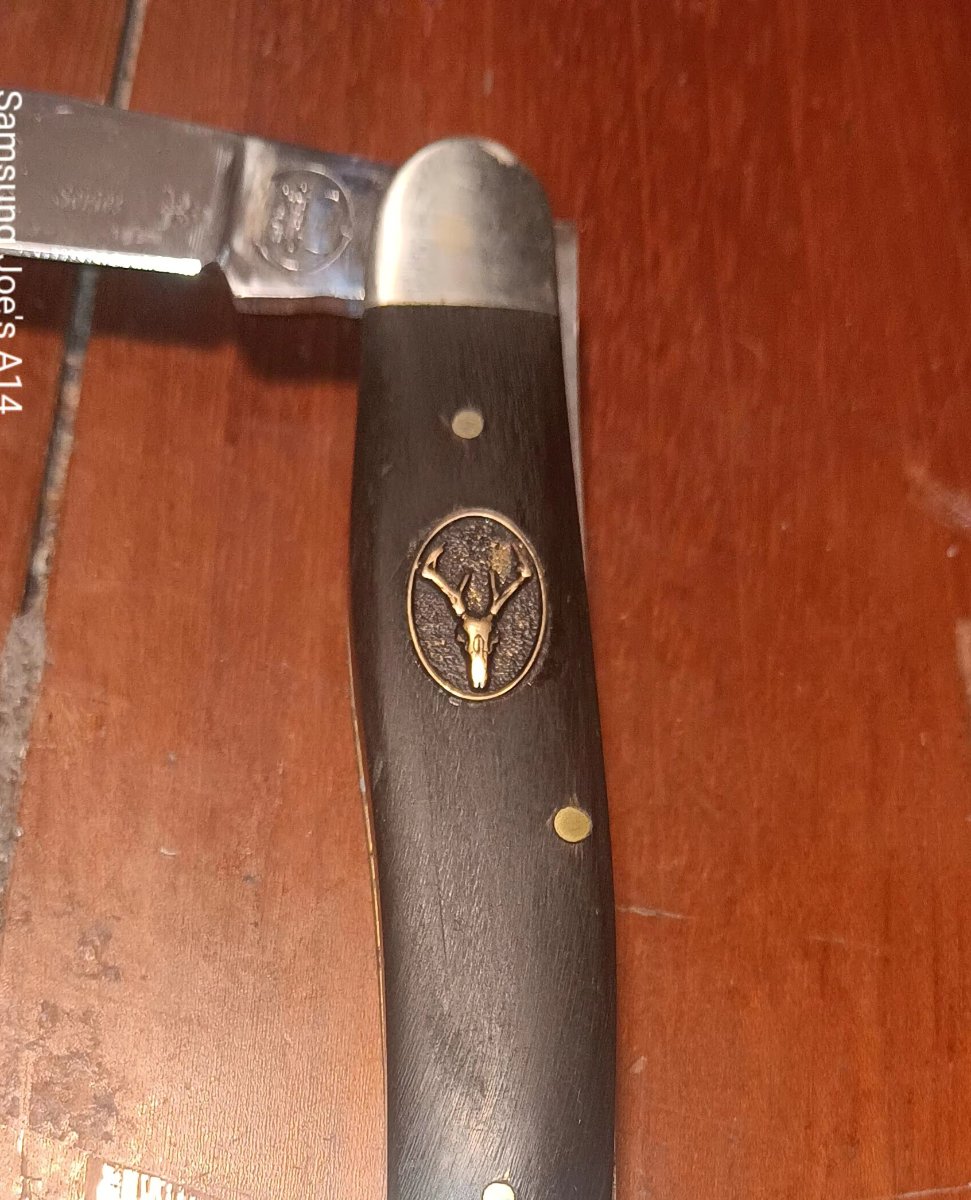

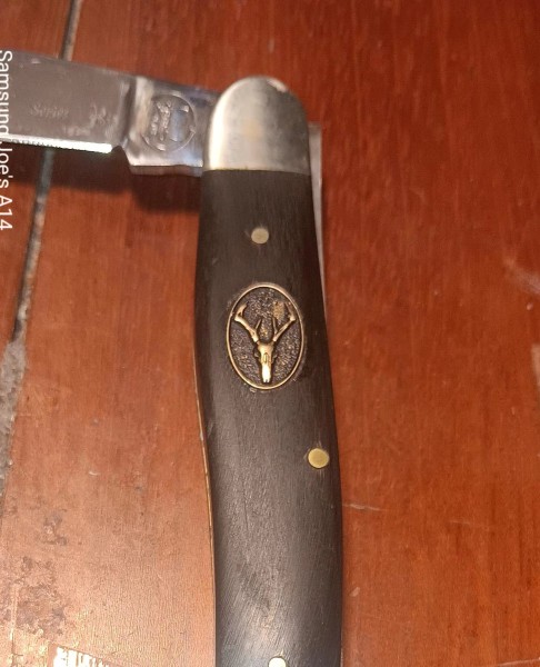

Buck Creek Collector but can't find any information about it!! Has anyone seen any like this particular knife and possibly know round about approximately a price?? I got this knife on a trade and the person didn't know anything either. It 1 of 500 made
