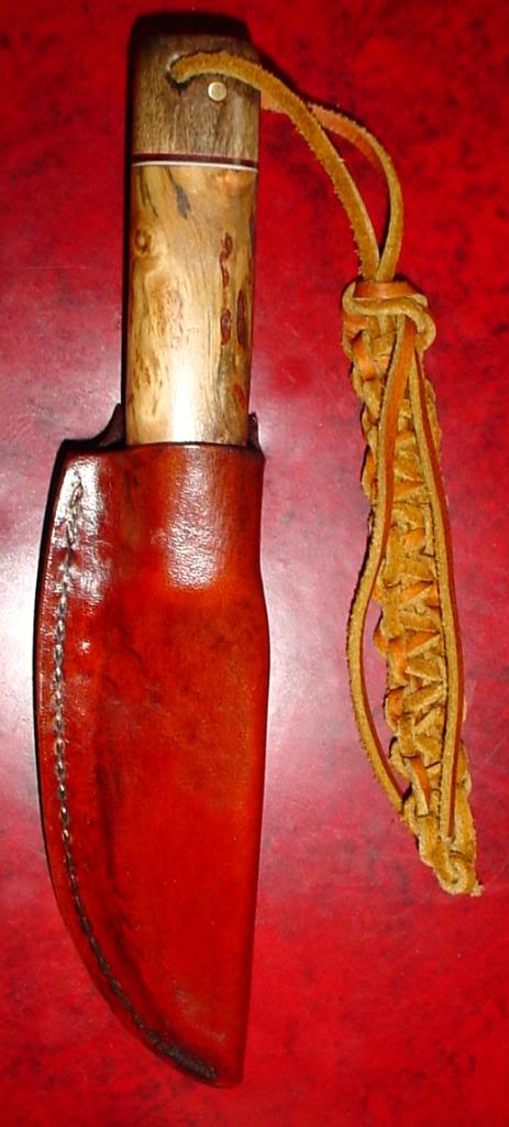

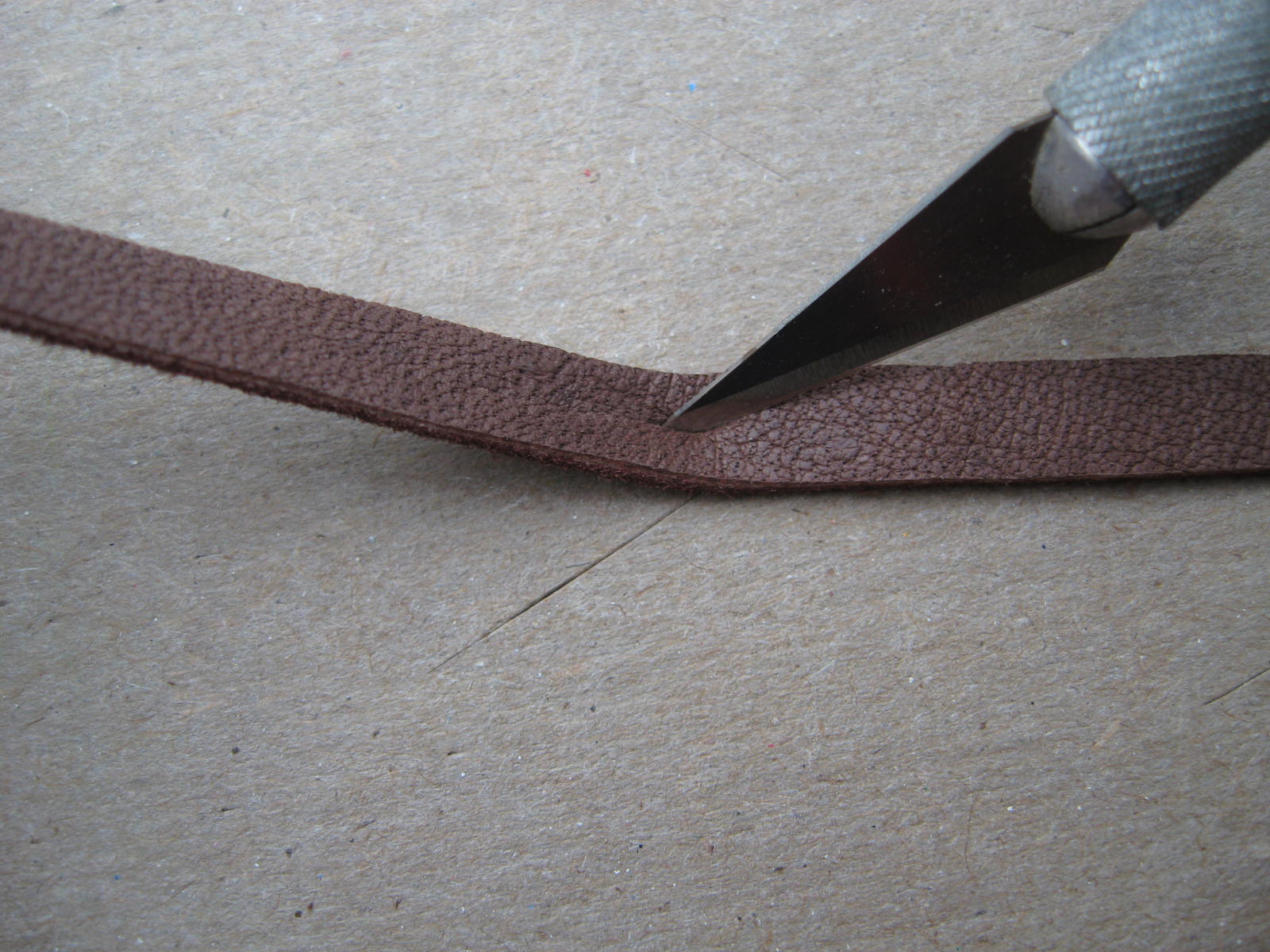

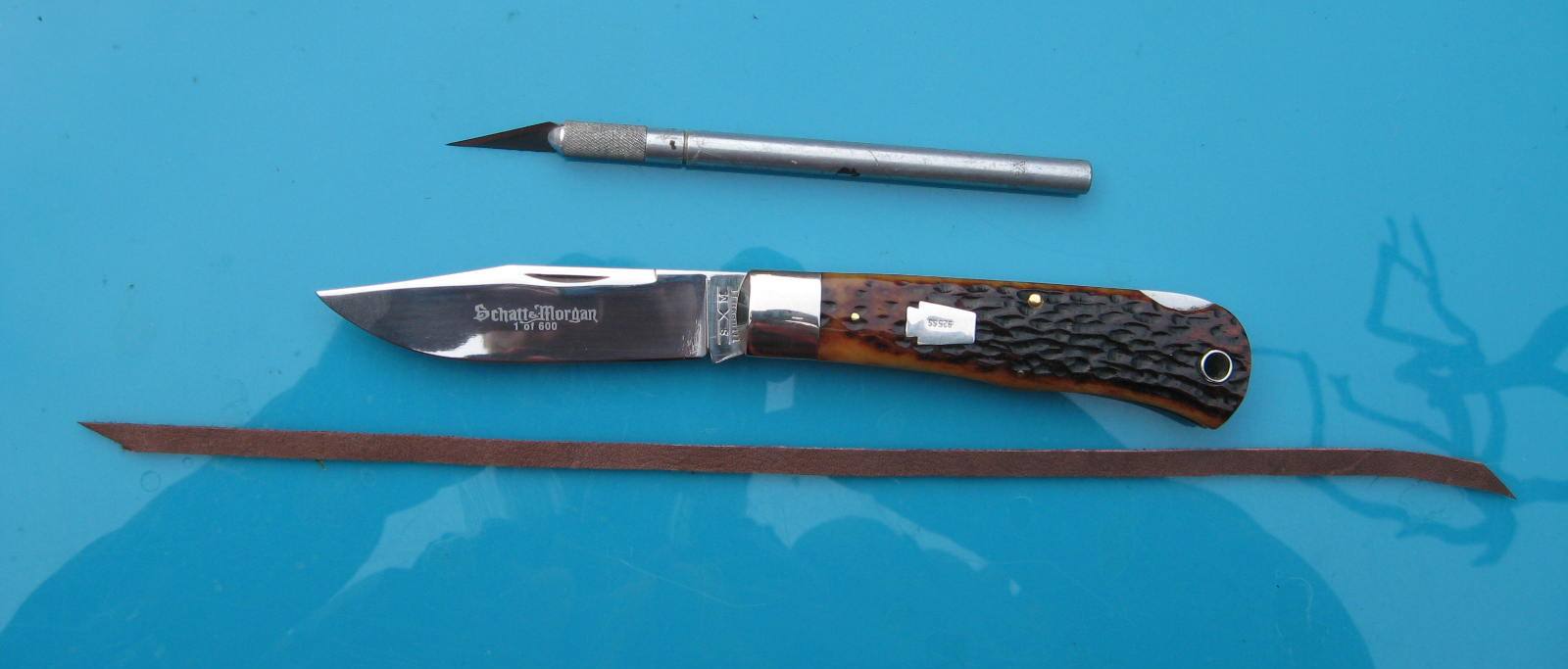

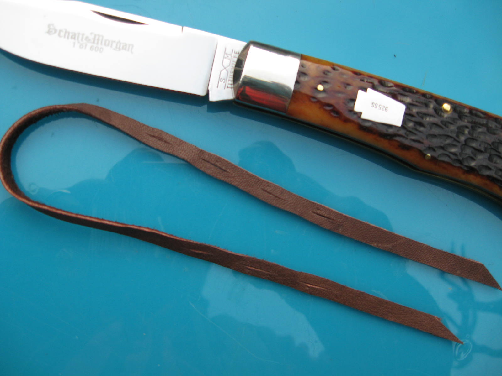

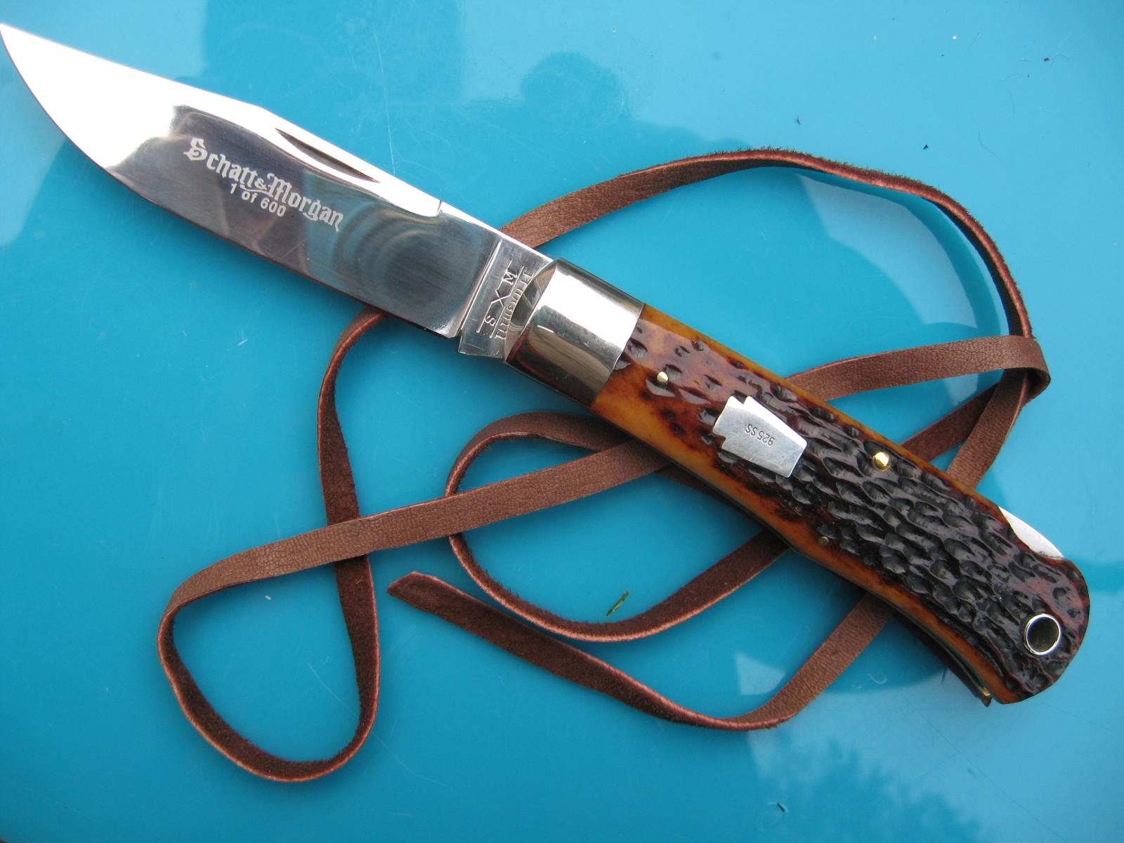

I was asked to do a little tutorial on making a knife lanyard. Well, it's fairly straightforward to make one like this:

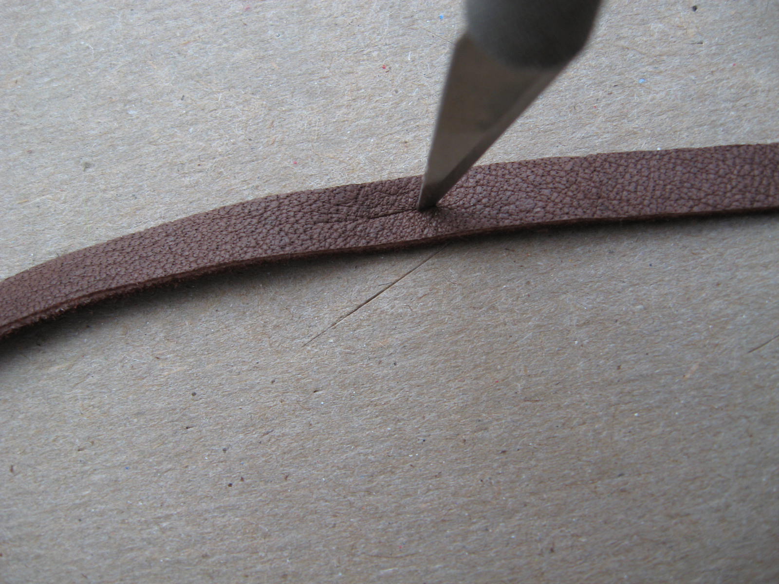

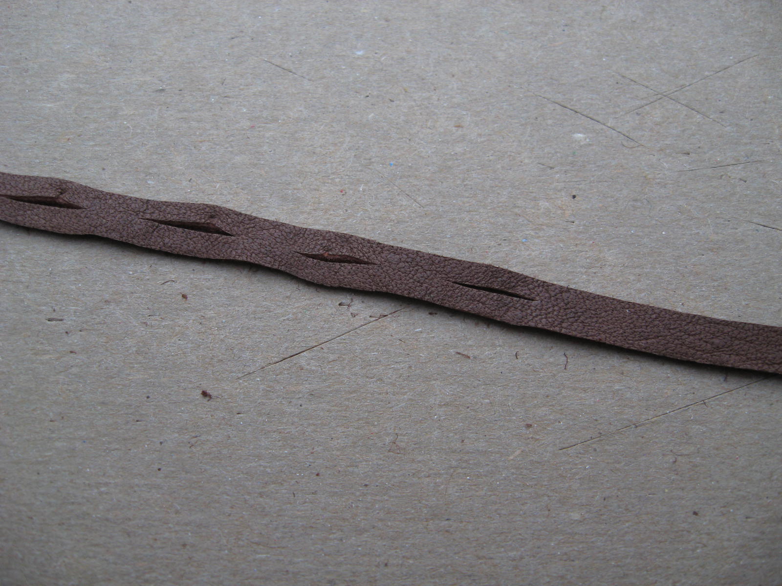

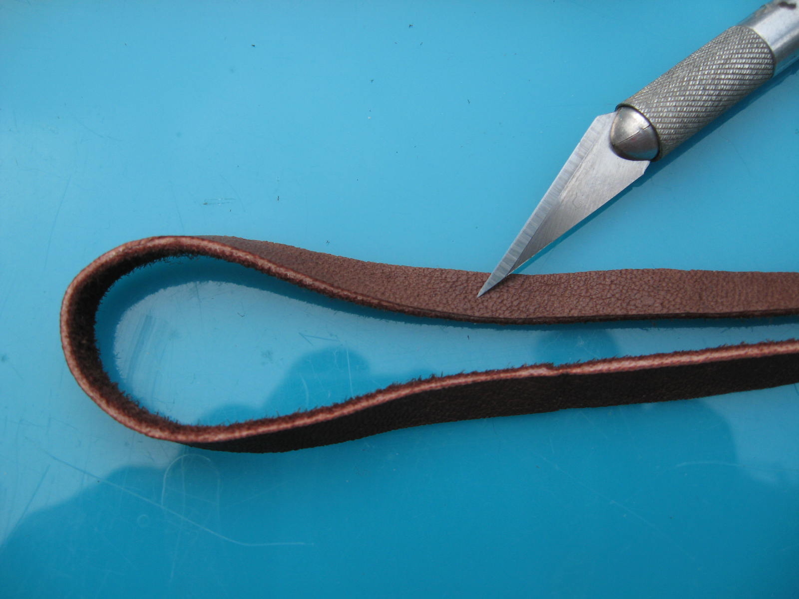

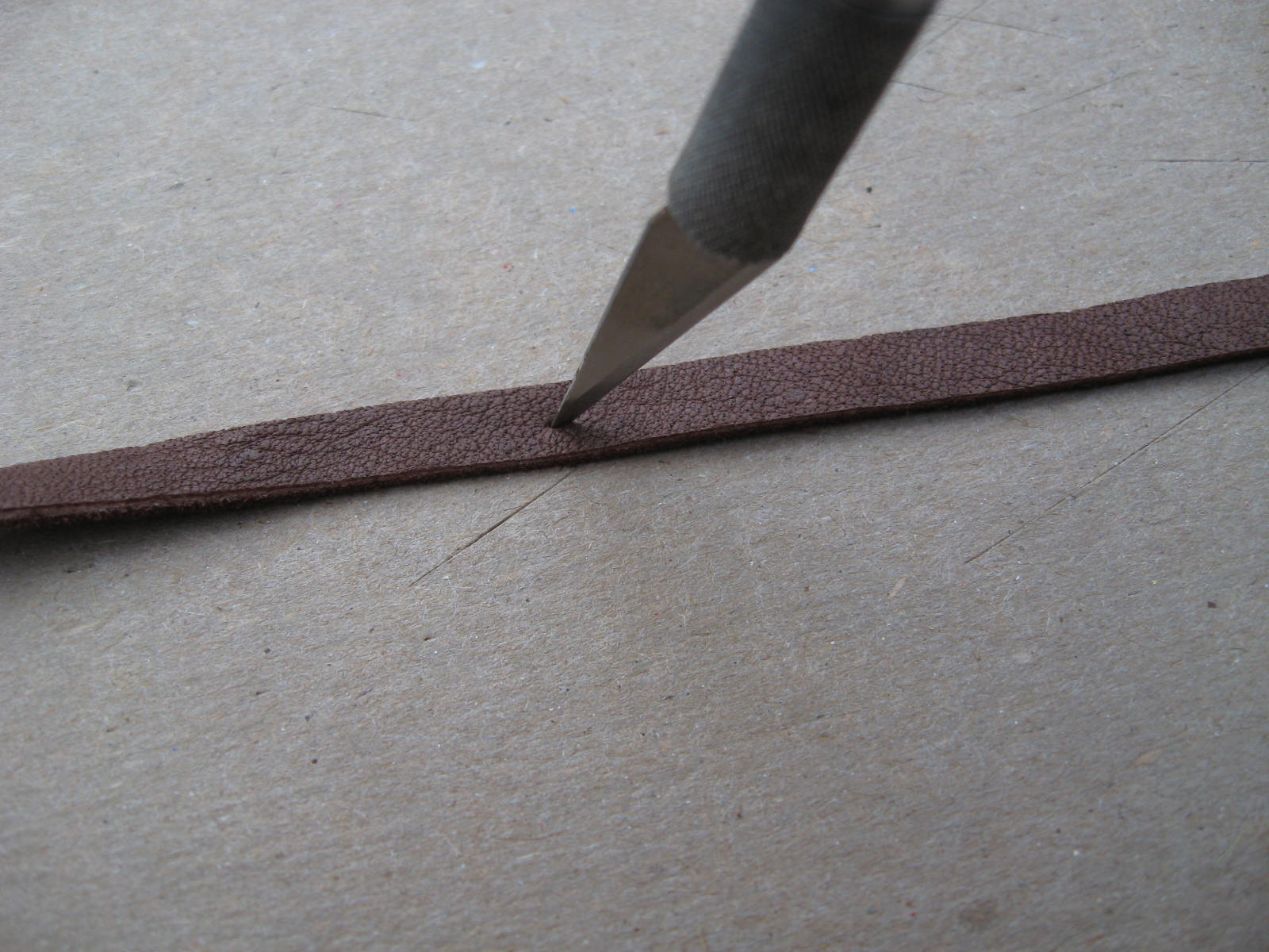

Take a strip of leather, soft thin leather seems to work best, but you can use a bootlace too. It is harder to cut the slits in thicker leather, however.Cut it to length with angled ends.Now fold it in half and estimate where you'd like to start cutting the slits. This will vary from knife to knife and depends on whether it has a bail or a tube.When you cut the slits, it is easier to plunge the knife into the material and pull the material through the blade. Use an X-acto knife or similar and make sure it is sharp. Use a piece of card or something firm to hold the point of the blade; I'm just using the back of a scratchpad.This operation can be a little tricky, but with a little practice you'll soon get the hang of it.

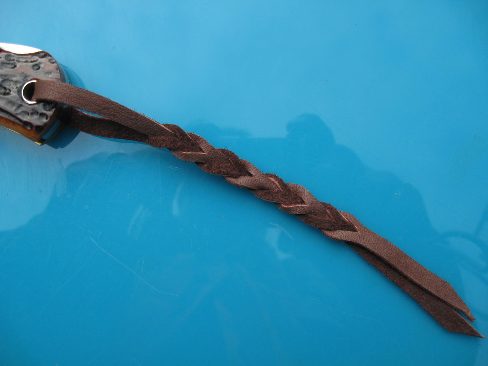

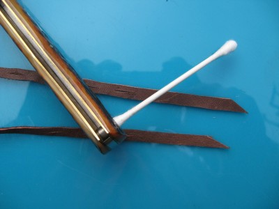

OK, if you've gotten this far, hopefully you haven't cut yourself yet!

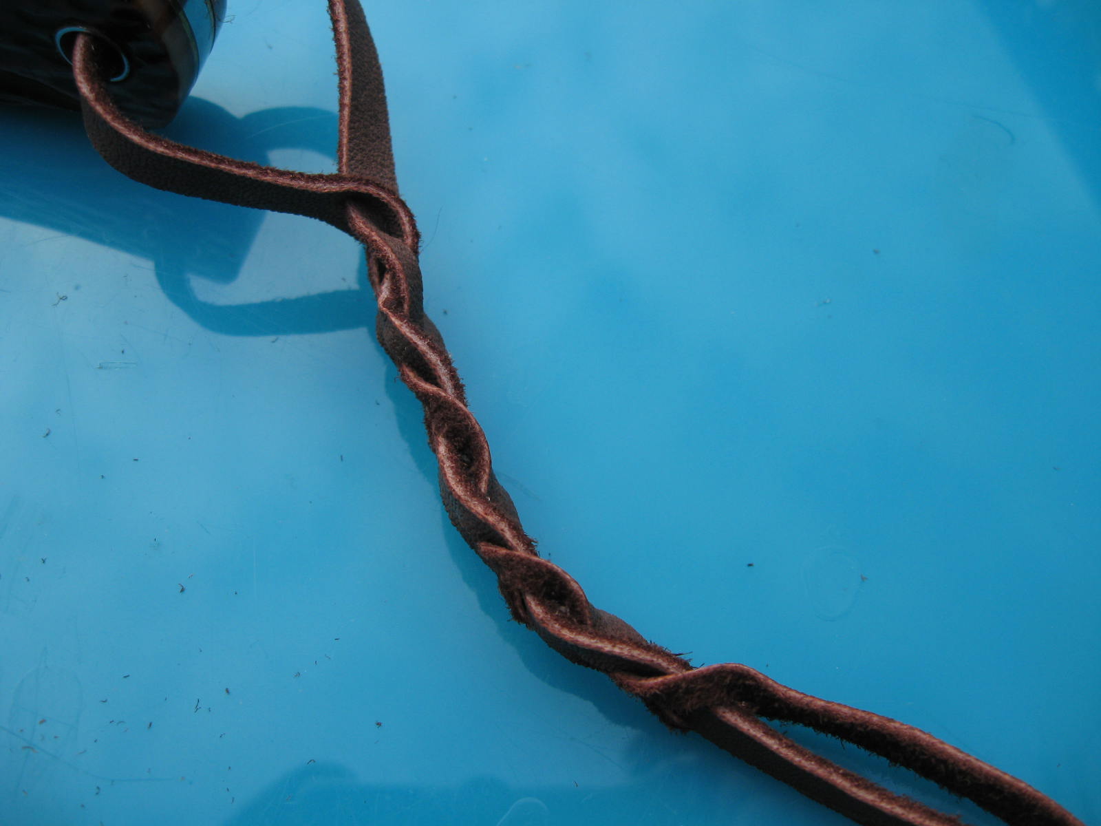

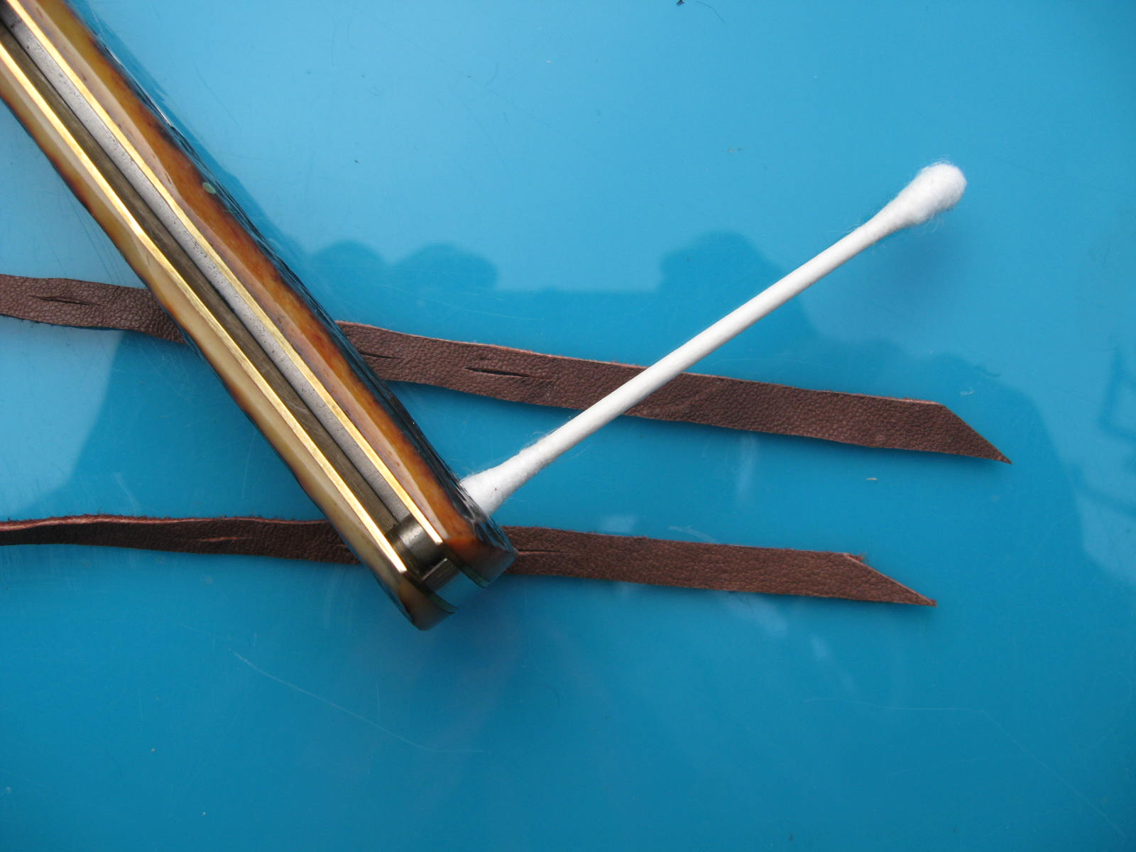

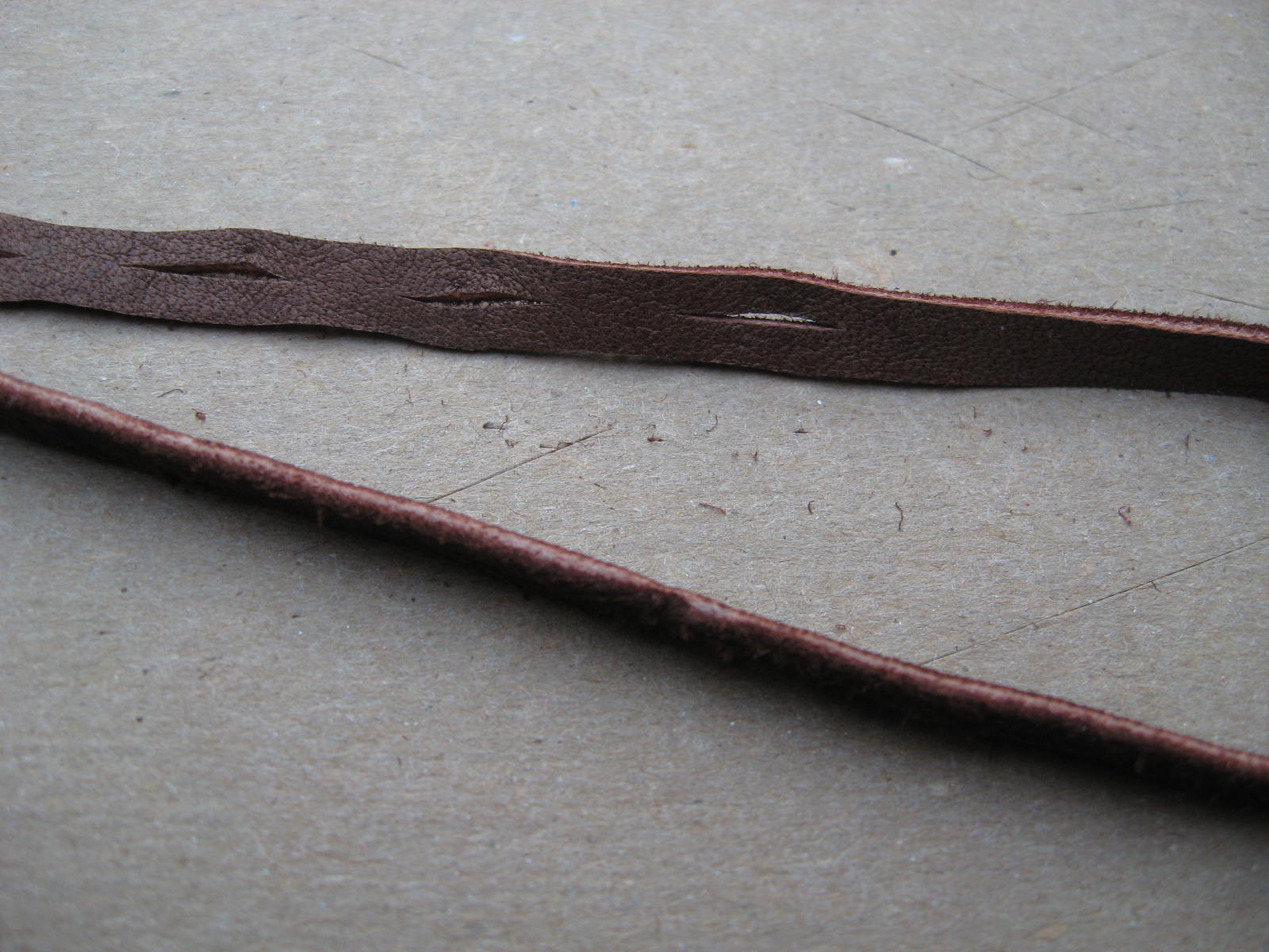

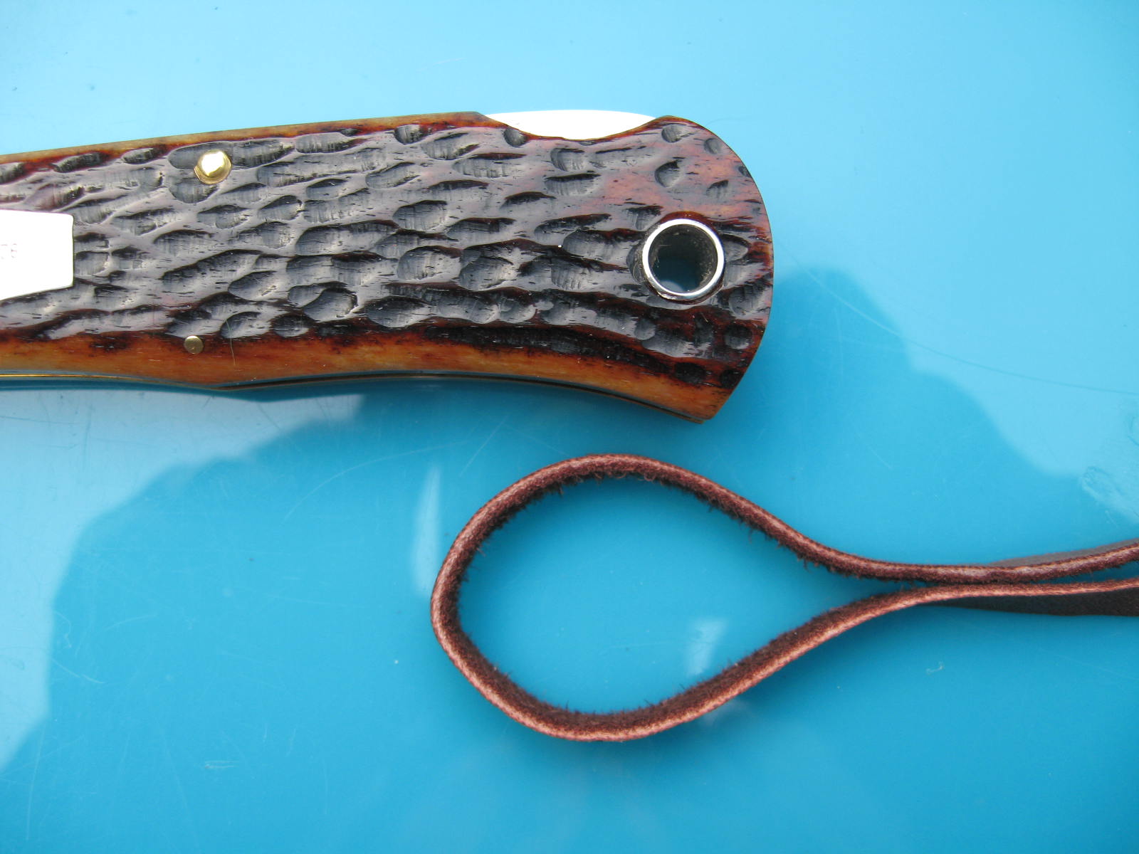

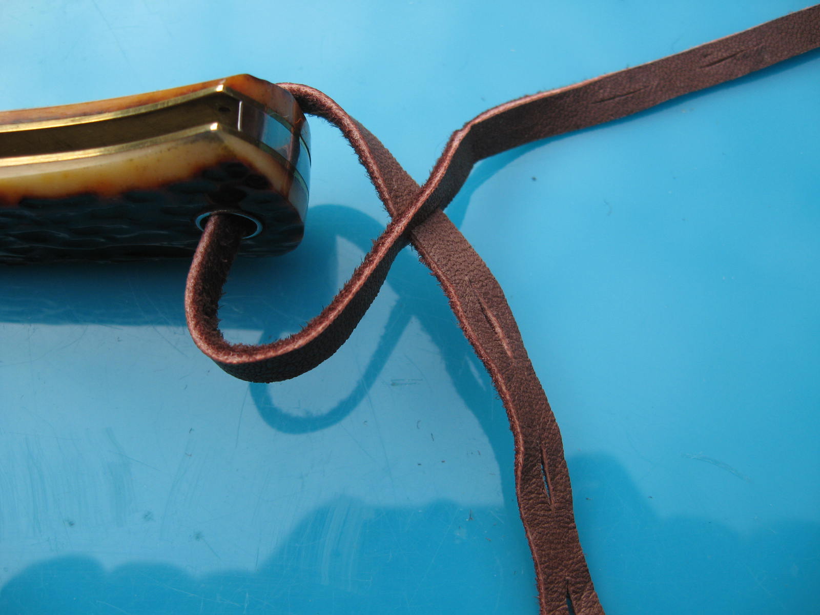

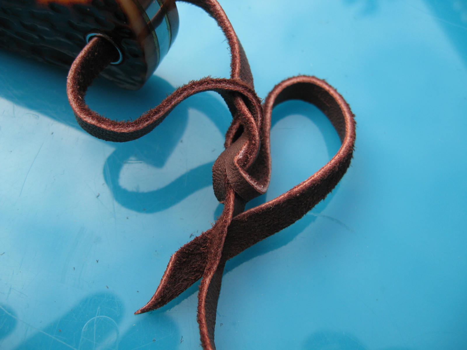

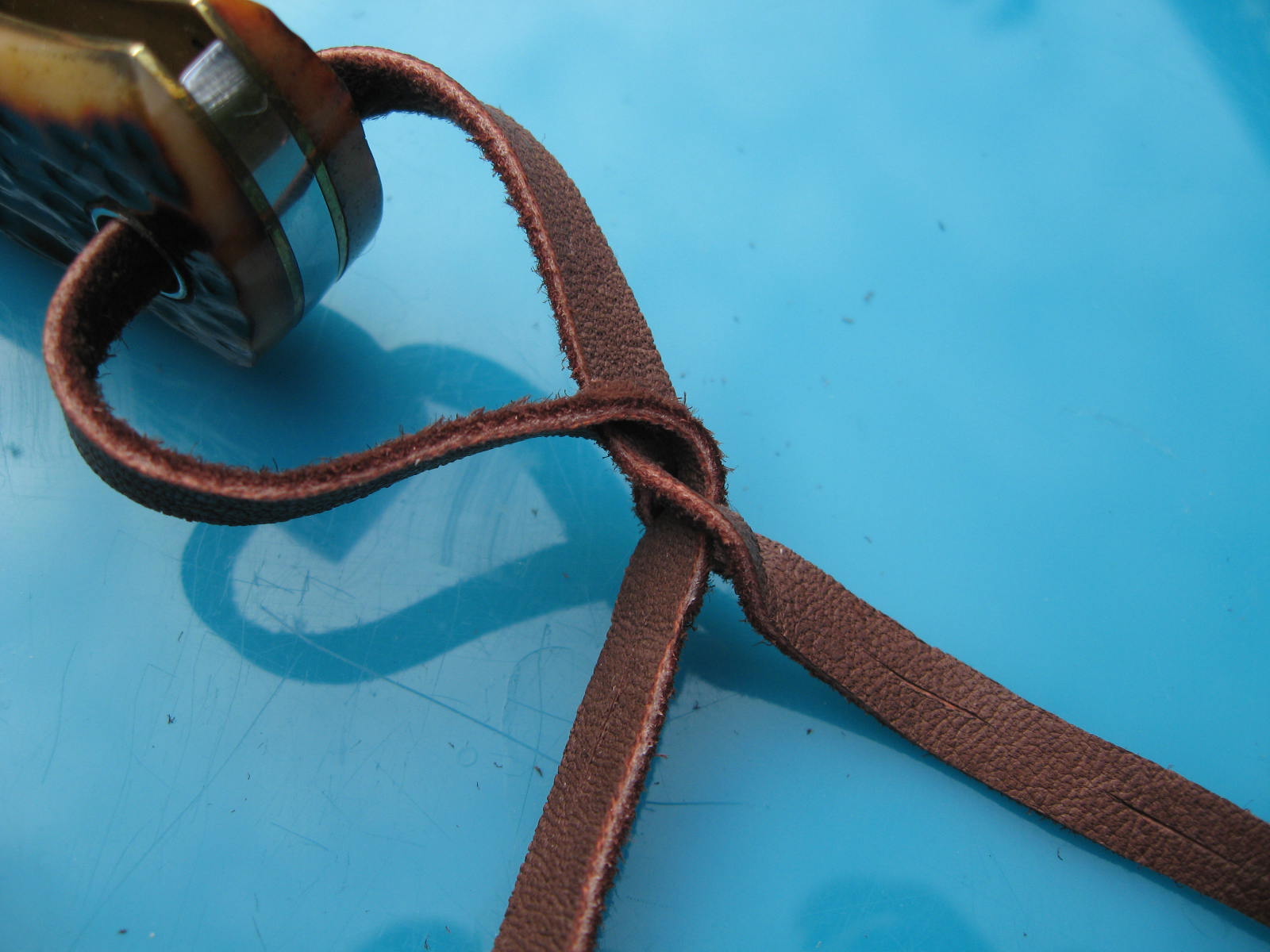

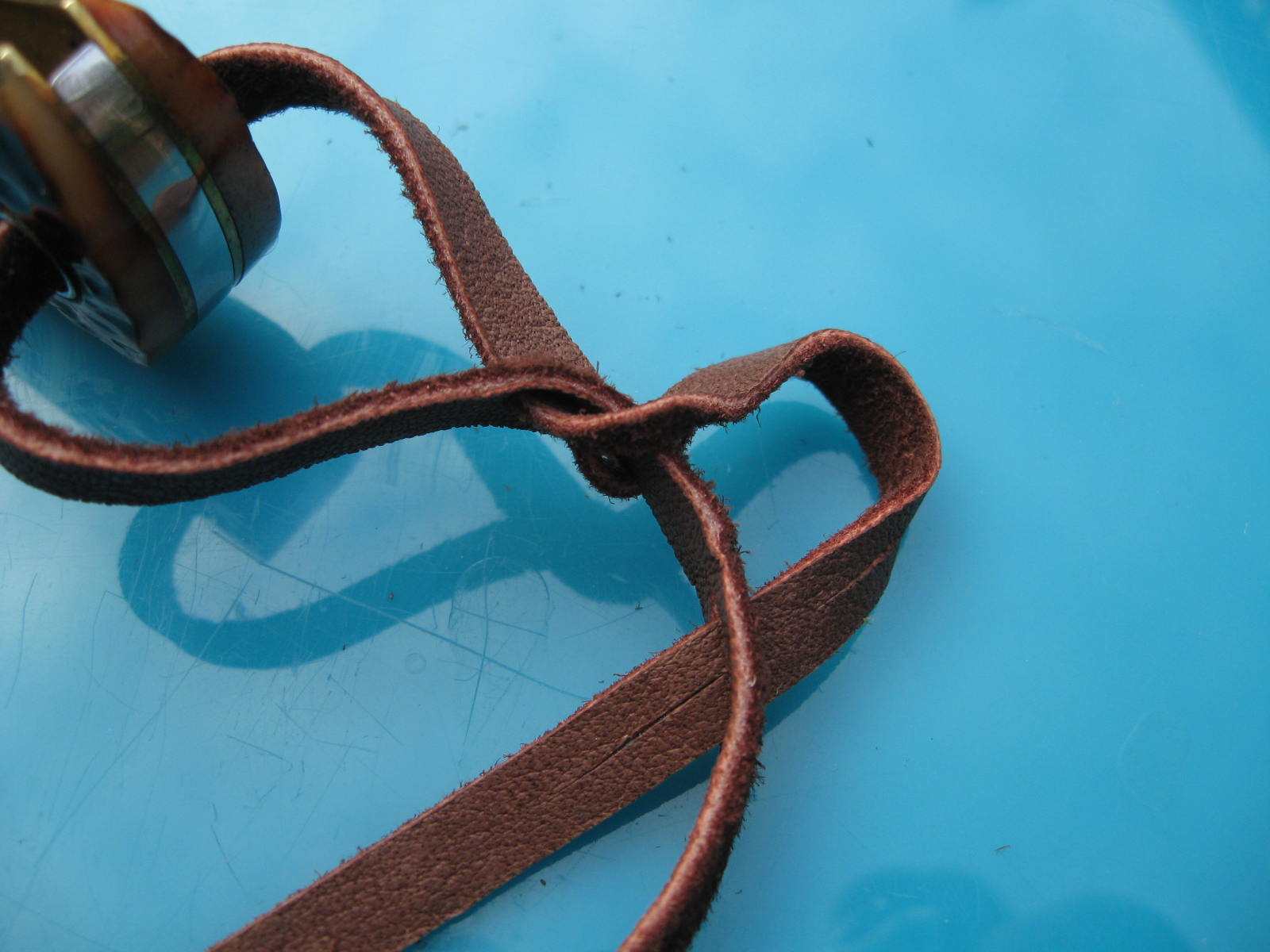

Alright; so now your lanyard should look something like this: Now we need to thread the hole with the lanyard; sometimes you'll need a sharp pointy instrument to push it through the tube if its small (like the GEC 72/73 series knives). Make sure to clean the hole first so you don't soil the work you've done so far!NOW, for the fun part!Thread one end of the lanyard through the first cut on the other side; make sure it is the first cut, as they can be hard to see and you'll end up taking it apart and starting over:Without moving the knife, take the half you just went through and go through the first hole on the first side. It's important to go through the lanyard in the same direction with both ends to get the braided effect.Continue in this manner until you go through the last hole. If you cut 3 slits on each side, you will end up with 6 "braids"; 4 on each side will give you 8 braids, etc.After you've gone through all the holes, work back through the lanyard to even out the "braids".By the time you're done with all your knives that will accept a lanyard, you will be an expert!

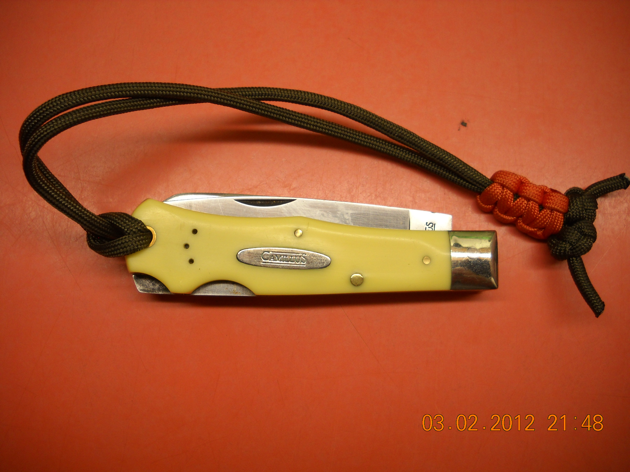

After asking the forum about the lanyard, I got to thinking about them and mentioned it to my Pastor who is an outdoorsman. He said he would make me a couple out of nylon cord. Being an old dog and a traditionalist, I was a little skeptical about using a lanyard. Most of my deer processing has always been with a "big" pocket knife, a trapper or a folding hunter(Florida deer ain't that big) and a sawzall. After trading for a double lockback Camillus that had a lanyard hole, I have become a "believer". The lanyard the young preacher made is attached through its' own loop and can be removed easily for washing which it definately needs when we get done dressing Bambi. In the last month I have have once again benifited by reading the thoughts and comments of the knowledgeable AAPK members! Thank y'all. Treefarmer
