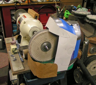

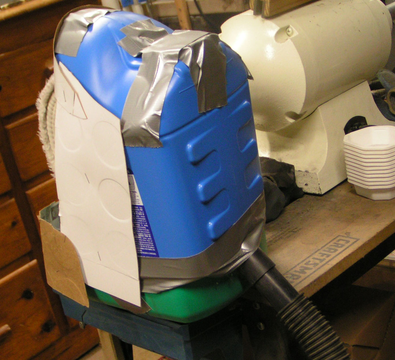

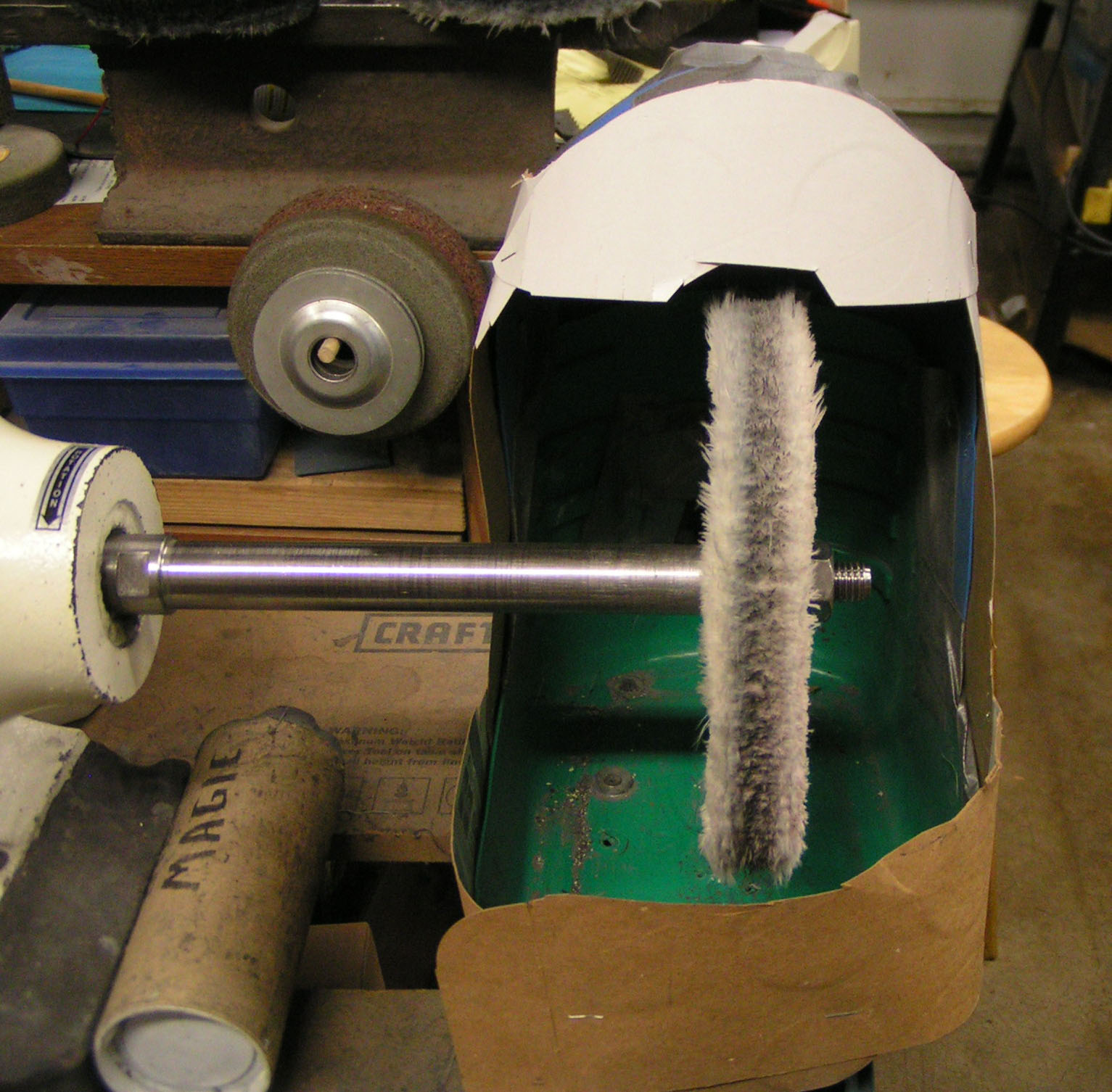

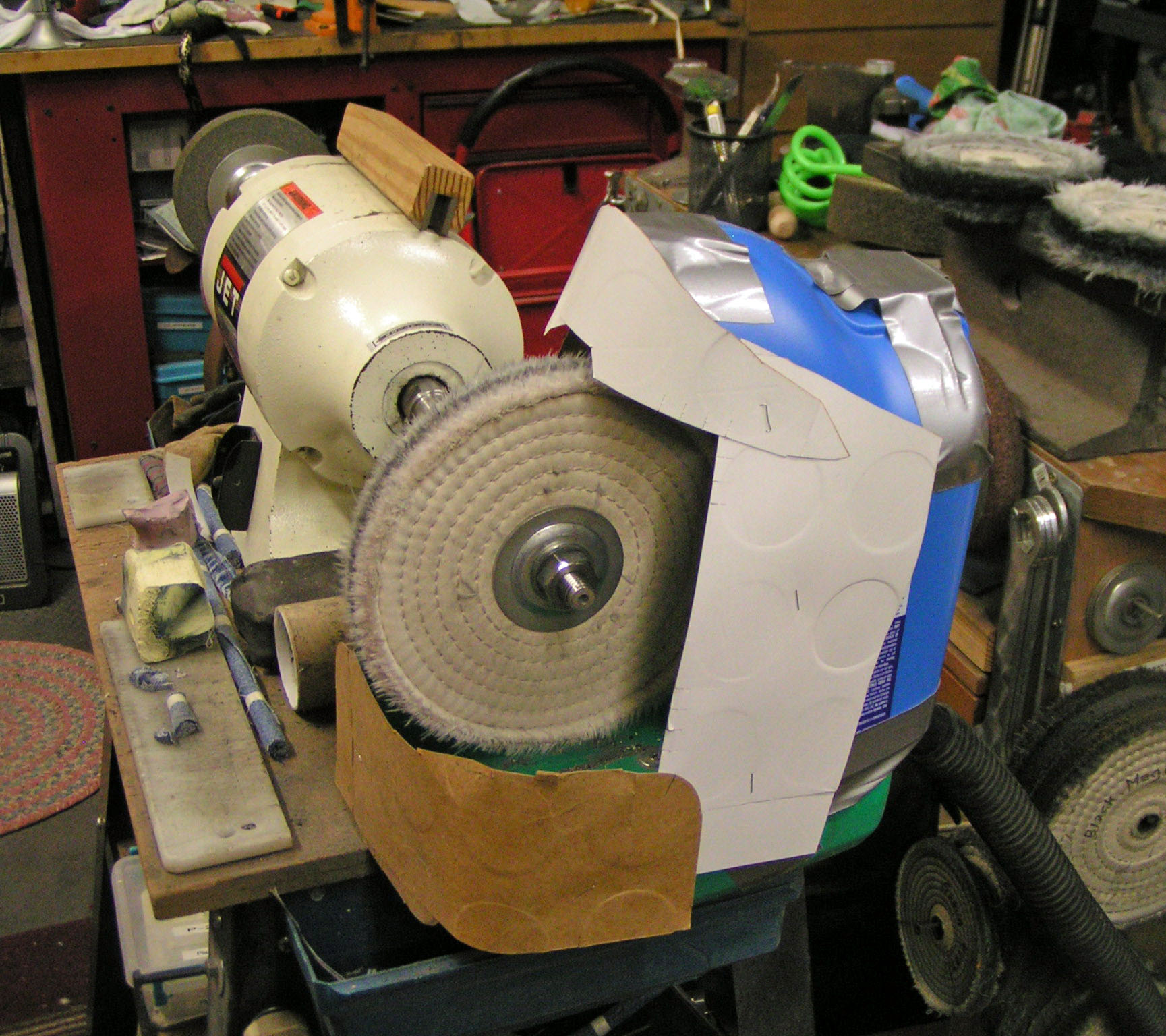

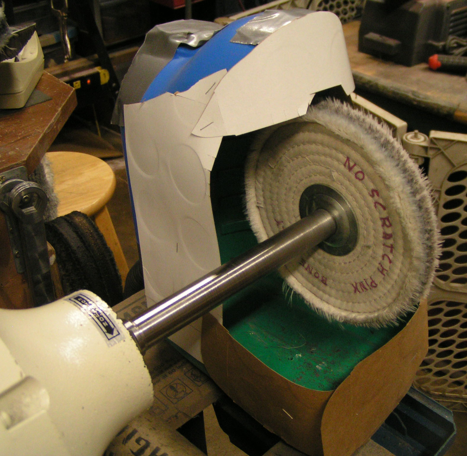

Here are some pics of my homemade buffer hood.
It is made from plastic laundry soap jugs, an old shop vac tool to get the hose connected, cardboard and duct tape. It is held in place with screws through the bottom into the wood on the top of the stand.
It is anything but fancy, but I think it gets about 75-80% of the dust when I use the buffer. Aside from the duct tape everything else was bound for the garbage or recycling so there was no great expense for it. Much better than nothing and far less expensive than several hundred dollars for a sheet metal hood that goes around the buffer.
