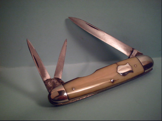

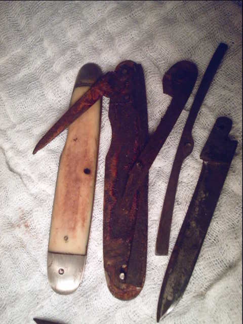

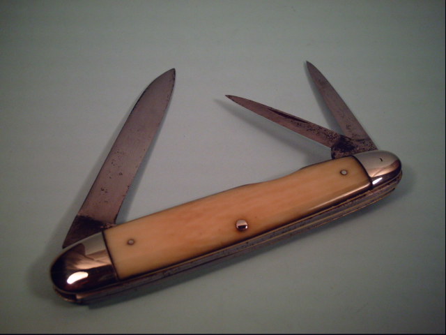

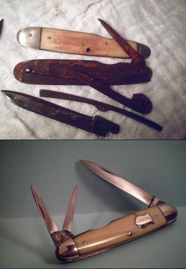

Well, I might as well be the first to get the ball rollin'. I finished this just in time for the new forum addition. I recieved it with some other parts knives from a fellow forum member. It was pretty gunked up and rusty when I got it. I cleaned it all up as best as I could. Tuning a splitback whittler is tricky! This was my first and it was a challenge, but I'm not complaining! After cleaning the handles up a bit I realized they were ivory. It's my second I-XL, but my first splitback. It will be a great knife to carry, give me somethin' to show off
. Needless to say, I'm tickled pink with it, not only with the knife, but proving to myself that I could tune a splitback
, no matter how many tries it took
. And as usual, here are some before and after pictures for your viewing pleasure. Let me hear your comments

- Rusty, gunked up and in pieces, just the way I like'em

Hey, thanks for the comments fellas.
Mumbly, tuning a multi blade knife to make the blades lie where they need to be and not rub against one another or the liners when closing. It has to do with the ammount of pressure applied by one or both bolsters from the pivot pin's tension on the tang, if too much pressure is applied from one bolster the blade will close to one side, if both bolsters apply too much pressure it will not snap open and/or closed. It mainly has to do with how much you peen on either side of the pin when reassembling the knife. You peen too much on say, the left bolster the blade will close at an angle and rub one of the liners. I still haven't quite gotten the whole "formula" for tuning figured out yet, but I'm working on it. You can use a slackener between the tang and bolster and peen the pin on the correct side to cause the blade to close where you need it to go. Splitbacks are especially tricky because the small blades need to lay right next to the liners without rubbing them, and the master blade has to lie perfectly center when closed. Most times on a stockman pattern knife, the blades them selves will actually be bent a little so they will close without rubbing, this is particularly true for the later Schrade uncle henry and old timer knives. Many were bent at the tang, so the cutting edge was not warped to impede sharpening. I'll take some photos later to help explain. Also, some problems I have encountered in the past was when rehandling a knife the epoxy would actually twist or warp the liners, so the blade would no longer lie center, I have since solved that problem. I'm no expert, just my observations.
