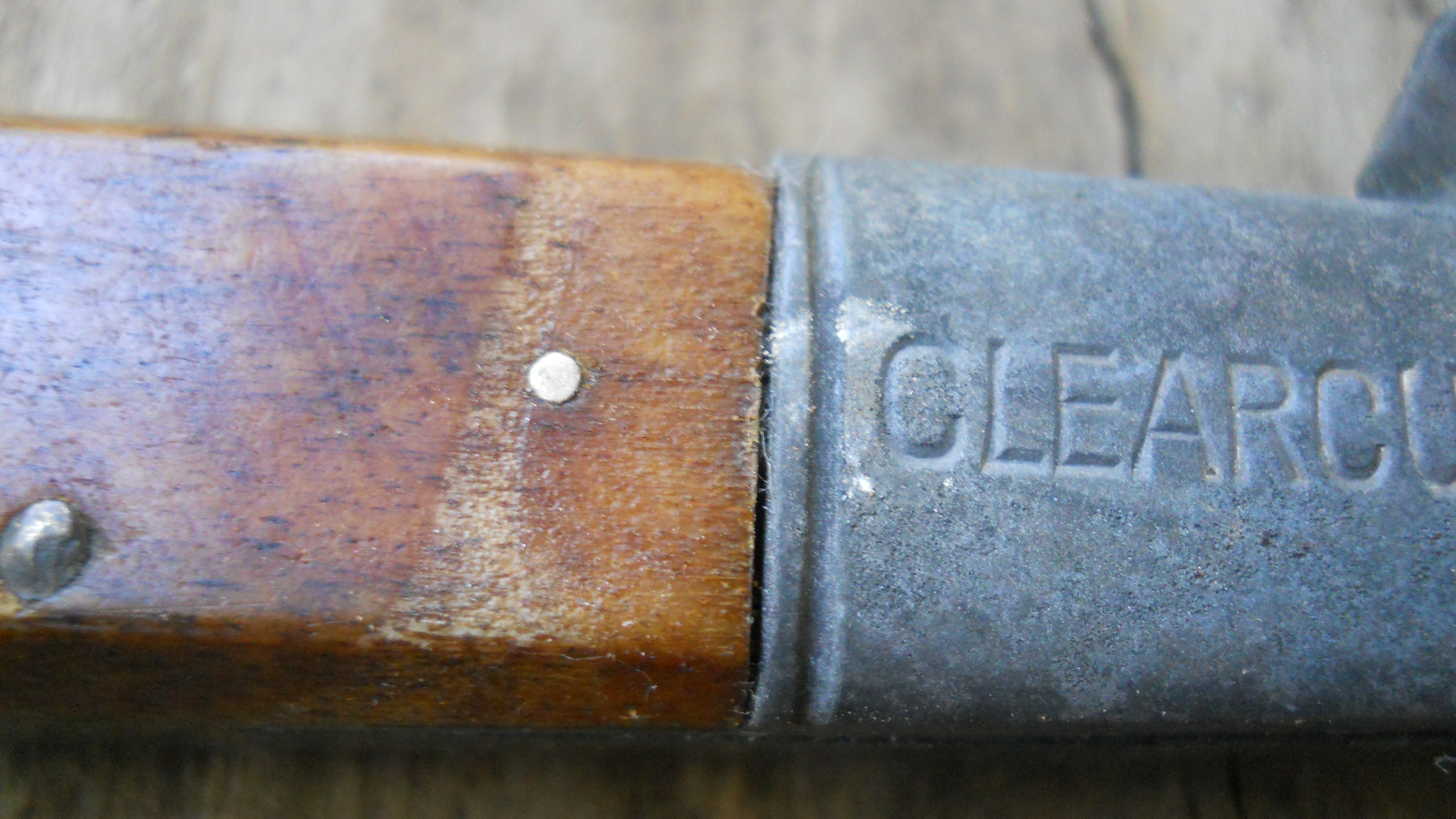

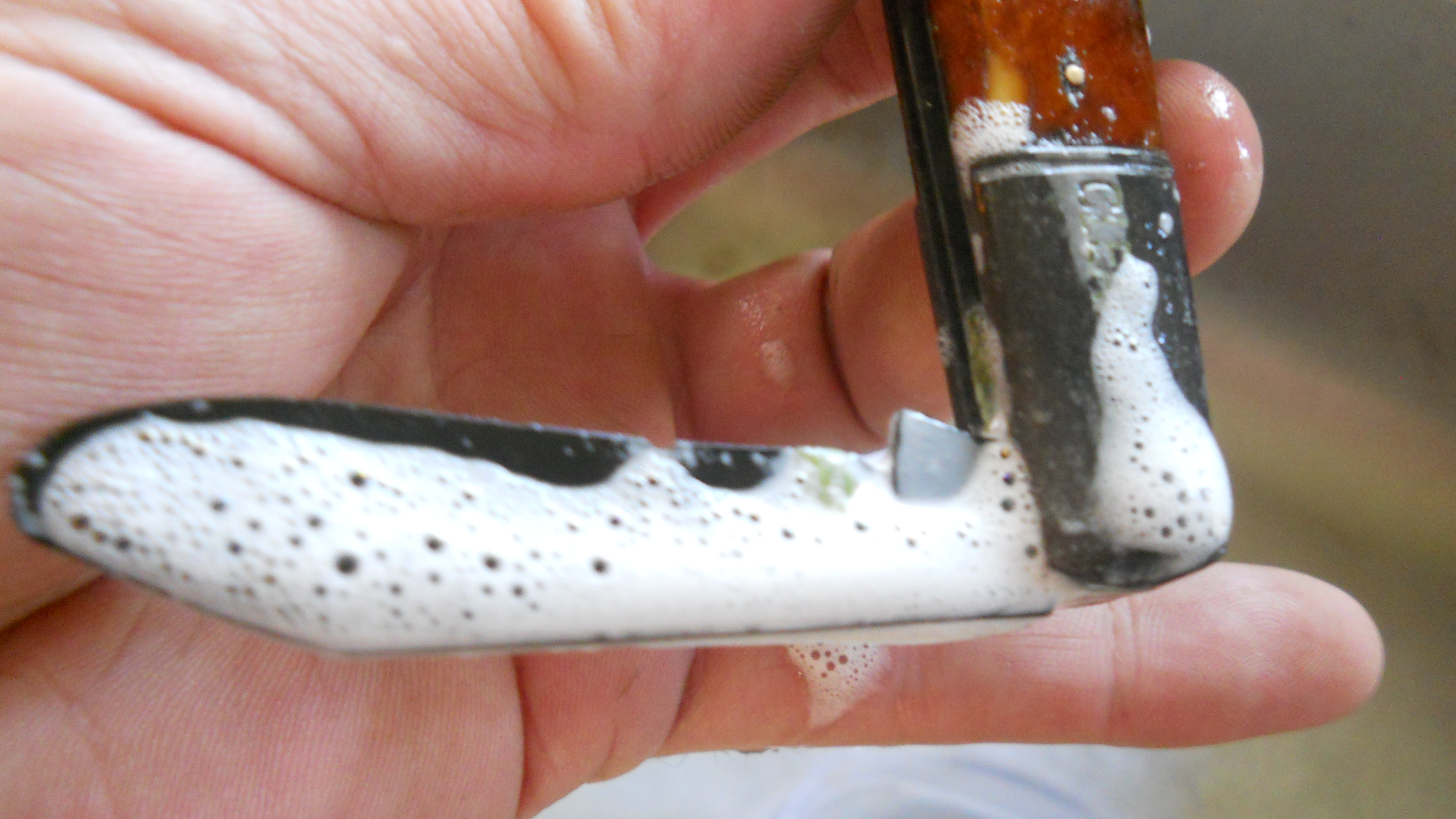

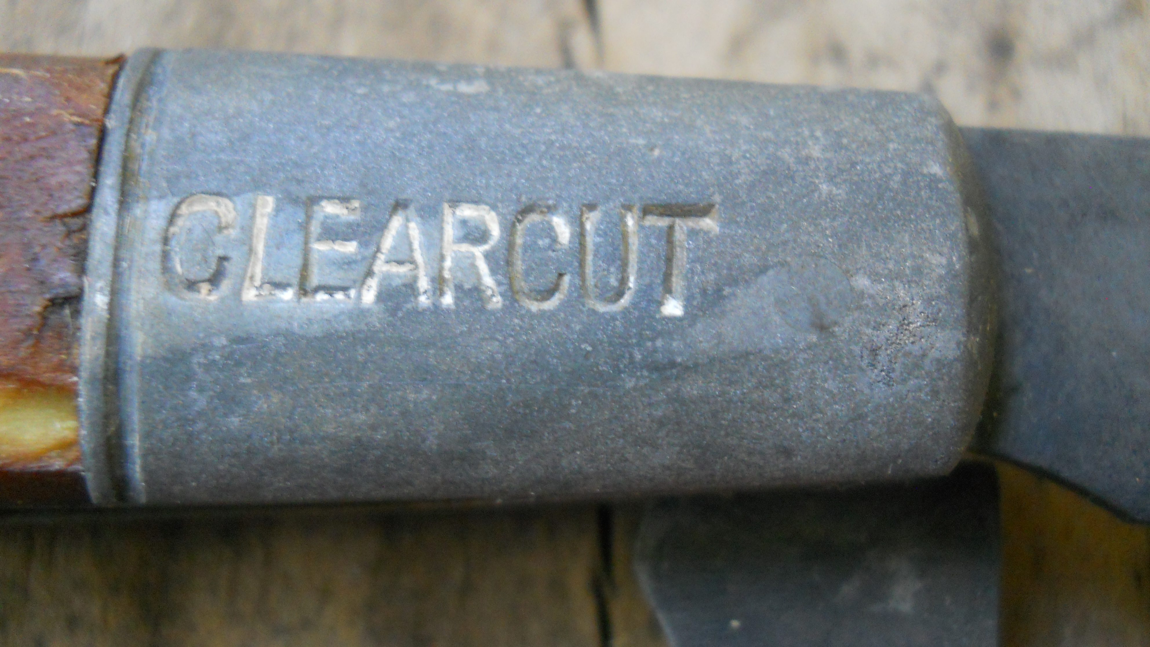

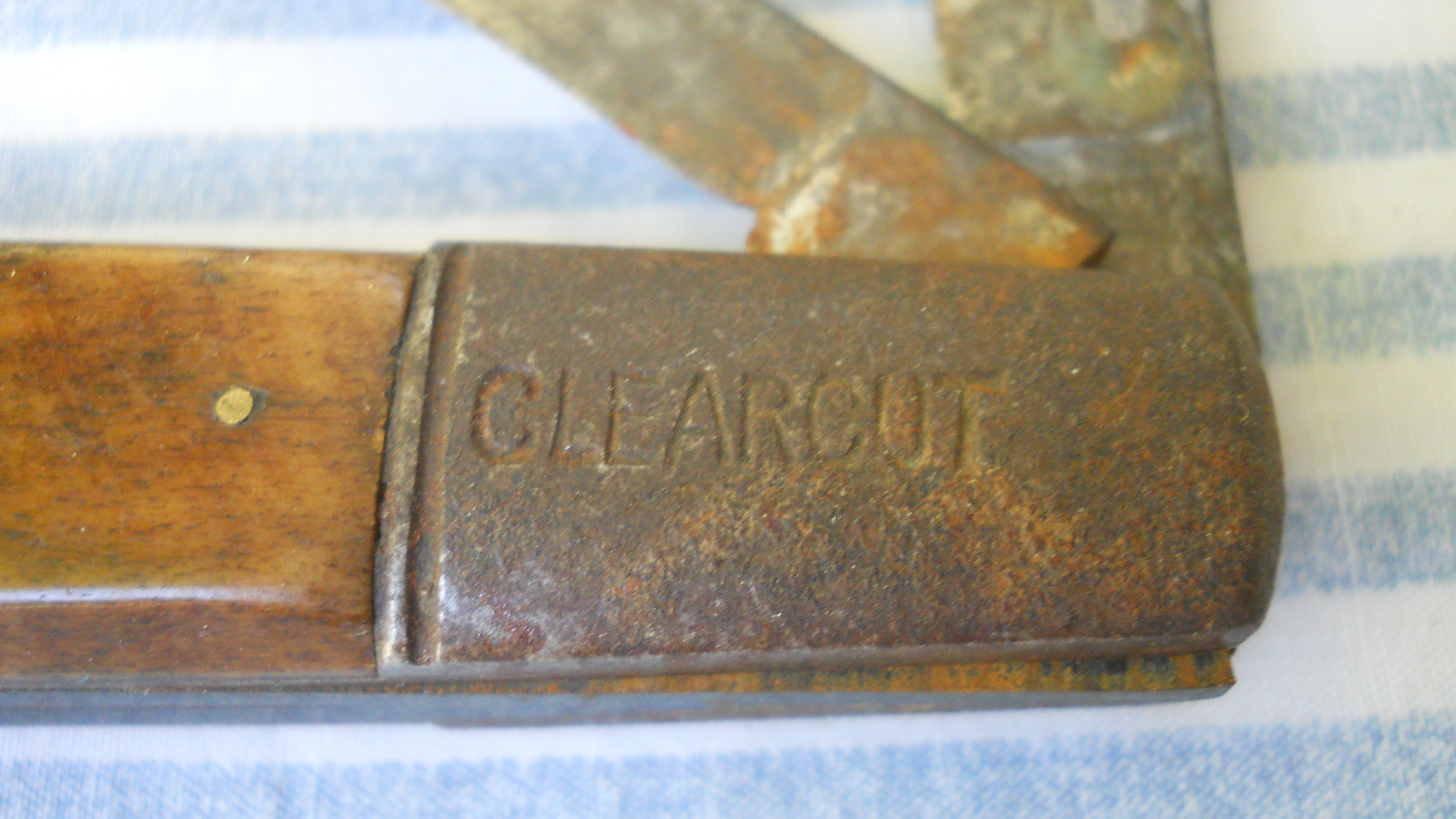

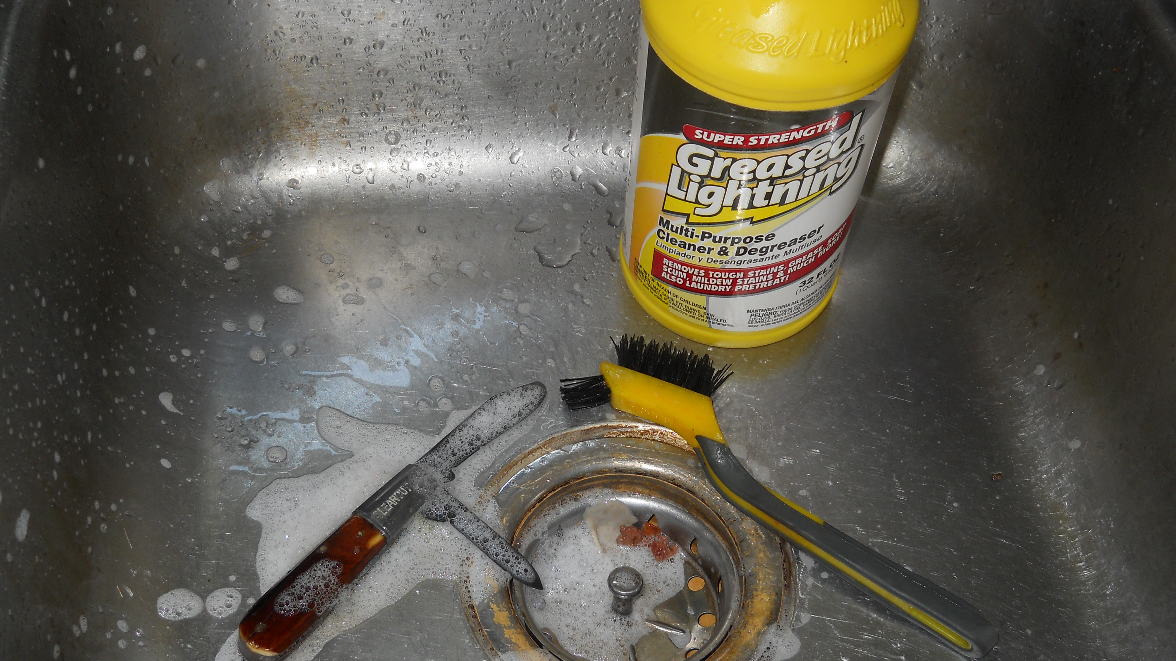

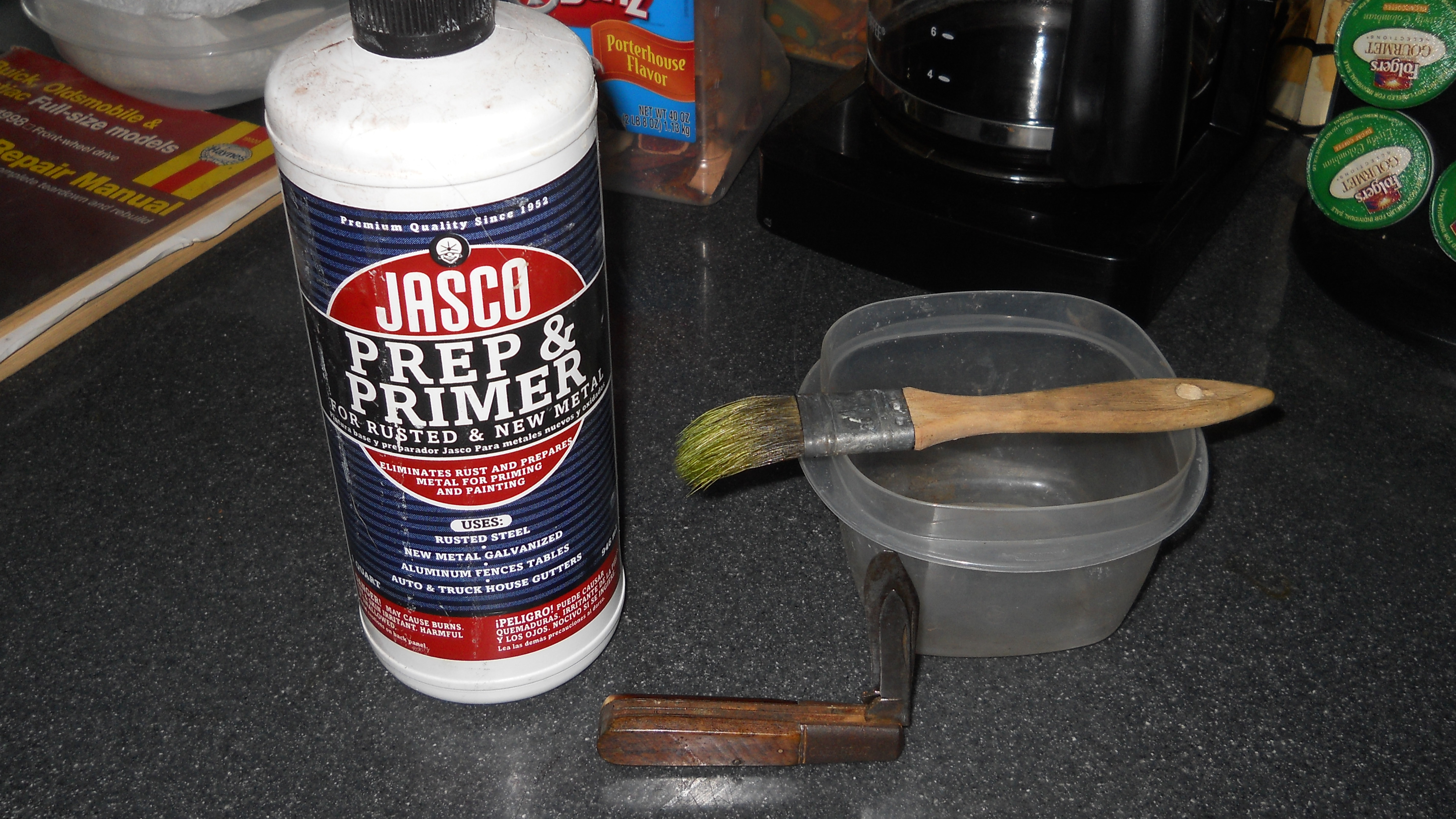

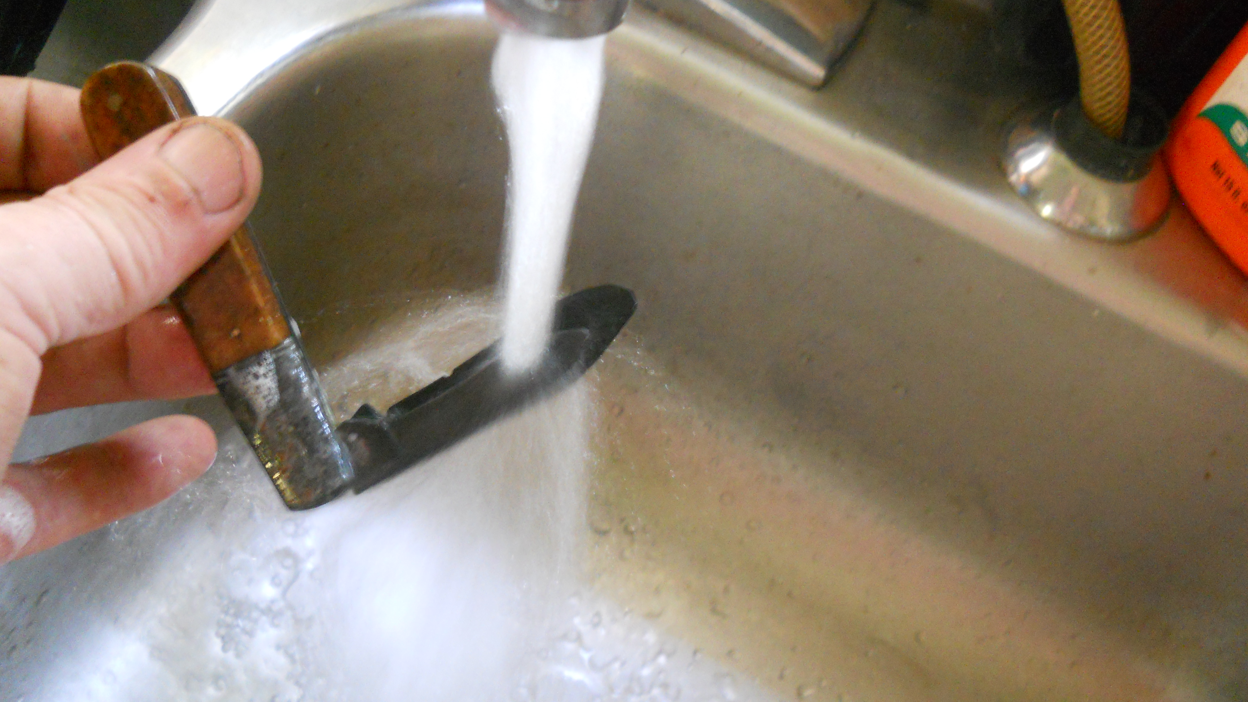

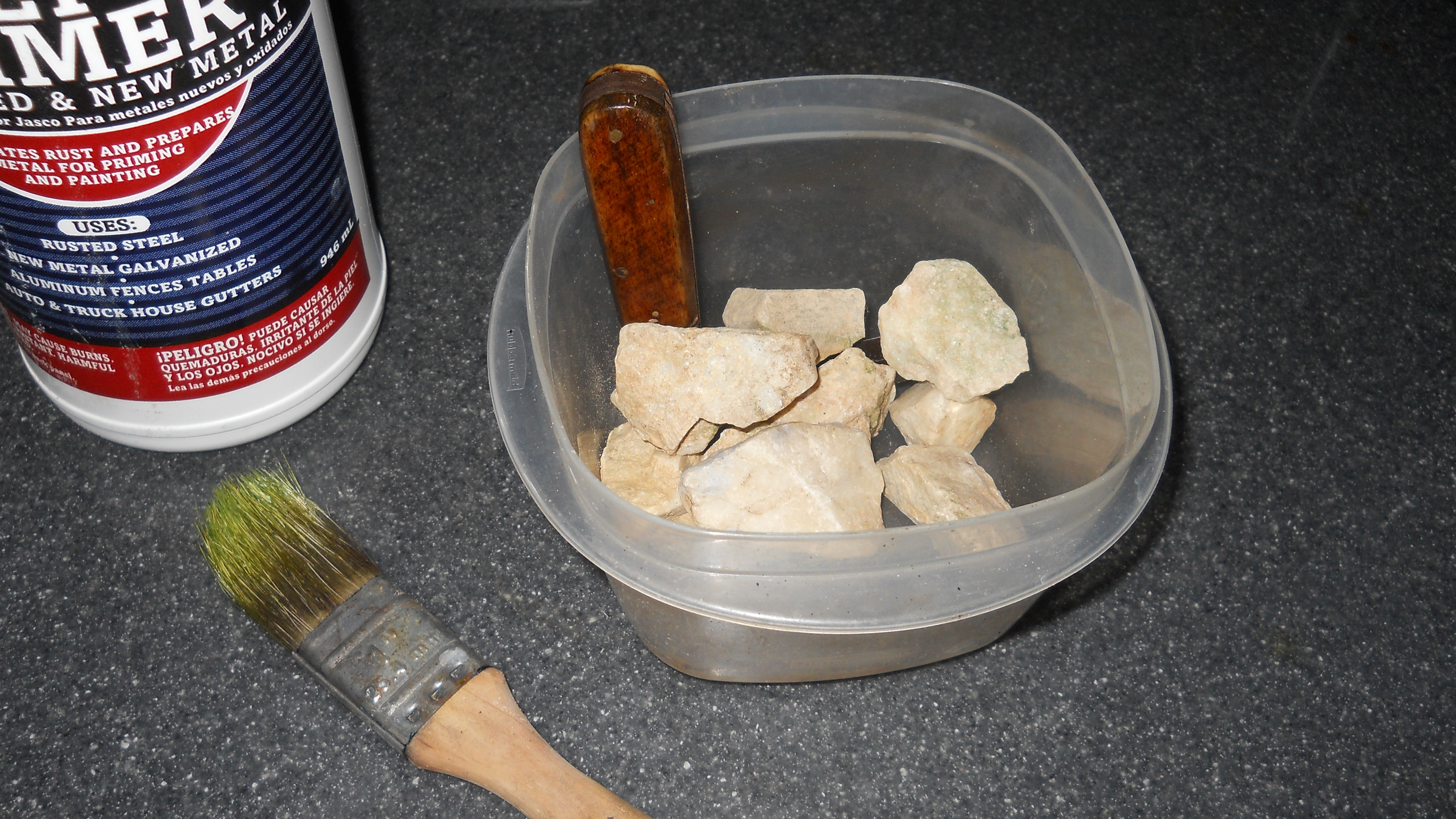

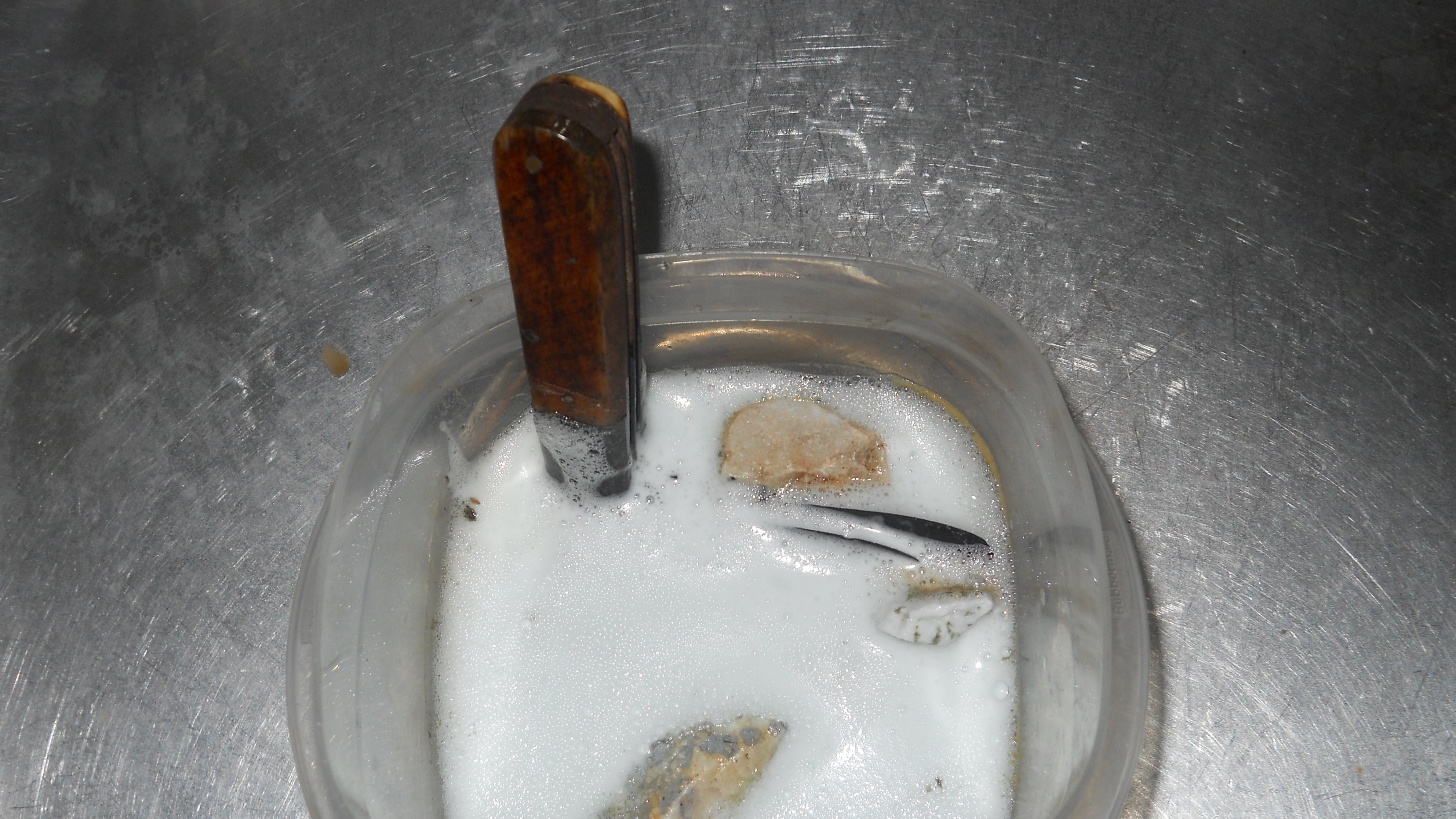

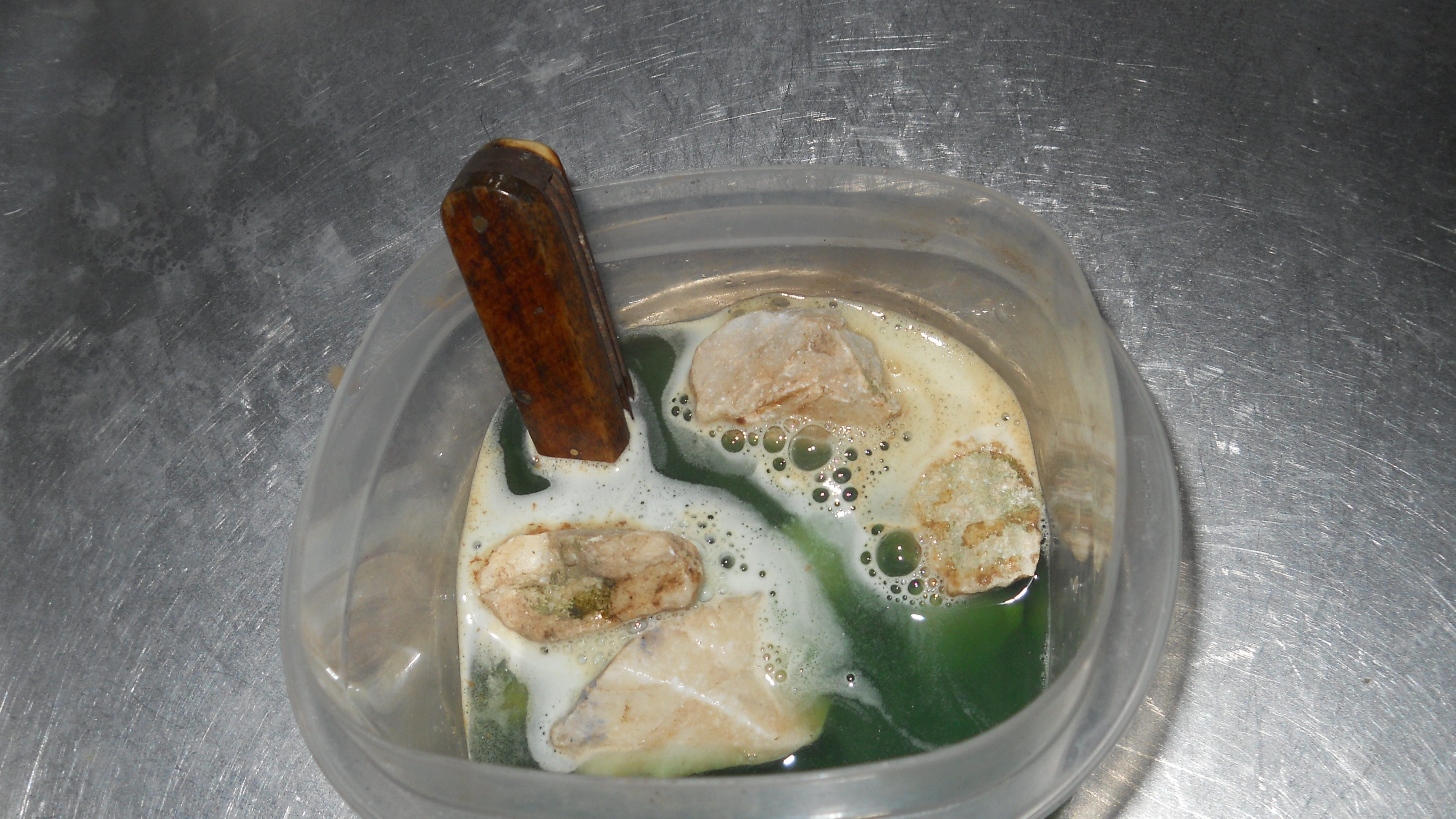

Want to get rid of rust with minimum loss of material?
This is something I have been using for a different hobby that only recently occurred to me that it could be used on rusty knives.
Phosphoric acid.
This acid converts ferrous iron to iron phosphate.
I've used it on auto body work when it was impractical to cut the rust out and make a new panel and have recently been using it
on vintage lawnmower restorations.
It can be found at Lowe's under the Jasco brand for under 10 bucks for a quart. Look in the paint stripper isle.
This is fairly serious stuff so PLEASE USE SAFTY GOGLES at a minimum.
***DO NOT GET THIS STUFF ON BONE***

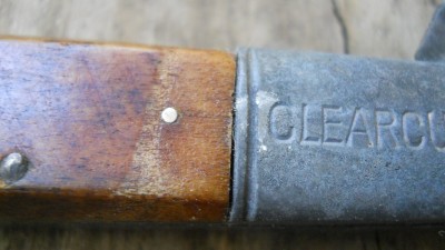

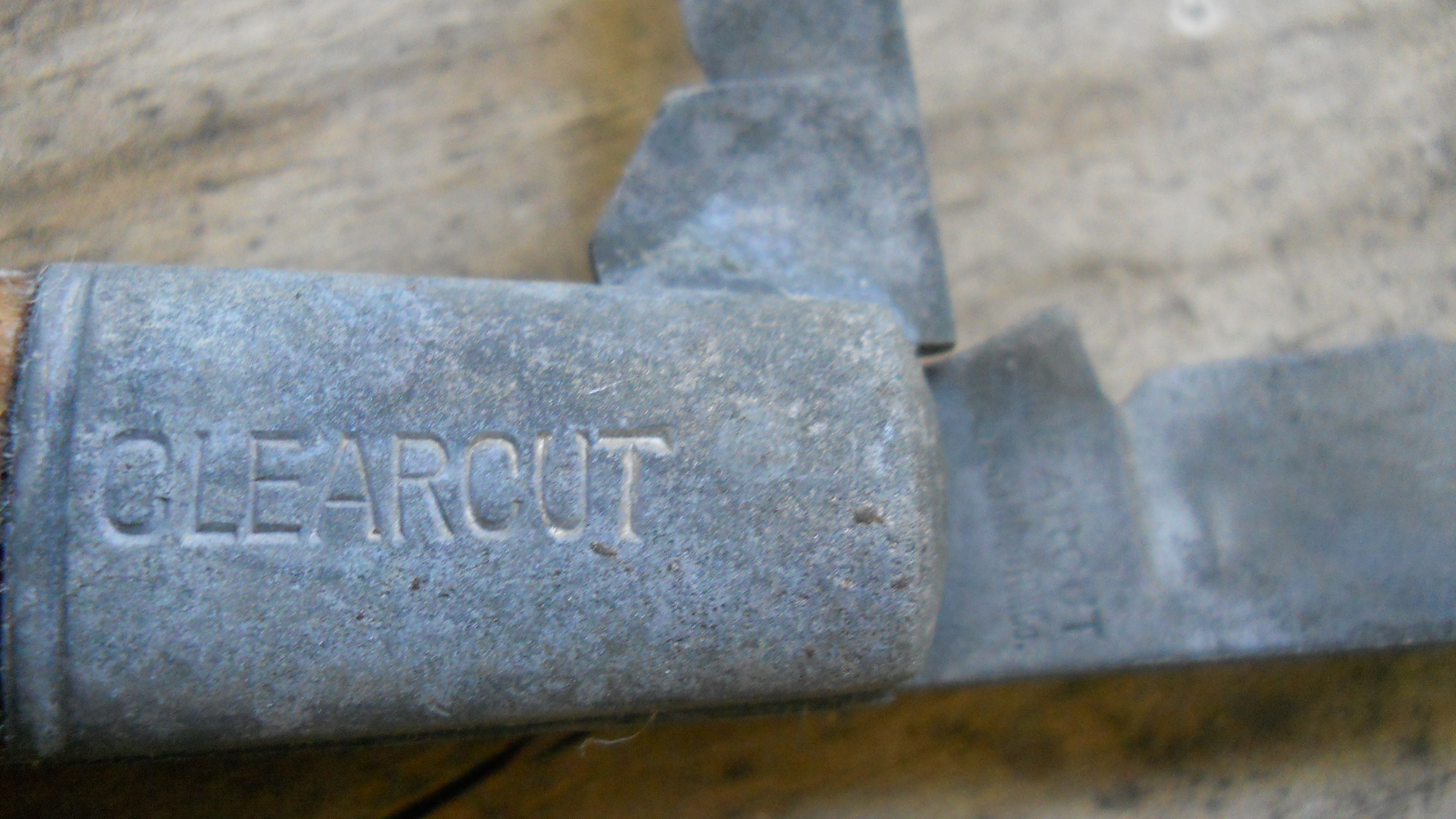

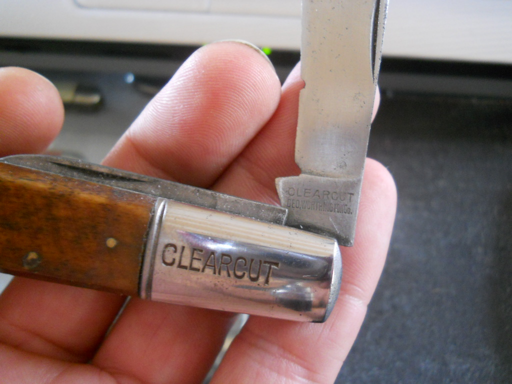

This Clearcut showed up at my door for under $10 including shipping.
It has the HARDEST snap and I have to keep my fingernails short to keep it from hurting my MANicure!
A lock on a knife?... I don't need no stinkin lock!
She's a daily driver now that she's clean.
..... Joe

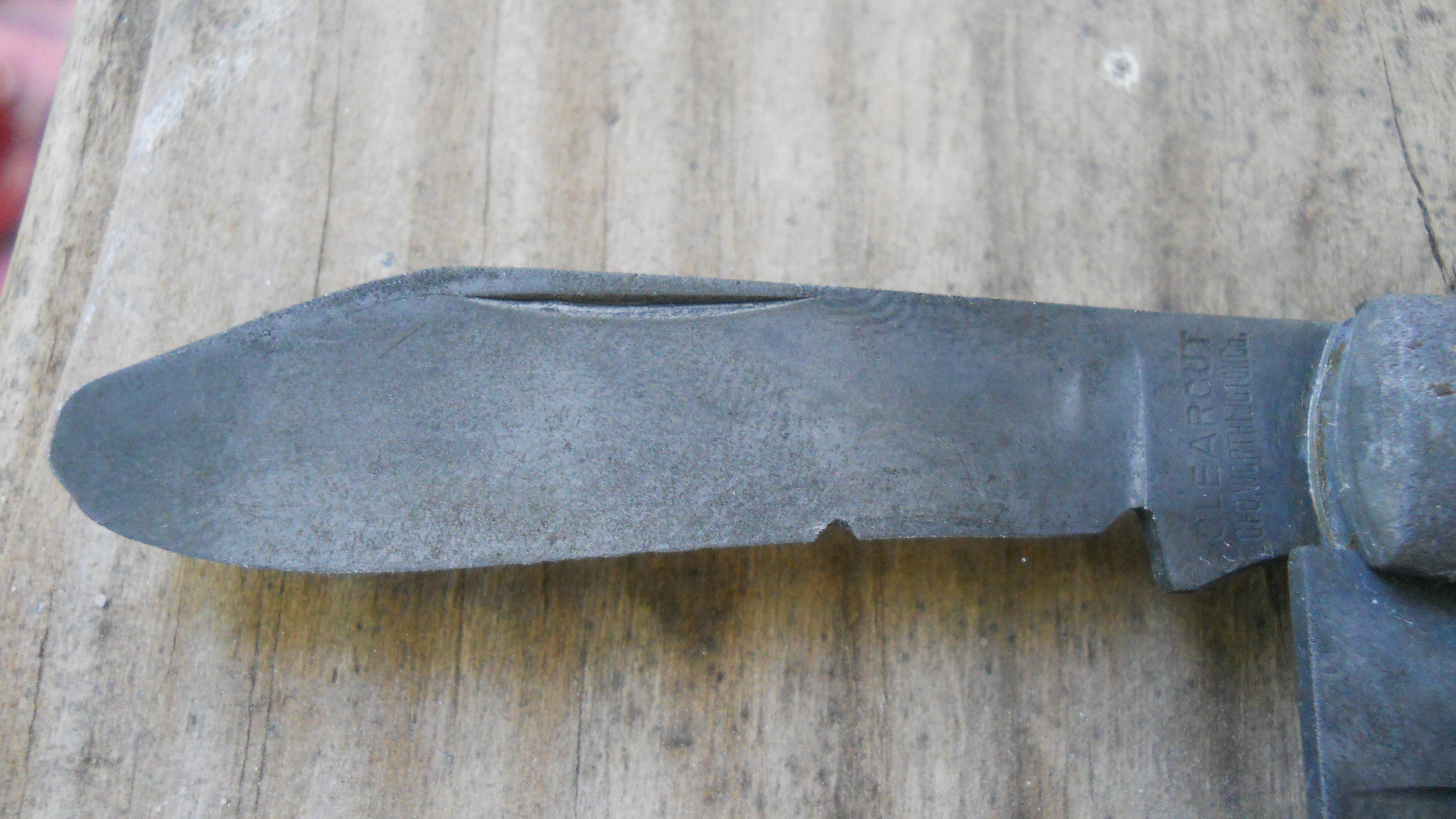

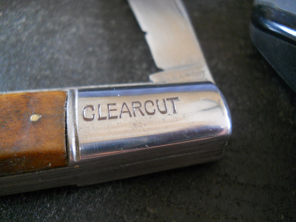

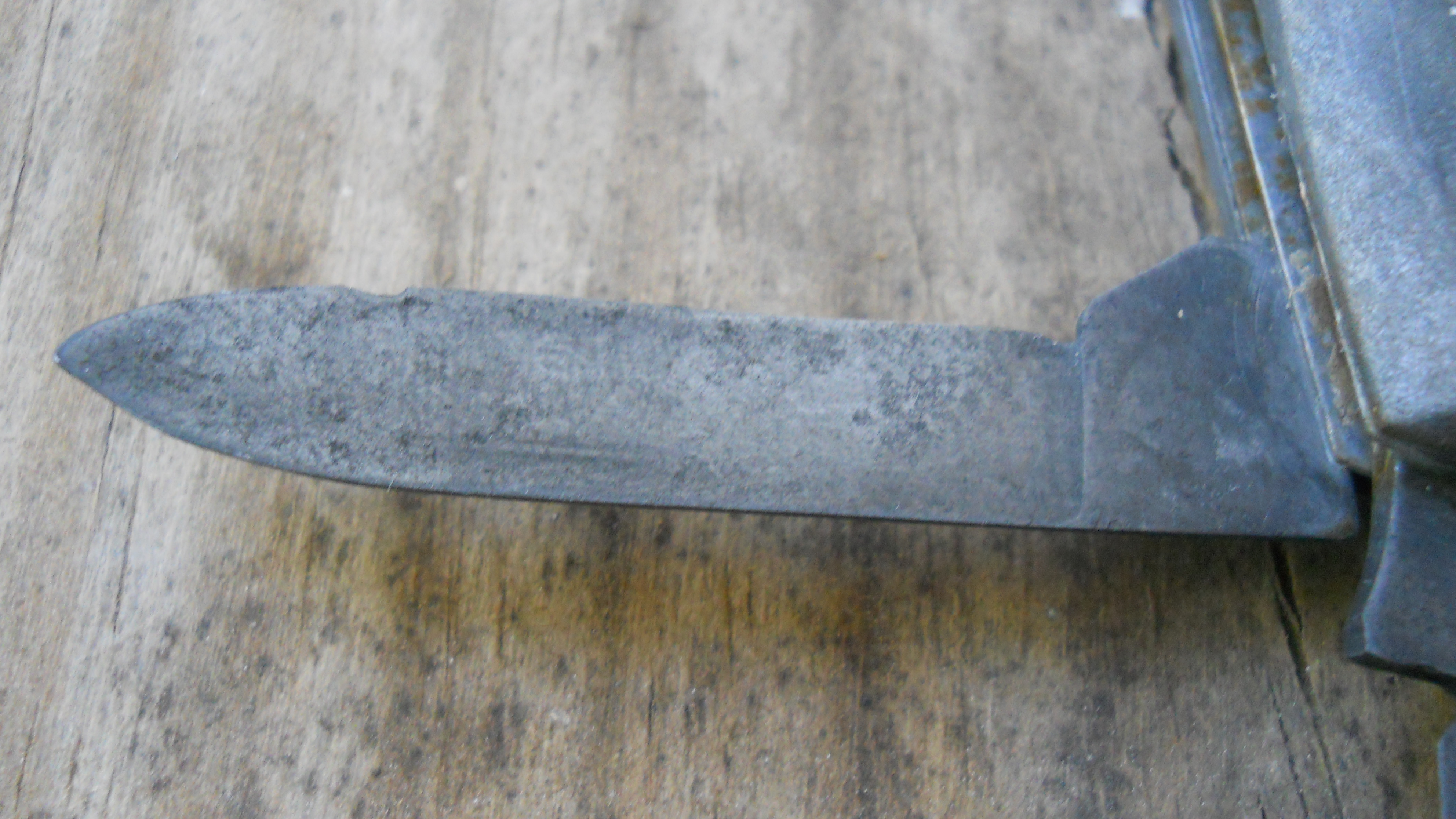

More pics.
The bolster has been sanded in 320 and went straight to the buffer!
It honestly didn't take much work!
Hope this can be of help to someone.
..... Joe
..... Joe

Pretty impressive stuff you got there. The knife turned out great! Really like the way you finished it up! Niccce knife, too!
