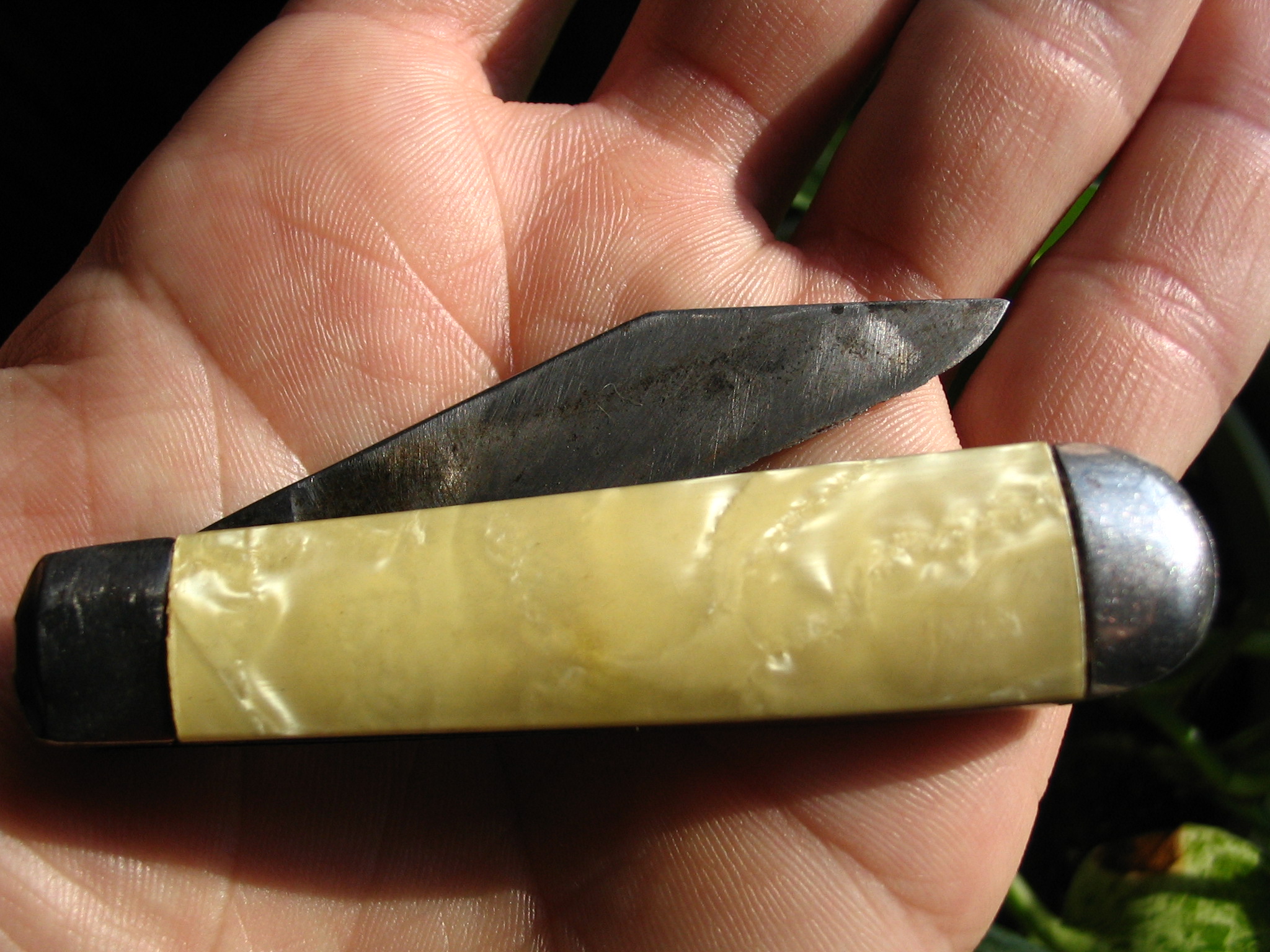

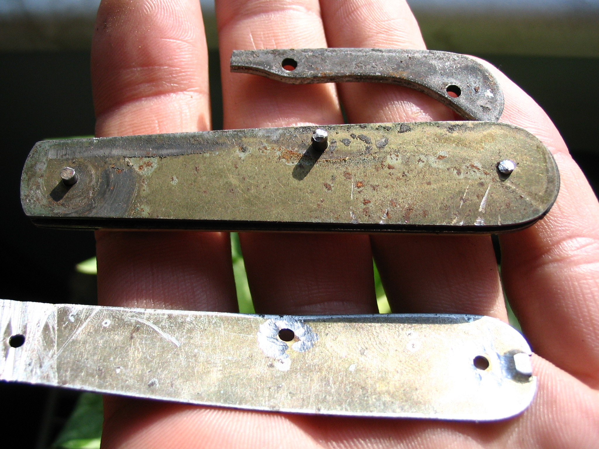

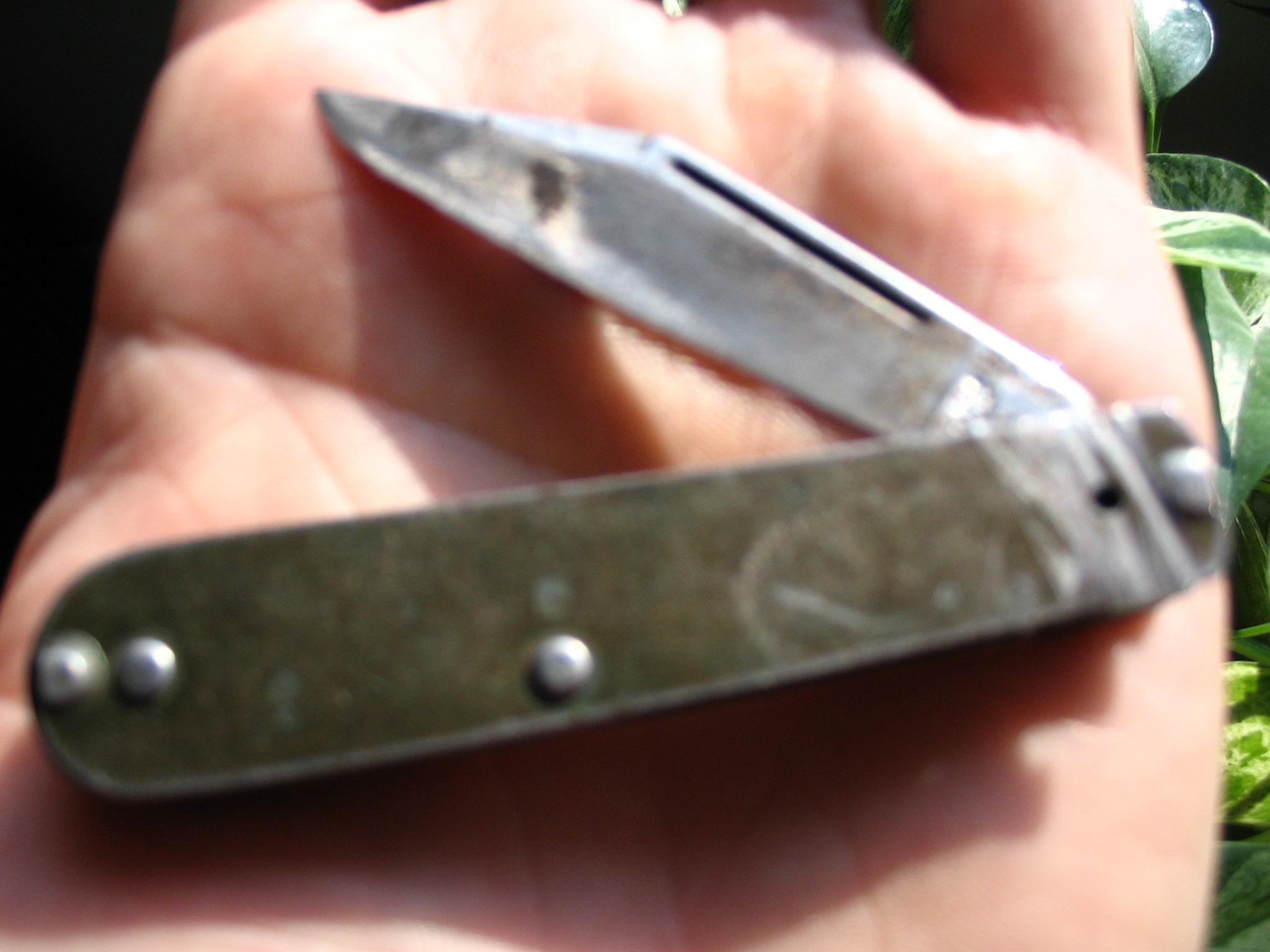

Hammer Jack Knife
Here's the Hammer I'm starting with. It started as a Cell wrapped shell handle in poor shape. It had a broken backspring and secondary blade. It was also missing one side of the handle. I thought it would make for a good first project knife.
I removed the remaining handle by prying up the crimped tabs at either end. Next I cut the pins to start disassembly. I got rid of the damaged spring and one of the liners. I finished disassembly then the parts were cleaned, lightly sanded and prepared for tinkering.
