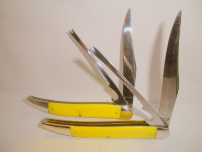

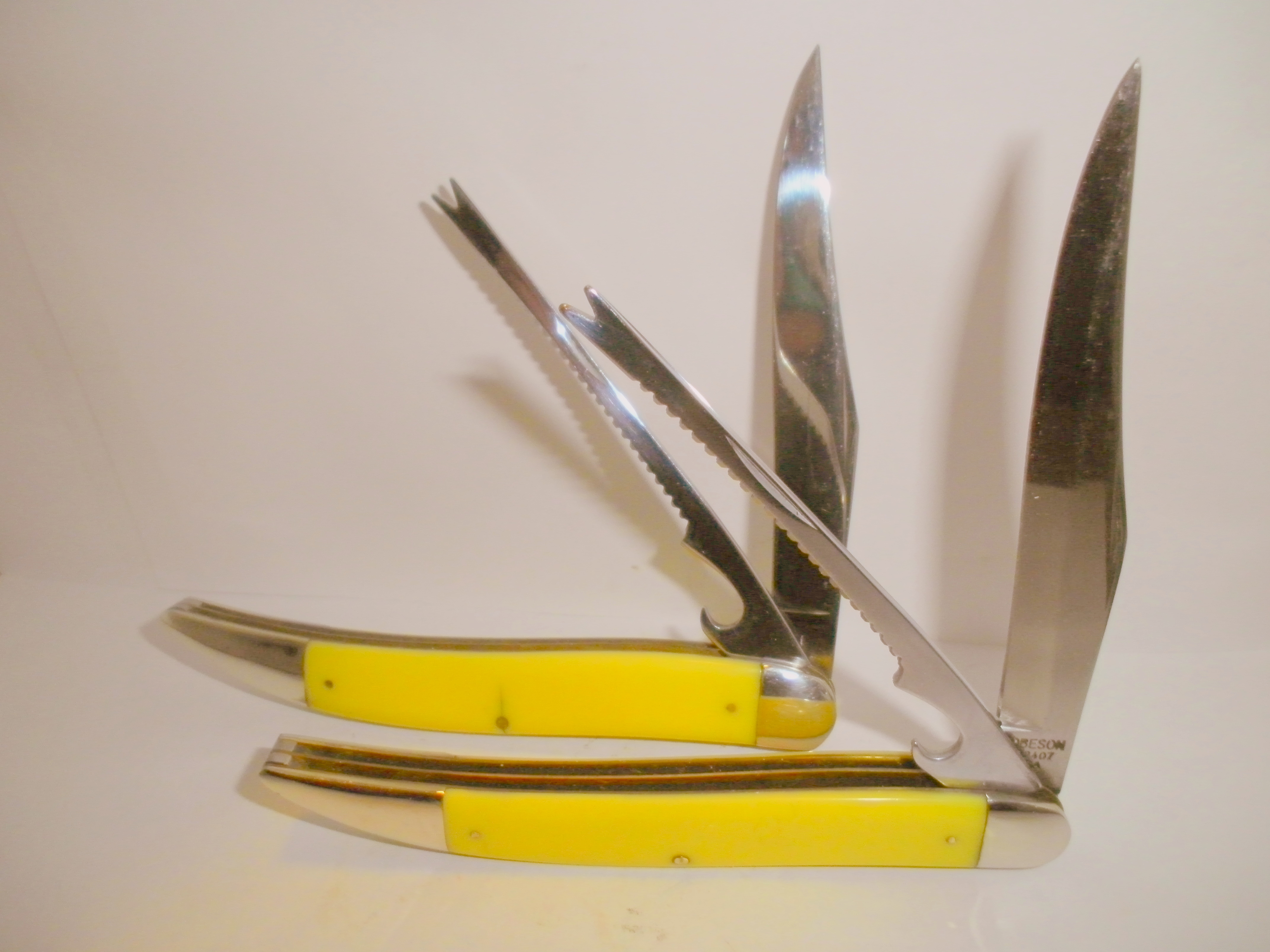

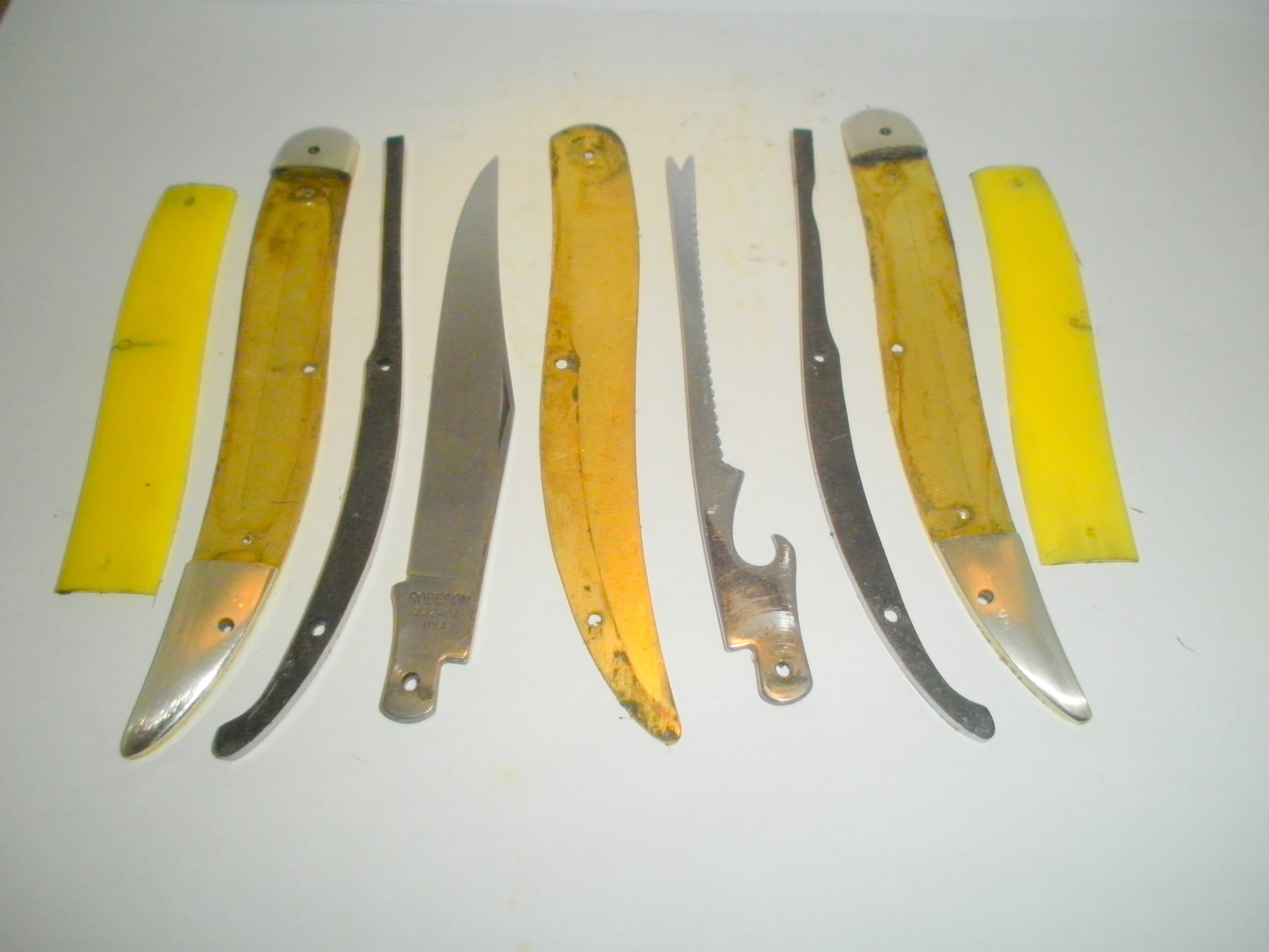

I picked this pair of Robeson Toothpick/Fish knives up from Charlie Noyes. They were some of the surplus knives from his 60's Robeson display.
The mint one's going into my collection as is. It's the one with stress cracks that has me pondering.
Both knives are identical, except one is flat ground on both sides and the other is saber ground on the front side only and flat ground on the reverse. The number on both is 822407. (comp. handles, 2-blades, brass liners/nickel silver bolsters, 407 toothpick pattern)
My first option would be to try and replace the cracked handles with as close as possible yellow comp. I have a source that I think I can get awfully close. That would essentially give me 2 versions of the same knife.
The second option would be to replace the handles with a different comp. material. I have a sheet of really nice waterfall celluloid, or maybe one of the modern corolon type materials. Although different, it would be in keeping with the knifes model/pattern number and would make a nice display piece.
The third option would be a full, all out customization. I mean, what a great pallet to start with, right? The rest of the knife is mint, but will never be original. I could leave it as is and just throw it in the tackle box. But, I already have a good W.R. Case that I use and don't really need another. Besides, customizing this knife would be a lot of fun.
Some ideas I had were, replacing the scaler blade with a secondary pen blade. That would require a very specific blade to do it right. It would have to be a fairly long pen blade, almost a small spear blade. The placement of the nail nick would have to fall right to be able to access it properly. And of course, the perfect fit in the open and closed positions is a must. ::hmm:: Nothing hard about any of that, right?
From there, full blown filework. Blades, backsprings, maybe even the liners. Maybe custom blade etches? Engraved bolsters! ::super_happy::
Then there's the handles! ::woot:: Pearl, Abalone, Stag! Not to mention all the new bones and fossil materials that are nothing short of stunning.
I ponder all these things and think, what would I have in the end? On the one hand, it's still gonna be a modified from original 60's era Robeson T/P Fish knife. But then, on the other hand I think, hey they customize Buck 110's by the thousands. Why not a 60's era Robeson T/P Fish knife?
The toothpick has always been my favorite pattern and i've never really had a custom Toothpick. Sooo...here I sit on the fence. Waiting to see which way the wind blows. Anybody wanna breeze in and help knock me off? :D WB

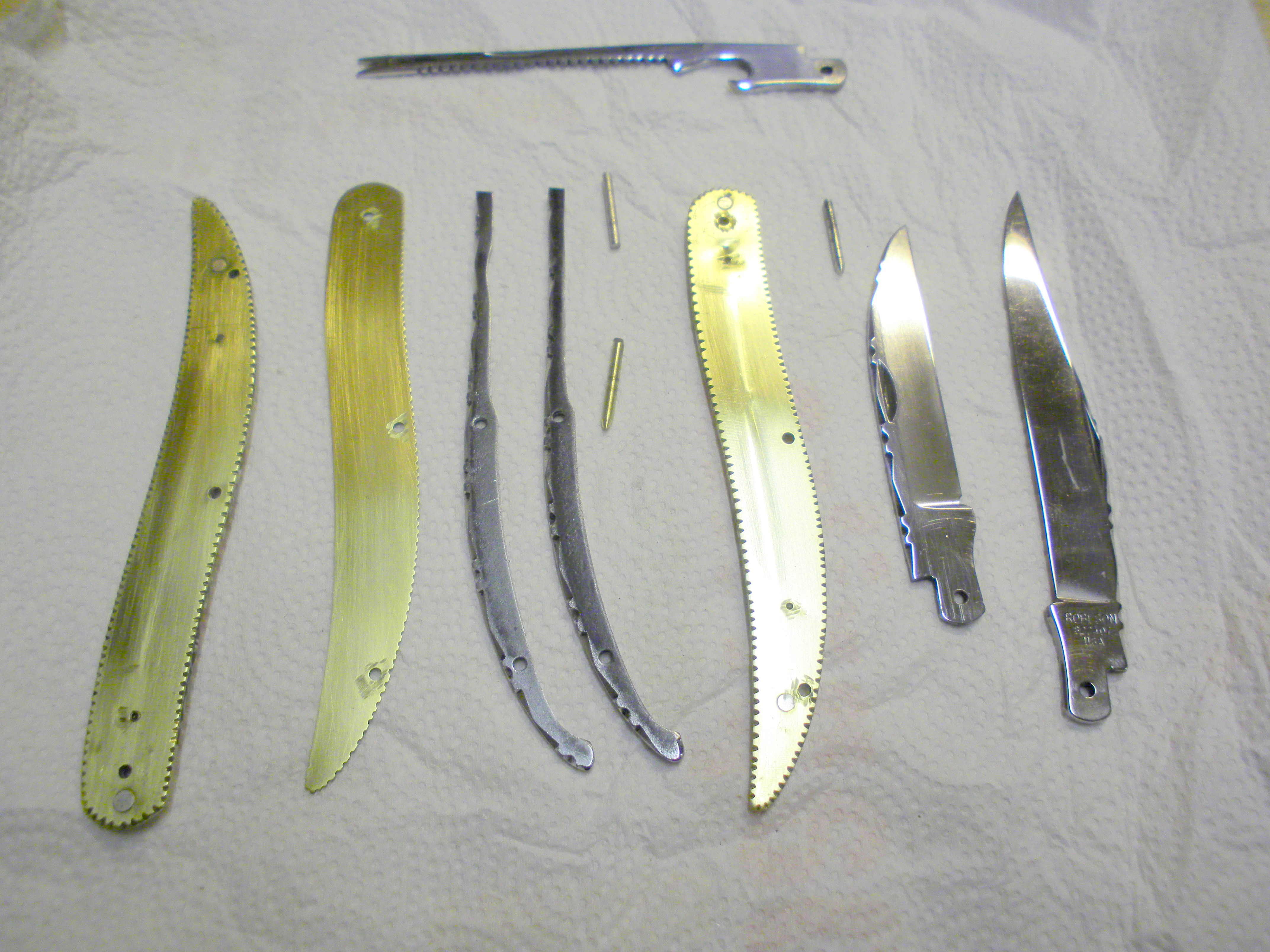

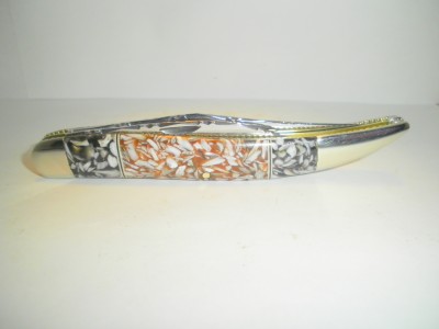

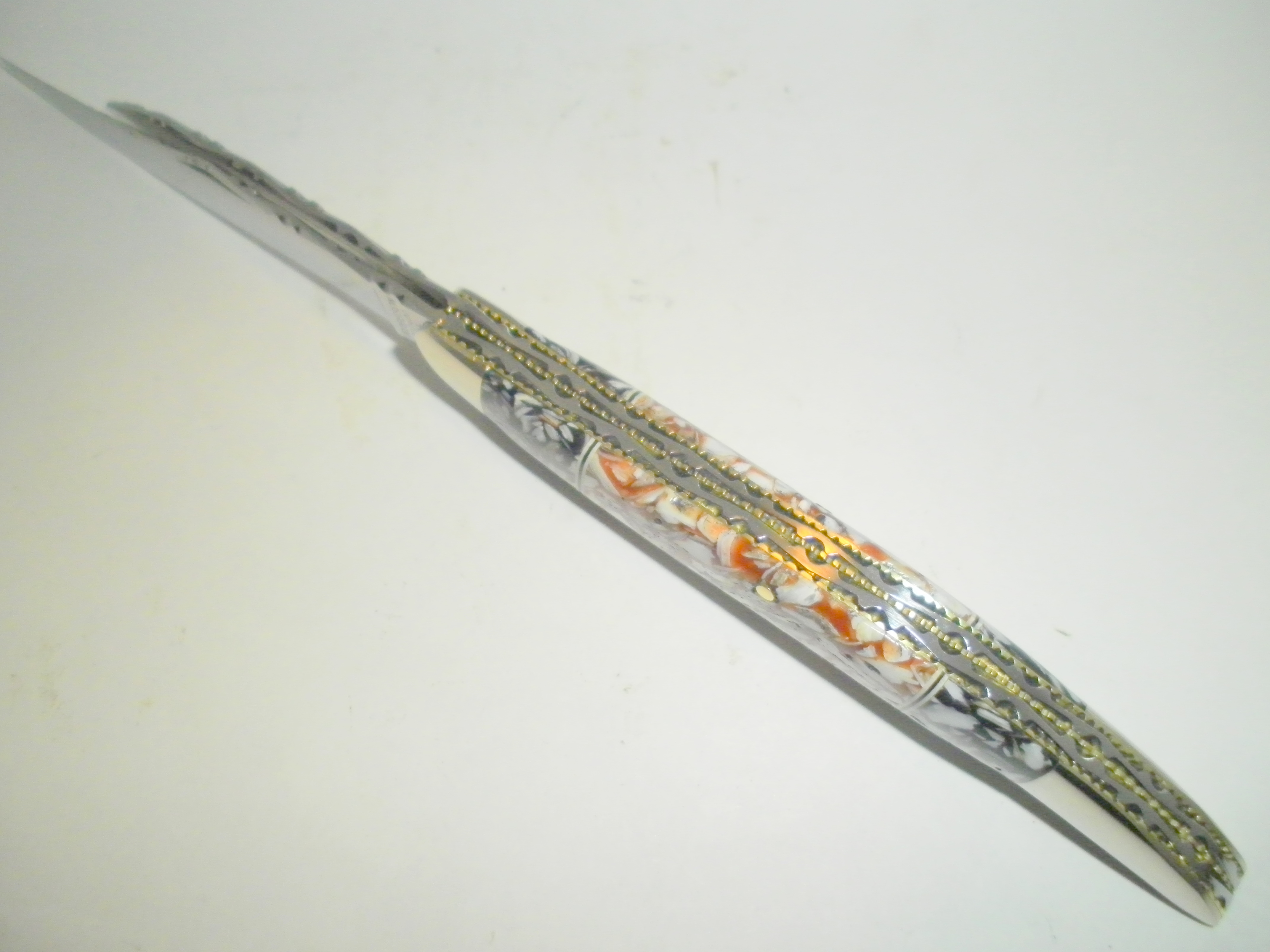

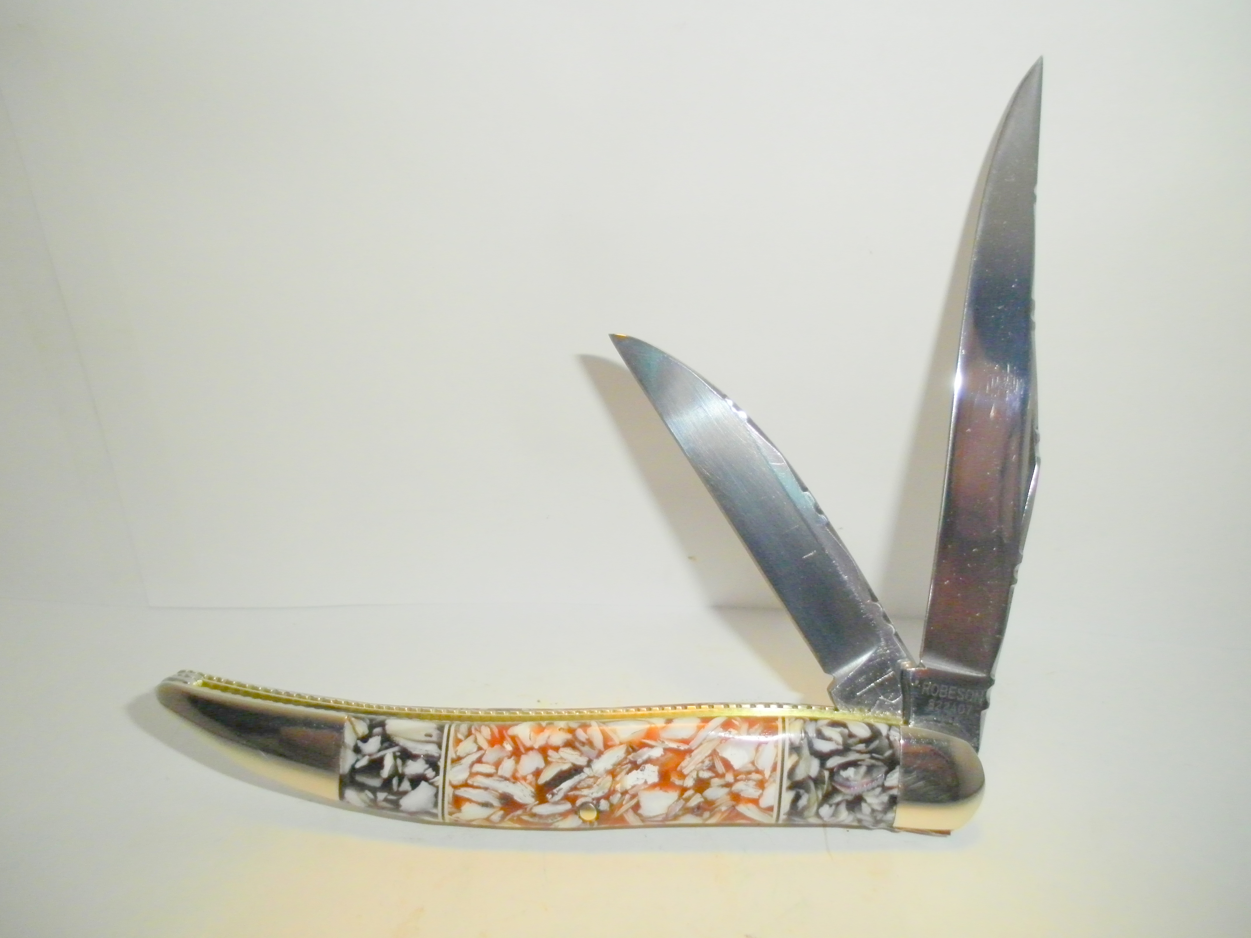

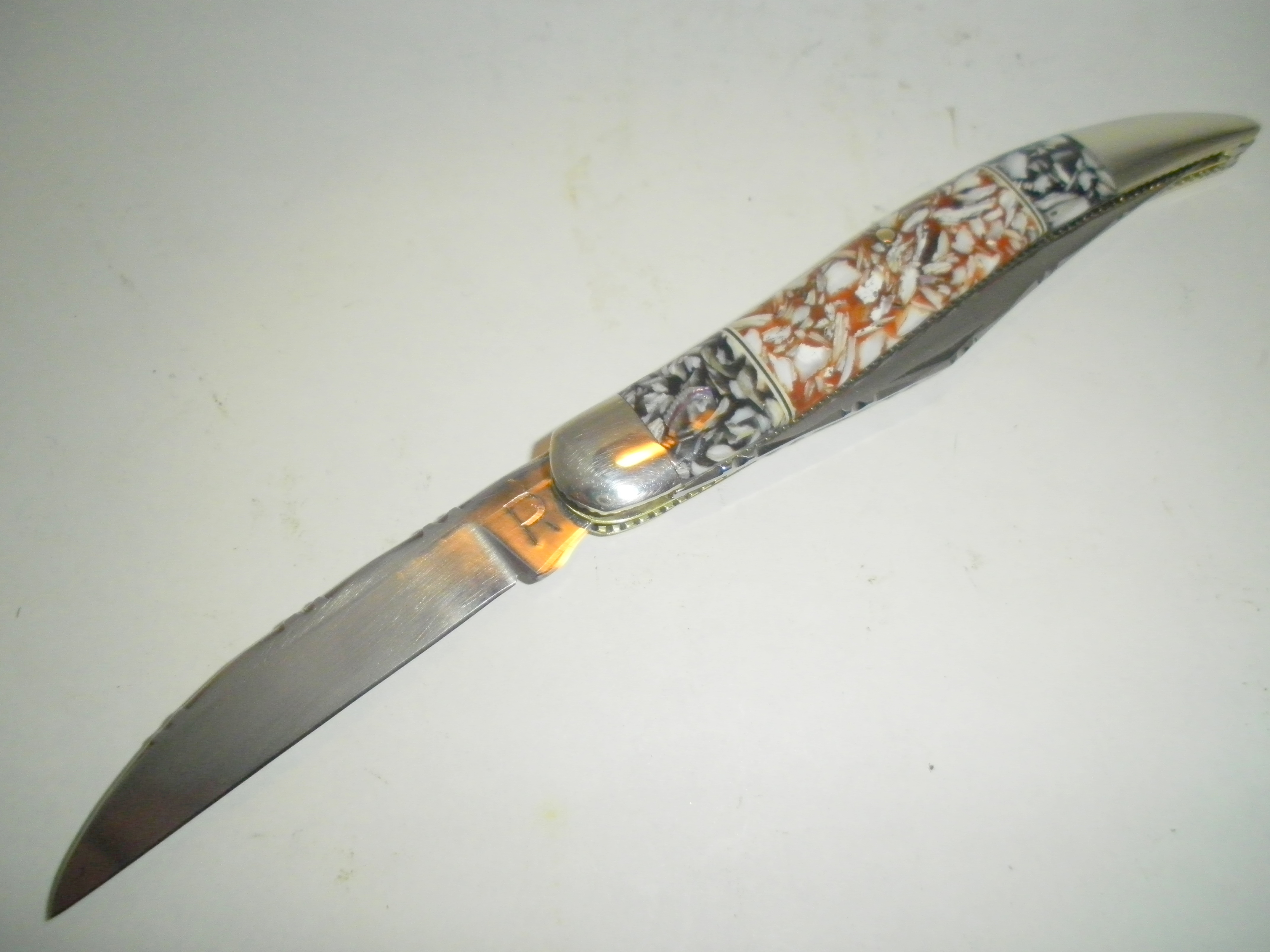

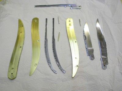

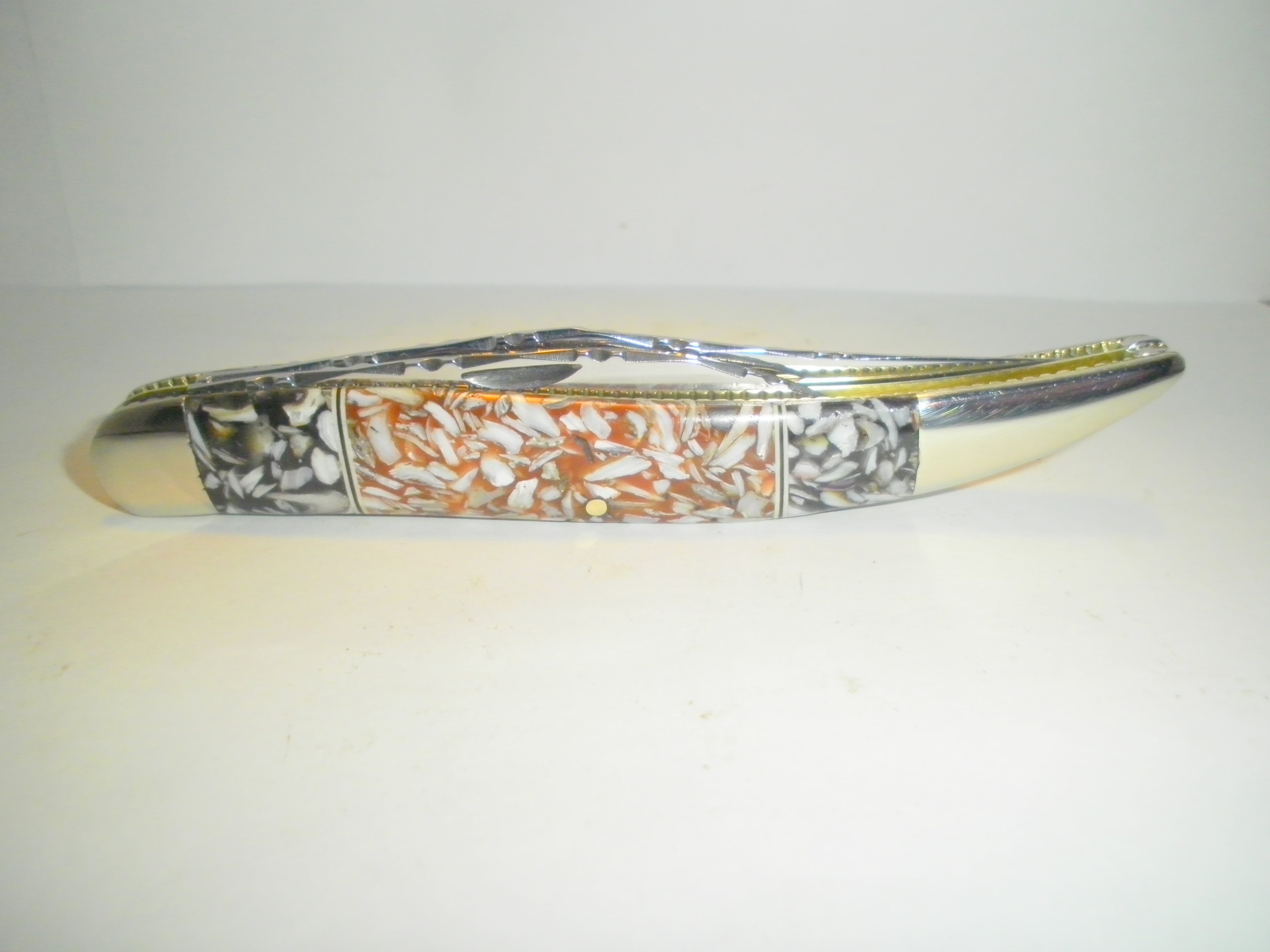

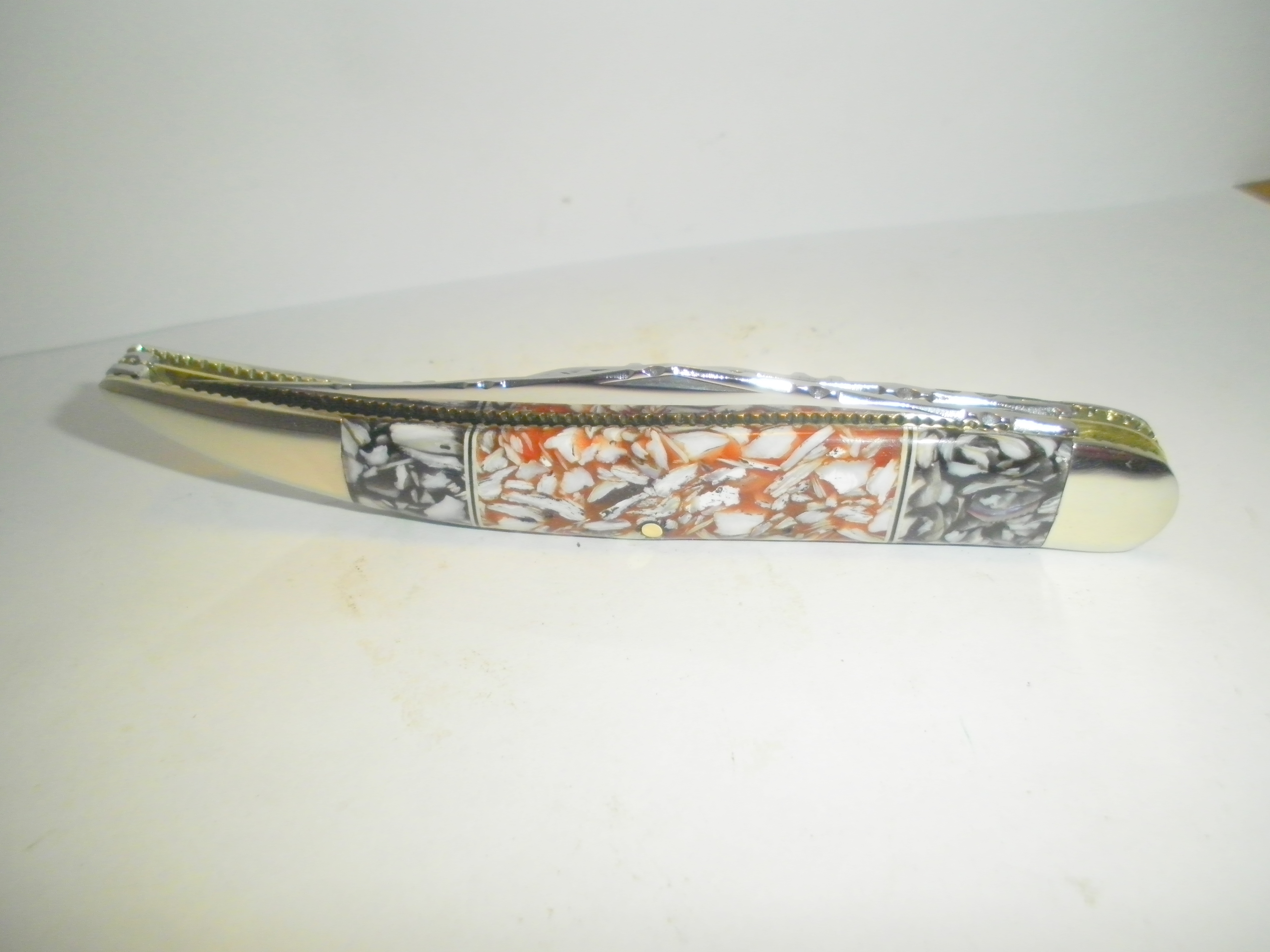

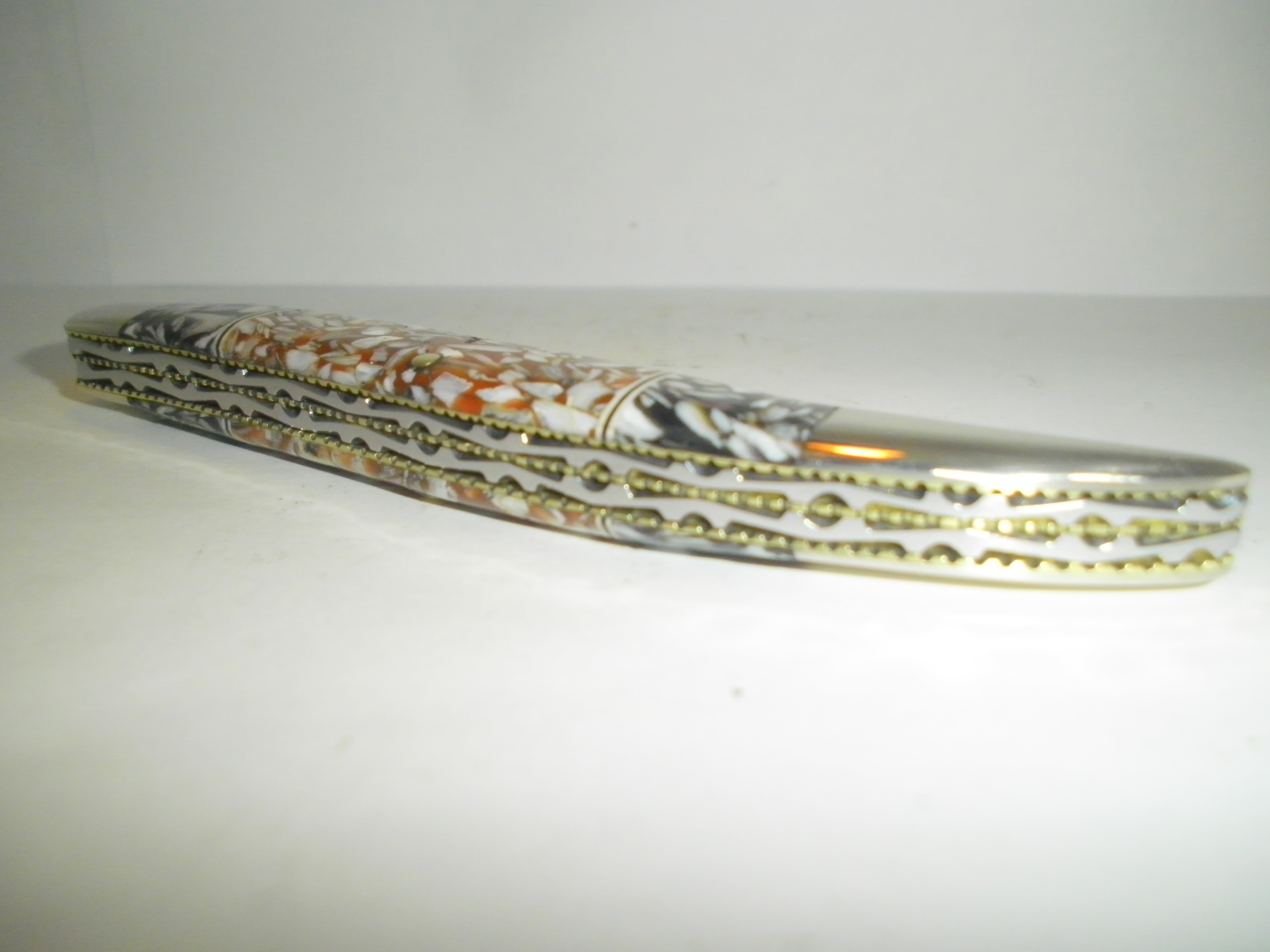

Welp, I got off the fence and here she is. I started with the rear knife in the OP pic.
Tear down complete, ready for customizing.
Custom work complete, a little more clean-up and polish on the insides of the liners and she's ready for reassembly.

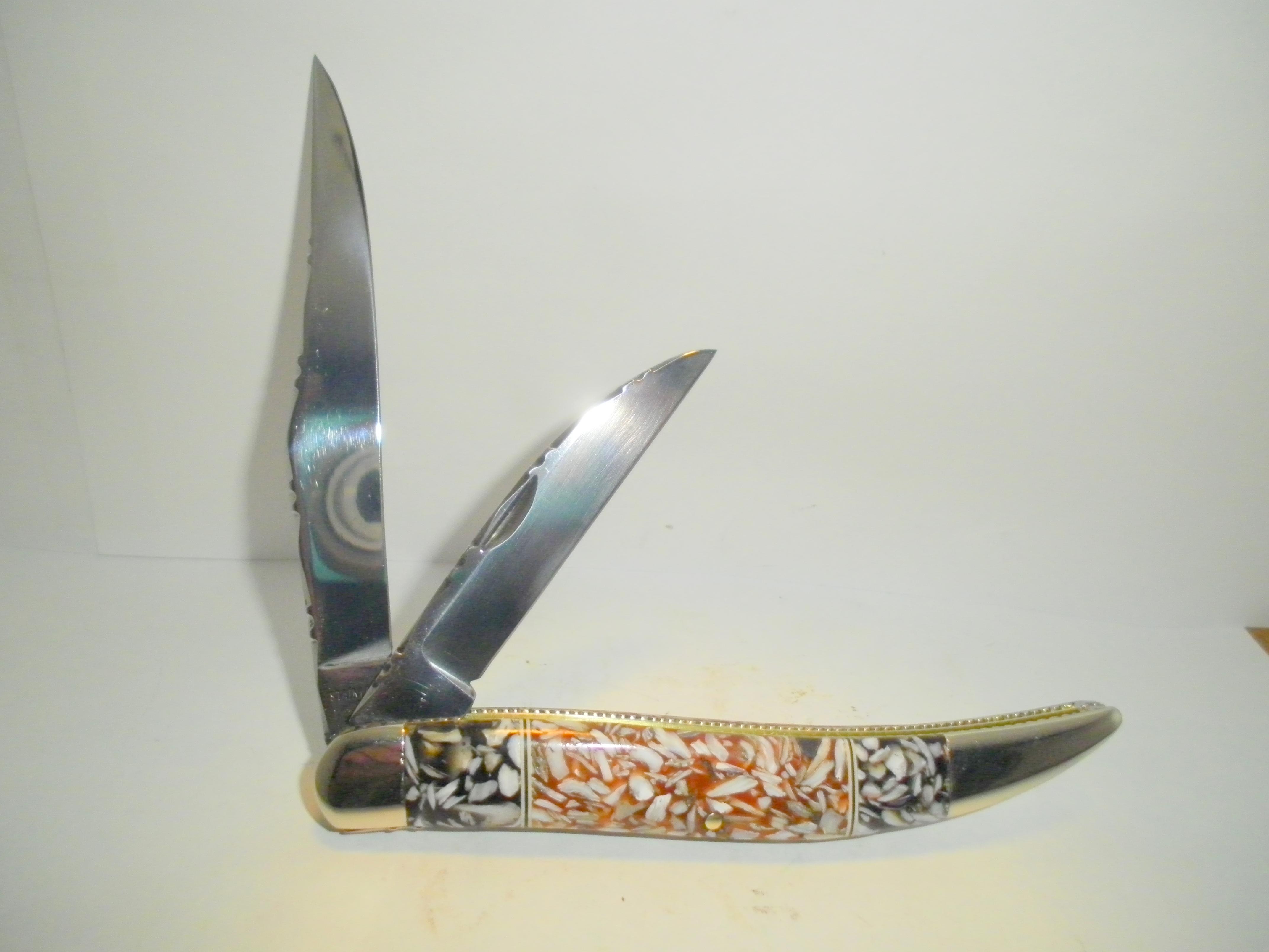

Reassembly complete!

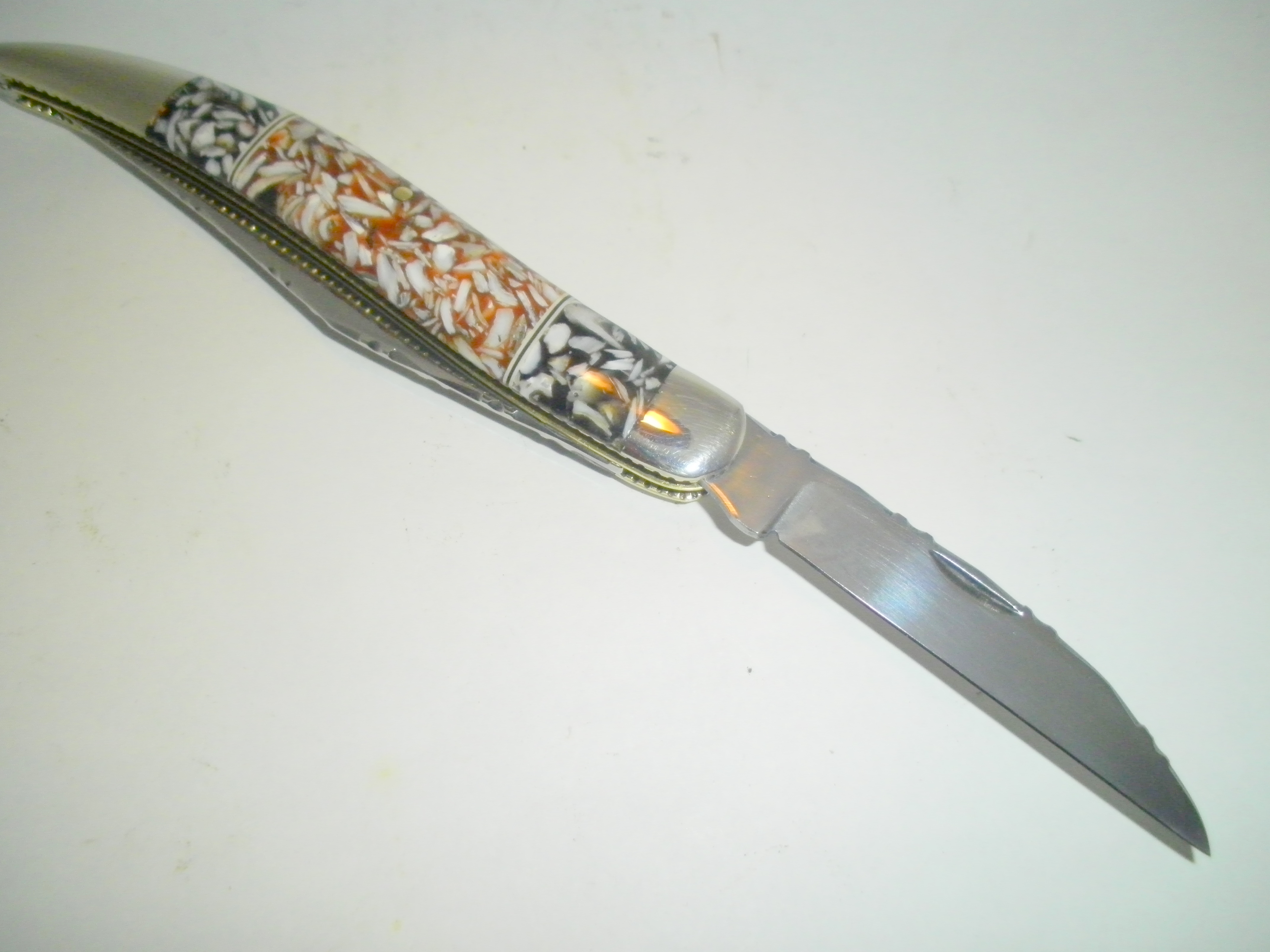

I made the wharncliffe blade from scratch. I'm not sure what SS Robeson used, but I used 440C. I had to mill 1/8" stock down to .082 and used the original clip blade as a pattern for the tang. Heat treat/temper should have it at about 58rc. The "R" tang stamp could be for Robeson, but happens to be the initial of my first name. 8)
All together I figure i've got about 40 hours in it from start to finish. Not counting the untold hours of the first 2 weeks trying to find a suitable replacement for the scaler bade. It finally dawned on me that I could spend years trying to find one. :roll: ::dang::
I'm still pondering getting the bolsters engraved, but probably won't till atleast after Christmas.
It was a fun project, hope ya'll like the end result as much as I do and hope Charlie feels that i've done the ol' girl justice.
WB

All I can say is WoW!!! :shock:
That Warnie looks like it was made for it. :lol:
I can see the hours and feel the cramps from all the filing. ::tired::
Super nice work, WB! ::tu::

:lol: Thanks Joe! I kinda thought I scaled the wharncliffe just about right too. And yep, it is amazing how many lineal inches there are in knife when you're going around it with a file.

Great job. ::tu:: You didn't waste time getting after that. Quite a transformation.

That is really impressive WB!
Did you do the heat treat on the blade yourself?
Very nice work!

Absolutely incredible WB!! :shock:

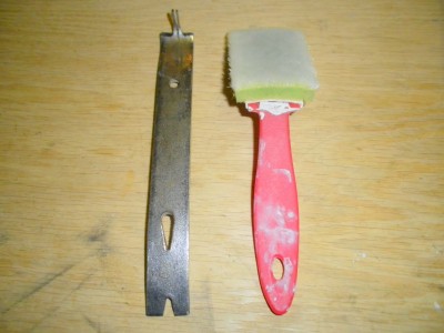

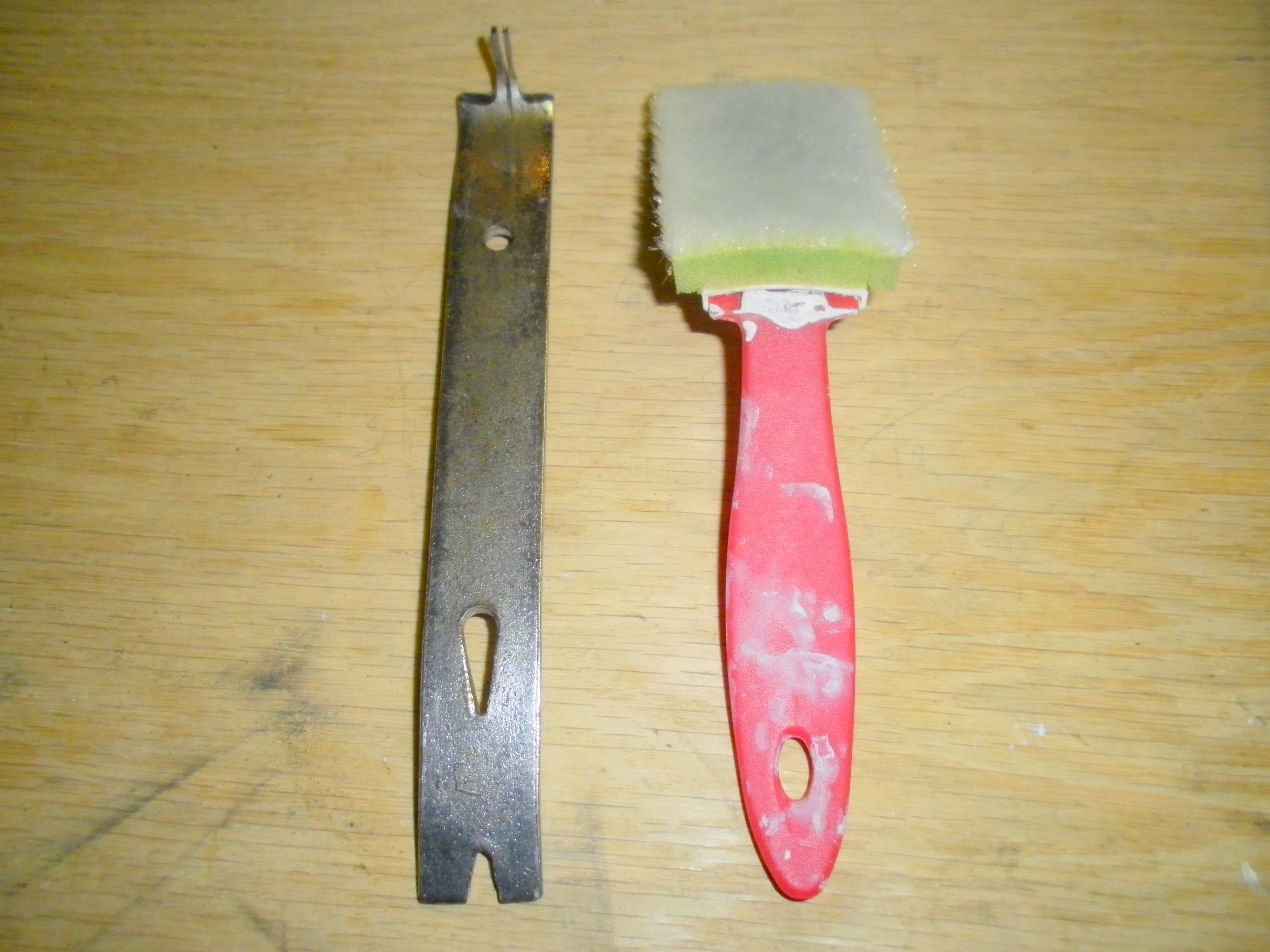

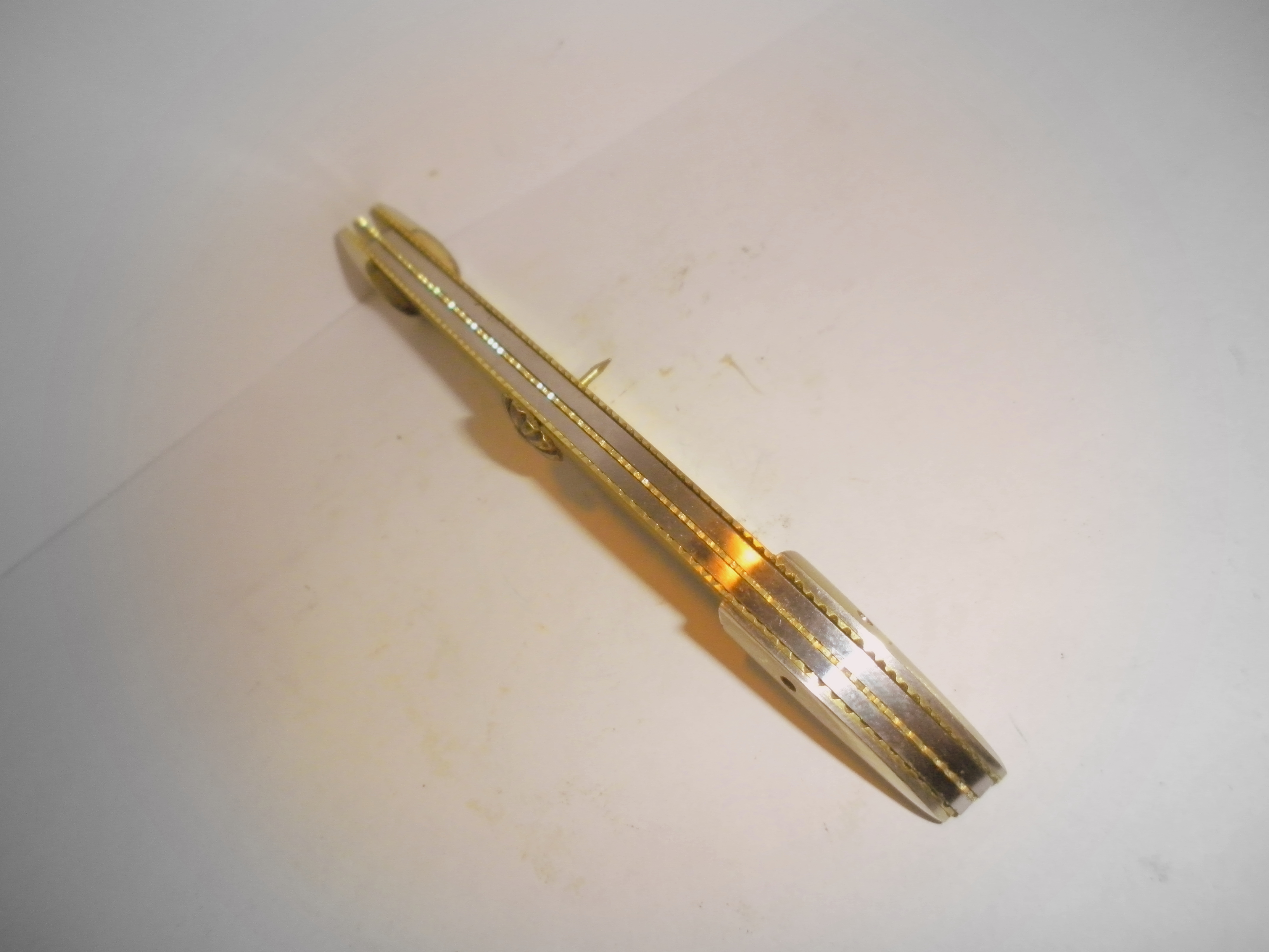

The only other pics that I took during this knife are these. First one is after coining the liners. I laid out marks every 1/16" and just counted strokes. 1,2,3,4...1,2,3,4,... ::tired::
The second is of a couple of tools I found useful. The soft paint pad worked pretty good at removing polishing compound from the filework. I found that it worked best if I caught it while the compound was still soft. It tends to set up as it cools down.

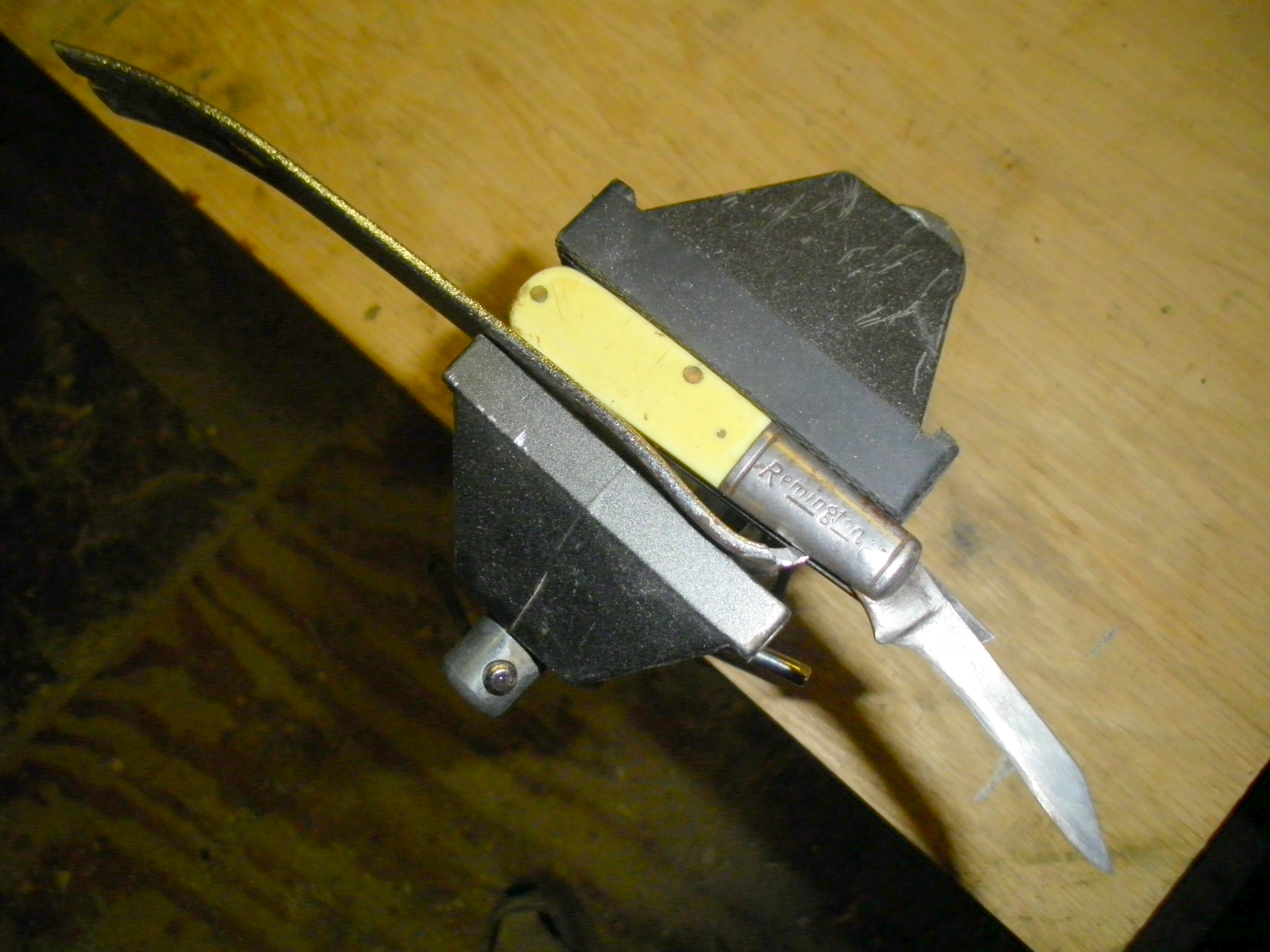

The other tool is my version of a backspring tool. I made it from a mini prybar. I used a 4" grinder to remove most of the material and cut the slot with the Dremmel cut-off wheel. (kinda wish i'd done a neater job of it now) The tempered steel in the bar, makes for a tough backspring tool. Just had to be careful to not overheat the metal while making it. It works perfect.
I'll get some pics too of the rest of the set-up I used with the backspring tool.

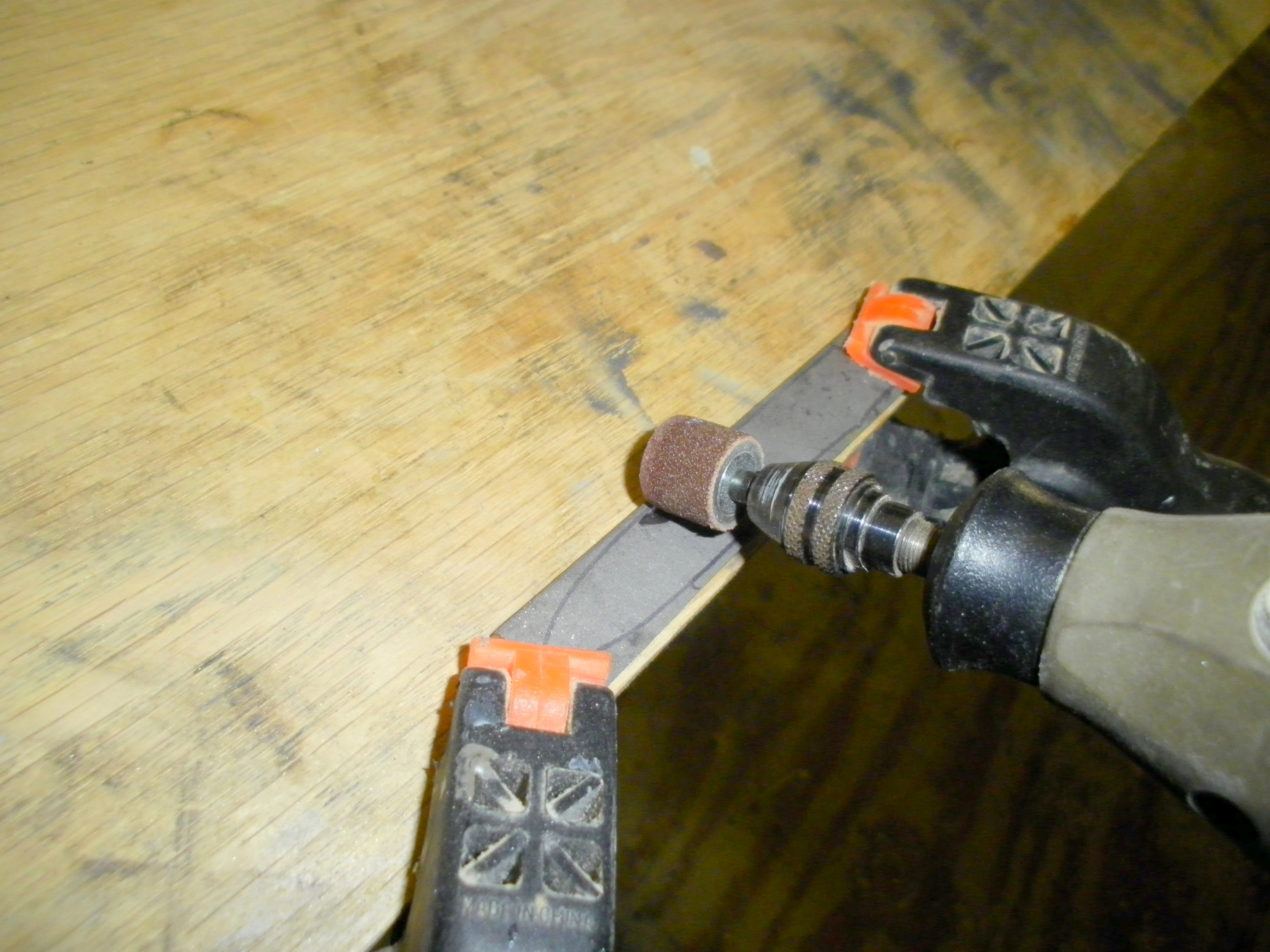

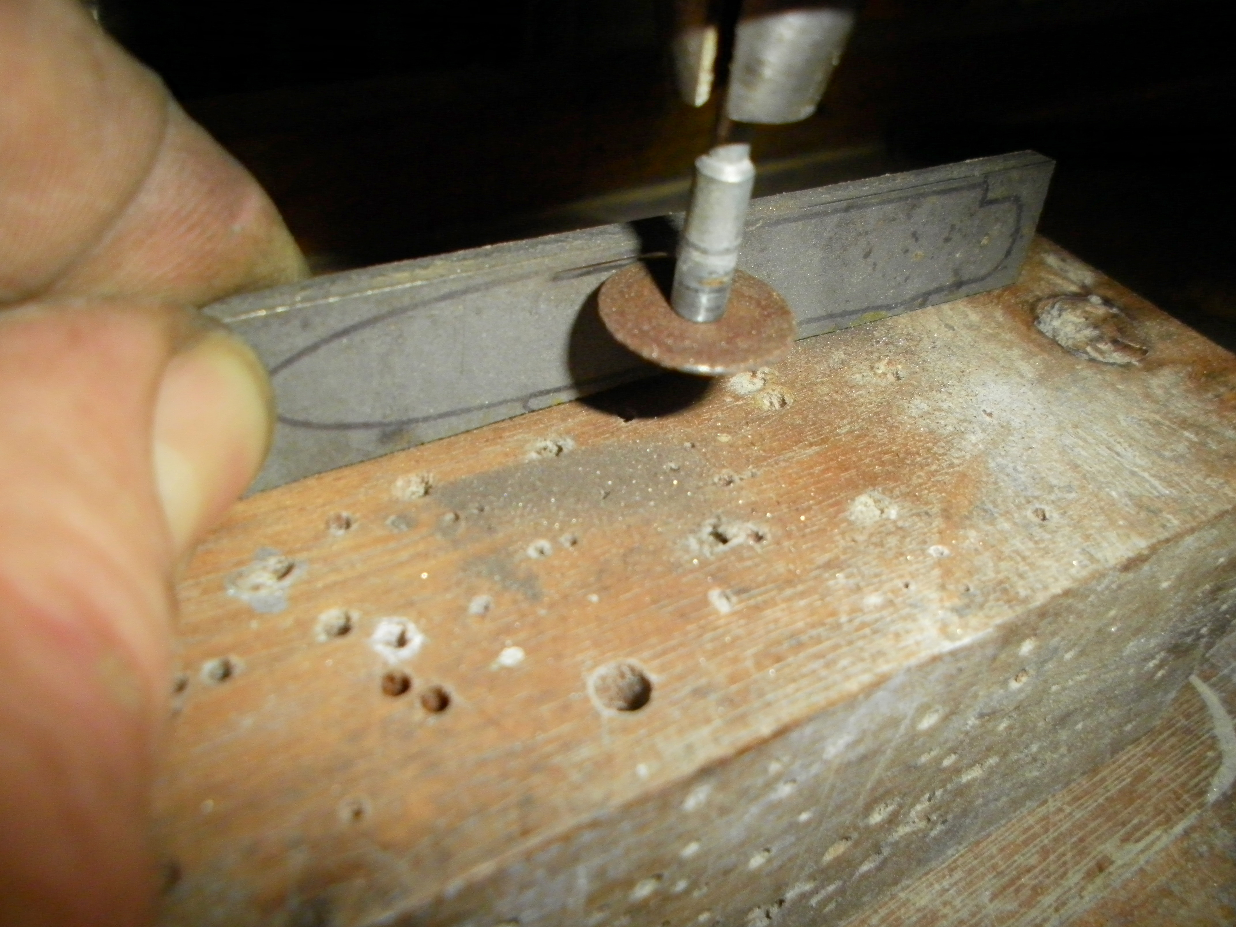

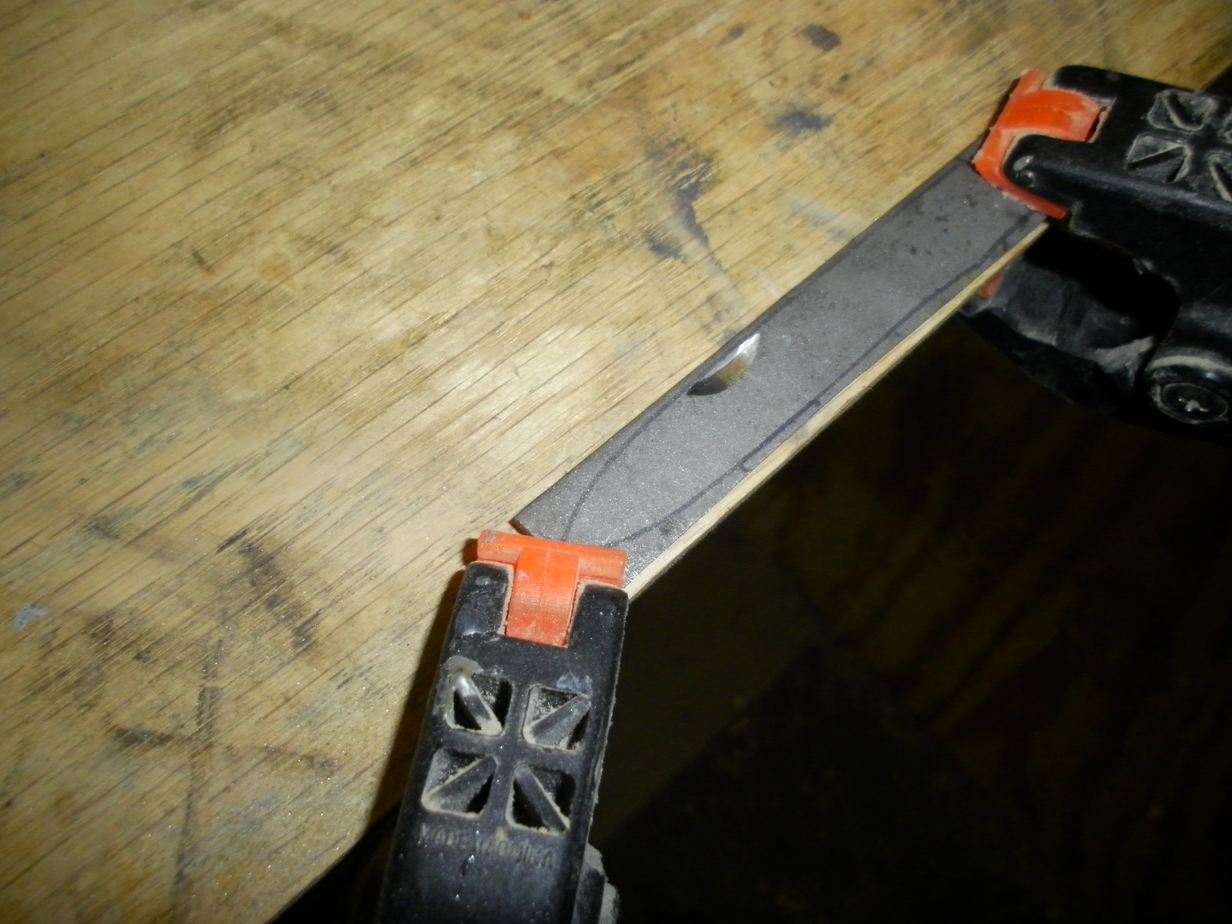

Here's some pics of how I did the nailnick.
Chuck up a cutoff wheel in a drill press. Stand the blade blank up and lower the arbour to the prefered height, lock it in. Cut a slot by sliding the blank against the wheel. Travel back and forth all depends on how long you want the pull. Cut to approx. half the thickness of the blank.

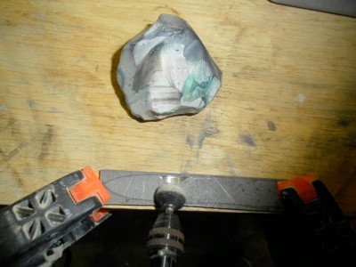

After completeing the slot, clamp the blank to a work surface. Using a rotary tool fitted with a small drum sanding attachment, cut in the concave area by starting in the center of the slot and working side to side toward the edges. When almost complete, switch to fine grit sleeve and work the concave from one end to the other. This will even up the concave and leave a smooth surface for polishing.

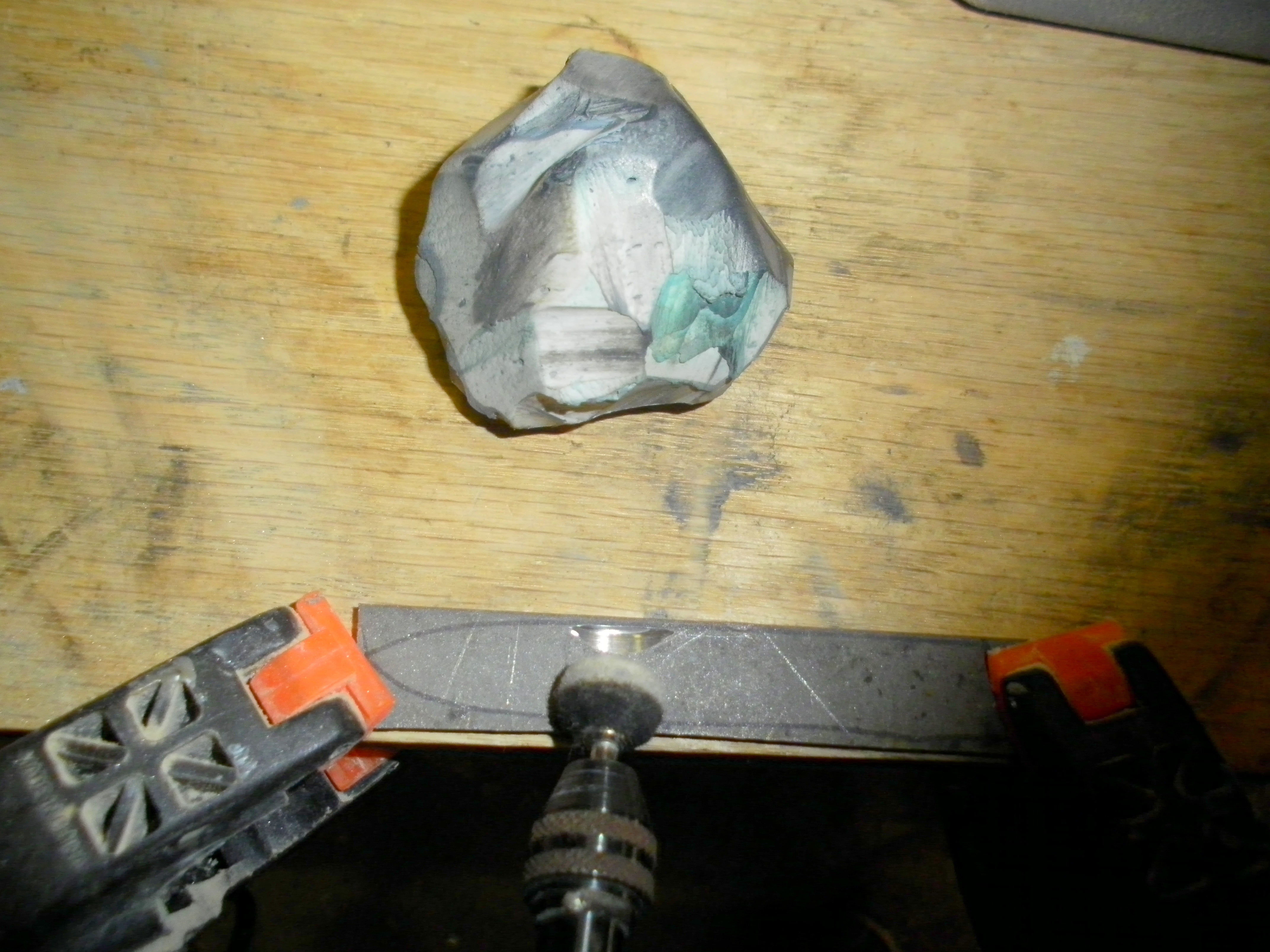

Finish up by buffing to a nice shine. If heat treating the blade, you can skip the polish till after the heat treat.
This is a pic of how the backspring tool works. The vises rubber back jaw allows the springs to "over travel" and relieve tension on the blades.
I'm sure there are better ways of doing these things, these are just ways i've found to do them using the stuff I have at my disposal.
WB
P.S. ::hmm:: Not sure how that last pic got there.
