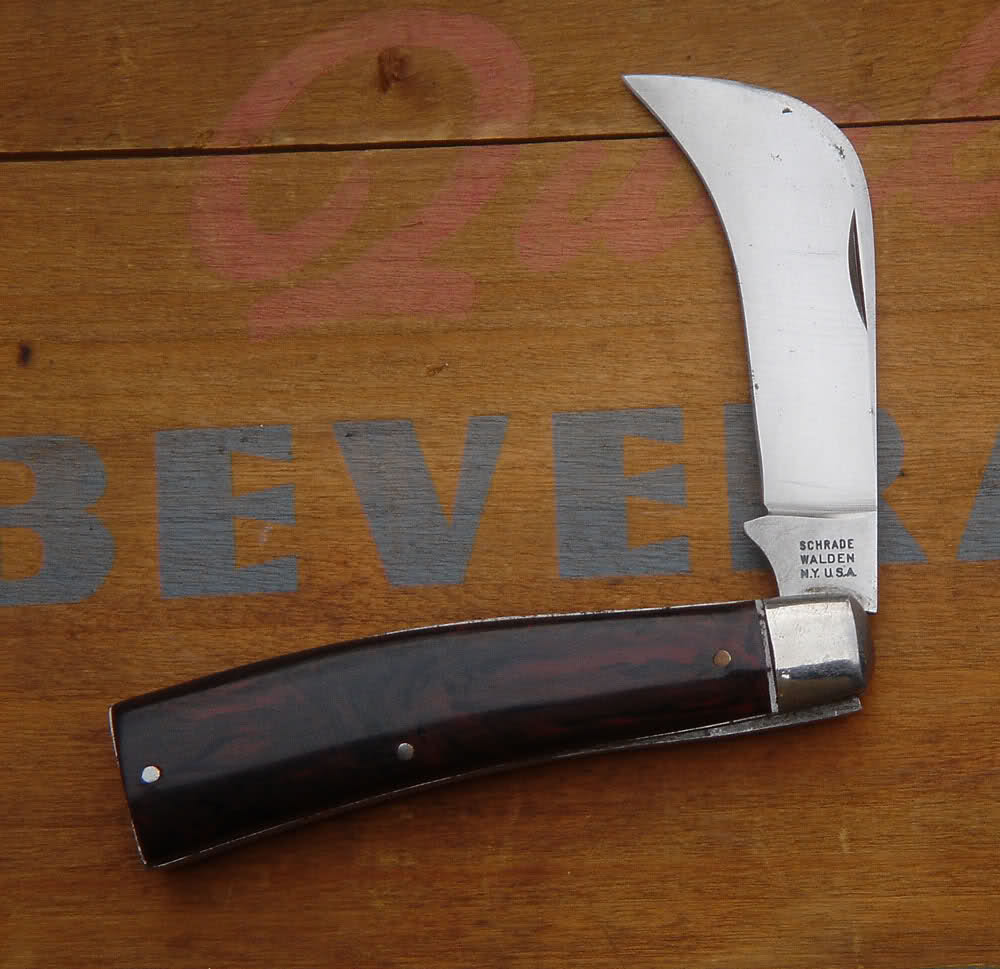

That's handle material is actually an early plastic, went by swirl mahogany at the factory. It was used fairly extensively by Schrade Walden/Ulster for a time before delrin took hold, roughly the early to mid-fifties. Looked fine at first but time wasn't very friendly to it, prone to shrinkage and warping.
Here's a shot of an old Schrade hawkbill with the smooth version of that cover material, note the telltale shrinkage both at the bolster and the front and back edges:

So much for my using the delrin to date the knife then. ::doh::
Eric for my future edification, are you saying you can tell the handles are swirl mahogany because of gaps at the bolsters ? If so, is the shrinkage you mentioned also the cause of the cracking of the material ? Tryin to learn me sumpin here.

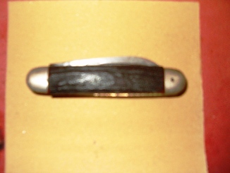

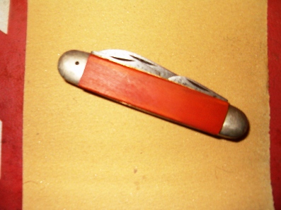

Got my scale material in and I am trying to decide which to use.
The first is amber stag bone, I know it's black but when i buff it I expect some of the amber to show through. The second is Autom Gold dyed smooth bone.
Right now I am leaning towards the stag bone.

Posts: 39458
Re: an old user
Post by jerryd6818 »
If it were mine, I'd go with the jigged amber.
gringo
Posts: 2033
Joined: Sun Mar 02, 2008 7:17 pm
Re: an old user
Post by gringo »
hummm...do the stag and send me the bone???? :D

You are right the color will show up as you sand down and polish the bone.
You will be surprised at the change. It is my favorite part about working with bone handles.
