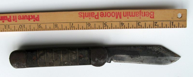

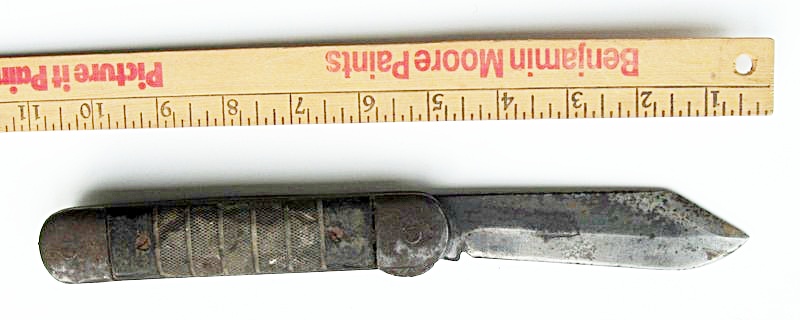

OK, here are a couple of pictures- they're not the best quality, but I will take a coupld more when I receive the knife. I plan to do something like a before & after & along the way profile- this tool may need surgery to save it. This is going to be a user tool, not a wall hanger. By 'User', I mean to peel an orange or open an envelope.
The saw blade is still stuck inside. Will need to do delicate extricative operation to pull it out.
The nice people at Bear River knives in michigan gave me a little info on this as well - they said the kinfe sold for @2.95 when new, probably around 1944. Thanks for the comments & advice so far. We'll know pretty quick how this will proceed.

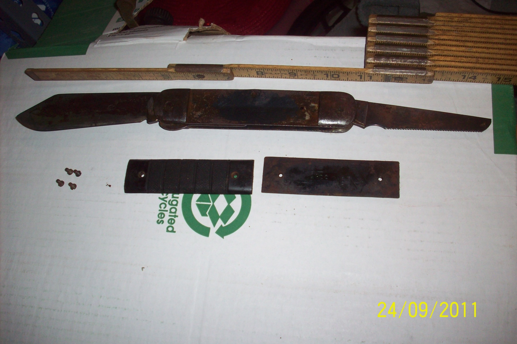

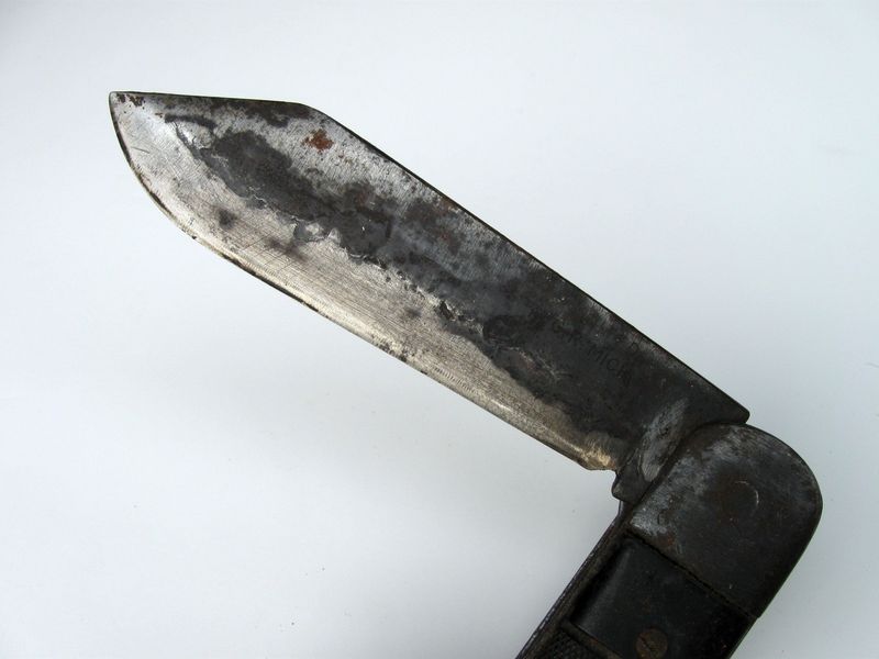

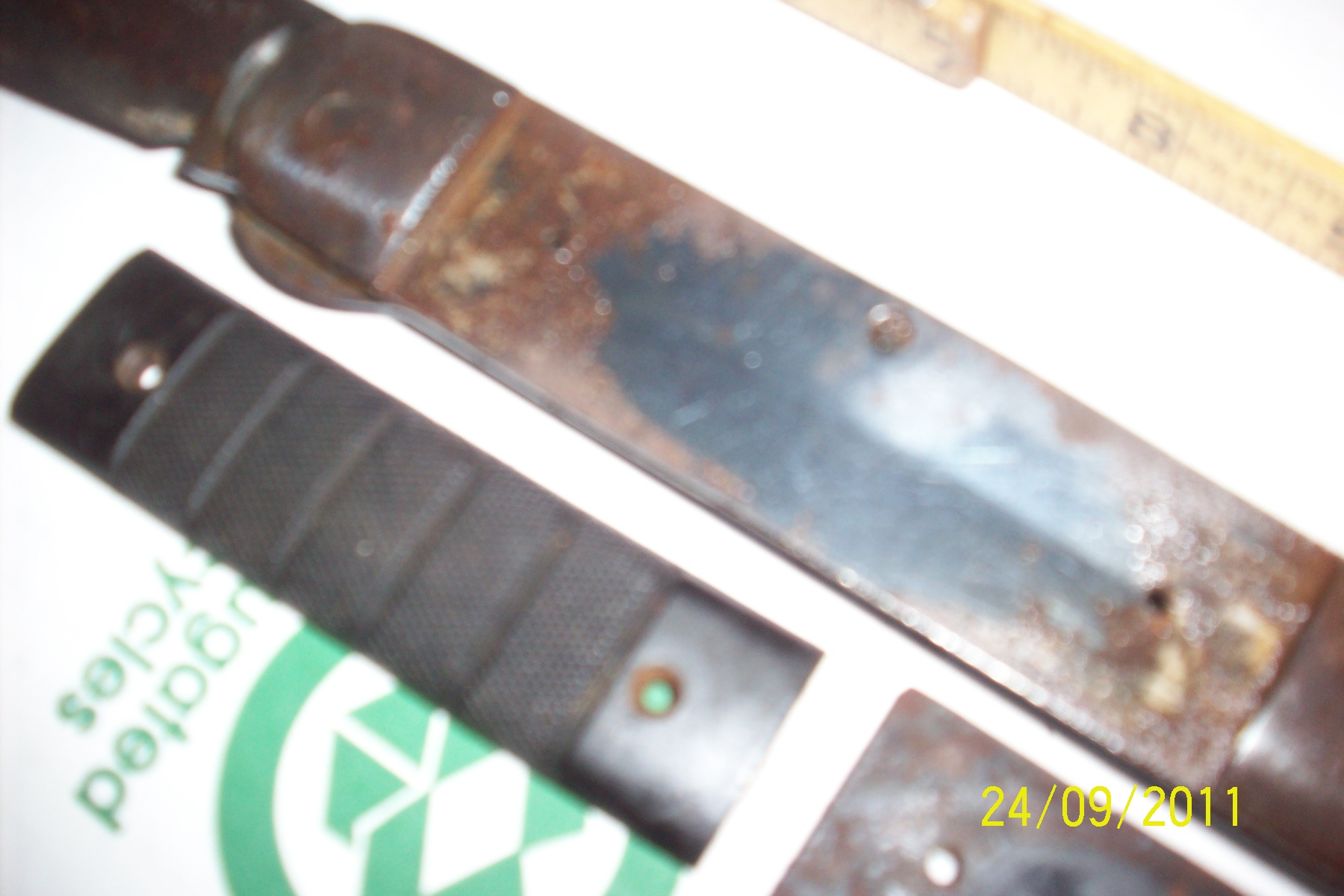

Couple of pictures from today- I took the plastic handles off and pressure washed the knife body. It cleaned the interior and blew all the gunk out of the body.
Then sprayed it with WD 40 to displace any remaining moisture.
The main blade spring action improved a bit, but that side rivet will need some work. there is a bit of play in the side bolster. To do this, the steel knife body will be positioned in a vise (non-marking jaws) and will squeeze it back into position.
Then depending on if it stays in position, I plan to lightly peen the rivet to keep it positioned in the hole. Simple process, just need to be careful with alignment and centering a punch on the rivet.
Plastic handles have some marking on the inside. Screws are in very good shape, came out freely.
I received an e-mail from Frank Trzaska, who runs a very impressive web site exclusively dedicated to Military Knives:
Frank writes:
The knife was made by the United Machine Tool Co. in Grand Rapids Mich. It should have the makers name stamped above the GR Mich stamping.
They were a secondary supplier to the military during WW II with this knife. They produced 60,000 of them during the war. They also sold commercial versions after the war with the parts chrome plated.
Parts are non obtainable for these knives. If you want to restore one the best bet is to buy two broken ones and make one out of it.
Thank you for the kind words on my site!
All the best
Frank Trzaska
Picture shows the saw blade tip has been broken, maybe 3/8 of an inch missing. The teeth are still fairly sharp and as mentioned, the sawblade is in very good shape with minimal to no discoloration.
Tomorrow I plan to polish the exterior and see what it looks like. I might touch up the blade but it's going to lose the blacking. Such is the sacrifice we need to make to clean this up to cosmetic grade.

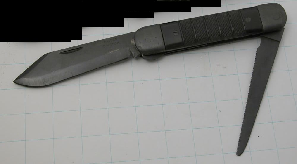

It should look like this when you are done
