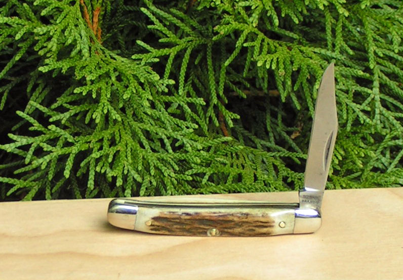

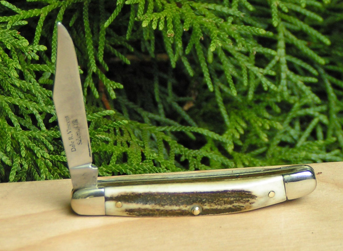

A Schrade 108OT with a broken spey blade. Converted to a single blade with stag handles added. This went into my store this weekend and has sold already.

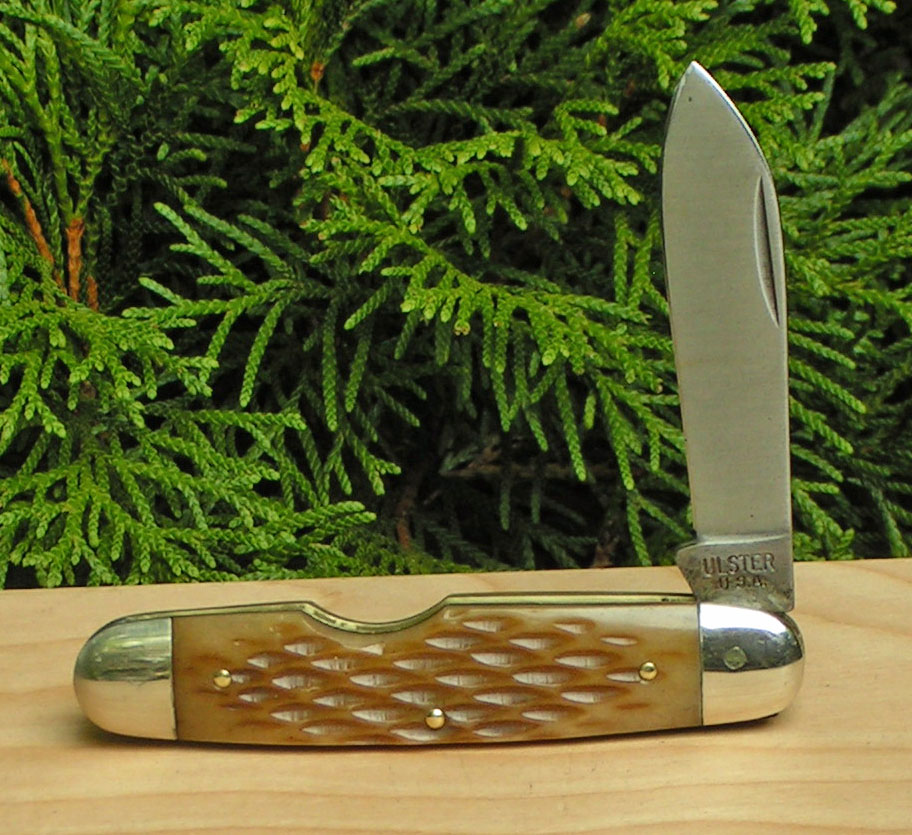

An Ulster spear blade from a camp knife put into an Ulster stock knife frame and converted into a single blade easy opener. I did crack the bone at one of the pins in this knife.

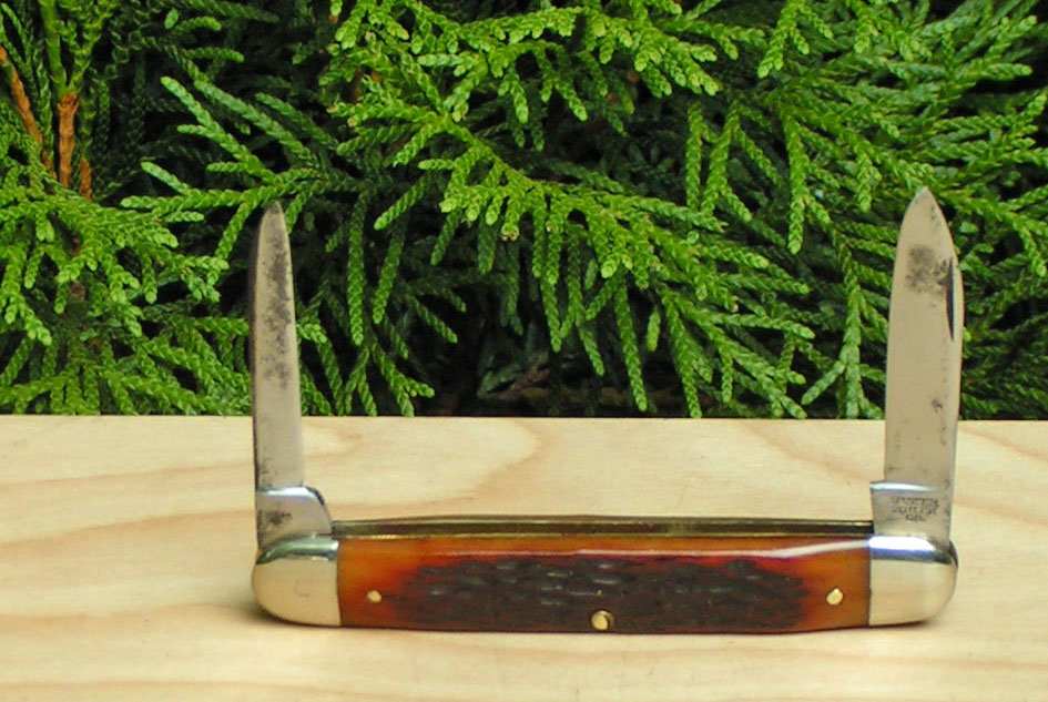

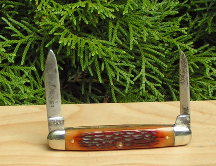

An Ulster penknife that had bad celluloid handles on it. I took it apart, cleaned it up and put it back together with RV jigged bone, which is the closest to the peachseed jigging pattern Schrade and Ulster used. I put this one in my store this weekend and it has sold already as well.

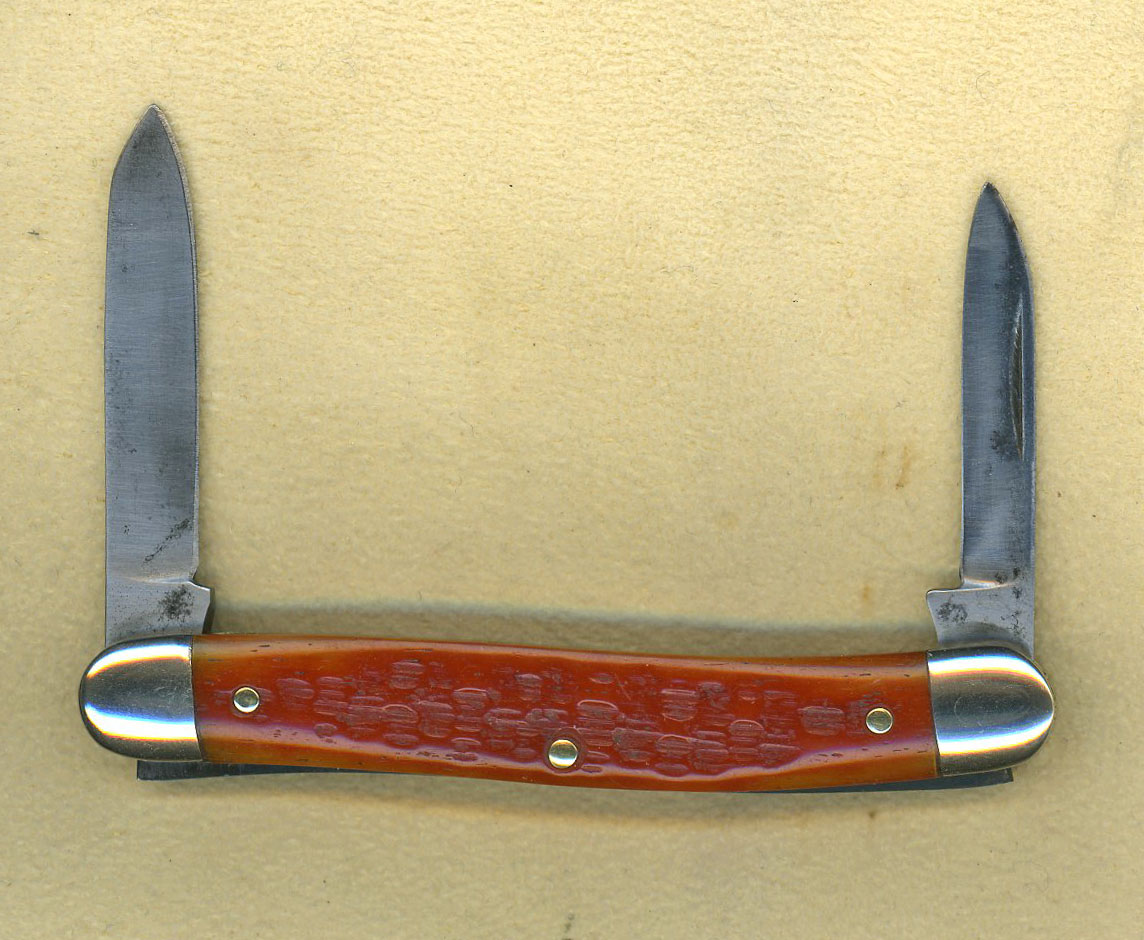

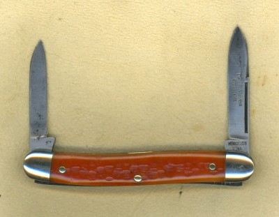

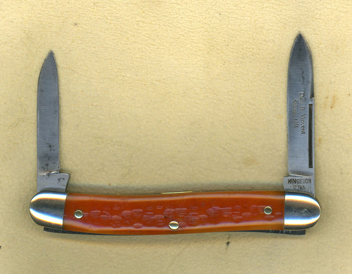

This is a nice Kingston penknife also with bad celluloid handles. I tool it apart, cleaned it up and put on come colorful jigged bone. It currently resides in my AAPK store.

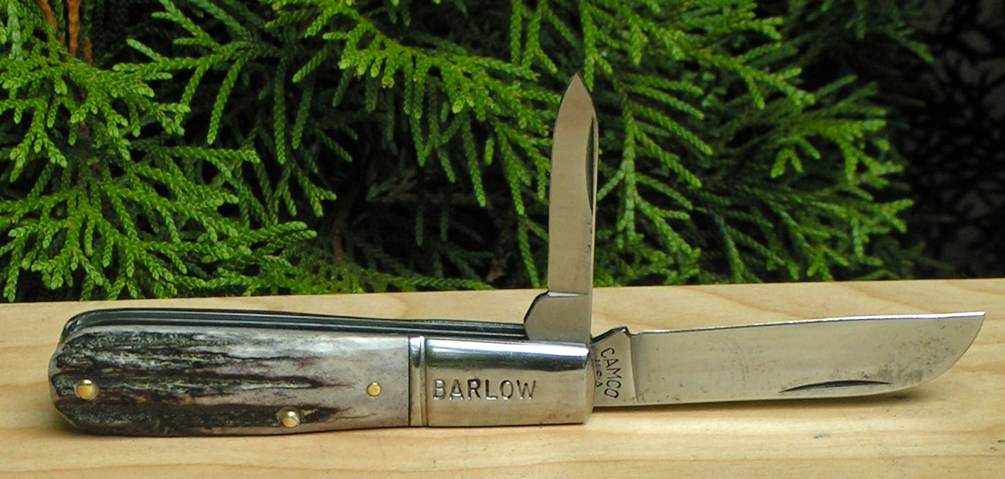

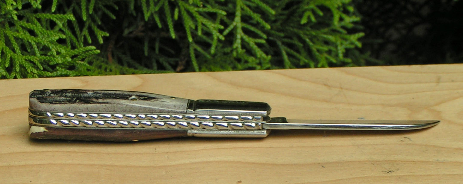

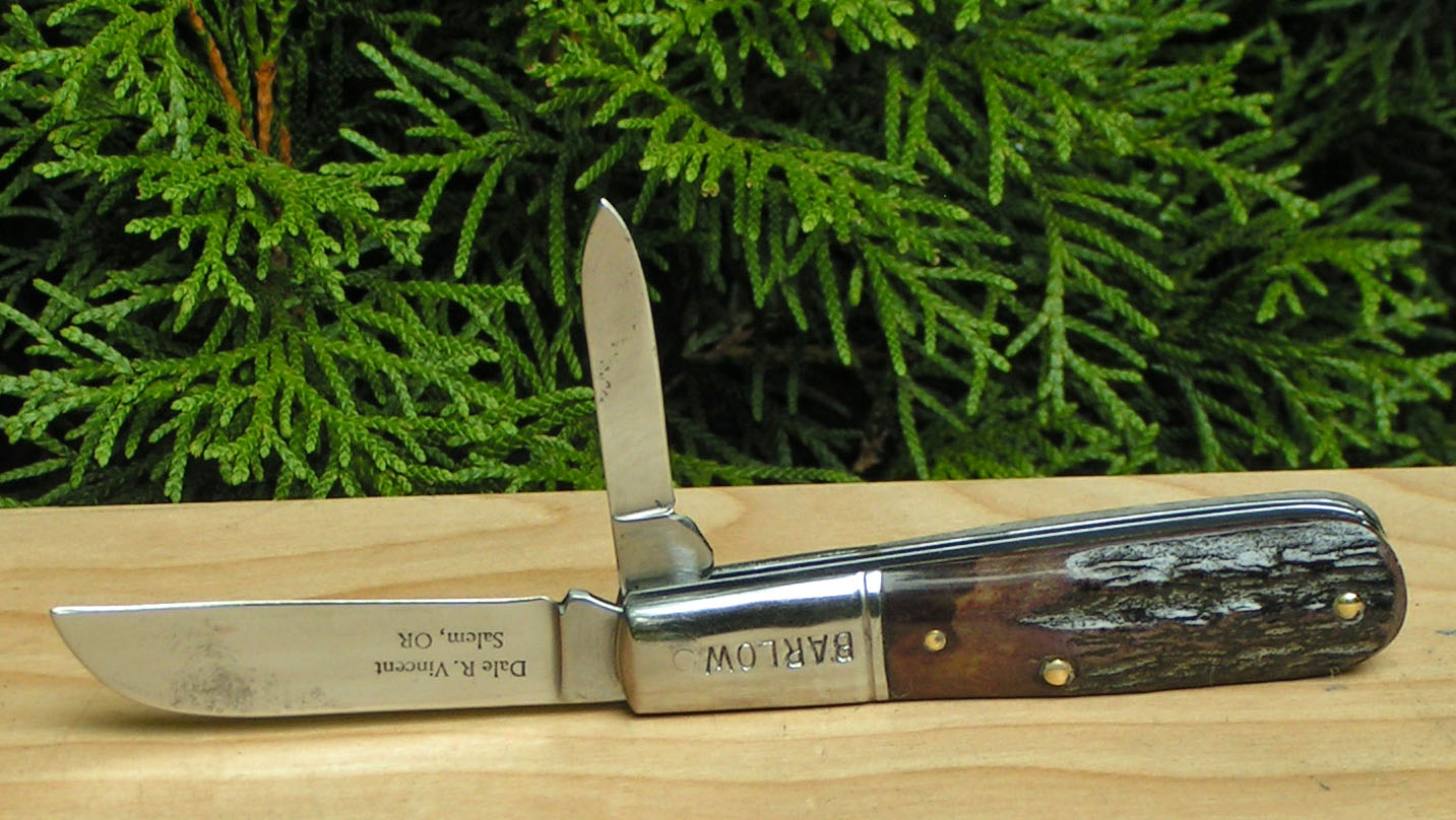

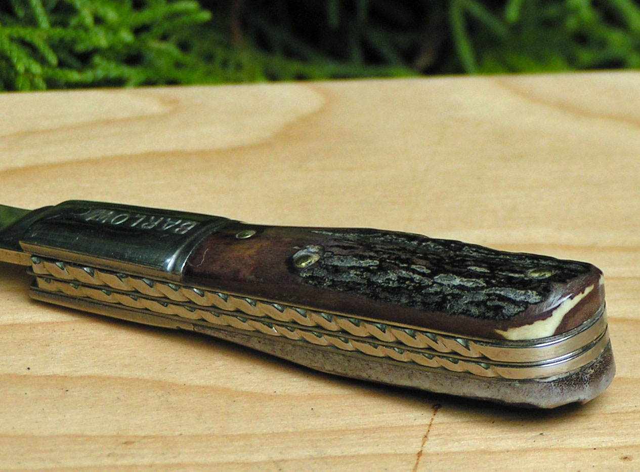

I did a customization of a Camco Barlow. It is unusual in that has the sheepfoot master blade instead of the more common clip blade. This knife was in extremely good condition when I got it. I think it still had the factory edge on the blades. I did rope filework on the backsprings and added stag handles. The stag was an experiment in dying stag. I used a two stage dying process. It was interesting to me to see how differently the two handles came out even though I did them together, using the same dye, same process, and same dying time. I guess there is no telling what you may get when working with natural materials. This reminded me of how many of the old WW II era knives had different colored handles. This one is currently in my AAPK store.

All very nice Dale but the Ulster EO spear is beautiful. Can't imagine what it will be when you're back to 100%

I like what you did with the Ulsters!

All nice ones, but that EO is a jewel.

nice work...love the ulster eo.

Love the Camco and Ulster pen knife. Hope the rehab works out, I definately sympathize. I just got home from gallbladder / colon surgery, and I don't dare going near anything sharp for awhile.
I might have to stop by your store,........ I really like that barlow !
