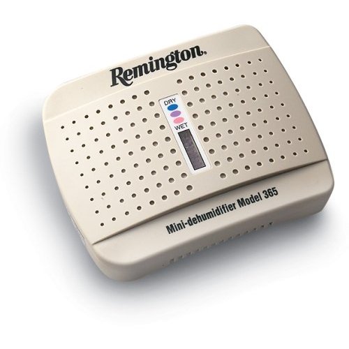

- justold52
- Posts: 4459
Re: Oiling 1095 Blades
I hate finding the damn things! Seems no matter how much care you take to avoid 'em, theres always one in a crowd. O'course living in the Pacific Northwest with its 95% humidity doesn't help.
I use this but I can't tell you if it works. I have it in my show case and it has a lot of CELLULIOD handled in it. As or 8 years running this. I have not rust or pitting pepper. So my guess is that it works....
- Attachments
- Remington® Model 365 Mini-Dehumidifier.jpeg (30.99 KiB) Viewed 2796 times
