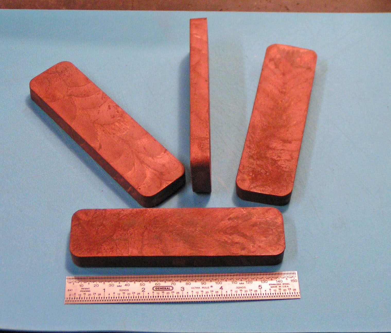

From what little I know of the Delrin handle making at the US knife companies, I think the handles were pretty much molded to the individual knife, not cut from a sheet of material. It makes sense from a cost perspective, as there would be very little wasted material.
This pic of Delrin blocks Schrade used. They were fed into a machine that melted the blocks, dyed them and injected them into the proper molds. I understand some were then colored again later.
If this is the way most of the companies make their Delrin handles; it might explain why, in spite of looking, I have never see Delrin available in sheet form.
