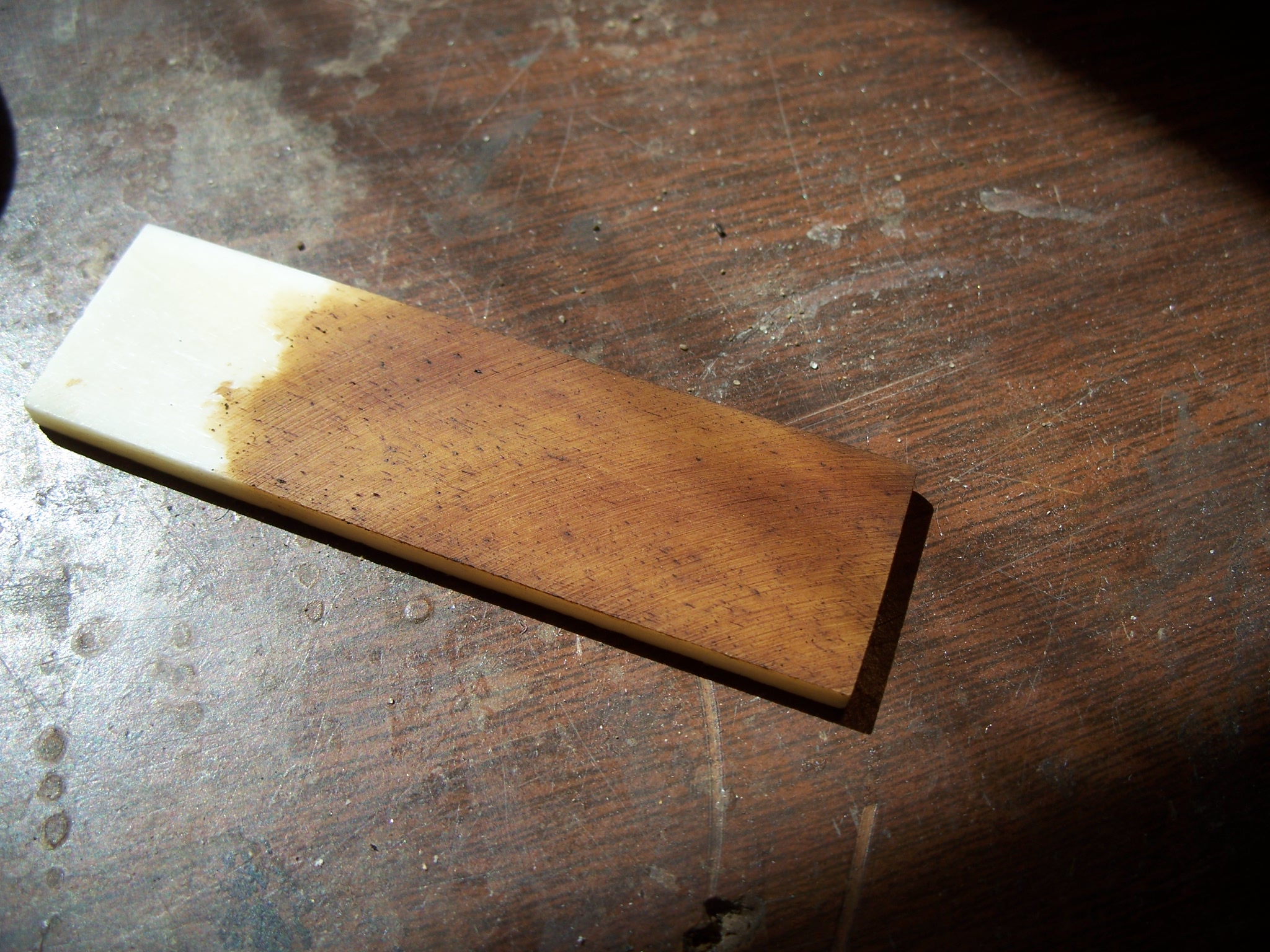

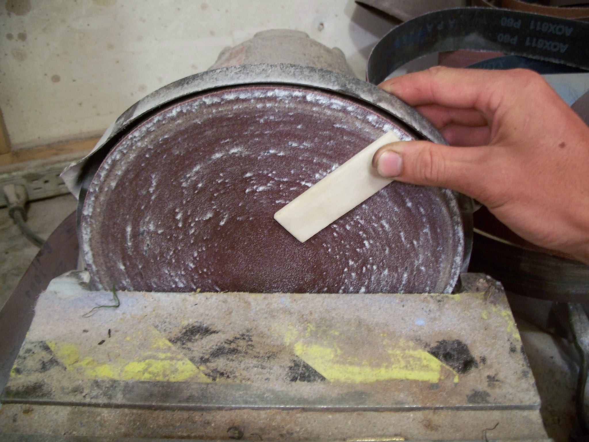

at least 60 grit disk on a bench mounted disk sander (36 is better, then do a little rubbing with 400 to give it the old pocket worn look, then dye) . Hold it in the position shown to achieve desired results. different angles make the scratches angle in different directions. As with anything experimentation is one of the best things I can suggest because the possibilities are nearly endless if you play around with materials, angles, grits ect. This one was done with a very worn 60 grit disk (what I happened to have on the machine at the time)

Re: Saw Cut Bone
That came out real good Kaleb!
I think you nailed it spot on!

Thank you for posting this. I got a bit impatient and found a real coarse rasp and tried to do one set of handles with it. I got the deep striated lines I was going for, but the pattern doesn't look saw cut or uniform at all. I am going to try to duplicate your results on the disc sander.
