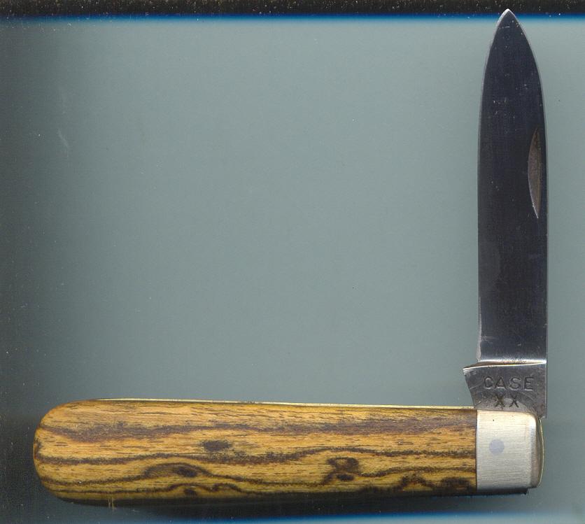

WEll, Here it is finished. Thanks for giving me the opportunity to work on this one Rich.
case xx elec after.jpg (53.74 KiB) Viewed 4194 times

from blood to a finished knife? is that all there is to it? c'mon mm, show the other pics.

no pics inbetween that, sorry. It was too dark to get any ::dang:: .

ok, next time we would like to see your hafting process and finish work on the blade. that old case looks mighty fine now, good work.

Good job, MM. ::tu:: It should make for a great carry.

Great work MM!
That one must not have wanted to cooperate. It looks much better now. ...whether it likes it or not! ::tu::

Looks good Muskrat Man.
