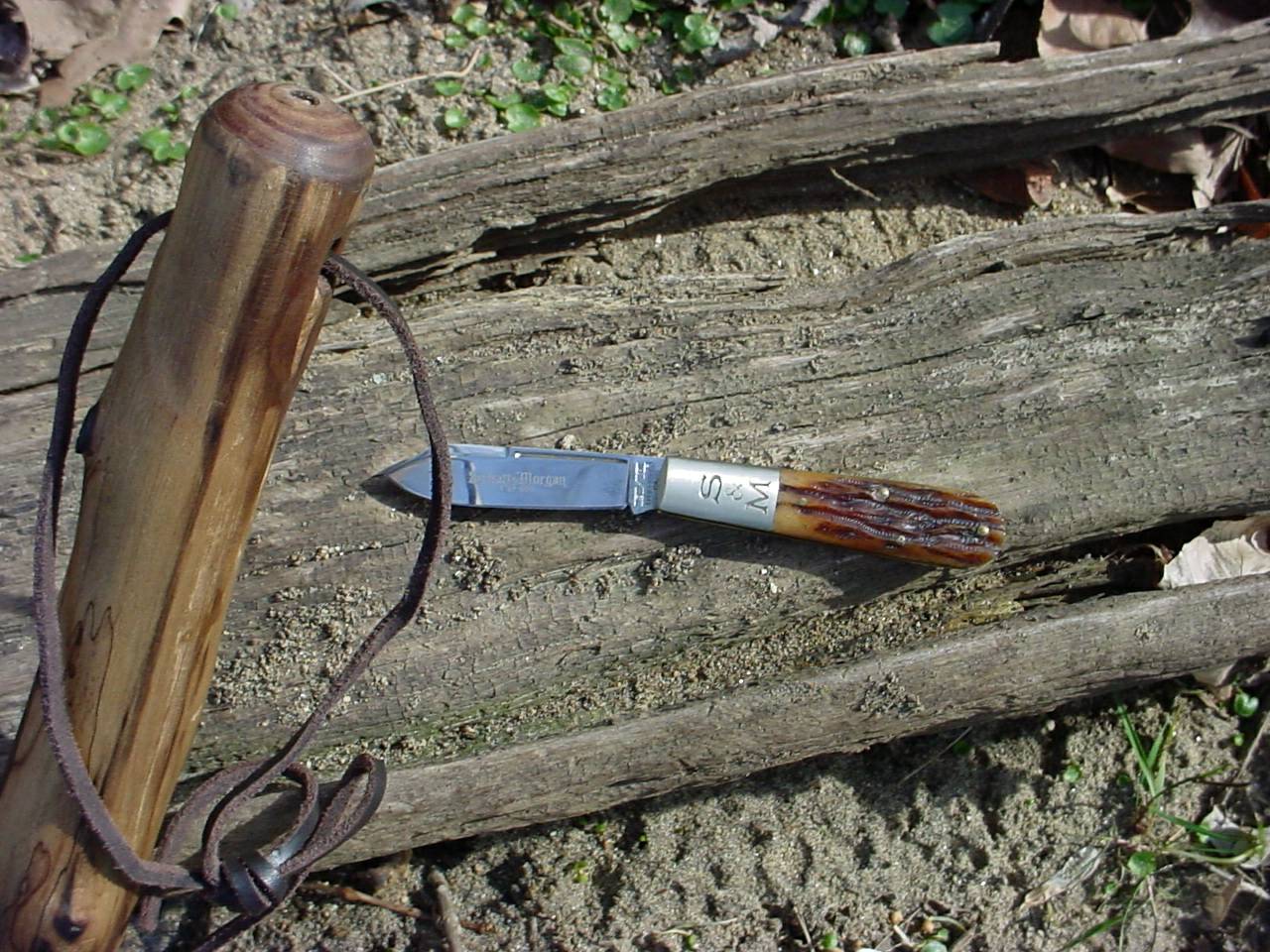

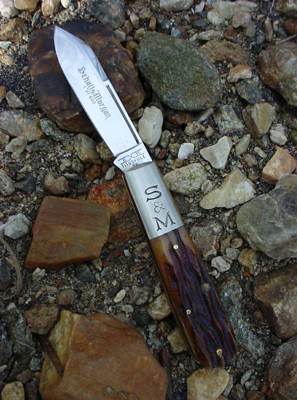

I ordered a Shatt & Morgan knife and received it today.
041269 BARLOW from series 11.
It is a nice looking knife but I'm a little disappointed as the blade has a very slight play in it.
Also the blade when opened isn't in a straight position.
Is this a common thing with this brand of knife?
I have never had any problem like this with any other brand new knife I ordered online.
I was contemplating on sending it back but the camping trip I want to take this knife along on is in just a few weeks. I'm sure it will take much longer than that to have it repaired.
I myself can make the repairs fairly quickly but that's not the point.
I can tell these are quality knives by the materials they are made of but the companies quality control is least to be desired. These problems should have never left the factory.
With a $20 dollar knife I'd expect something like this. This knife wasn't cheap...
I am going to take the knife with me on my trip as is. See how the knife holds up and if the play gets any worse I'll repair the knife myself.
A few taps with a plastic hammer will fix the play problem. Trimming the run up will fix the blade position problem.
If I was collecting this knife as an investment I would send it back for a refund.
I will be sending Clarence an email with my disconcerts about the minor problems with the knife. I also explicitly ask him for a shipment tracking number when I ordered the knife which I never received.

the "drooping blade" is indeed a common occurrence with queen-made knives, and has been for years.
as you said, it's an very easy fix, so it's baffling why they've never figured out how to do it at the factory.
blade play is uncommon, except on their mountain man pattern.

I repaired the knife myself tapping the bolster pin with a small plastic hammer which took the play out of it.
I also had to hand sand the hammered pin area because it got a little scared up in the repair process.
I left the sagging blade problem alone, It doesn't concern me that much and doesn't affect the performance of the knife.
Never had anymore problems with the knife and use it a lot when I go camping or fishing.
I sent an email to where I bought it and was told to send it back.
I didn't have time to wait so I made the repairs myself.
Like I said if I were collecting and not using this knife I would have sent it back.
