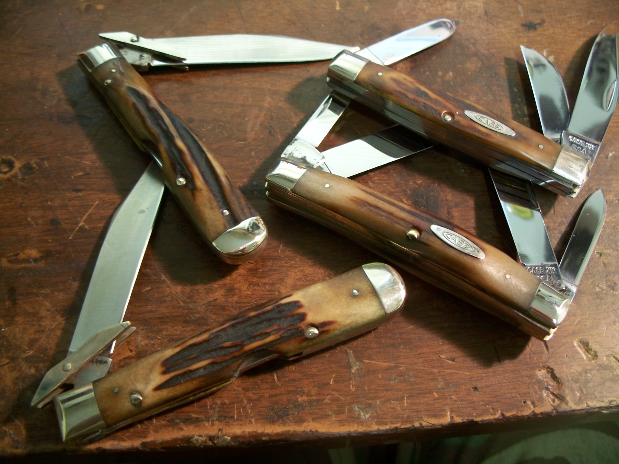

Here are some of the knives after some work. They had been soaked in transmission fluid and had some kind of thick topcoat on the stag. The stag was completely black and/or chocolate colored on all of them, they tuned up pretty nice.

Those look pretty good.
