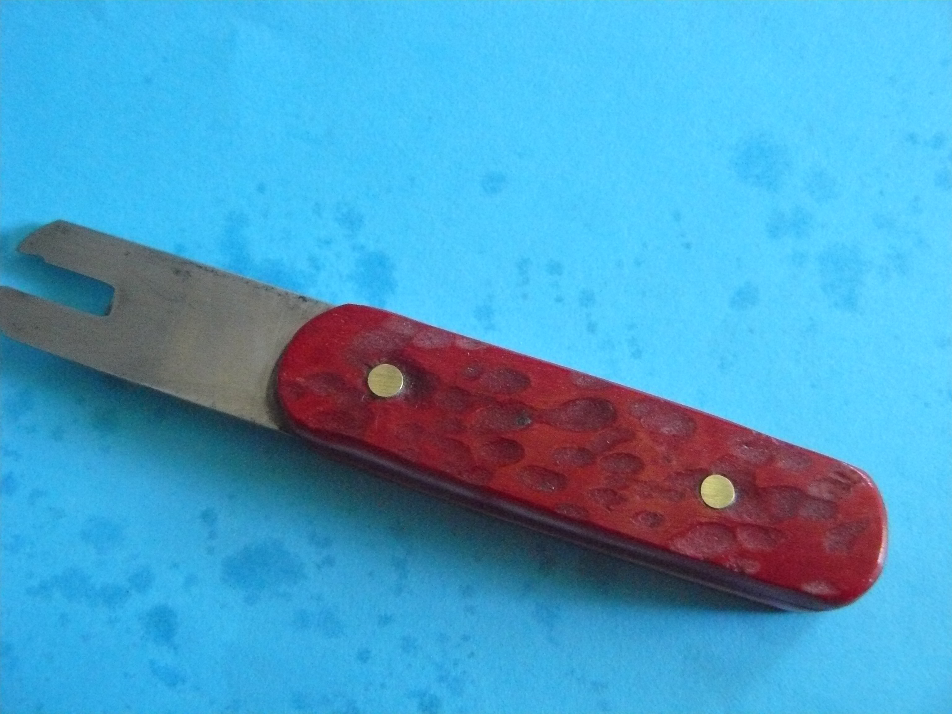

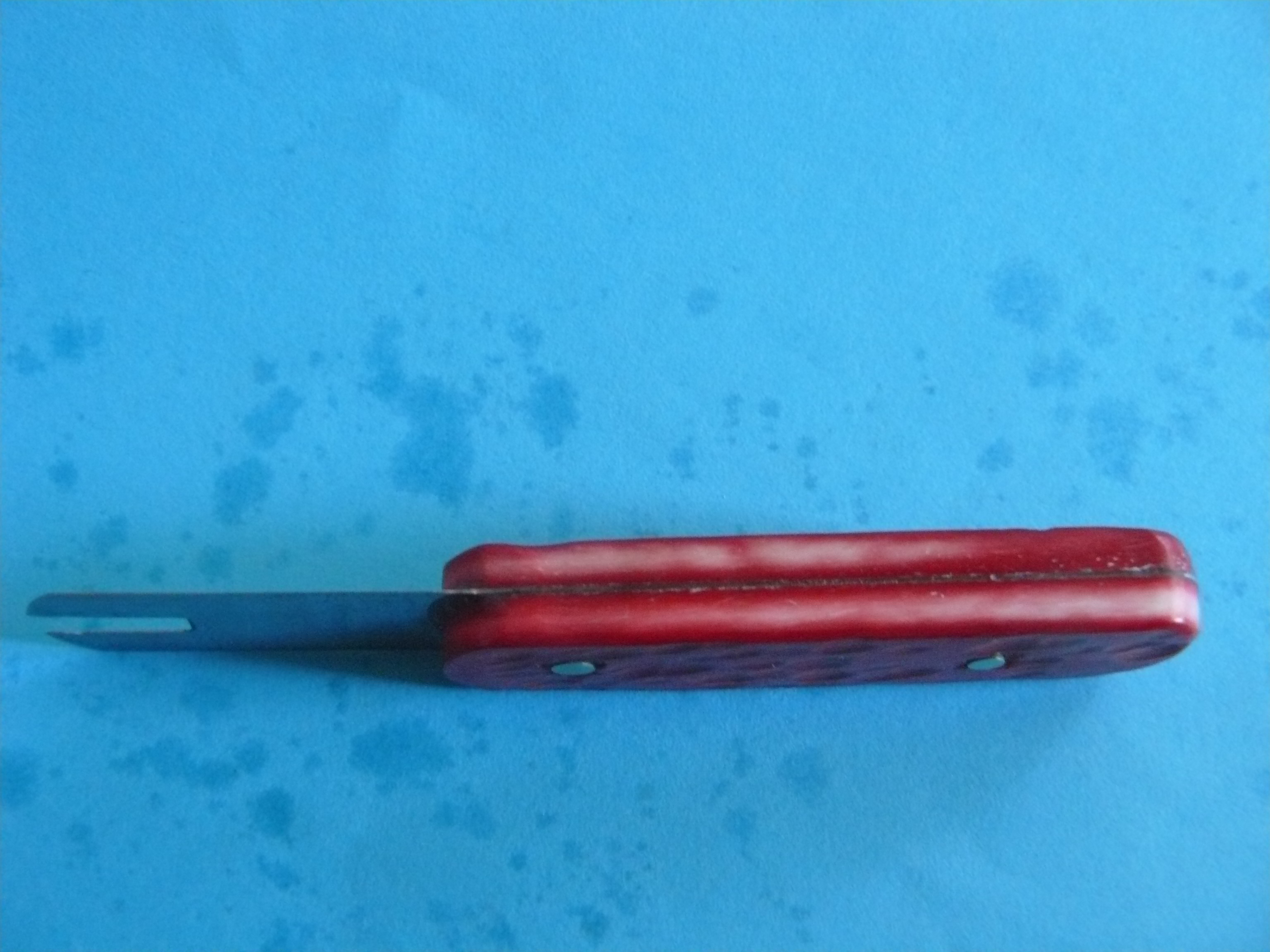

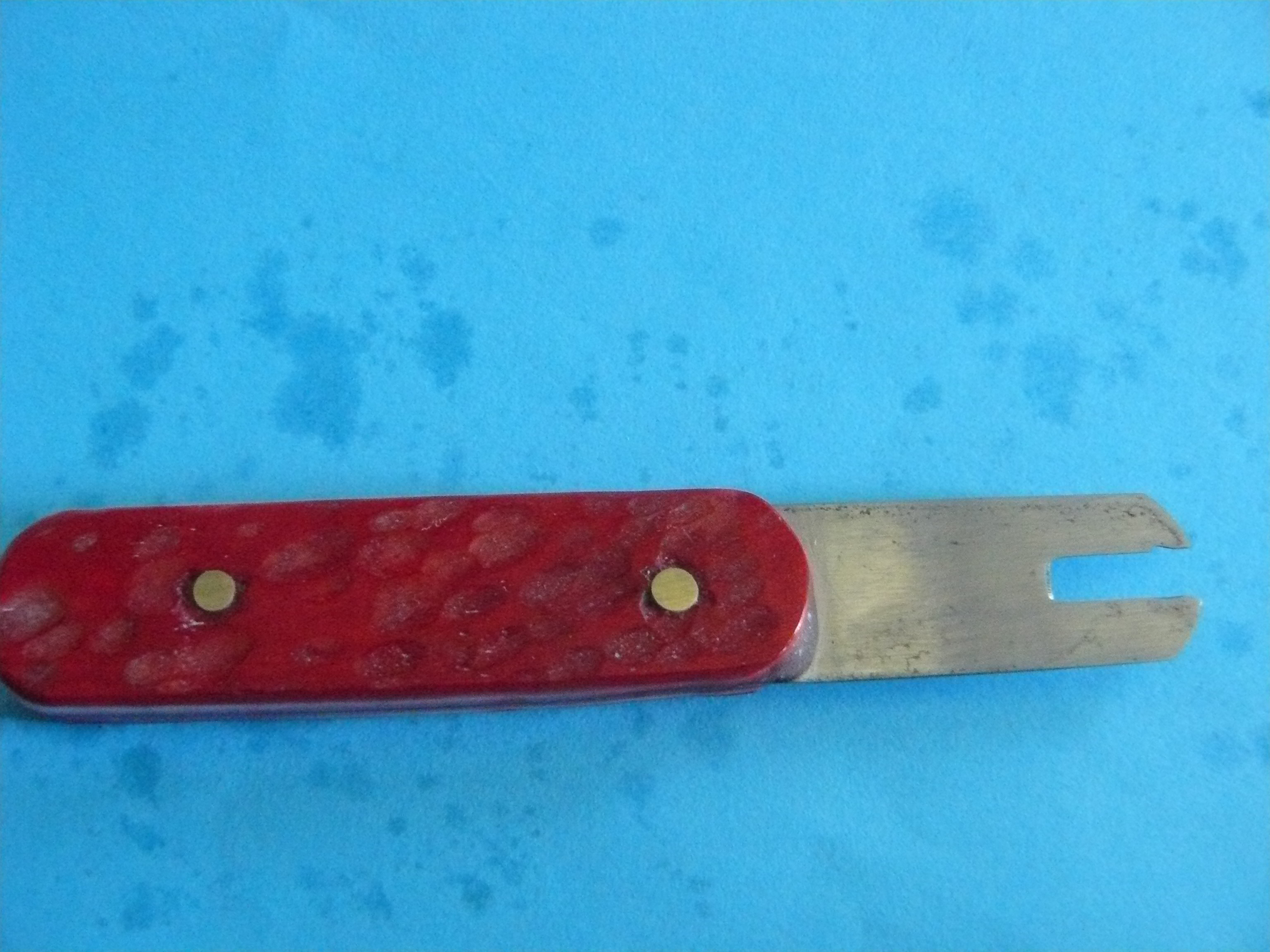

Hi all, Got around to making a slackener the other day.
The handles are saved from a broken set, you'll notice one hole is a bit offset, I had to work around
the broken edge, but still works.
Was going to put in landyard hole, but with my expertise probably would've been a disaster.
Anyhow she works.
She's 3&3/8 long, 10thou. blade.
Comments wellcome.
cheers Gary. ::groove::
Pic's leave a fair bit to be desired, really shines pretty good.
Cheers
Gary

Looks like a good job.I just have one question:What is a slackener? Haven't heard the term before.

Looks like a tool to keep space between the liners and blades from getting to tight or stiff when putting a knife together or back together... ::shrug:: ....thats my guess. :)

johnnierotten wrote:Looks like a tool to keep space between the liners and blades from getting to tight or stiff when putting a knife together or back together... ::shrug:: ....thats my guess. :)
You are right Johnnie~
Althought the term is "slacking tool"
You can also use tin foil folded to .010 to .015 thickness.
It is actually just a spacer or shim..........
Gary~
Your slacking tool looks as good as some of the knives you made.
Wow!!! I just use an old putty knife.
You need to make a spreader tool now.
(PS) The pins being a little offset just shows it was hand made.
I've made knives where the pins aren't symmetrical.
If you look at antique knives, they are by no means perfect.

Nice gary..This was a feeler gauge?
Did you use a Dremmel to cut the slot?
Been meaning to make one.
I Put my first knife together a few years ago and that was one of the things
I forgot to do ::facepalm:: ,and that knife is TIGHT!

The terms are synonymous. Adrian Harris calls it a slacking tool in his book & Ben Kelly calls it a slackner in his book. It depends on which book you read or what you learned to call it. They are the same tool.
I thought about putting handles on my slackners, but the thinner ones will sometimes tear when they are removed, usually those that are 0.008” or less, so I make mine out of feeler gauges and if they tear, I cut them off and cut a new slot in it.
