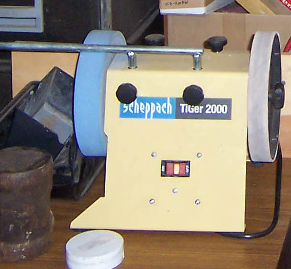

I modify blades all the time on a grinder; the difference is I use a slow moving wet grinder.
Here is a pic of my medium wet grinder. It has about a 7" stone.
There is a plastic tray that sets under the blue stone. It is filled with water when the grinder is in use.
The bottom of the stone runs through the water and is carried up onto the blade constantly.
I also have one with a 10” or 12” wet grinder and a small Craftsman wet grinder I use for tools.
The most likely cause of damage to the blade is from overheating. The fact that the stone moves slowly means it does not heat up as fast, the fact that is runs through a water bath means that is stays cool.
