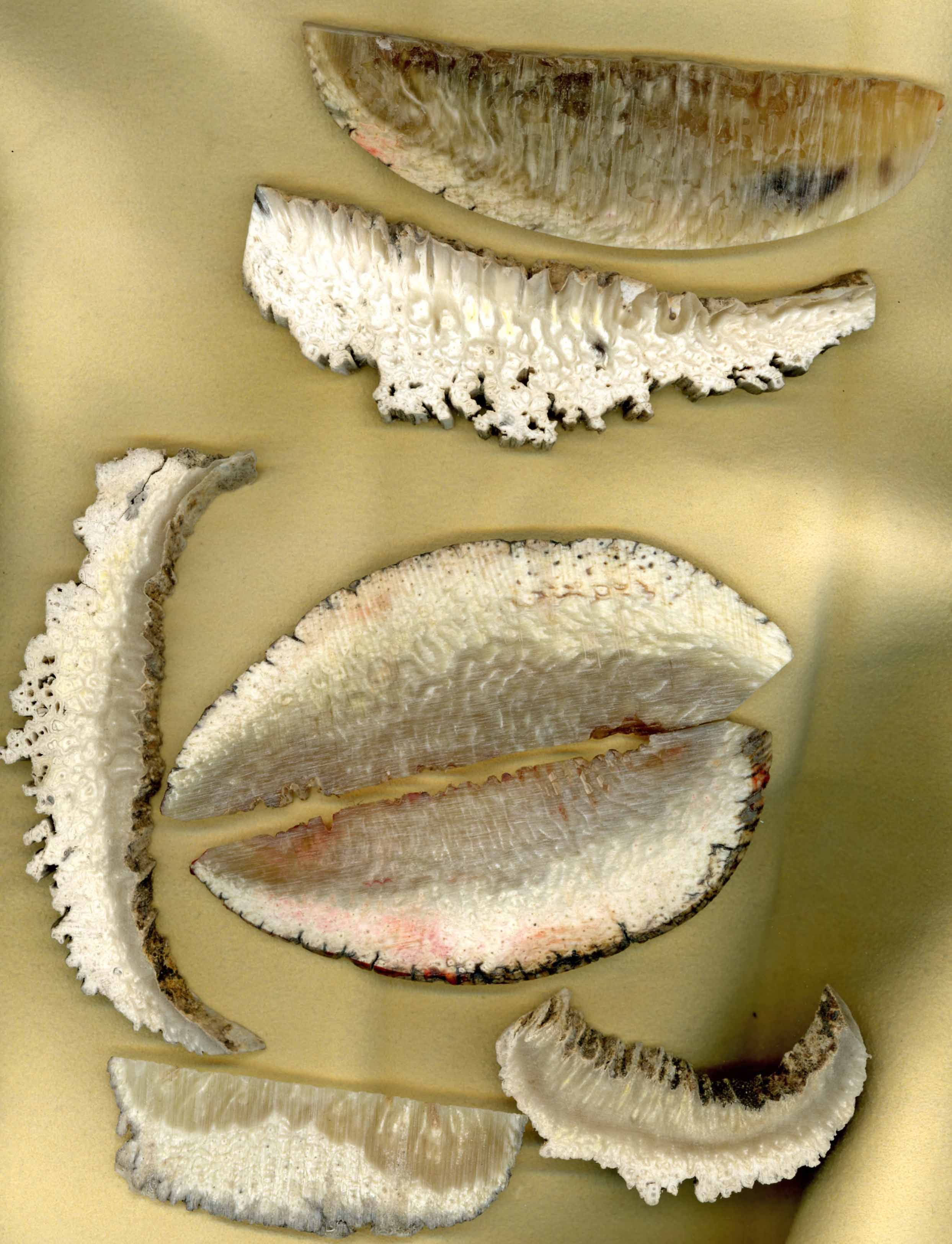

Have any of you worked with Musk Ox horn?
I picked some pieces from a custom maker last year, several odds and ends, but no matched sets.
It has been stabilized, so I don't anticipate any serious problems, but it is very interesting stuff.
Parts of it have a crystalline look to it. Very pretty.
The hard thing for me is deciding what kind of knife to put it on, because it looks so different than anything else I have seen. It would probably look right on a knife that had originally had something like waterfall celluloid on it.
Here is a scan of several pieces I got.
The hardest part will be getting it flat & that is probably best done by sanding it flat then finishing up on a lapping block with 220 sandpaper.
